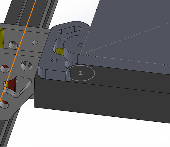

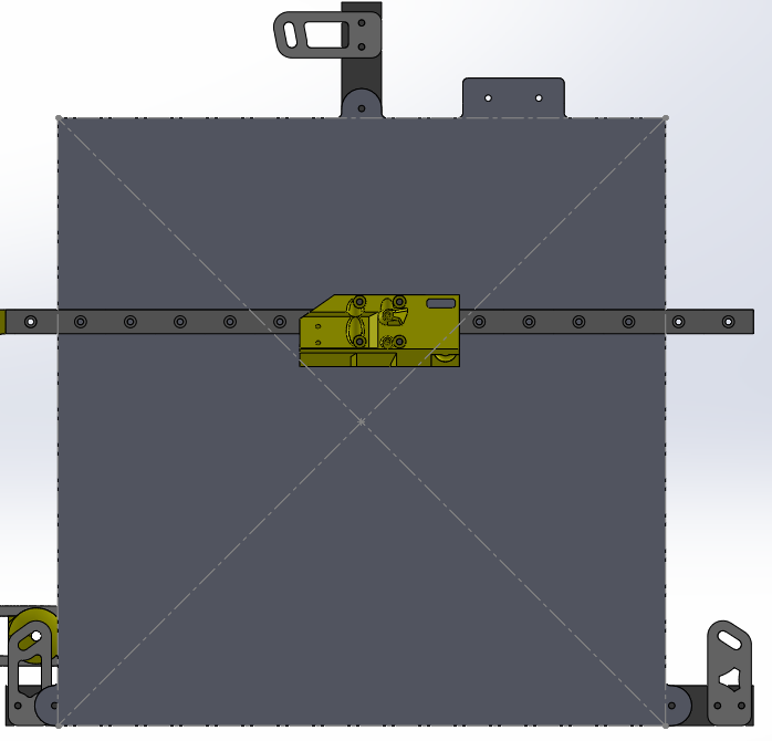

Okay new strategy. Iâd like to still use the heater that I have (12" x 12" w/o holes). So I am going to cut a new bed plate that puts the holes outside of the heater and printing area. I am thinking I will do thisâŚ
Any reason this wouldnât work?

The only issue I would worry about is the new placements interfering with the brackets for the Z drives.
That was the only issue. But I made it work.

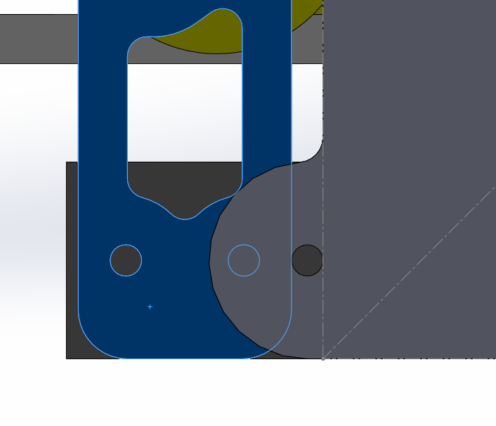

The top side and right side are no issue at all. The left side was as close as it possibly could be (thanks Ryan). There is perfectly enough room for an M3 bolt hole between the edge of the heater (grey dotted line) and the edge of the Z bracket (blue line). How convenientâŚ

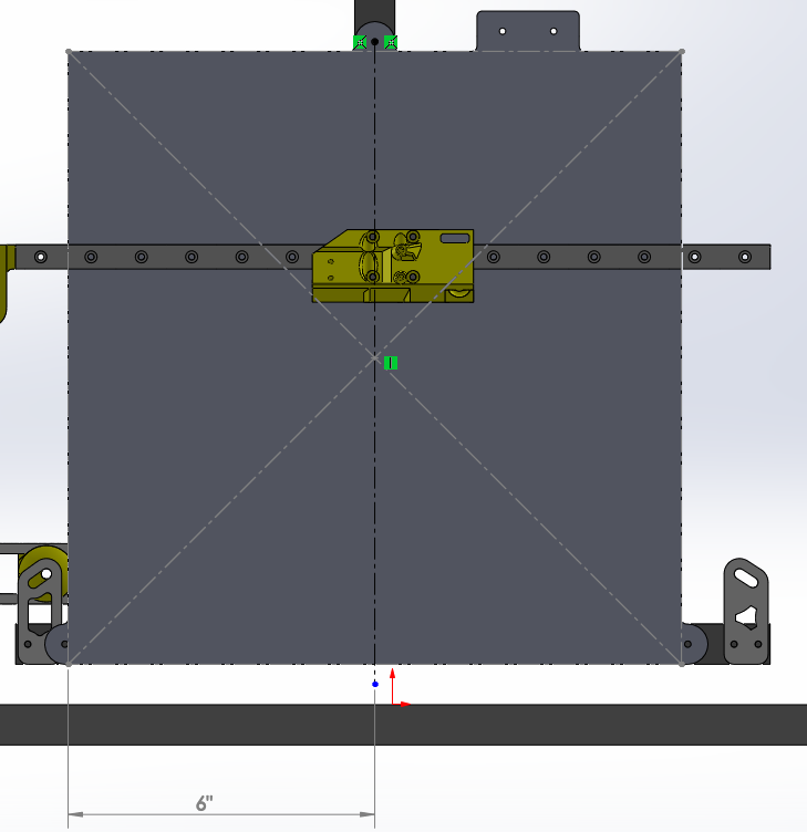

How is the left edge of your bed so much farther from the bracket than mine? The top center mounting hole should be centered on the plate, correct?
If so, with a 12" bed, then the edge of the bed is 6" from the centerline of that hole. Thereâs not much I can do to change that. Look at the gap between the left edge of the bed in model to the bracket in the model compared to the left edge of your bed to your bracket. The model shows it should be a lot closer than you have. Is yours a 12" x 12" bed?

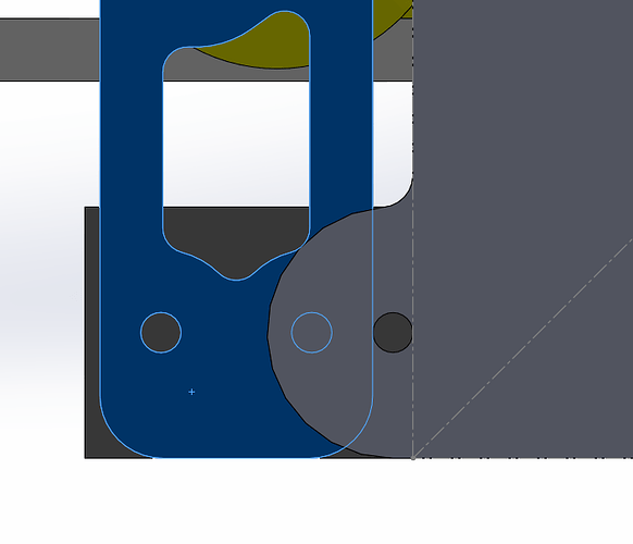

Yes, the bed itself will clear. But the bolt needs to clear the bracket. And I forgot to account for the bed spacer⌠thatâs gonna hit the bracket in this scenario.
I wanted extra space around my bed so I think I added 25mm in Y, and 50mm in X to the frame or something like that??
Edit: yepâŚ

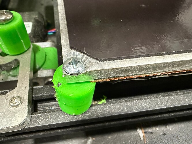

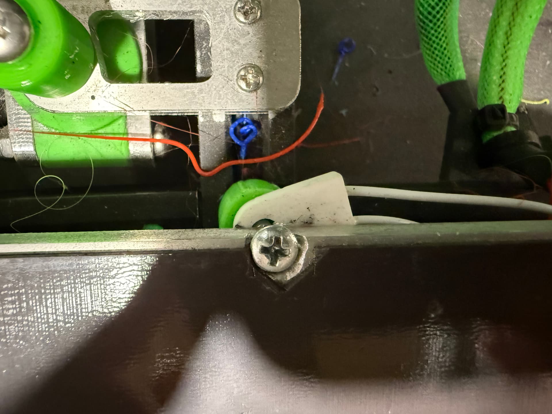

I did slightly notch my heater to clear the bed screws. BUT I did had a thermal camera and took a look at it heated up before I did to make sure I wasnât going to cut into any wires inside.

AAHH. This could help. What do you think, a 1/4" all the way around the heater is safe to cut?? I will only cut around where the bolts go, not all the way around the heater. But just in general, it appears a 1/4" is safe, no?
Yeah I think so. I put my screw holes as close to the edge as I could get them, and then I just barely notched around the hole so the screw could pass through.
On the second pic you can see the thermal fuse under the bed as well. Which looking at it, looks like I need to move it more under the bed ![]()
Yeah I tried to get mine as close to edge as possible as well. But it still gets in the way of the heater a little bit. Going to try and trim some off the edge the heater and see what happens. If I ruin it I ruin itâŚ
Just worry about where the screw hole is. That silicone spacer wont hurt anything touching the heater pad. Mine are printed TPU and hold up just fine.

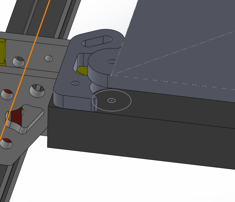

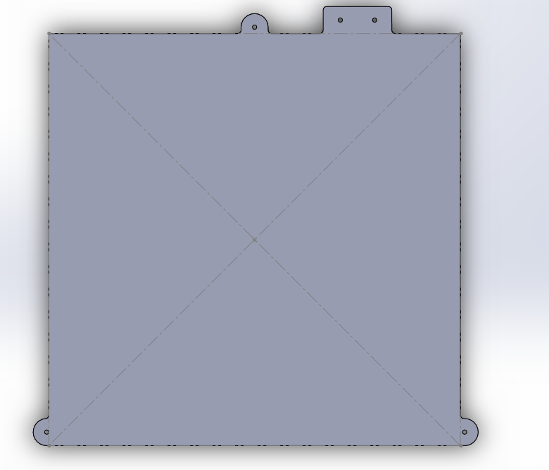

Honestly, before I try to cut the heater, I am going to try out my plan of making a new bed plate where the holes are outside the 12" x 12" heater.

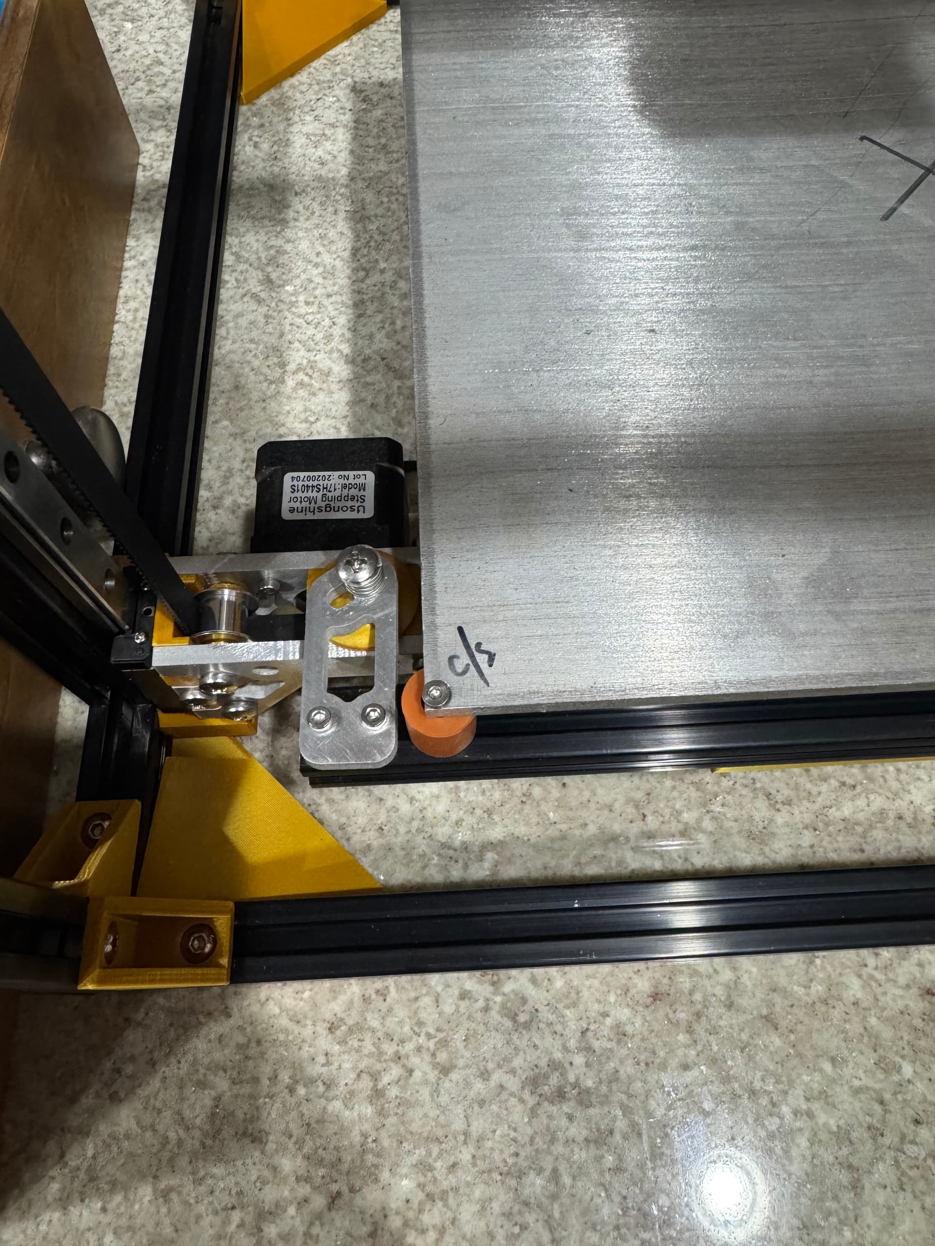

As mentioned before, the only trouble area is the front left bracket. I modified the bracket to allow for the bed spacer (grey circle) to fit inside of it. I had to get rid of one mounting bolt, but I think it will be plenty strong enough with just the one.
As long as it doesnât start to pivot with only the one screw. 2 screws keeps the bracket straight all the time.
I am hoping it doesnât pivot because it is two flat surfaces being bolted together. Even if by only one bolt, it should be strong enough to stay flat-to-flat which wouldnât allow pivoting. At least that is my hope.
I would be a little leary about removing one of those screwsâŚ
I had a problem early on when those 2 screws werenât tight enoughâŚ
