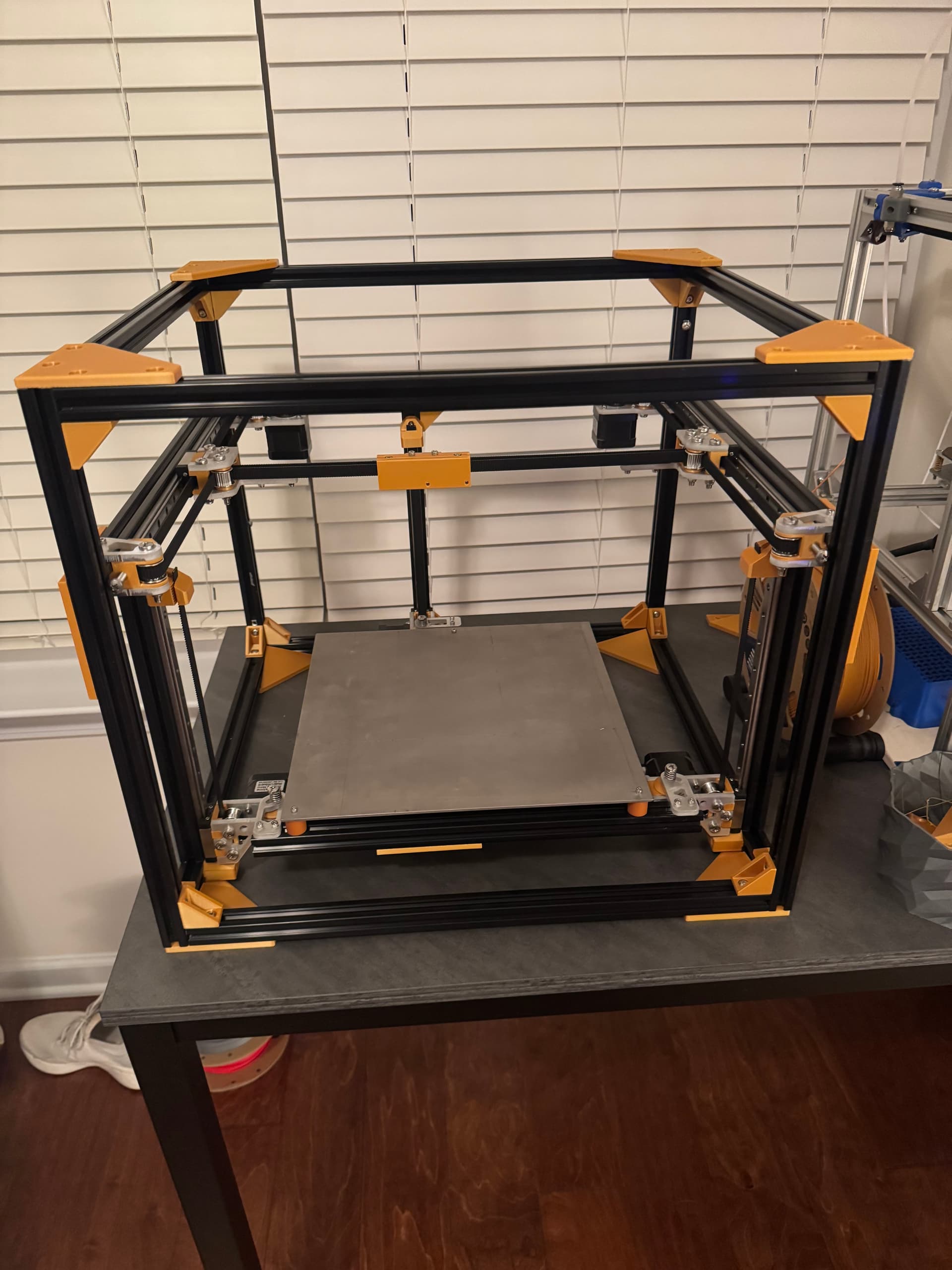

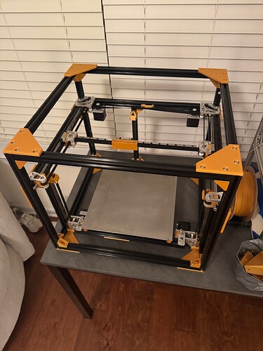

I started a V5 Build and so far so good. Physically, it is almost done. I just need to finish the bed. I am waiting for my aluminum bed plate to come in so I temporarily made a stainless bed plate with some scrap metal I had laying around.

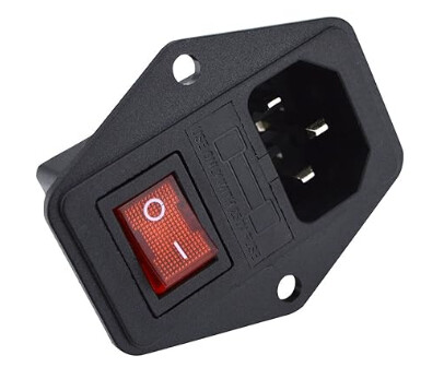

Also, I have never done 110V mains power heated beds before. How are you all handling the 110V wiring for this? I have always used the below rocker switch and routed that into a switching power supply. But if I go that route again, wouldn’t I need to split this off to power the switching power supply and also go to the SSR? Should I use terminal rails for Hot, GND, and Neutral so I can split them off?

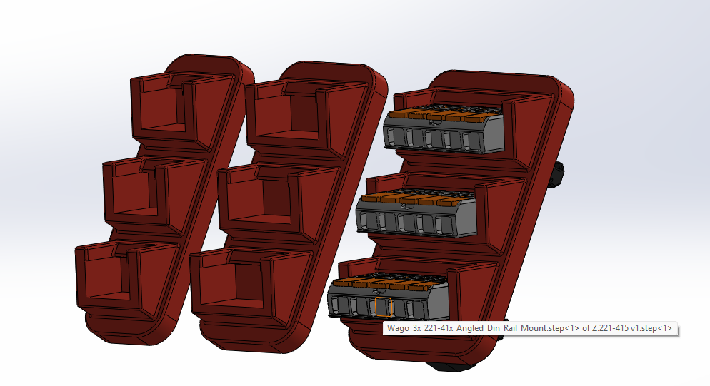

Personally used WAGO based connectors and printed some Voron mounts when making a controller enclosure for my MP3DP v4. Compact enough to fit under the bed. Shared mounts I used at https://github.com/aaronse/v1engineering-mods/tree/main/mp3dp-v4/mods/voron-parts.

Also, I am looking at the Voron Wago mounts and I am curious how the Wago connectors stay in there? Are they just press fit in there or something?
Yep, they just press fit into place, used PETG mounts. CNC cut top/side panels.

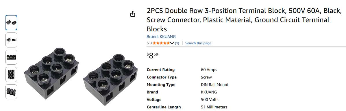

Gotcha! Simple enough. So I really only need the 413 Wago because I only need 3 slots (Supply from wall outlet, out to 24V power supply, out to SSR for heated bed). Correct? Nothing else should need main power.
I would need three of those (hot, GND, neutral).
3 would be good enough for supply + 24V power adapter + SSR. I ended up with 5 slots because I added a 5V power adapter for LED and other stuff.
Oh okay. Well if I need to pull 5V from somewhere I could tap off the 24V power supply and step it down to 5V.

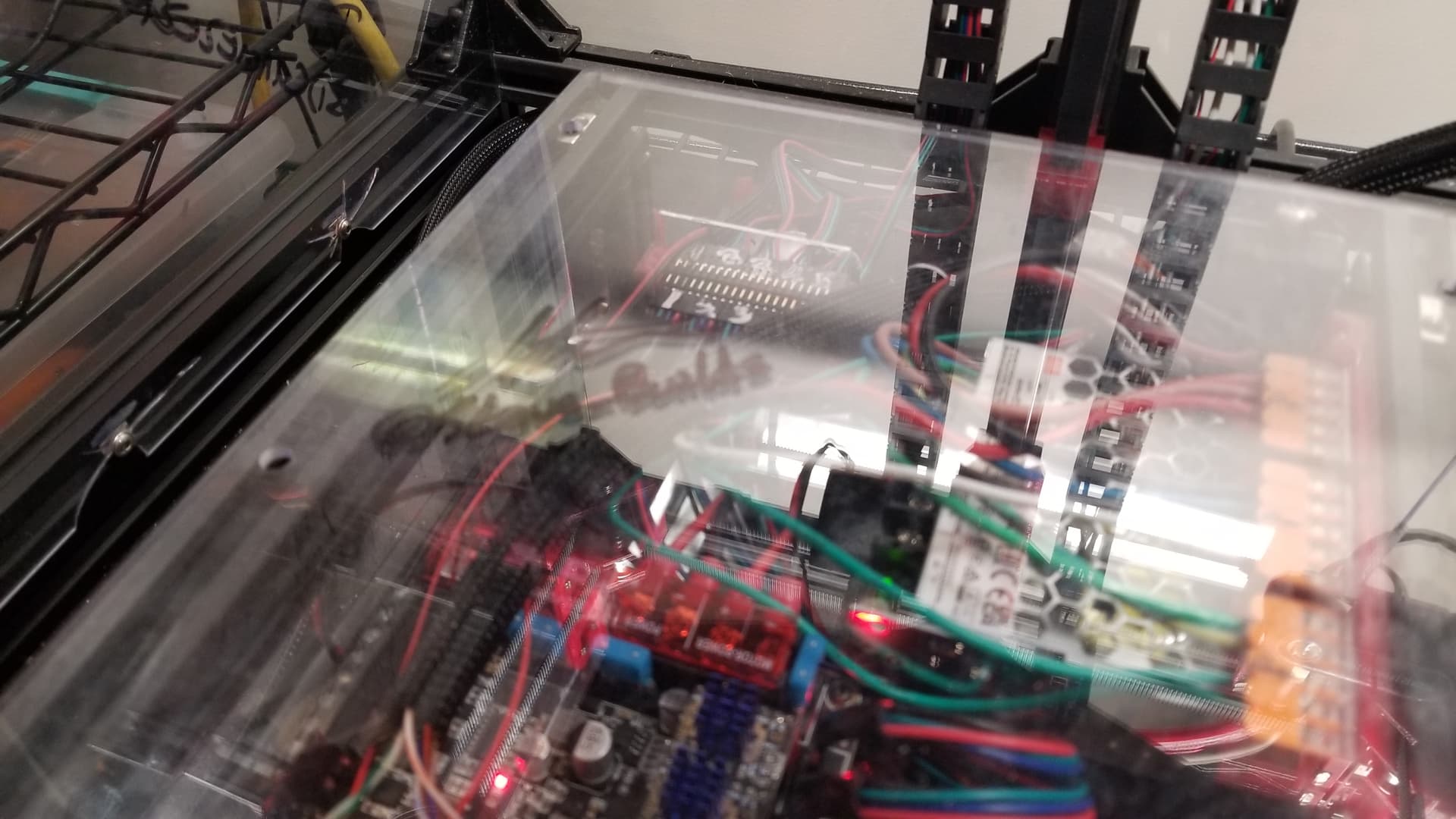

If your controller enclosure is metal, a 5 slot WAGO connector could be useful for bonding a ground wire to the enclosure too.
I do not have a metal enclosure. It is a combination of the aluminum extrusion and clear acrylic.

And looks amazing!

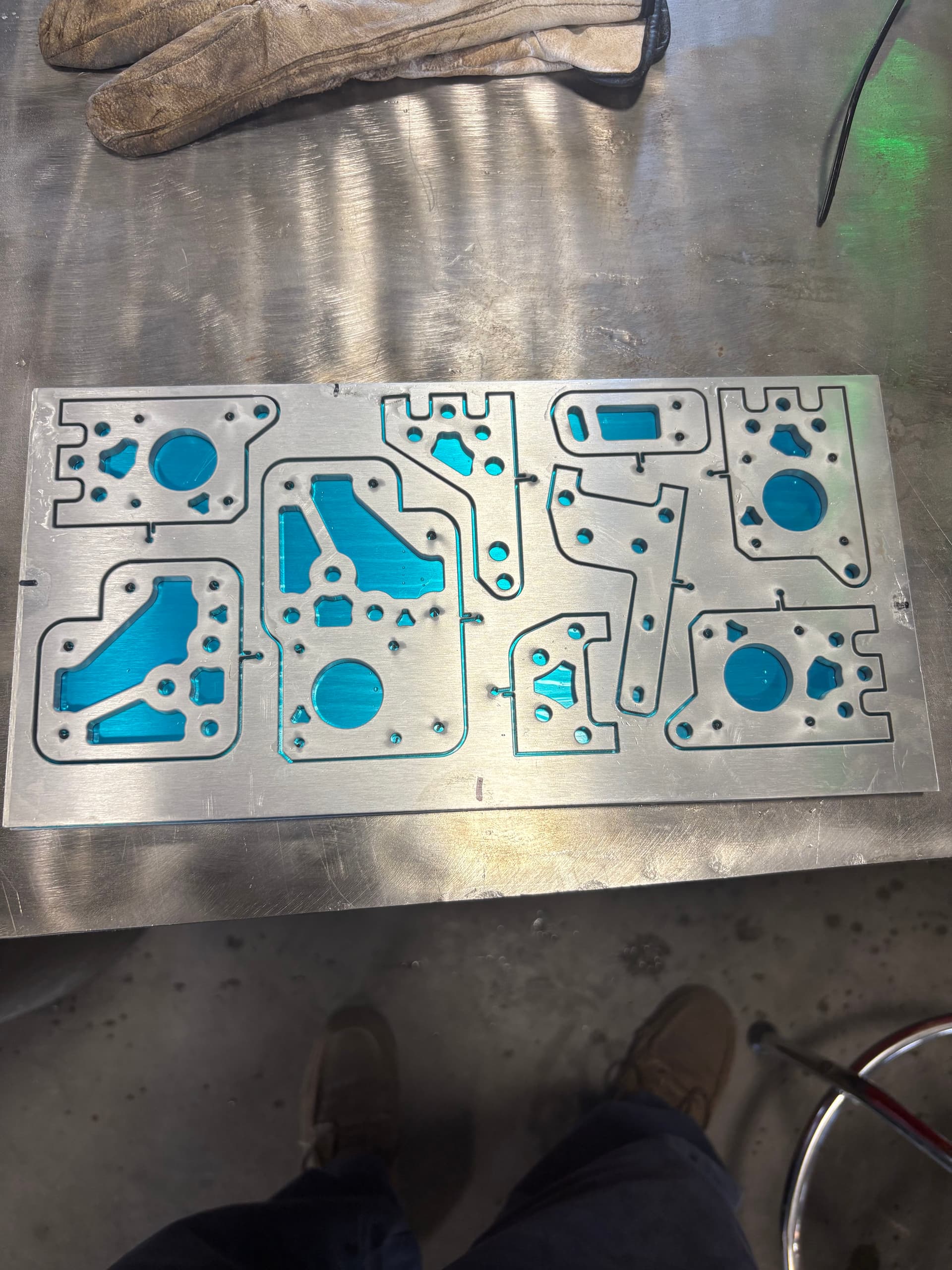

Thanks! I haven’t used my MPCNC in so long and didn’t feel like dealing with the mess of cutting aluminum on it. Luckily, I have a waterjet at work that I manage so I just threw this into production.

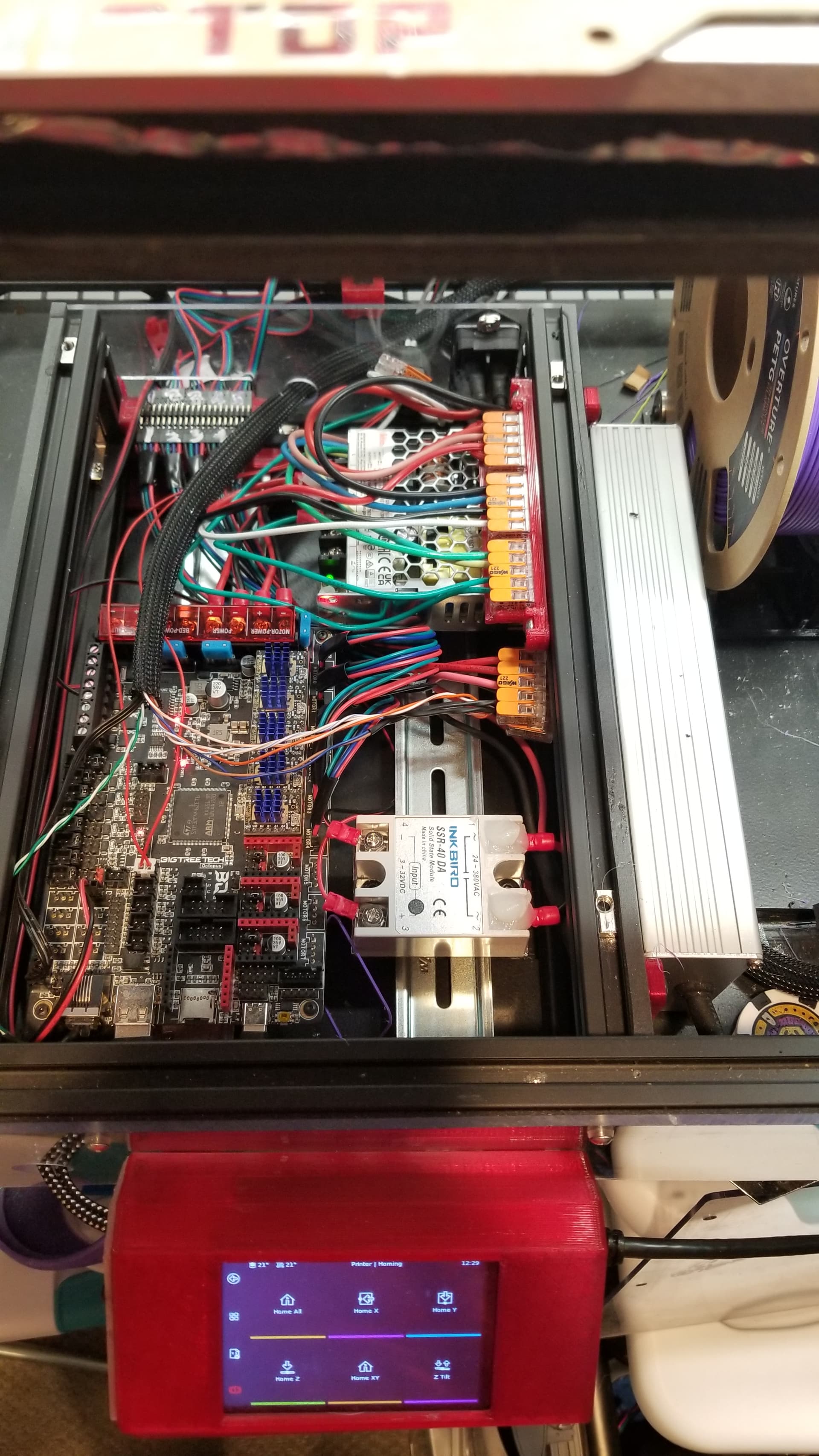

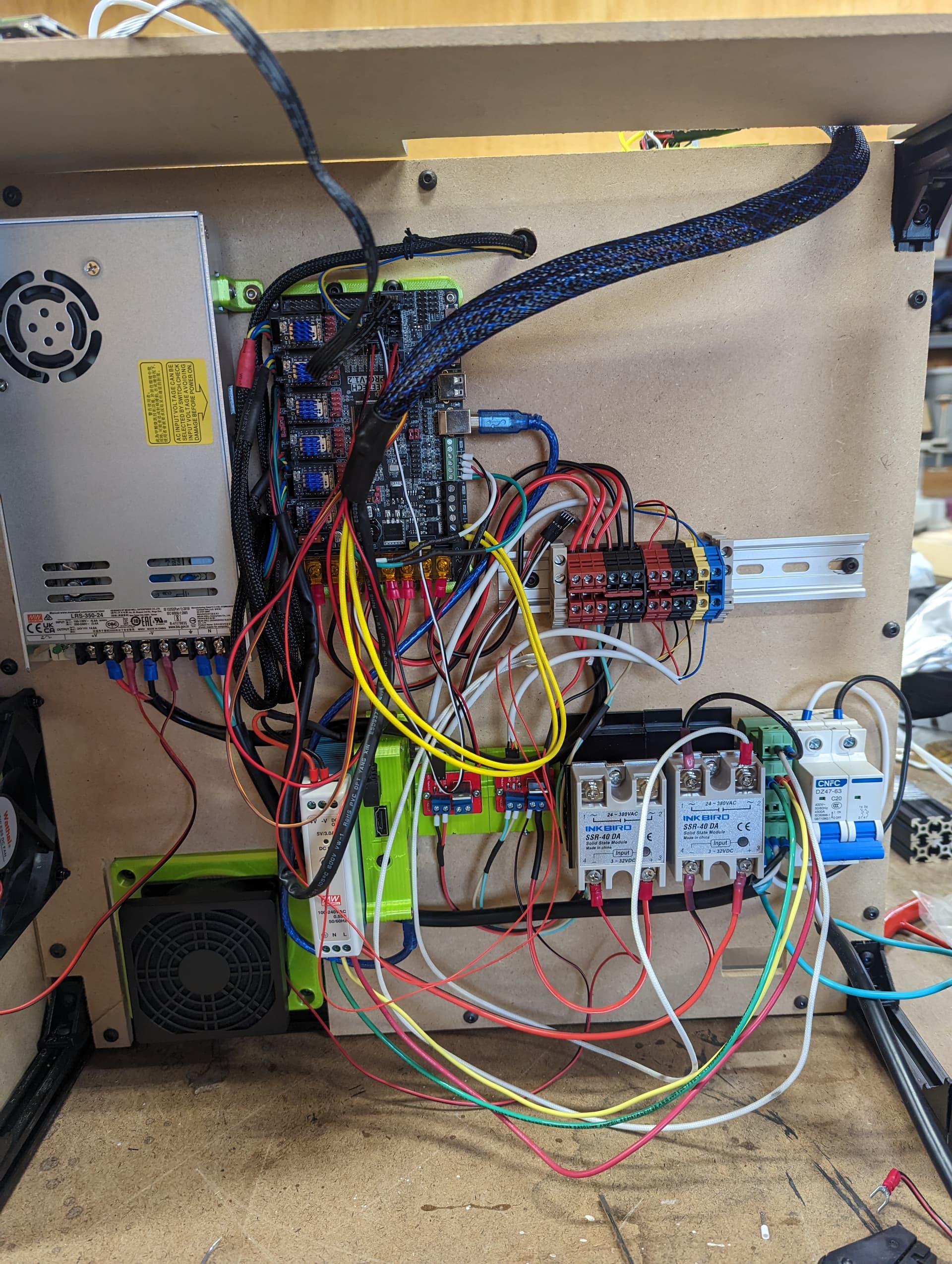

I went crazy on my V4 build and used DIN rails for everything. I used the Dinkle power distribution jacks. I have breakers in line with the heated AC bed so that if something shorts, it’ll trip the breaker.
Everything is mounted in the back of the printer in an electronics box that is an extension of the main printer frame rails.
This makes it look messy, but it’s because all my wires are still long and I was testing out. I have plans to replace the Pi and controller with a klipper setup and plan on cleaning up the wiring then.

I think components and terminal blocks on DIN rails in enclosures and sub-enclosures is a great way to build and maintain a machine.
