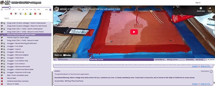

Curious where @Jonathjon and others fastened their thermal fuse?
Used solder butt connectors, HVAC Alu tape and silicone adhesive to securely wire up the Thermal fuse…

I put mine on the back bed screw. I used a shorter spacer there. I have it touching the aluminum from the bed.

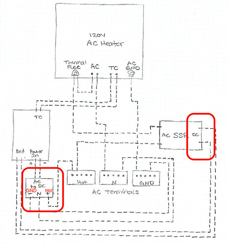

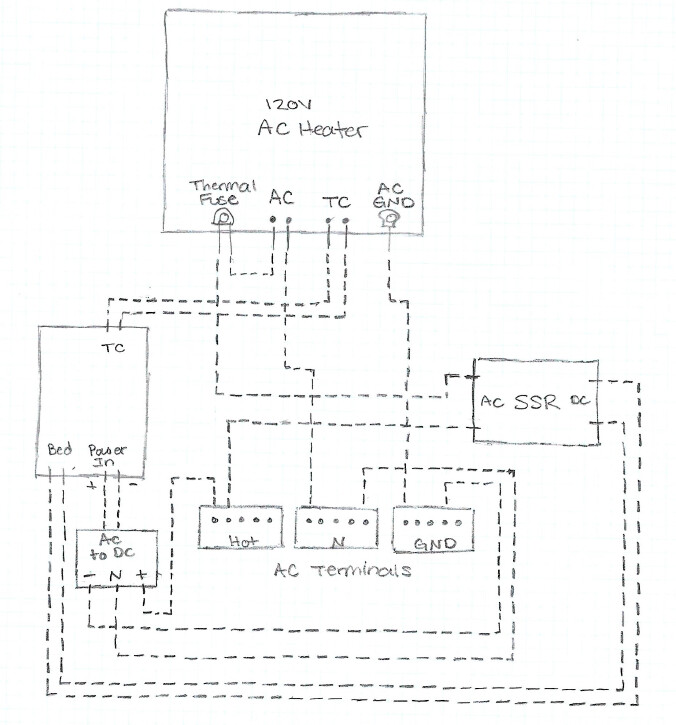

I drew up the wiring for the bed because it helps me visual it. Really not as complicated as I thought. Can someone confirm this is correct before I start running wires?
I’d fix your nomenclture. AC is Line (Hot), Neutral, and Ground. Everywhere, always.
Also, the SSR and your controller likely have +/- dependancies, so make sure you’re connecting those correctly. What SSR are you using?
You should also show your power cord and power switch/fuse for the AC inlet.
Yeah I just put the +/- on the power supply on the AC side because I was lazy and didn’t want to squeeze in GND and Hot lol. But the terminals are labeled Hot, N, GND.
Yeah I also didn’t show the AC power in due to laziness plus I am confident on how to wire that in. I will be using the Rocker Switch that I posted earlier, which I have wired up on numerous other projects before already. That has a fuse in it so I should be good there.
Most of what is new to me is everything after the AC Terminals. So I just drew up everything after that point.
