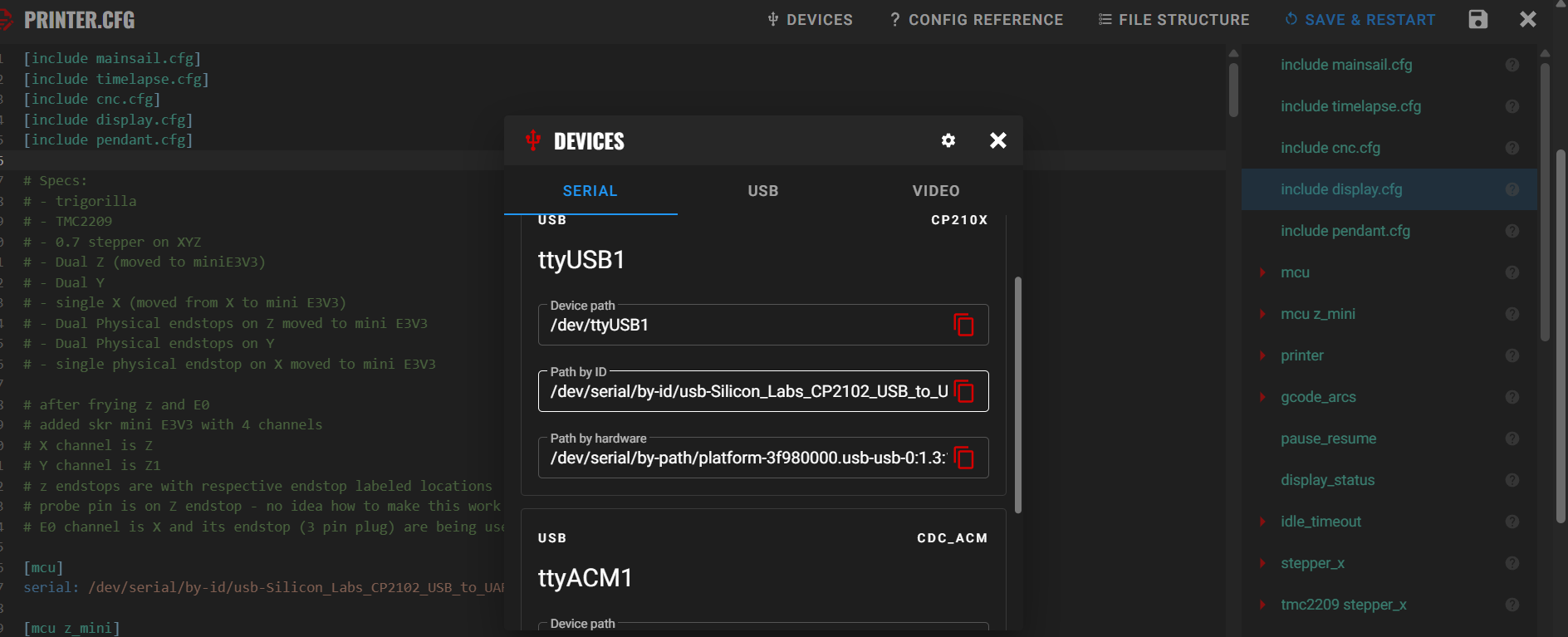

Now I am in the process of setting up my V5 with Klipper. I am going through all the same steps, however, I am getting an issue here.
Once I go through KIAUH and obtain my MCU ID. I copy and paste it into this line here and hit “save and restart”.
Then this is the response I get and then after 5 seconds or so the Pi seems to restart itself completely. My PuTTy connection is lost and everything.
So once it reboots, I check my printer.config file again and the MCU ID was the same as it was before. It never saved. For some reason it is not liking me updating that MCU ID…

couple things: should be no need to use kiauh to get the device ID. In mainsail, when you edit the file, you should be able to click on the usb symbol device tab at the top near the center of the page to see the usb device id:
then click copy at the right of the by id and close that window and paste it right in.
second. you can save without restarting by hitting the disk icon next to the X instead of save and restart. Then reopen the file to verify it has saved. then add a space or make some other nonessential change and save and restart or just restart it manually to get the change.

I tried it this way and it seemed to have worked. I am now connected and operational. It oddly took a few minutes for my Pi to reconnect after the restart, but maybe that was my wifi being slow. It ended up connecting after all.
