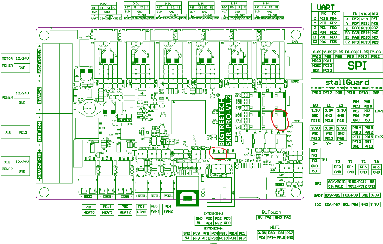

On the topic or SD cards, I can remove the SD card from the SKR Pro once the firmware.bin has been flashed, correct? It doesn’t need the SD in it to function?

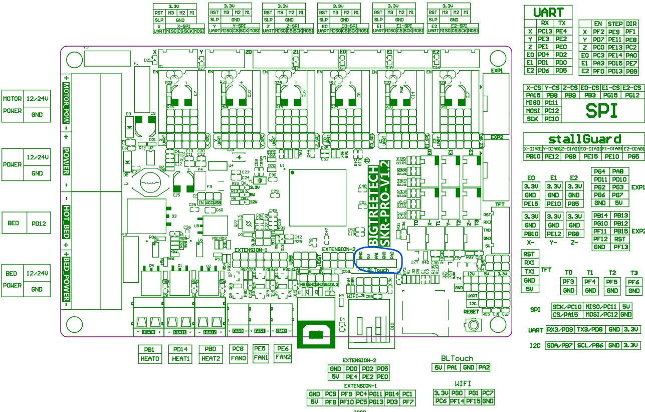

Also, while waiting for the new Pi, I want to double check my wiring is correct for the MicroProbe. For the BLTouch, I used the pins in RED below:
However, for the MicroProbe, I have read that I need to only use the pins in BLUE instead:
Something to do with pullup resistors and stuff that I am not familiar with…
Which one is correct for the Microprobe, or does it matter?
I used the blue ones. You specify pullup in the config with a ^ before the pin name. Just be sure you get the correct sense pin assigned.

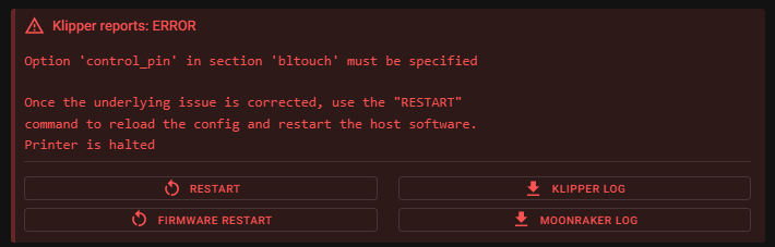

Okay…. more unusualness. New RaspPi 4, new microSD. New install of Klipper. New firmware flashing to the SKR Pro.
I have commented out the BLTouch lines of code from my printer.cfg file. I have replaced all of that with @Michael_Melancon configuration for the BIQU MicroProbe below.
Someone tell me why the heck it is giving me the below error??? I don’t even have anything referencing BLTouch in my config file anymore. If I go into my config file and ctrl+f to search for bltouch, it doesn’t exist. So how am I supposed to edit it? Makes no sense to me.
Can you zip and upload your current printer.cfg?
If you copied Mikes exactly then I have a good idea of where the problem might be
Well, since posting, I went to the bottom and found some code that was commented out for bltouch and just deleted it all together. No idea why it was reading it if it was commented out…
