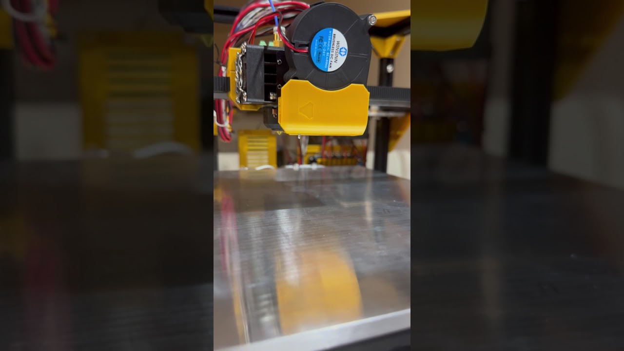

Well idk then. Is it triggering it the first time then backing off 5mm before it crashes?
I have a video. Can I embed it somehow or should I go the ol’ Youtube route?

Just looks like it still thinks it’s triggered even after it pulls off
PROBE ISSUES RESOLVED!
By the power of Grok AI, I found that adding “homing_retract_dist: 10” to my [stepper z] section fixed my problem. The issue was that the probe was triggered and then tried to probe again before ever moving away. So it just stayed triggered the whole time until failure.
So the retract section in the probe section did nothing. That’s some :poop:
