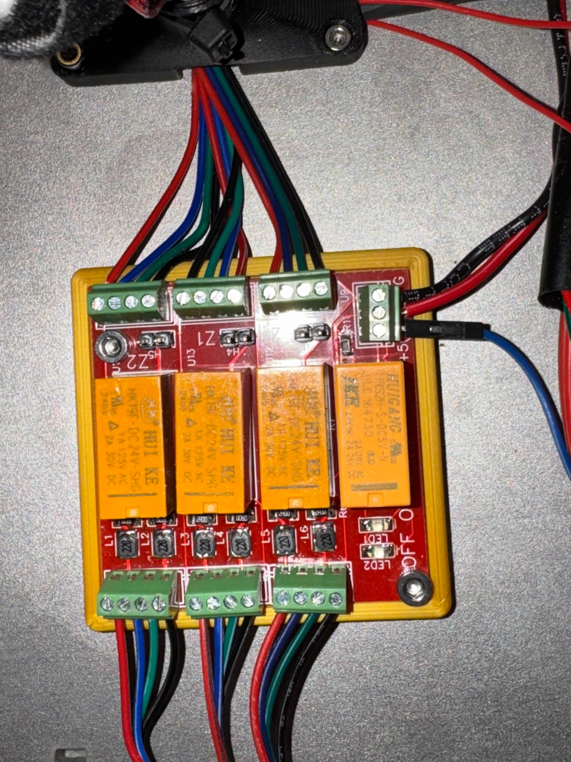

Any guidance on setting up the Z Brakes as far as wiring and Klipper config goes? Is there another forum thread I should reference?
You need a 5v high signal from your board to flip the relay that isnt pulled up on boot or it will always keep the brakes off when the board powers up. You may need to test. Red led is brake applied. Green led is good to operate. You will hear it flip. I believe the snippet shared above has the multipin use example. The z brake must be off before enabling the z motors. Since homing is typically x first, i multipin the z brake with x enable so when x is powered the brakes turn off and then when z homes the 2209 doesn’t get confused. If you do it wrong klipper will fault and say z motor short detected, but it wont cook anything… At least in all my z brake testing i never fried one.
Okay so I have added in the Z brakes. I have 24v coming in and I have a 5V high coming in. When I switch the printer on, I hear some flipping, the red light flashes and then no LEDs are on anymore. No red or green
  1. remember svg for the power and signal connections left to right (see board diagram below)
    S = signal from 5V line. if your board only does 3.3V, then you may need a relay to switch 5V to the 5V relay coil
    V = 24V motor drive voltage. If those have power, then these relays will have power
    G = ground.
Verify your board is labeled like this:
  1. test voltage connections of the relays for proper operation
    with 24V and ground connected and powered, you should see a red LED turn on.
  2. verify 5V signal to deactivate brake. Default is BRAKE ON = red LED.
    If you apply 5V power and ground from a 5V supply, then the red light should turn off and the green light on (if 24V is connected properly). If you swapped ground and 24V, then bad things can happen and you won’t see LED at all.
Here is how I have it wired right now. I have 24V and GND straight from 24 power supply. I have 5V signal from a 5V high on the SKR Pro (pulling 5V from the 5V pin on the Extension-1 header). Of course the stepper motors are already being powered with 24V from the SKR Pro. Would it be a problem that I am providing motor power at the MCU and at the Z Brake. Should it be one or the other?
With 5V signal disconnected, I can power and I am seeing a RED light. The motors are hard to turn so I know they are shorted.
Once I connect the 5V, I hear the relays flip, the RED light goes off, but no GREEN light. The motors are now free to move.
I have now gotten everything to move as expected and am running a test print. I think I am okay, just no GREEN light…
There is a slim possibility the led is on backwards. You can test it with a multimeter set on ohm /diode testing. Disconnect all power and ground if you test the led. Try in both orientations with the red and black probe wires. If it lights up with the multimeter, It will be very dim. If it lights then you know. If it doesn’t i might have a spare i can send you if you want to swap it out.
