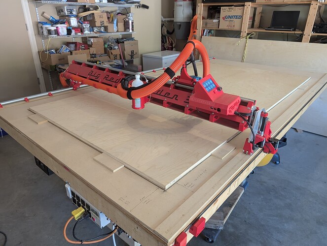

I have an LR3 that I converted to Landscape, and based on the layout of my shop, it is really better for me than Portrait. I find loading large sheets of plywood much easier along the long edge of the table, and standing along the side at the origin seems more comfortable than standing along the end at the origin. Plus it simplifies the CAD and EstlCAM layouts, with the long edge always being X rather than Y.
Here’s a few pictures of my Landscape LR3 (parked at Home):
I haven’t converted an LR4 to Landscape, but it will be simpler than doing so on an LR3, as the limit switches for X and Y already have the holes pre-designed into the print files (which has confused more than one first time builder). You may need to reverse the Y belt holders so the limit switches are where YMax is on a standard build (which now becomes XMin). Software changes are reportedly very simple on the Jackpot board.

I have a portrait machine, but I typically stand on the xmin side because that is how the space is allocated in the work space that is available - basement far distant corner. It typically doesn’t involve pieces larger than 20"x30" though, so any orientation isn’t a big deal unless it is something really dense, but that is out of scope for this machine. When the machine pauses, it can be driven to a suitable/ convenient location for bit change: no crazy long arms required. I have about 12" of extra table on the Y min side (normal operator side). Everything is oriented per usual. I never really thought about it being different, but it works. While I do have 2 feet to get to the x min if needed, the machine is tucked under some wall shelving, so it is awkward to stand at the xmin side. There is a PC on that wall at Y max, so I typically face that and may have been known to view jellyfin features during extended shop use. The extended table there for tools and other random things that are “necessary” makes it so I use it the way you propose and because that is how I set it up. Drive the gantry out of the way for load/unload. There is the Ymin belt right in front, but that is easily navigated or removed quickly with just a screwdriver if necessary. I say go for it. if you have never used one, you will learn to use it as you have it. The only wrong way is to either not use it or break it. both of those can be overcome.
I don’t find it difficult to use for workflow. Indeed, for me it is quite the opposite.
Changing bits is pretty easy, as the core is parked only a few cm from the edge of the table. I access it from the side (long edge), with the router at Home. I just take a small step to the right of the YZ plate, and it is easy to reach.
Loading material is a breeze. I slide or lift it along the long edge of the table (and of the stock), and then slide it up against a couple of wooden guide blocks that I installed so the material is right where I want it to be.
(I moved the gantry after loading the material for photo purposes)
