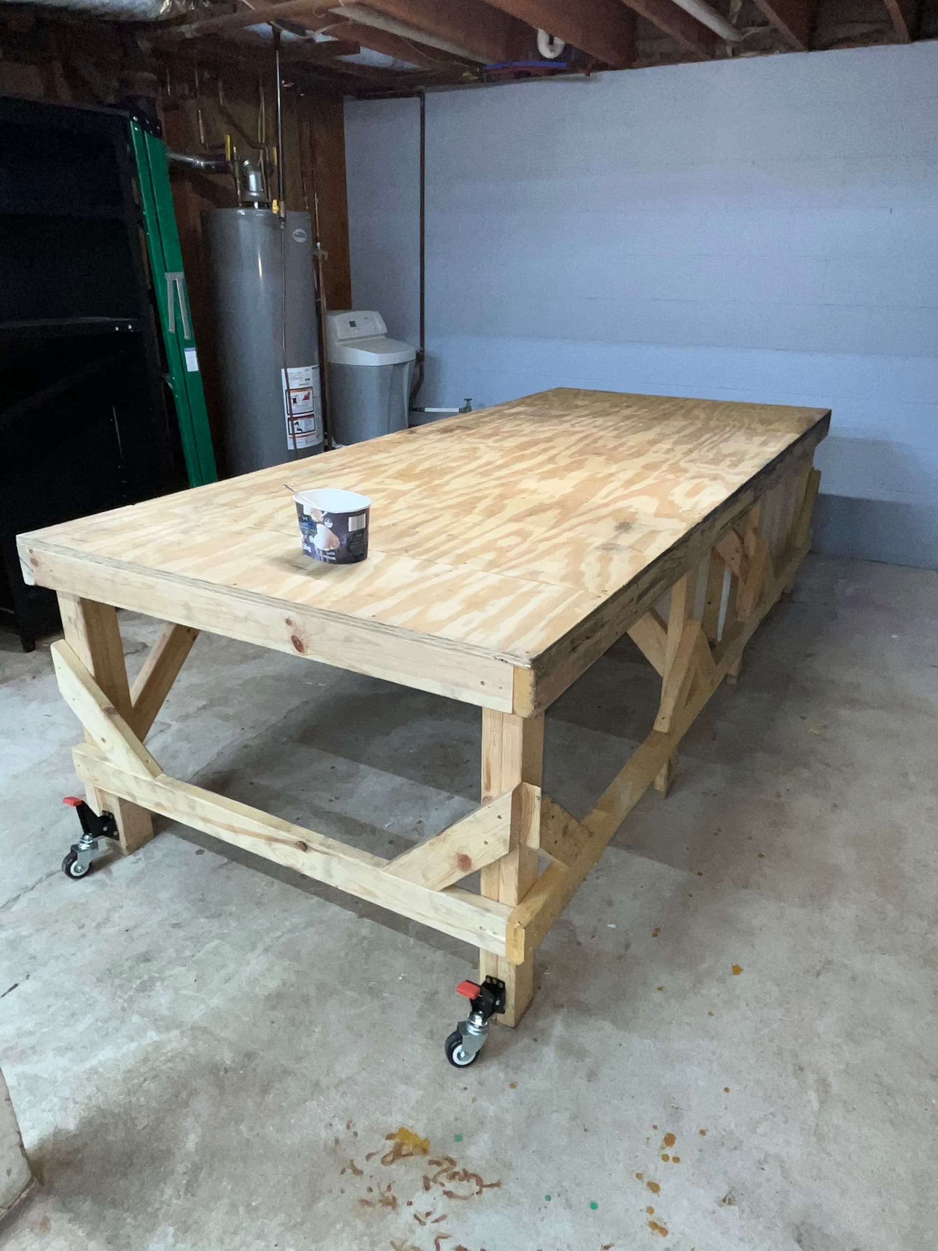

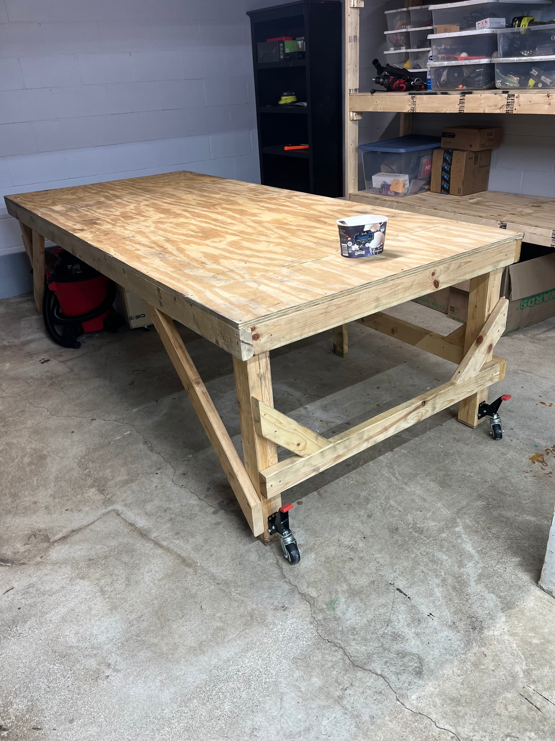

Hello! I have a table top already that I want to add super struts to a use for a 4’x8’ LR4 table. The table is 4’x9’ right now and I need to add around 12” of width so that it’s 5’x9’. See pics. Is this possible? How would you do this? Also should the top face of the superstrut be on the same plane as the spoil board? Thanks

If you’re really talking about adding 6” to each side, I feel like you could keep it simple and just add 3/4” sheet goods for the top, then another 3/4” for the spoilboard and rails. A few angle supports on the overhang would plenty suffice. In fact, if you glued them to the top and pocket screwed them to the table, you could easily remove it if you ever decided to use the table for another purpose.

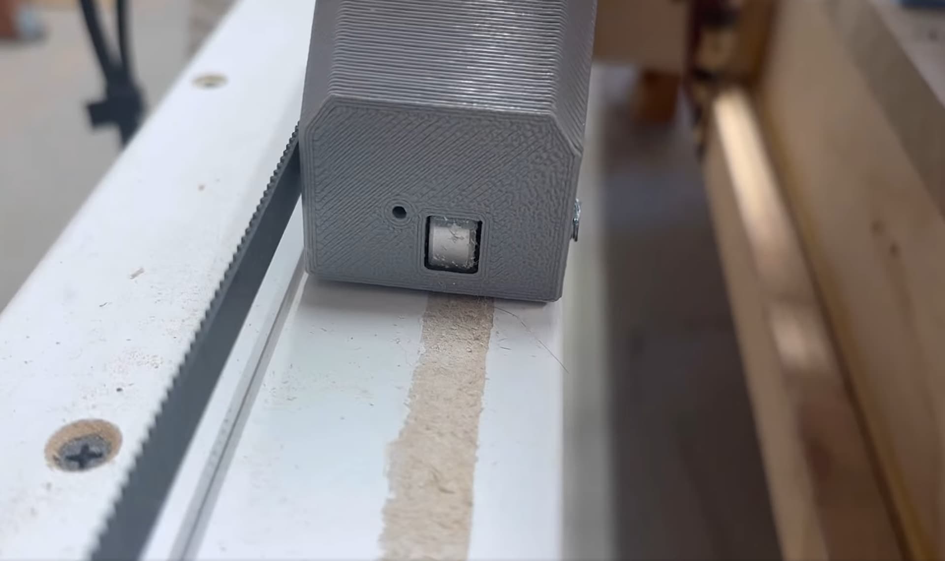

I built my (non-torsion box) table with a plywood top sheet. Within 3-5 hours of use. ruts started to develop where the roller wheels ran, especially near YMin, where most of the motion occurred. :open_mouth: That plywood (Factory Select grade) was really soft!
I threw a sheet of 3/8” MDF on top, and after many hours, there aren’t any signs of ruts or grooves.
But I agree, a metal running surface isn’t a necessity. MDF will work fine!

No, I saw this post on fb v1eng group. A guy named Peter Babagian. The wear looks much worse than even yours. I am not sure what to do. I am thinking about if some kind of brush on expoxy might work well on top of this lane of the MDF, to make it hard and hold together well.

That looks like a problem with the paint/primer on the running surface. Was it MDF or LDF?
I don’t do production work with my LR4 but don’t see any hint of erosion on simple big box 3/4 MDF elevator plates.
Don’t use a soft material for the non-rail side,which includes paint or coatings.
I think it was primed MDF. But yea I won’t use any of that in my build.
that was indeed my post and that was primed MDF… and the bearing wheels did wear a rut. I decided, when I get time, to cruise by some cabinet shops and ask for scrap formica/wilsonart, etc. all the same of course and will use contact cement to glue that down on the non-rail side. that will alleviate any grooving. that will be my temp fix as I venture to build a table entirely out of uni strut channel… why? for no other reason except it sounds like a cool project (and I loved having an erector set as a kid). Also, Although I have built the full sheet sized table, have yet to cut a full sheet of anything. The new table will accommodate 48” x 60” or there abouts and be quite mobile with locking 5” swivel casters. I will keep the larger table top on hand in the event I need it, but if not used by end of year… it will be recycled. :slight_smile:
