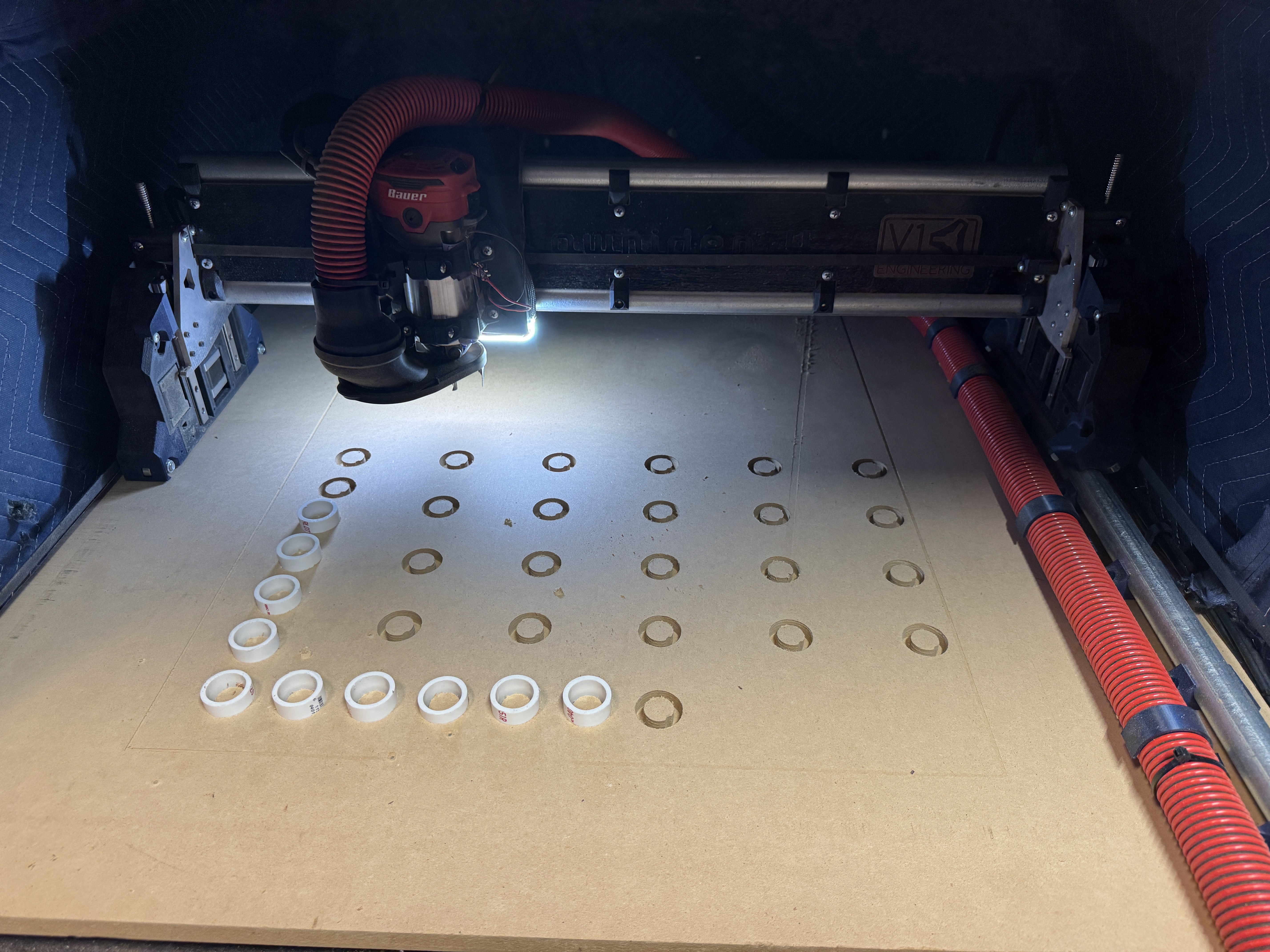

Decided to change up the spoil board a bit, and went for the “pvc fence” method. I had seen a few YouTube videos with people using this, and it seems to provide several benefits, so I gave it a shot. I previously would just screw down my workpiece to the spoil board, but that doesn’t work if you are surfacing the entire piece. So far it has worked great on the few pieces I have milled with it. I plan on making some hardwood wedges that will be able to push up on the workpiece and keep it snug. Curious is anyone else has done something similar on their lowrider, and any tips for using it?
