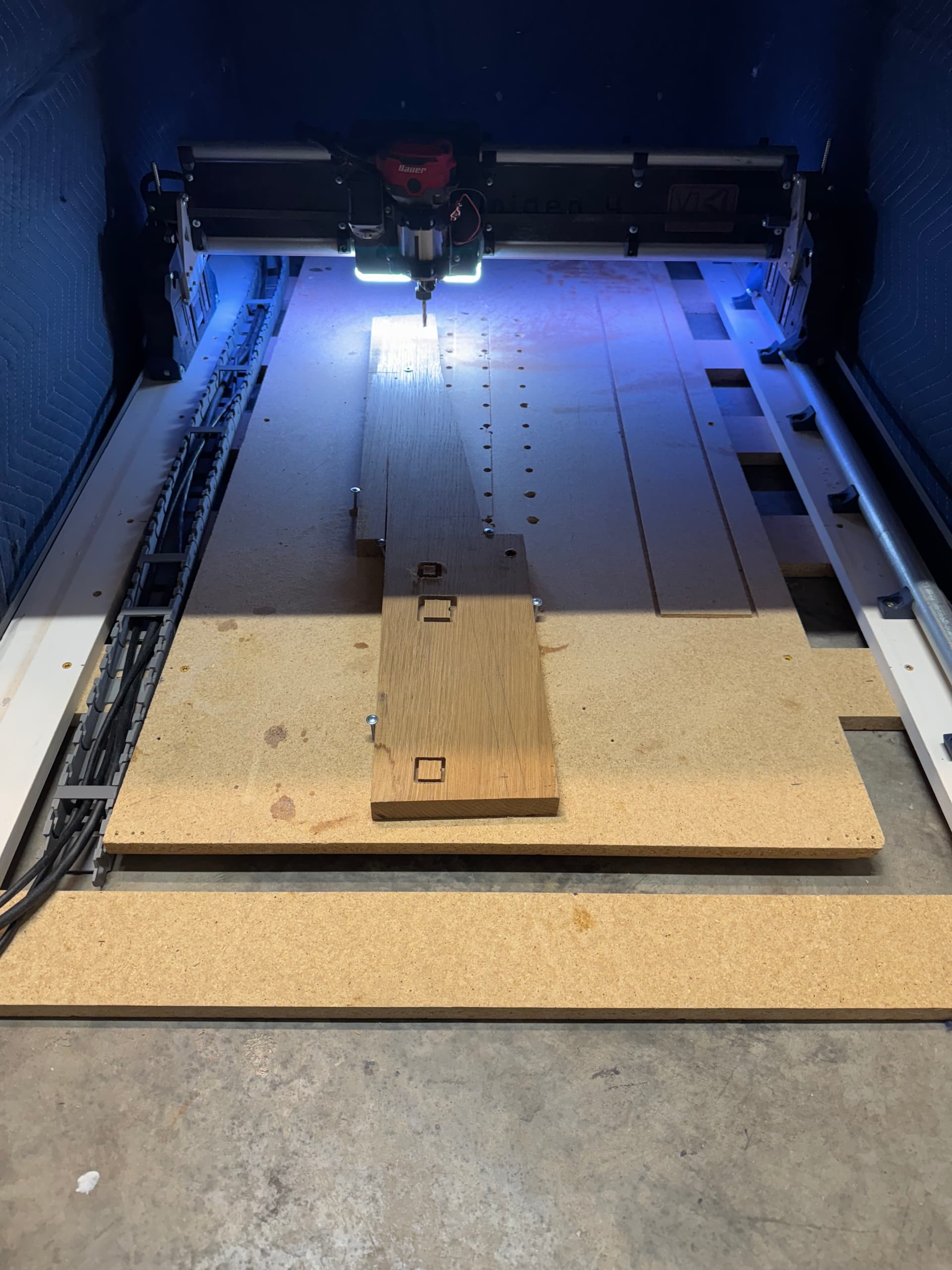

So I decided to take apart my enclosure and try something different. I currently just have the LR4 on its Mdf sheet laying on the concrete floor of my garage, and the noise level is significantly lower. I also made a plywood box around it, that does not actually touch it, and now when running a cut it is about as loud as a fan/AC, which is great.
Given that it is essentially the setup most users term “the bootstrap” phase, I was wondering if anyone had ideas for a more permanent version of this. I enjoy having the machine on just a single sheet so I can lay it on the floor wherever I need it, flip it up vertical for storage, or put it on a table. Are there any downsides to having the machine only mounted to a single sheet rather than having it mounted on a table?

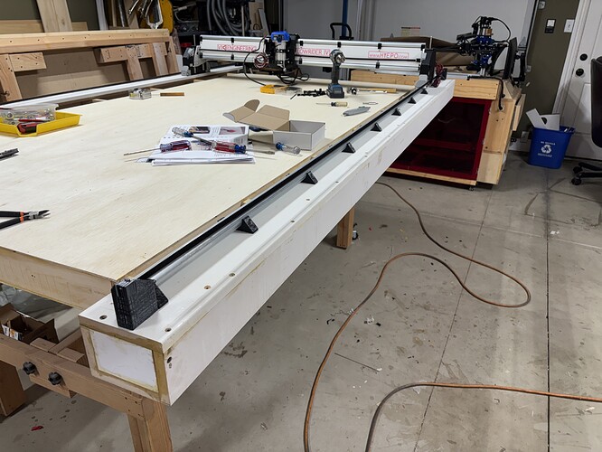

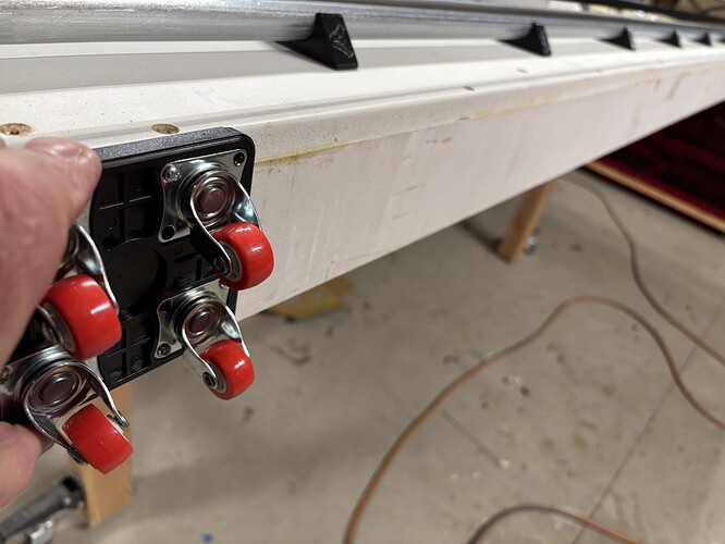

I built a facsimile of a combo of Doug’s and Ryan’s torsion box tabletop… with the intent of being able to store it on long edge. I have the top off the ground on another mobile workbench and have not attempted to slide it off onto its side (rail side) which also will have swivel wheels so I can move it around easily. I guess when I actually mount the swivel wheels and slip it off will I know how well it works. :slight_smile:
(got these off temu pretty cheap)
I’ll advise some sort of latching mechanism so it latches to the mobile workbench securely but right now it’s just sitting there

Well once again made some changes to my LR4 setup, :rofl:. Seems like I spend more time working on the actual machine than using it. As I stated in a previous post, I took apart my enclosure and built a new one that “slides” over my LR4 while it sits on the ground. So far this has worked out pretty well. The noise is much quieter as the vibrations are transferred to the concrete floor of my garage. I built a somewhat temporary setup with MDF runners attached to the white MDF baseboards that hold the y rail and y belts. While this setup works great, it can be a strain at times having to always lean over/ be on my hands and knees. I am considering getting “horse stall matting”/rubber matting like this
https://www.tractorsupply.com/tsc/product/4-ft-x-6-ft-x-3-4-in-thick-rubber-stall-mat?srsltid=AfmBOorHrcWqrM2W-y3ID2Ab4XchNmVwusux8U0Xg44y8koctkRRl4vj
or something similar to this to lay under my LR4 when it is on a table in an attempt to keep the vibrations low. I have a hard time thinking it would allow the vibrations to come through as it is 3/4in of solid rubber. Was wondering if anyone has an experience with this type of material not only for CNC work but just in general. If I do end up getting some I will let everyone know how it works.

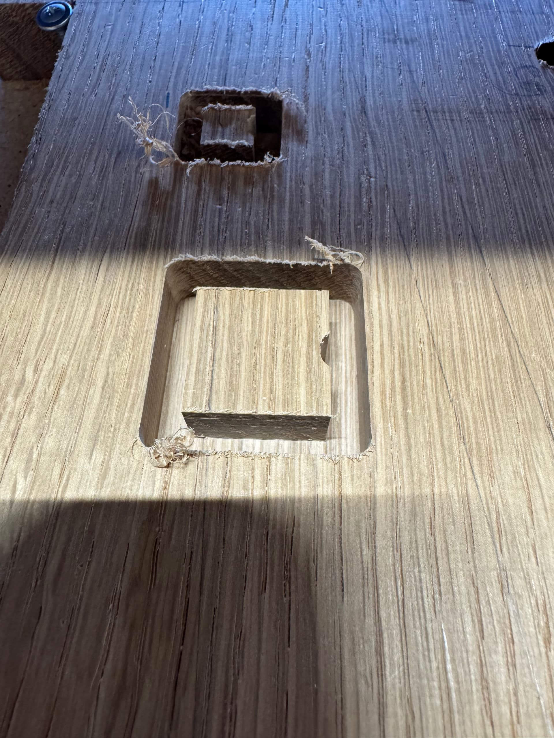

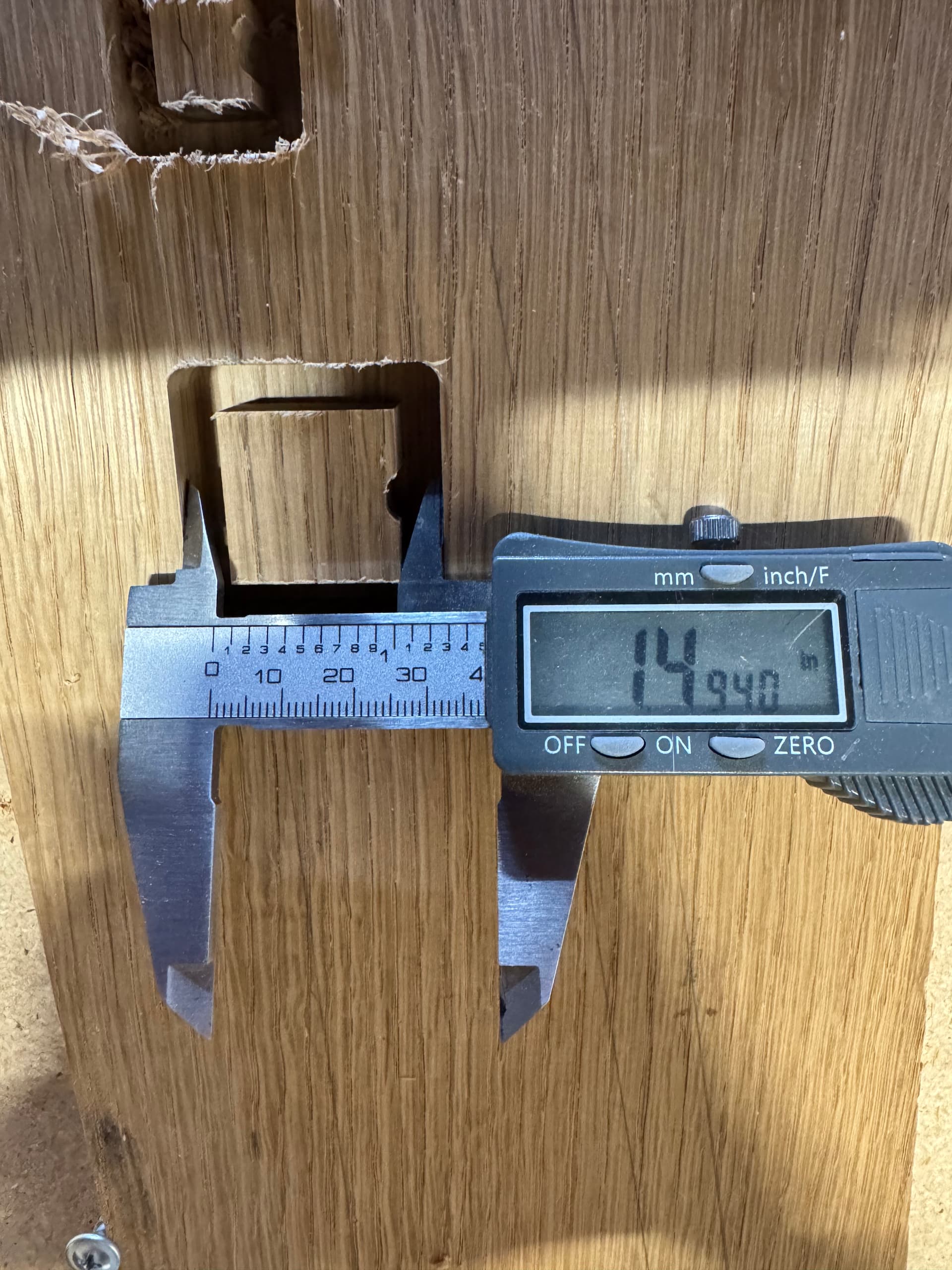

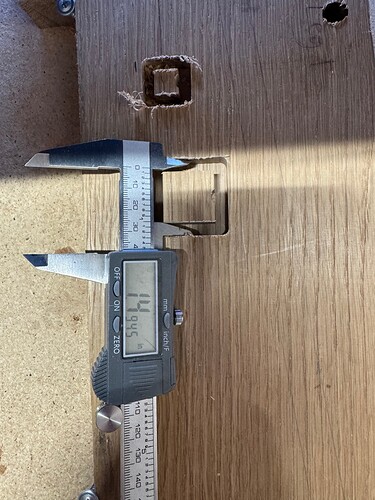

I cut out some test squares in white oak, which is a fairly hard wood, and I got pretty dang close to the expected 1.5in. Not perfect, but honestly more than good enough for my use case.
