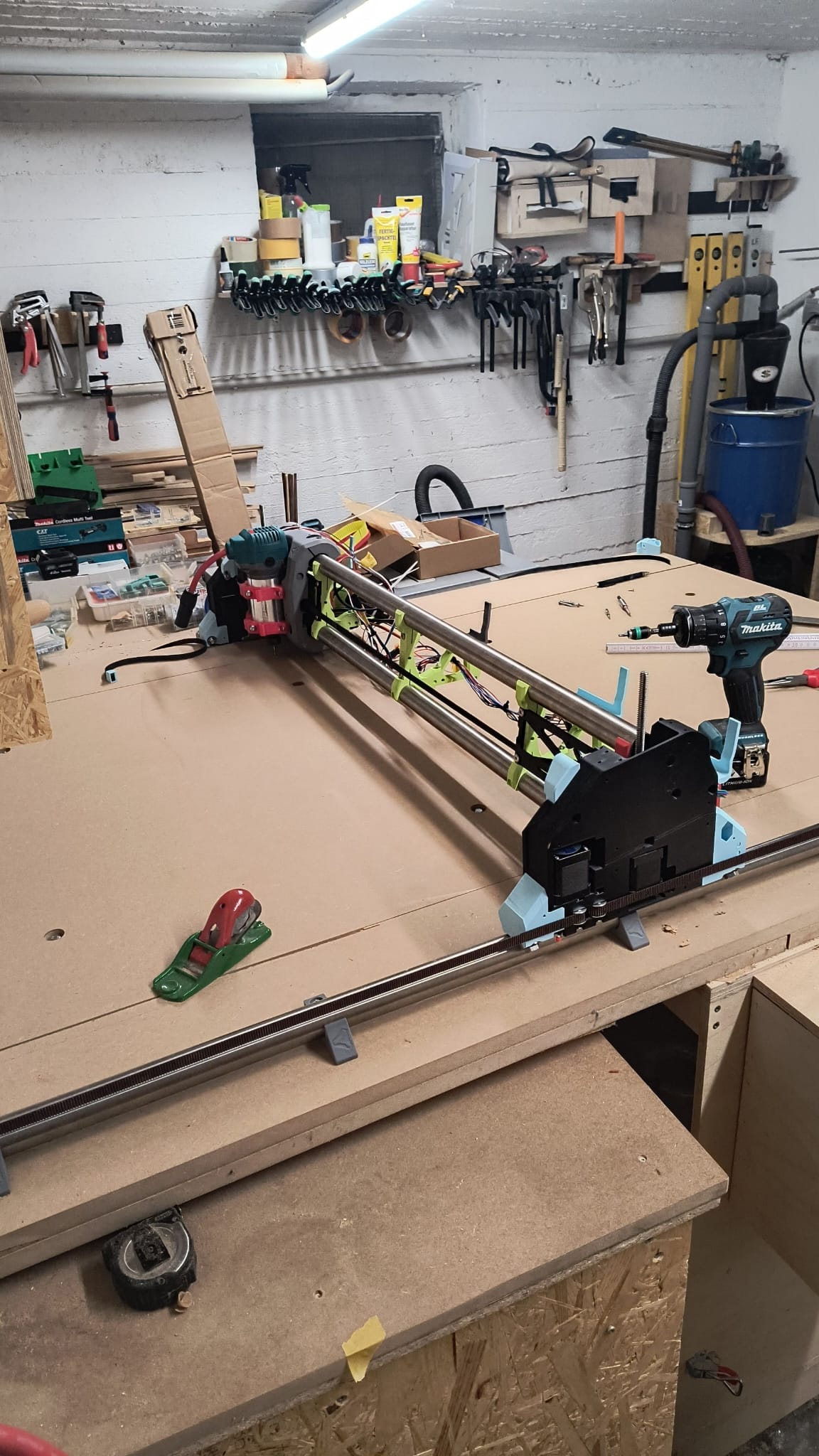

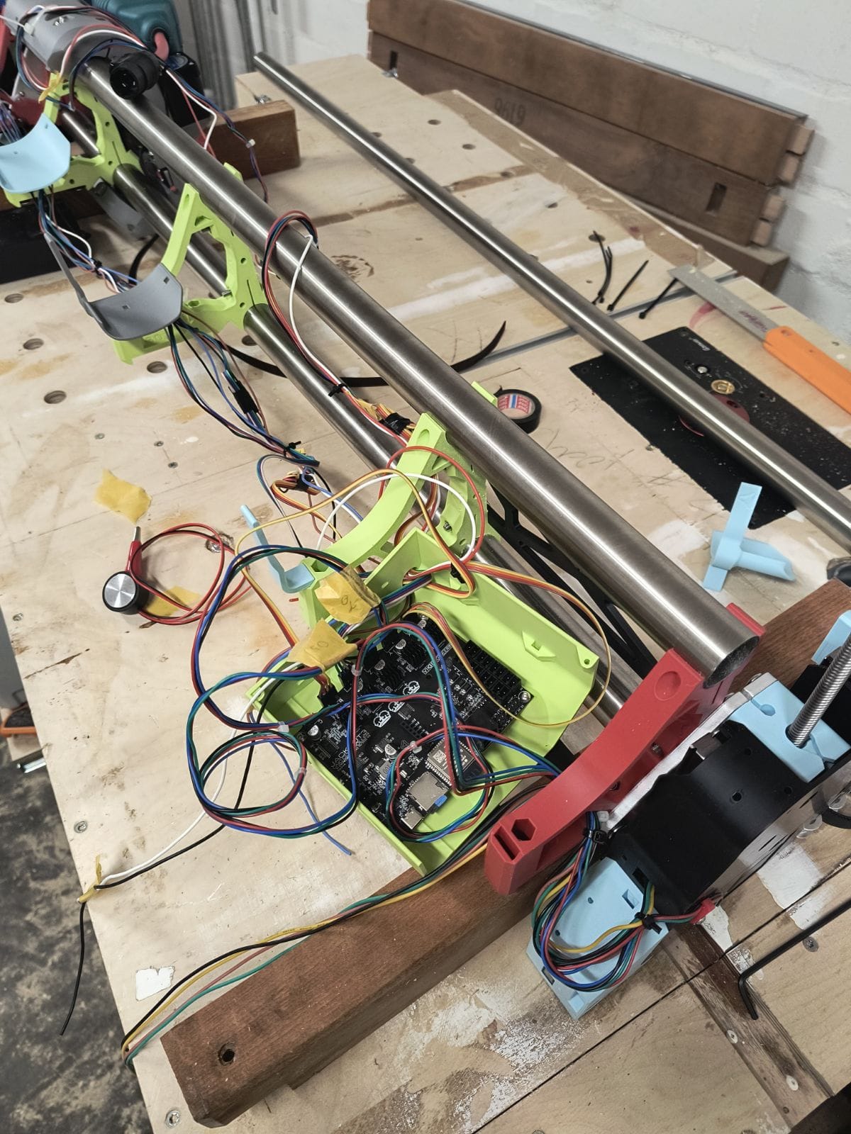

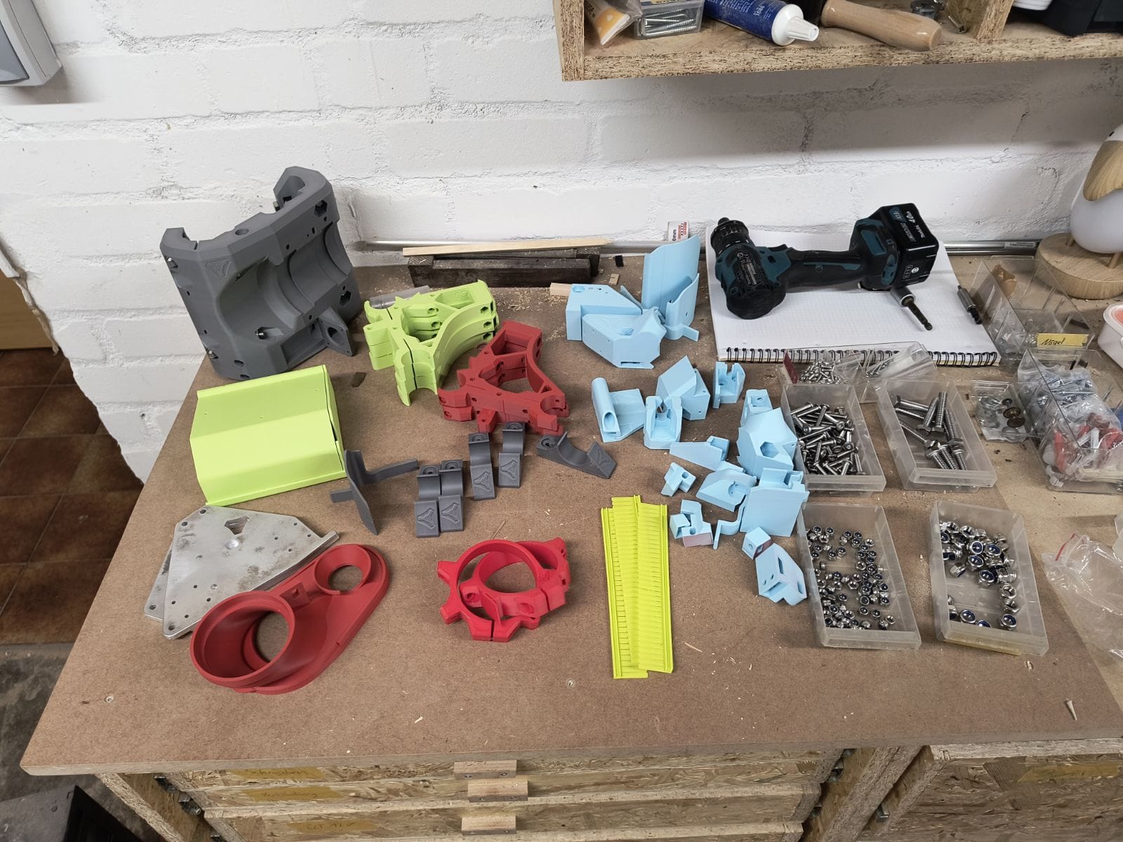

Okay, before taking it apart again i want to write aa short summary about my LR4 build. I decieded to build a CNC at the beginning of december and started printing with every PLA I had laying around hence the name
A friend hat to print the big parts, because my A1 mini only supports up to 180mm² after i got those parts on the 22n of dezember I started building.
Not much progress between the 24th and 1st. But after that i got around and finished everything

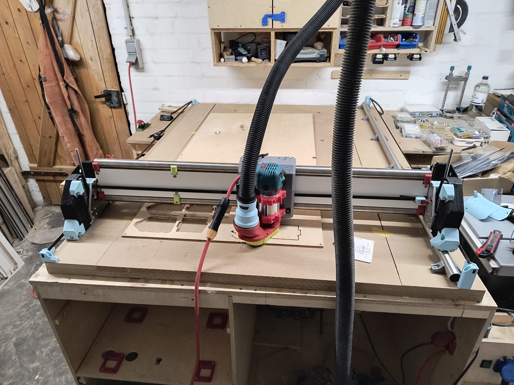

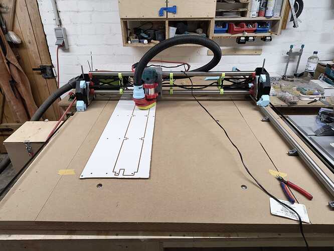

After building a Base for it out of 2 sheets of 18mm MDF I got everything mounted and my first movement. I got it squared to the best of my abilities and went into Gcode generation. After sorting some things out with my Gcode and getting really frustrated with Fusion360 I found out that the Lowrider is not really supported in the free version. So i switched to EstlCAM and got my first result. No crown, straight to 12mm MDF
Next stop Strut plates. After cutting the first two 4cm short i realized, that I built the Machine bigger than anticipated because I went with 1000mm and 1500mm stainless steel tubing. But the 2nd pair looks like it is gonna fit. I will find out in the next days.
1/8” 2 Flute Downcut, 1440mm/min Feedrate, 3mm DOC, Setting 3 on my Katsu. After installing the strutplates, what would be the next thing to increase to find the limits? DOC or Feedrate?
Also if anyone in nothern Germany needs a pair of strut plates:-D
Al in all I spend about 10-12 hours from first screw to first cut I would say. Next up is installing the strut plates, leveling Z and then source some affordable 18mm plywood in germany to build a workbench. Birchply (Multiplex) is >60€/m²…:-/
Some things about the build:
The instructions are very good vor the most part. When installing the steppers it would have been nice to know that you should route the Z-Stepper cable first bevor it says you need to route the Endstops and y-Steppers
Tablesize, is stated in the calculator, but onmly the outer dimensions, it would be nice if the inner dimensions would be stated or how wide the runners on the side should be at least
And lastly i think it is never explicitly stated that the ymin and ymax assemblys are identicaal and need to be built paralle. I figured that out after beeing half way through my first part.

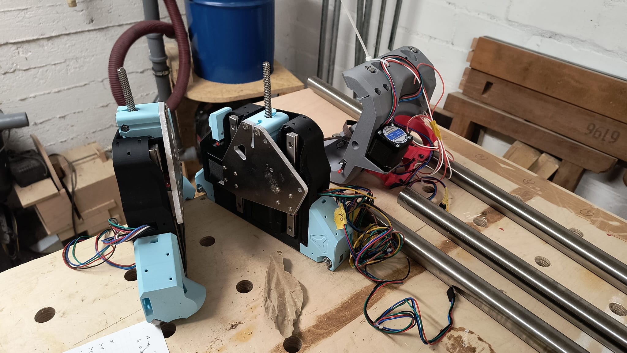

so after taking everything apart again to instal the strut plates

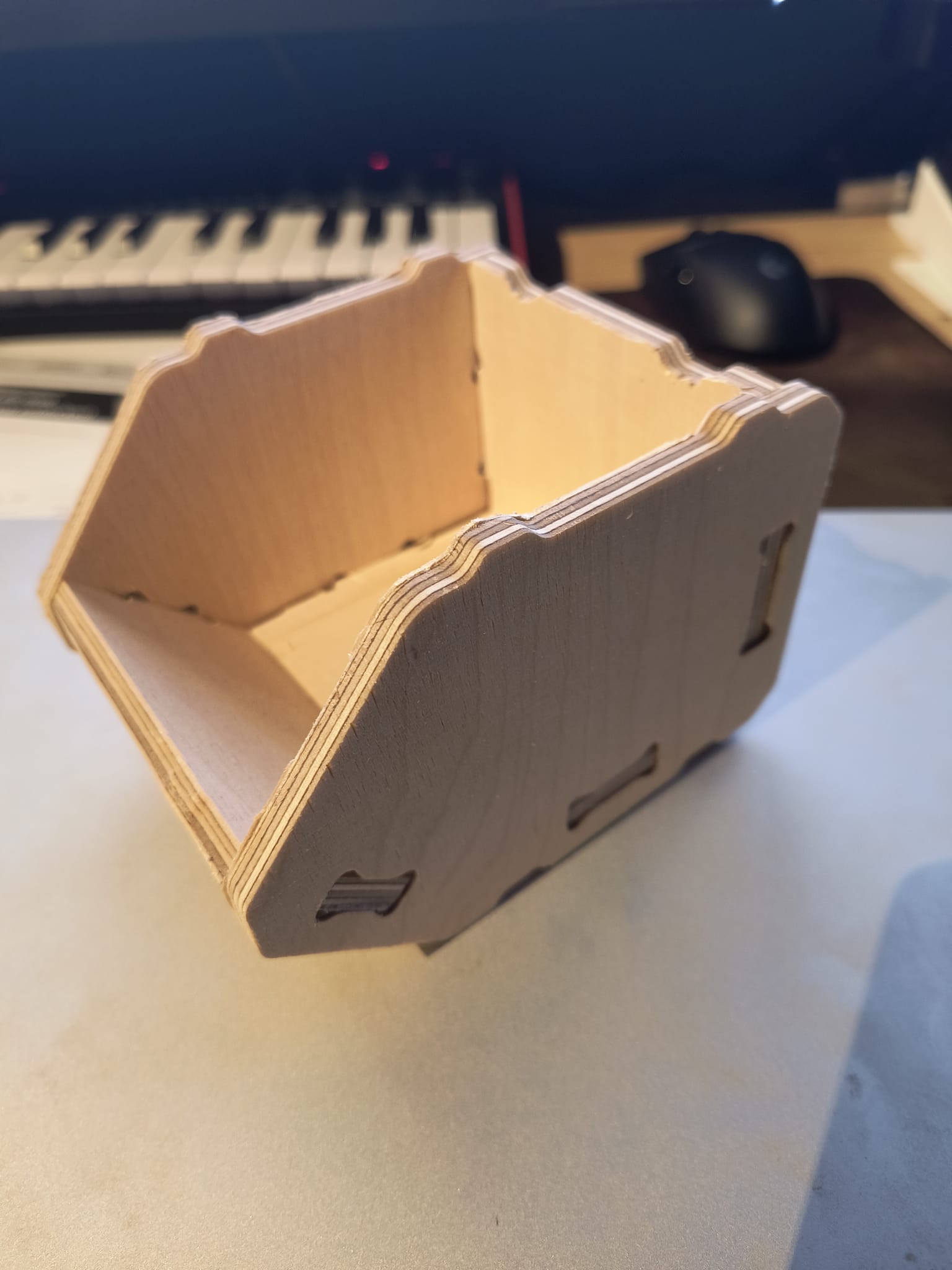

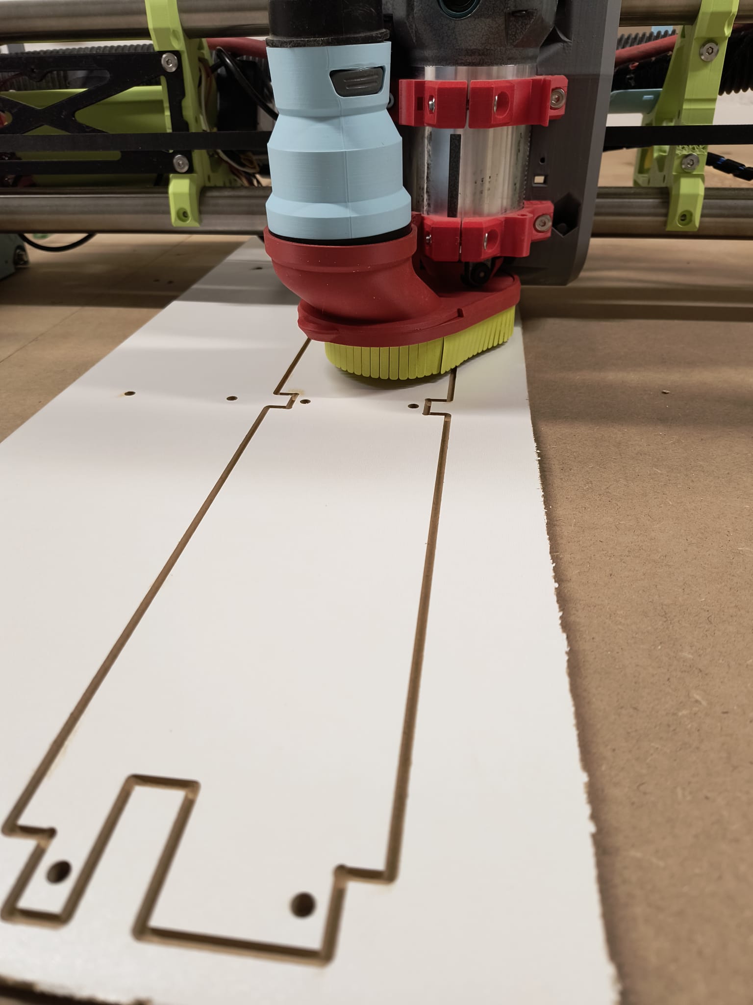

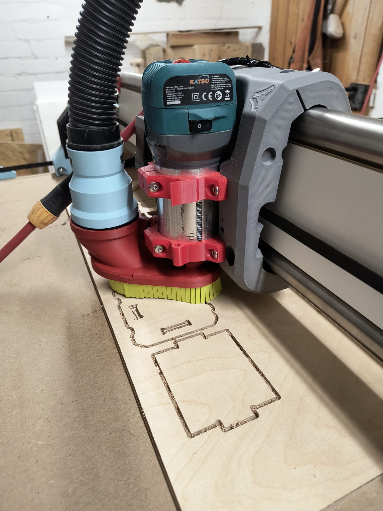

first cuts in 6mm plywood. 1/8” downcut, 6.1mm DOC at 1500mm/min. I think I can work with that for the time beeing.
What would be some good test to test dimenional accuracy? Like the Cube in 3D printing or something like that.
If the tabs fit (and it seems they do) it’s a pretty good indicator that the cut isn’t too bad. :slight_smile: I had to hammer in the first ones because the slots were too narrow because of deflection. Yours looks pretty good. :slight_smile:

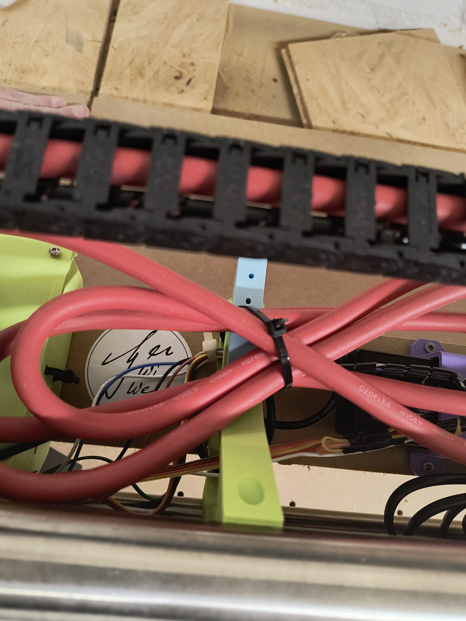

Hey, one more question, when you turn the machine off, my Gantry goes down because the unpowered motors do not offer any resistance. At the moment I put woodblocks under the gantry and then turn the machine off, so it resets on the wood
Do you have more elegant solutions?
No. :slightly_smiling_face: It’s a good sign they are dropping though.
Some people have stop blocks on top of the sideplates. Should be able to find them on printables.

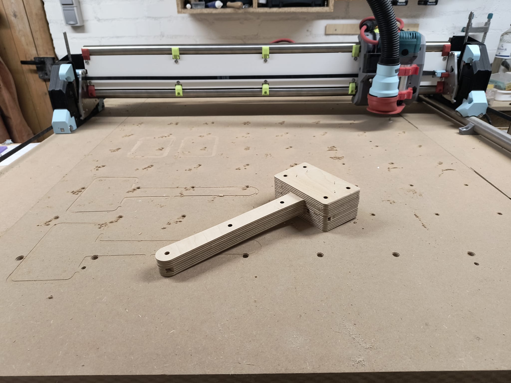

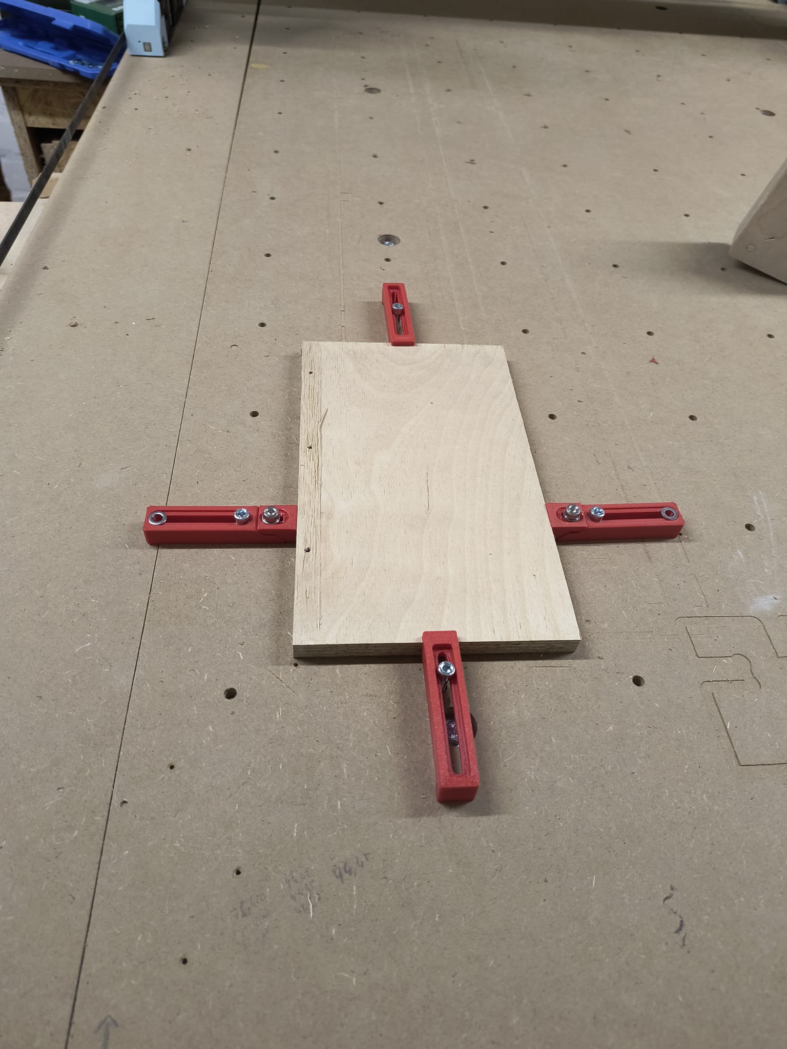

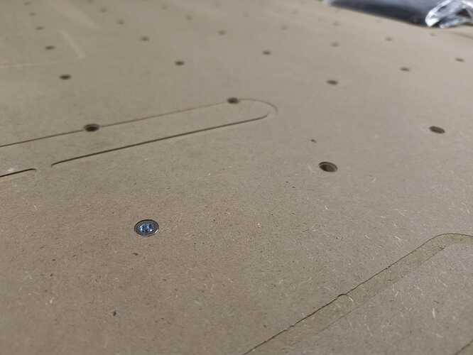

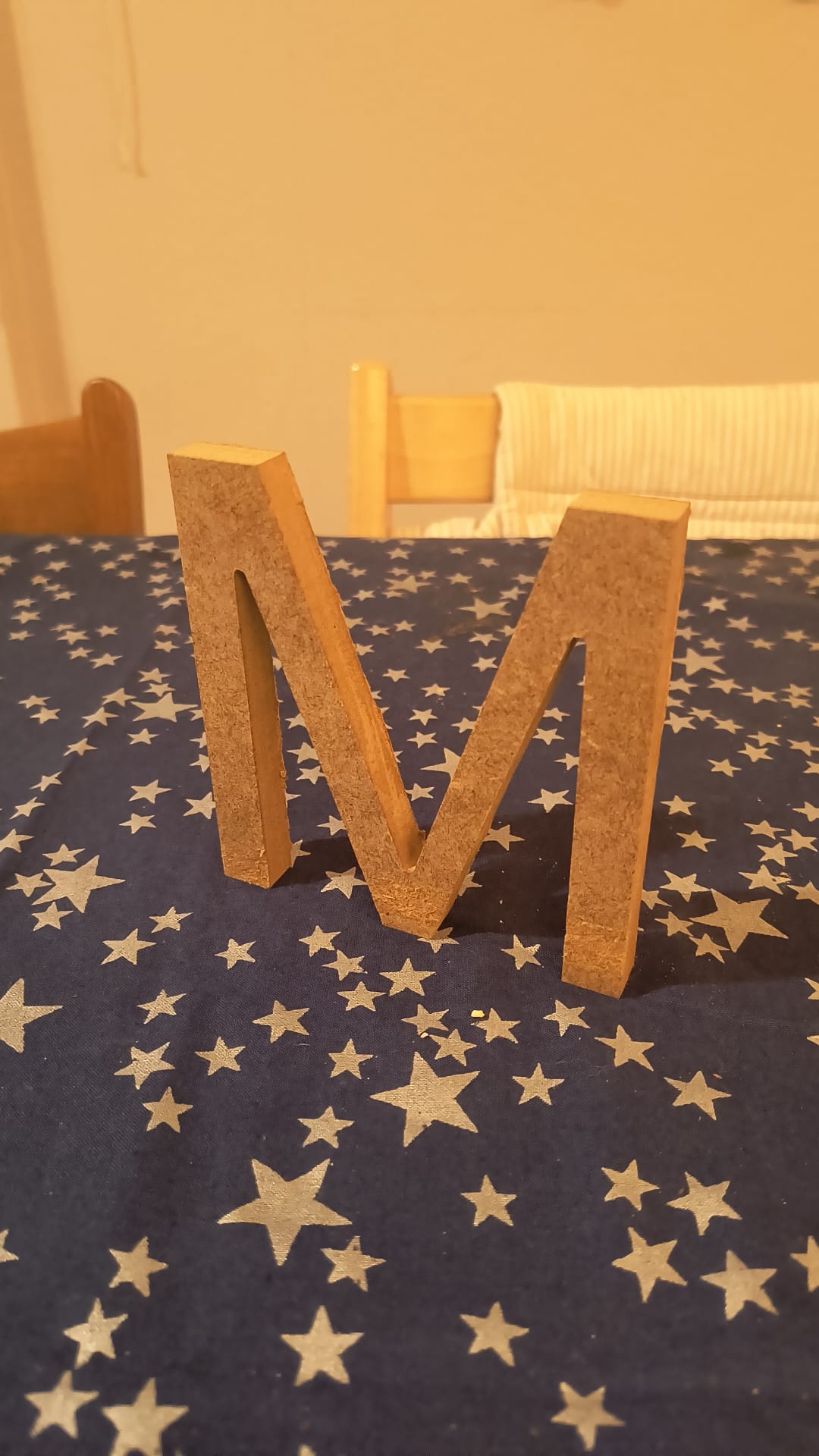

Okay, I think I’m done. Yesterday i cut 96 holes in my wasteboard from the back and installed threaded inserts

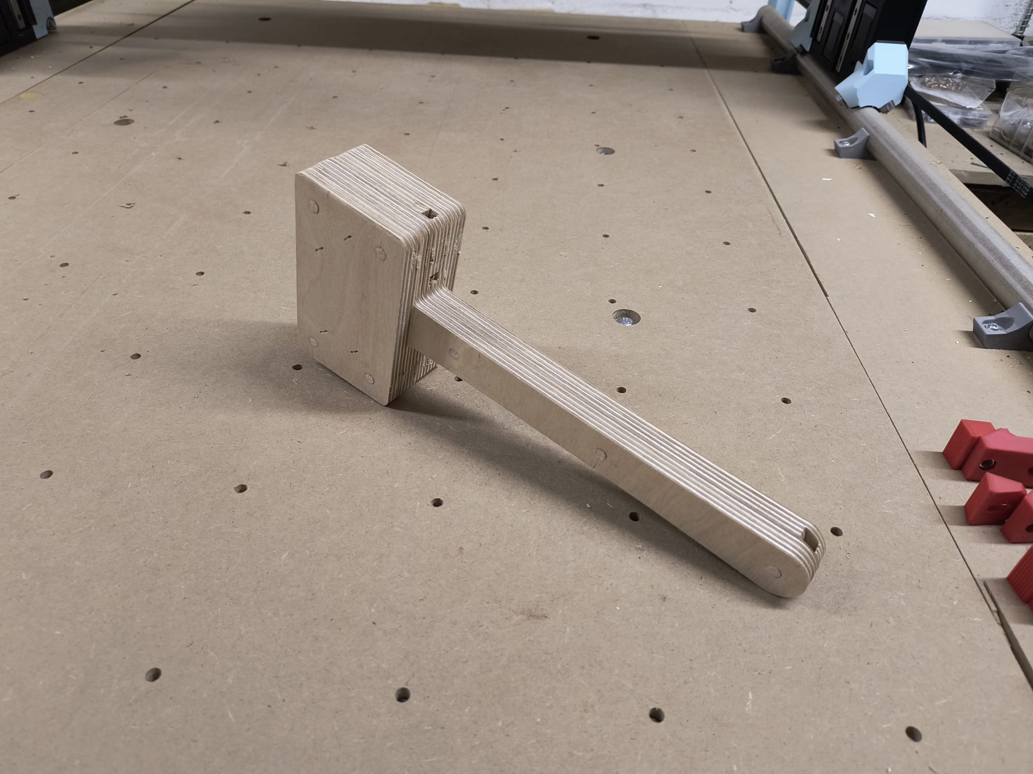

That’s workpiece holdiing done for the moment. Also i cut out my “first” Project. Which came out very good, considering i turned off the router mid job, because I zoned out…will not happen again.
Thank you so much for your help. Any further posts will be in Troubleshooting or Projects I made.
Looks good! What dimension on the threaded inserts did you use?
That beautiful sticker really ties the LR together. :joy:
Spoilboard and Hammer look great! :heart:
Thanks. Yeah the Sticker elevated if to the next Level.
The inserts are M5x10…sadly I think i stripped two or three. 10mm in MDF is really Not that much. Next Version might be either only mdf and screw everything down or t-tracks every few inches…
Where did you get the file for the hammer? Looks like a cool 1st project for me!
really nice youtube chanel, lots of files for sale and free. I really liked them even before owning a cnc. Next wiill be one of their mobile workbenches for the cnc and then replace my current workbench wich is way to big now with their modular one.
Not the OP but Free Plywood Mallet DXF Files | CNC Router Project Plans & Designs – Aribabox
