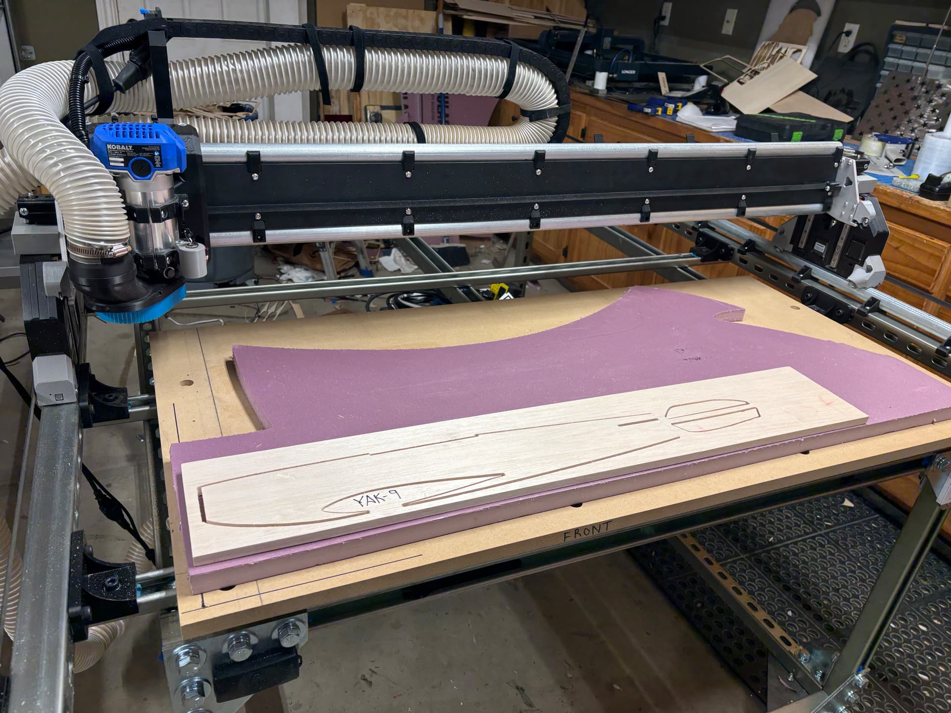

Fuselage for YAK-9

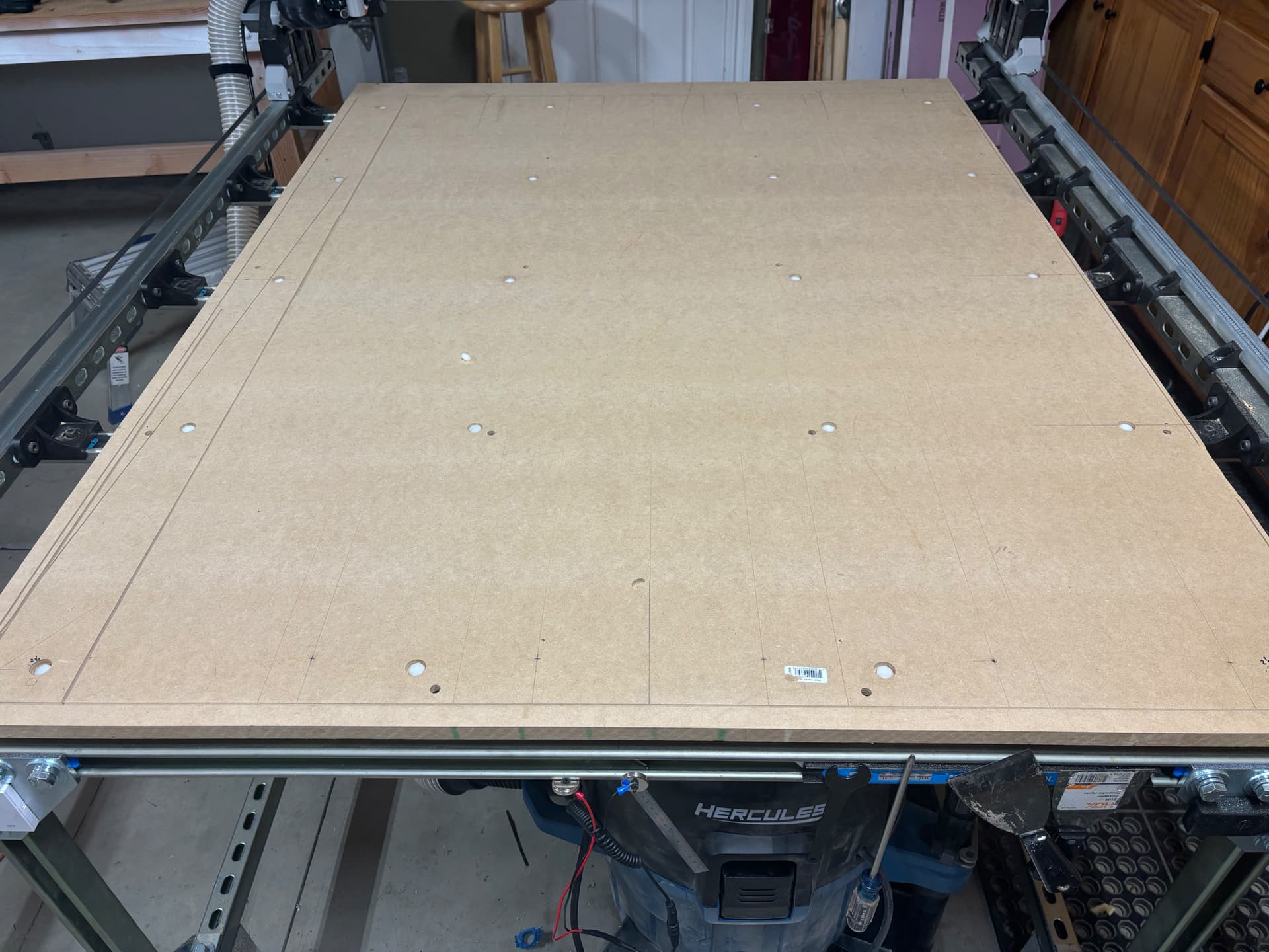

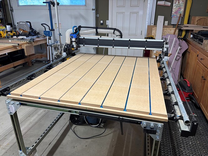

98% up and running…. Now to complete the spoil board setup… got more 3/4 MDF and will cut 60” strips with 3/16 miter on edge to overlap the t-track helping to hold that in place from the clamp pressure when in use. The dust extractor from HF fits under the table so long as I allow it to roll around freely… which is fine. Should be 100% by tomorrow as my wife is going wedding dress shopping with the daughter.. and I have the entire day to myself. LOL

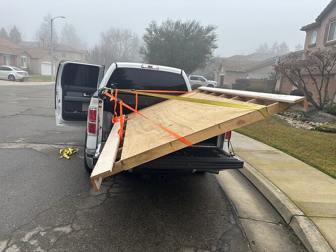

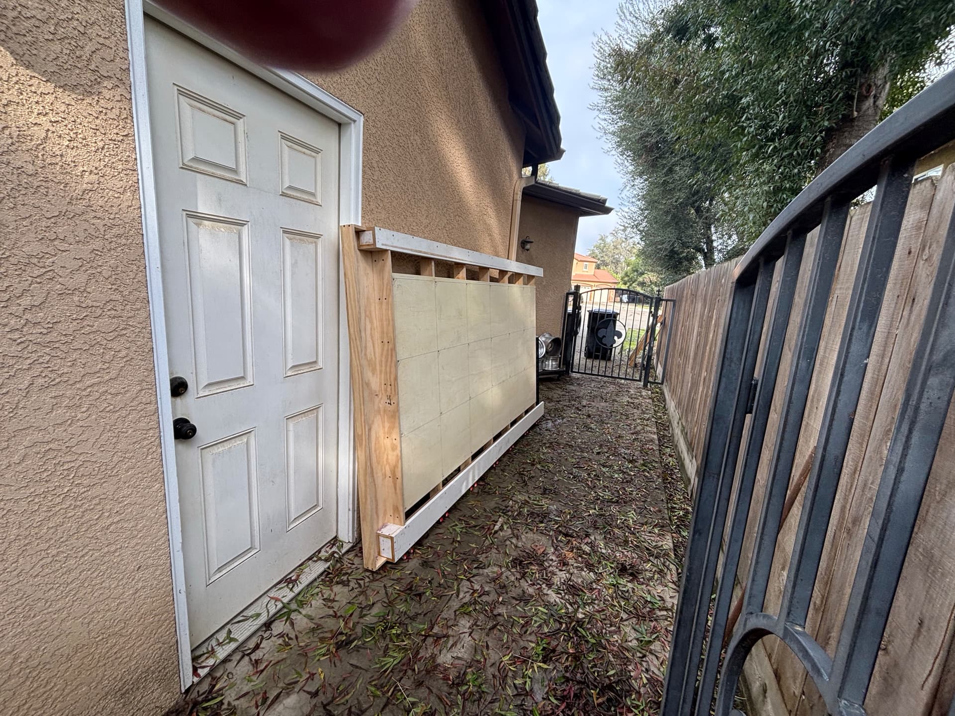

BTW, anyone in the Fresno/Visalia area want the old 4x8 torsion box table top? If so, contact me by 7am PST… otherwise that is the first thing I’m gonna tackle in the morning… its demise and disposal.
Literally rolls so easy on its side and can be handled by one person but better to have two… I just don’t have room to store it nor do I need it. It would be a shame to throw it away….

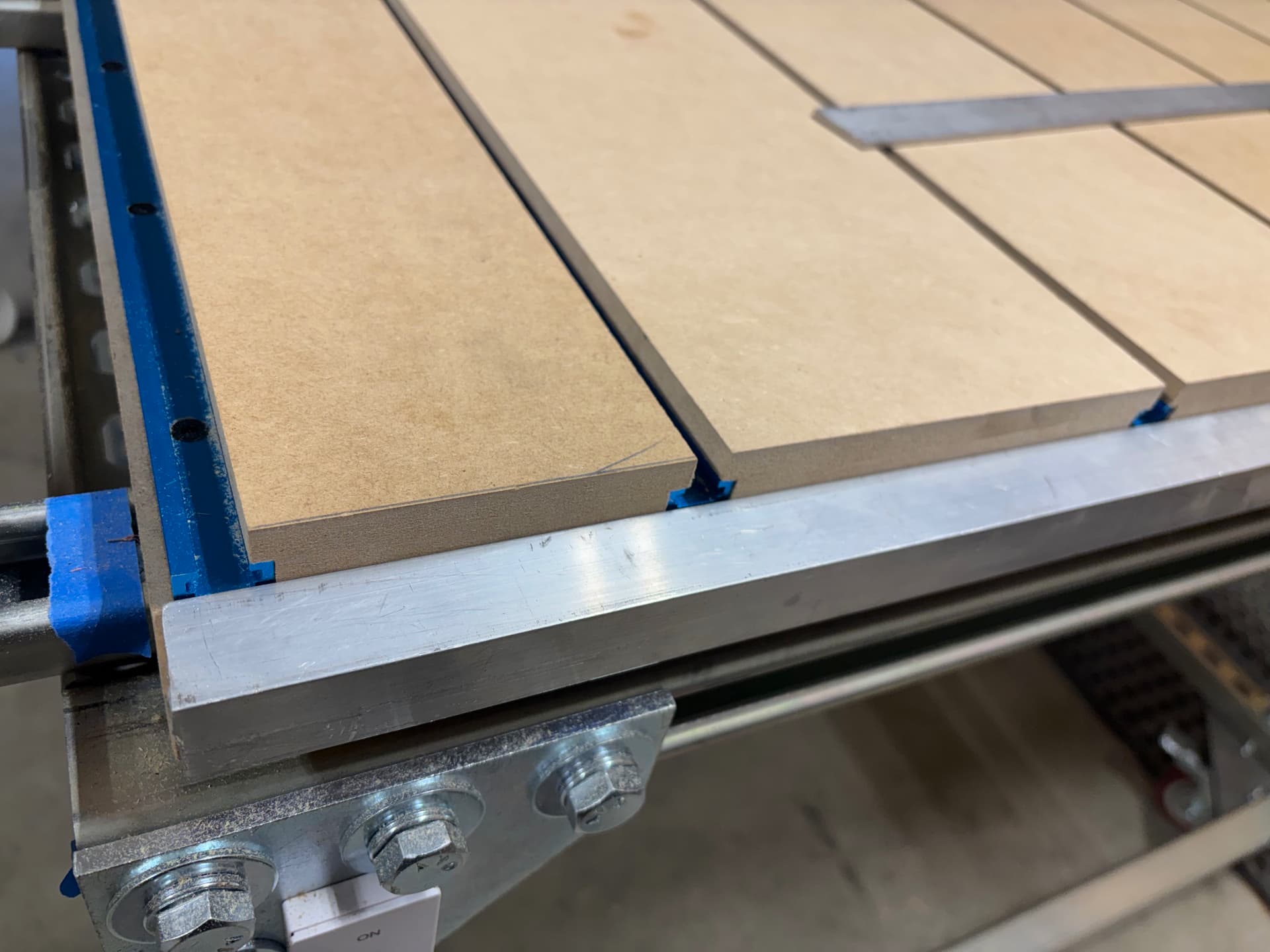

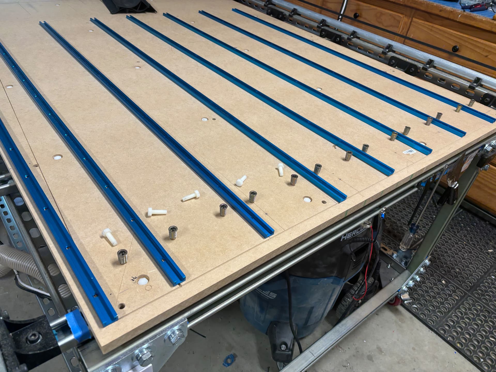

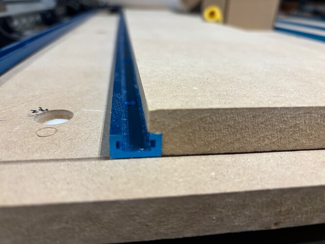

Getting the spoil board strips dialed in

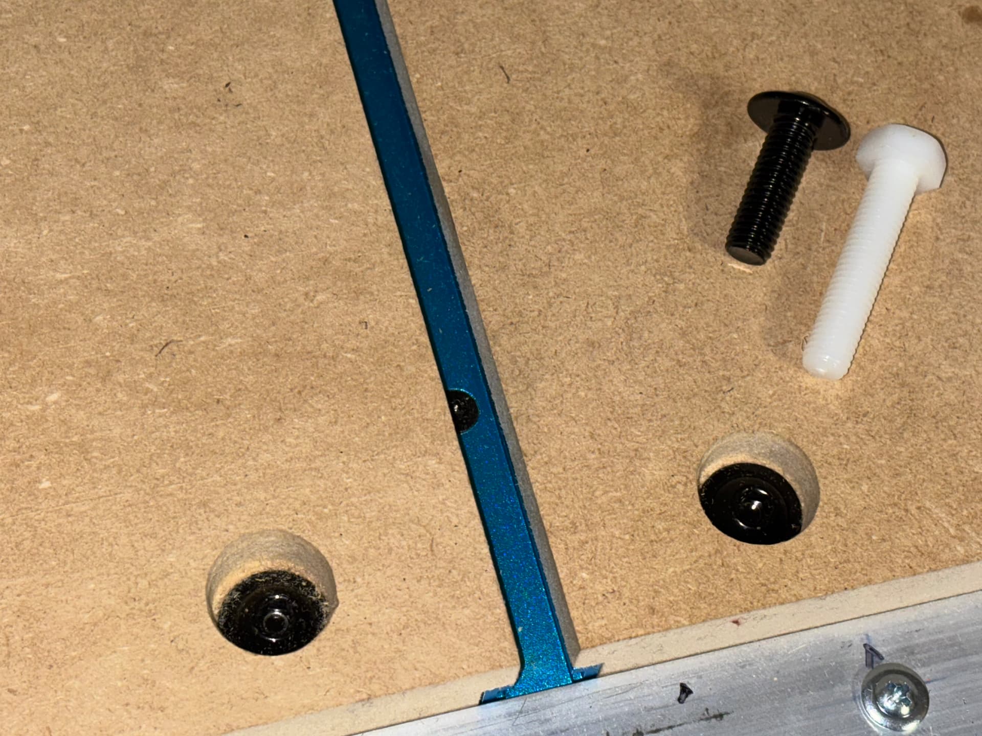

3/16 by 3/8 rabbet will help hold down the T-track plus offer some cushion before hitting it with the bit… but mostly for holding them down
T-track is all screwed down…
Next up, I need to have machine drill and counter-sink holes for bolting down spoil board strips to sub-board.

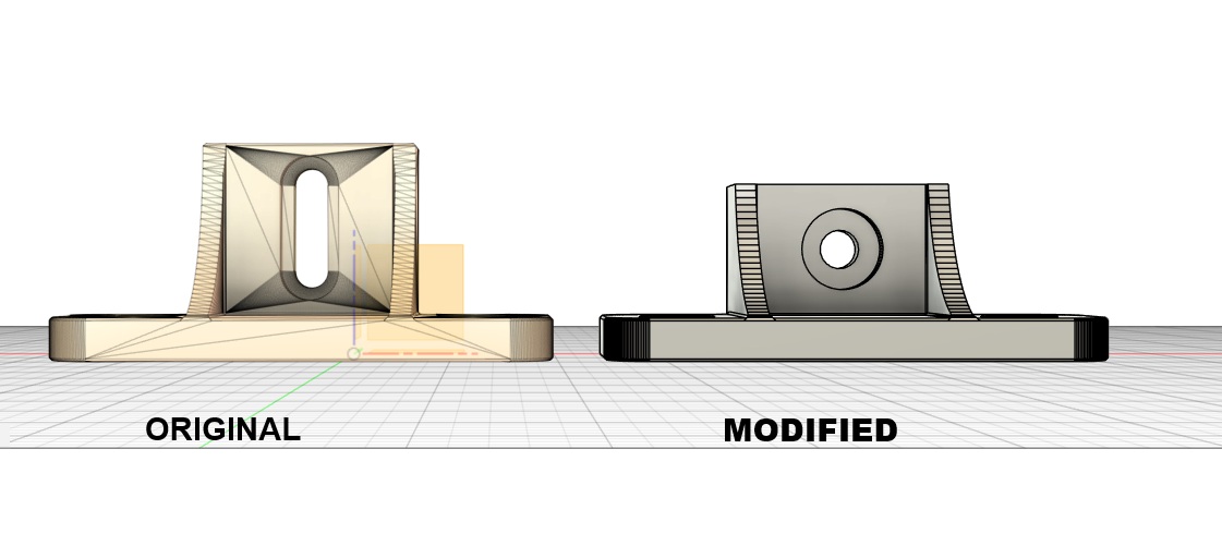

I also modified the 12g to 16g 90* bracket to be 1/2” shorter so that using the calculations from the strut panel for true 48” wide work area can be realized without going any wider with the gantry. The 49” wide MDF will now sit centered leaving 1/2” on each side of the 48” spoil board area. I did not make the change on mine as I had already squared the 48”x60” work surface to the machine… if I were do it again and use the new modified brackets, I would be able to run a t-track on both sides of the spoil board vs. just on the minimum side.

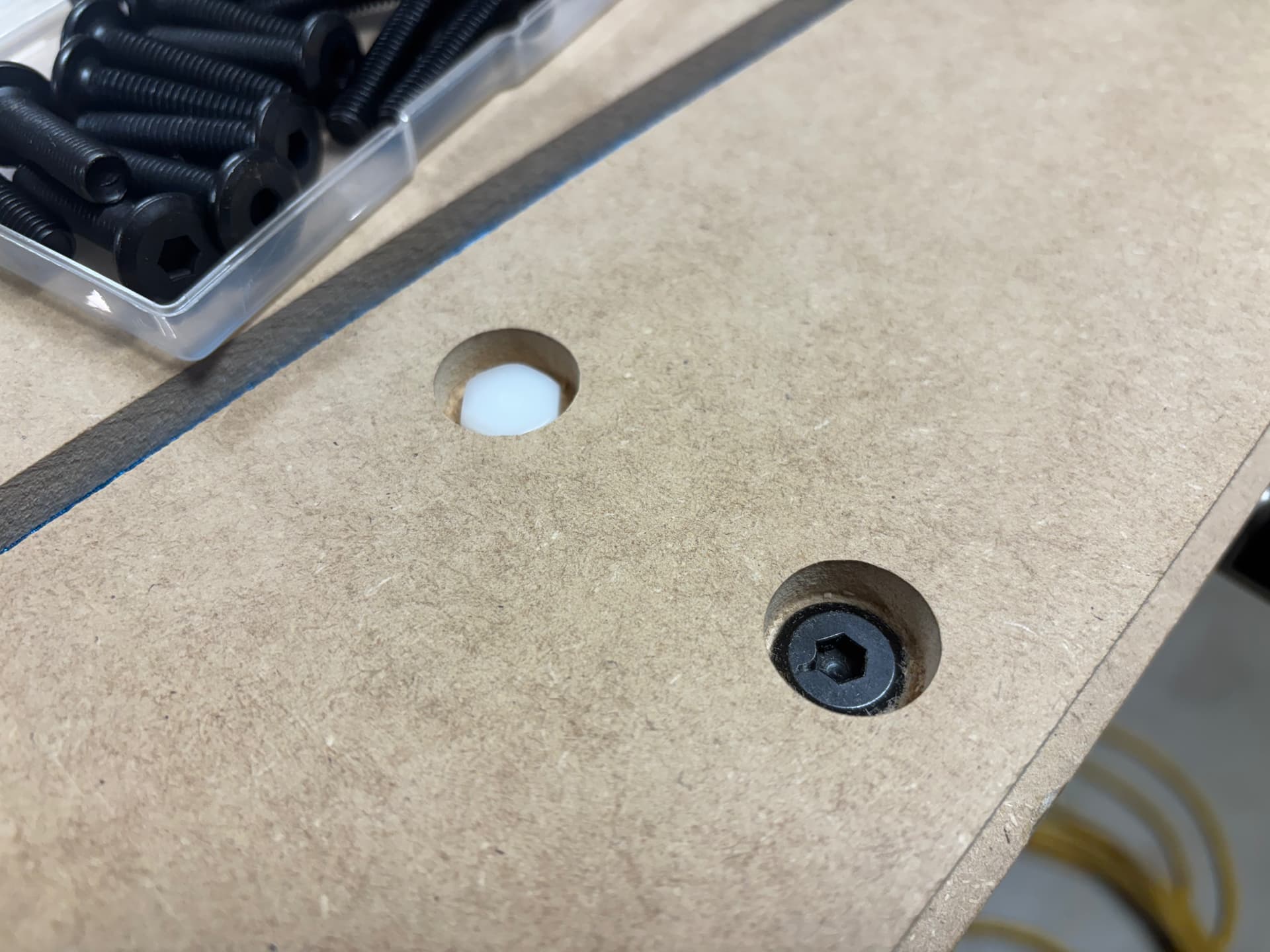

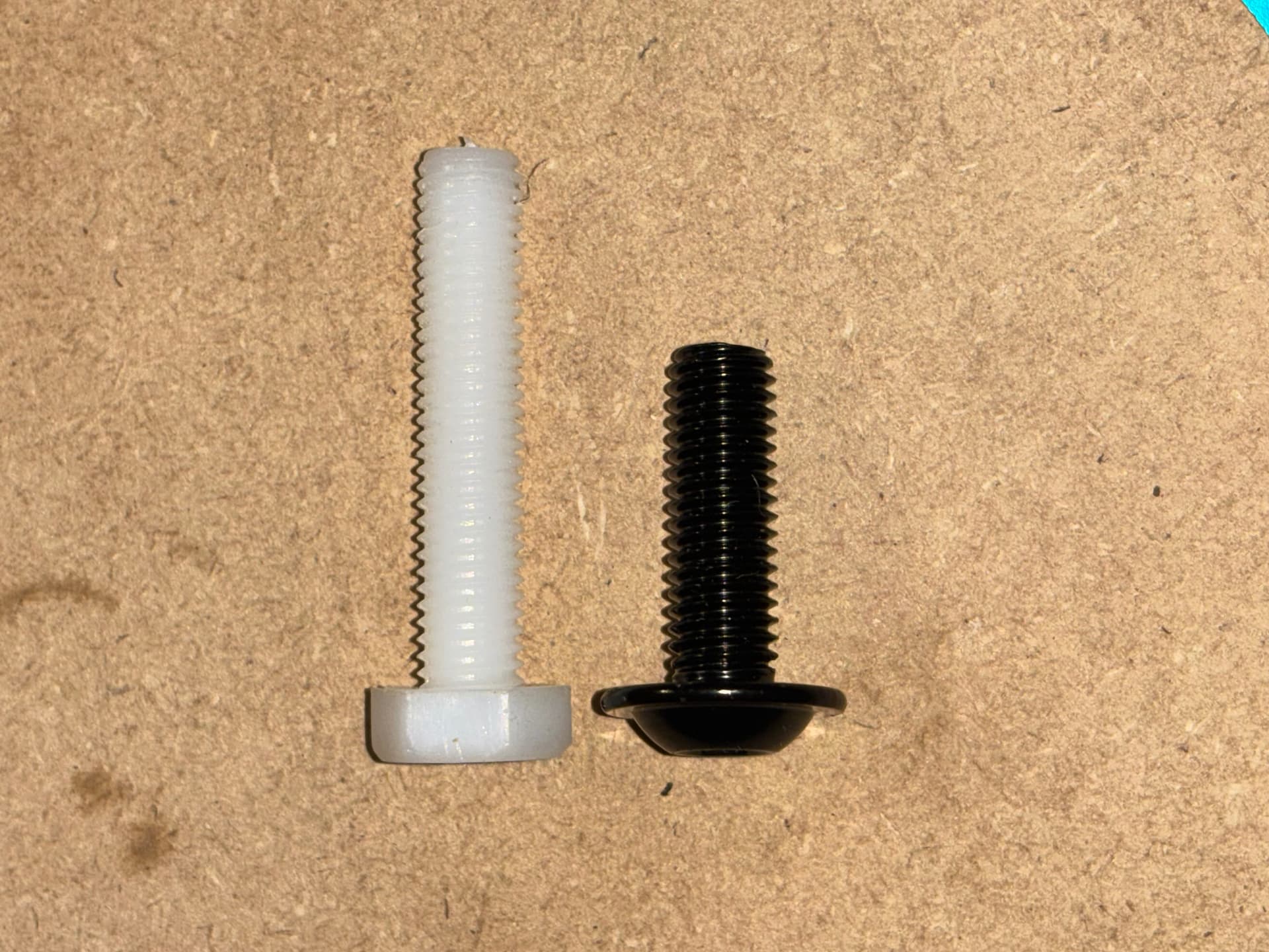

Busy with real work (LOL) not much progress today… did manage to install a backstop on front of lower spoil to match the depth of the t-track bottom (1/8”) which will serve as a stop for the spoil board strips. Maybe tomorrow I will drill out the holes and recessed pockets for the 128 nylon bolts

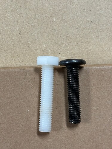

Unfortunately, the new set of now on bolts were made with soft cheap plastic and when I tighten them with my hands to get them snug, they anything beyond that they would strip out so they’re not gonna work
The ones I got a year ago I was able to crank down with a ratchet and they held. They were very strong.

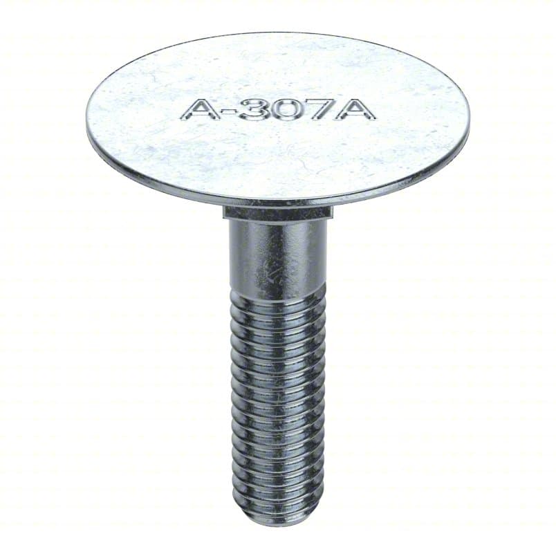

Problem solved, replaced the nylon bolts with flathead hex socket 35 mm in length and eight bolts made of steel, low enough where I should not hit with any tool and they’re able to crank down and hold those spoiled board strips, nice and flat
This looks like a great solution, especially if you’re going into threaded inserts or t-nuts. If you’ve got access under the table, you could consider elevator bolts. They’re like carriage bolts, but the heads are flat, not domed.
I keep one near my drill press so I can chuck it up as a quick stand-in for a low capacity arbor press. The one I’ve got doesn’t have the lettering.

I have changed my mind again… ditching the flat socket head bolts for socket head button flange bolts. The flat heads were crushing the MDF even with little pressure because the heads circumference was much smaller than the 3/4” pocket holes. I found some M8 x 35 flange bolts that worked very well, just shy of the circumference of the pocket… after all this, I surely didn’t want the spoil board bolt to cram through. Probably could have achieved the same effect with washers but this insured the overall height was still at or less than the nylon bolts.
this could have been avoided had I known what to plan for sooner. Initially making the pocket holes large enough for the socket driver to install the nylon bolts at 3/4” to a size more conducive to the flat head bolts would have eliminated the need to use the flange bolts. :slight_smile:

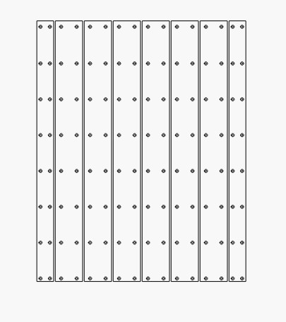

so I finally got around to creating the drawings of my table and cut list in PDF format for printing on 11x17 US Tabloid Size paper.
here are the links

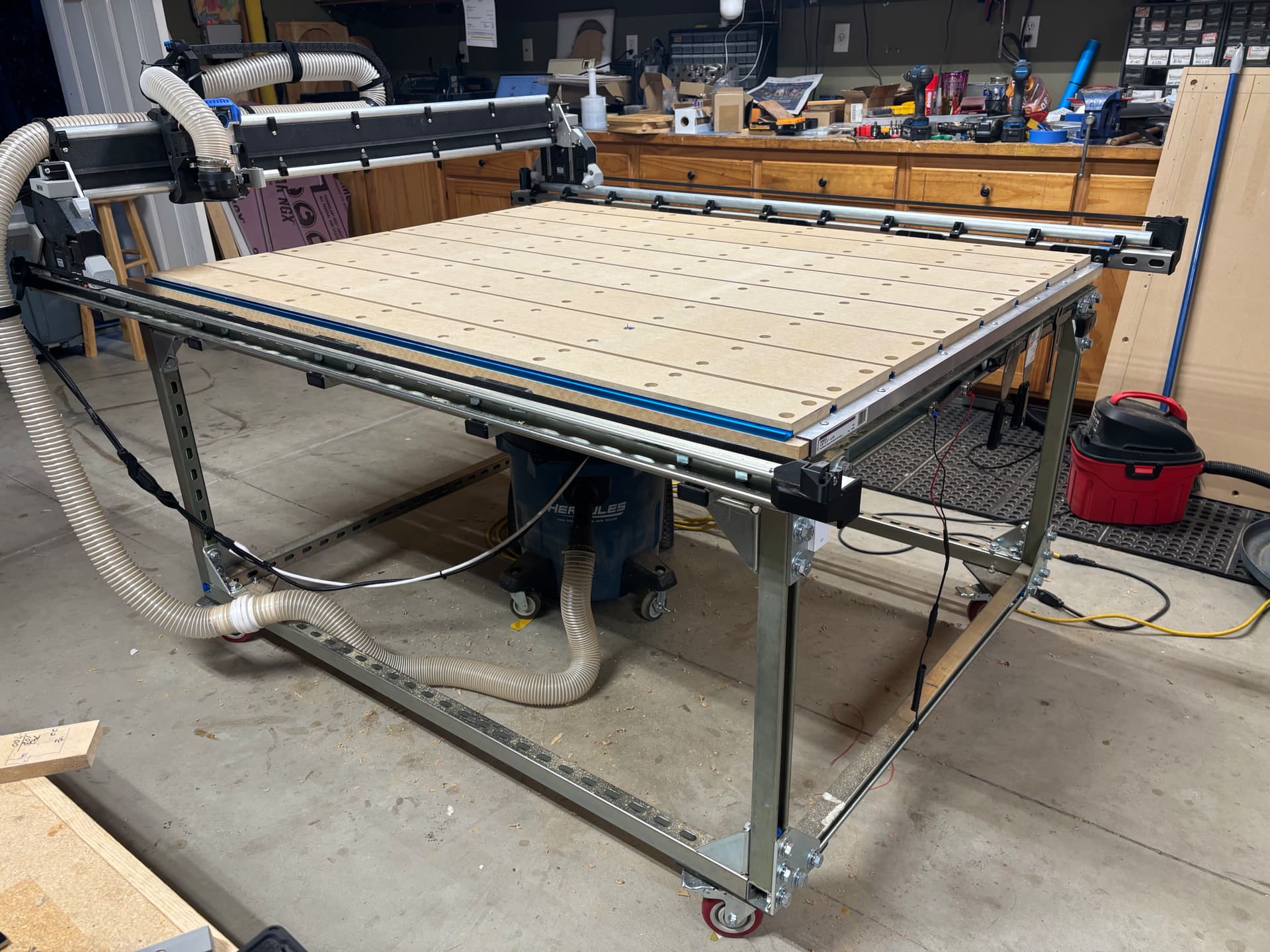

I was happy that my original torsion box full sheet table top did not go to waste. Scott pick it up on Saturday. I hope he gets lots of use from it while he builds and uses his future LR4

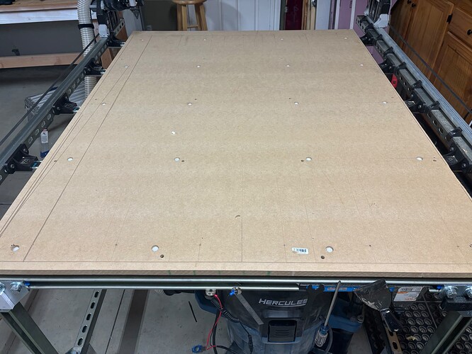

I love my new unistrutchannel table. Just saying. So portable. Only thing that is not free to roll is the power cord I plug into the wall to run it.
Currently I have wireless on/off switches for the router (which also triggers the dust extractor that rolls around under the table) and similar for turning the machine on and off. I might hard-wire these now that I have a more permanent table/machine. I finally have gotten used to using the WebUI on the Surface Pro (pick up one from amazon refurbished for like $100 and it works flawlessly).
