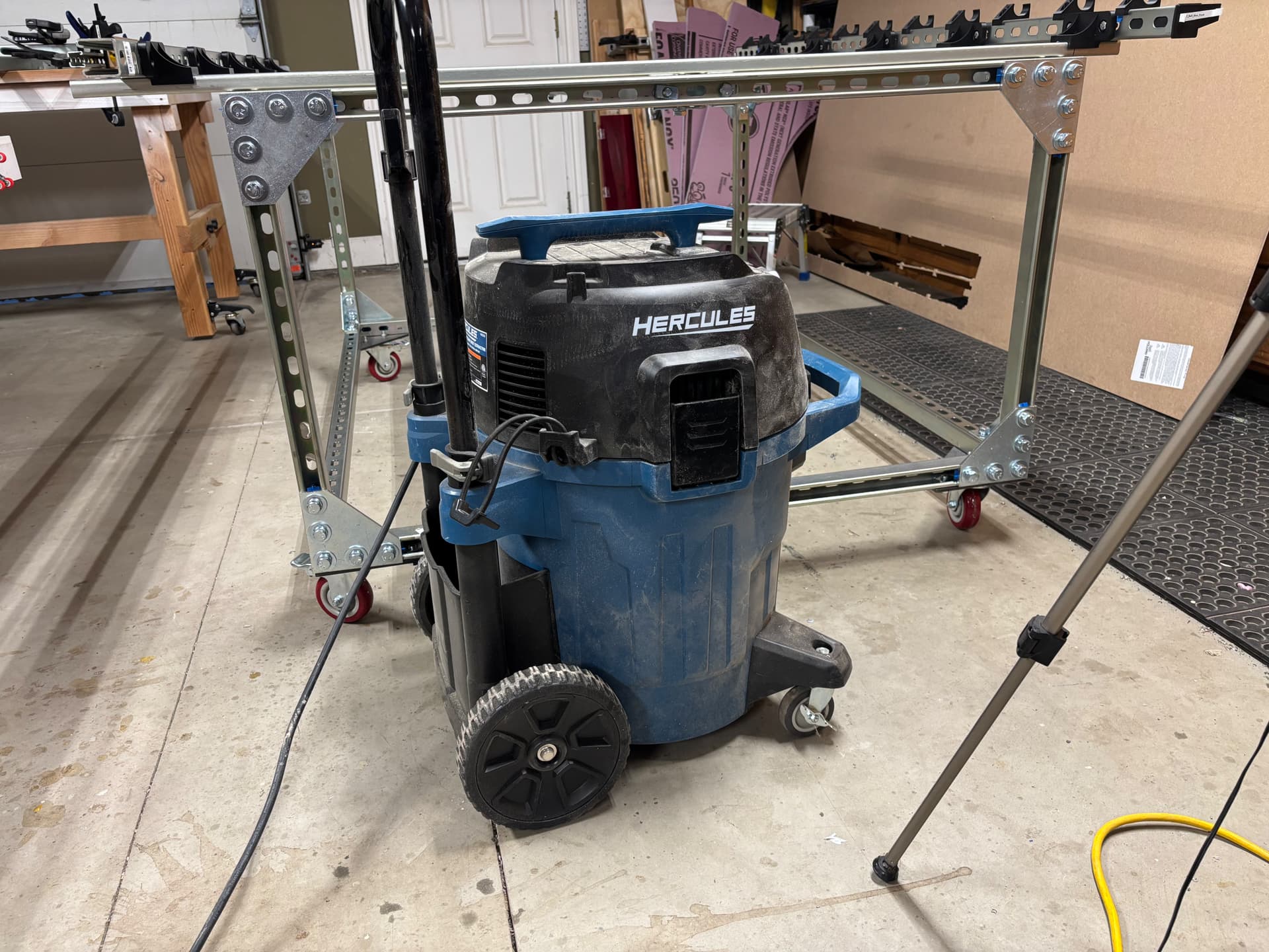

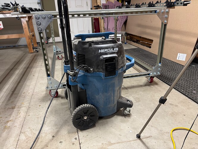

Item of note, I had always intended to mount the Harbor Freight portable dust collector under the table… but after measuring i found it is too tall for my ‘space’ under the table. Might fit if I remove the wheels and handle… I do have a few inches of space due to 4” casters so could make some sort of hanging platform below bottom rail … TBD.

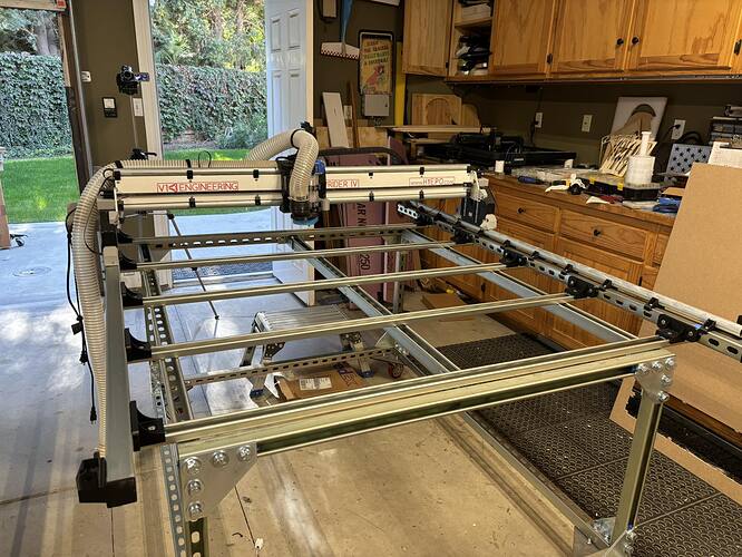

getting ready to assemble the new beam (accurately cut this time).

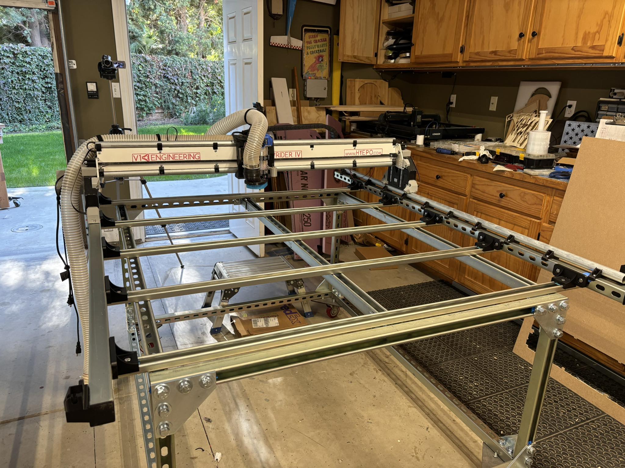

getting close to the finish line (again lol).
now to rebuild the beam

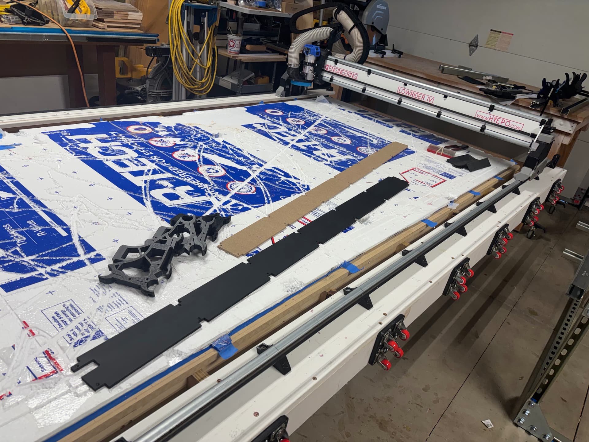

That was actually the old strut plates, the new ones are black

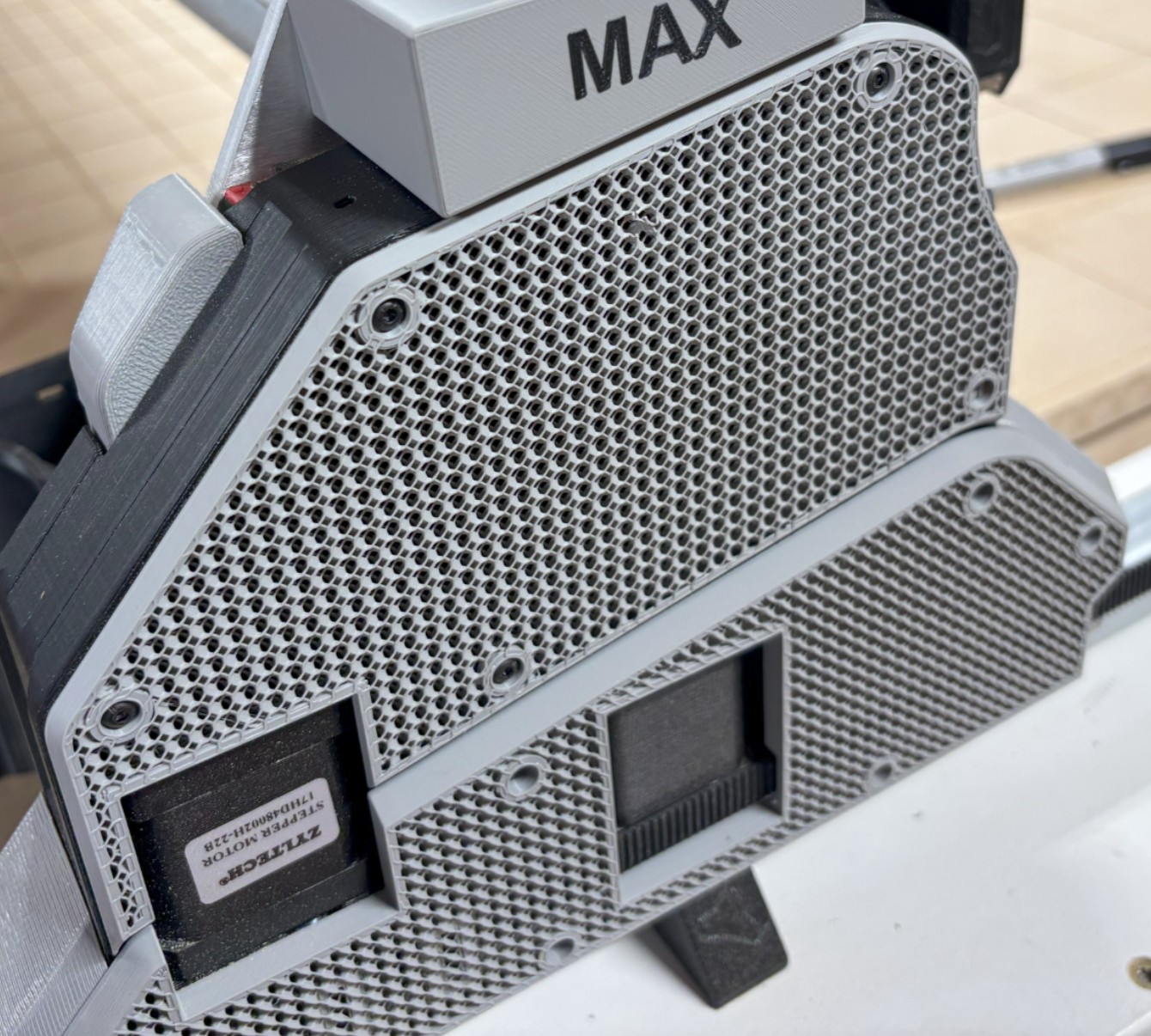

Hello Peter, I love these side plates, see photo, are they available somewhere for 3D printing. Thanks in advance for a message back.
That looks to me like the usual Peter plates from printables, printed with no top or bottom layers (So only paremeters and infill in the print)
MakerJim is correct. Those are Peter Plates from printable printed with no top or bottom layer as described. The MAX block is my design and allows for the gantry to rest after homing Z before shutting down machine where otherwise the router usually drooped into the spoil board once power was cut. Also available on makersworld and printables..
Z Rest Blocks
Min and Max Z Blocks
Peter Plates
Peter Plates
