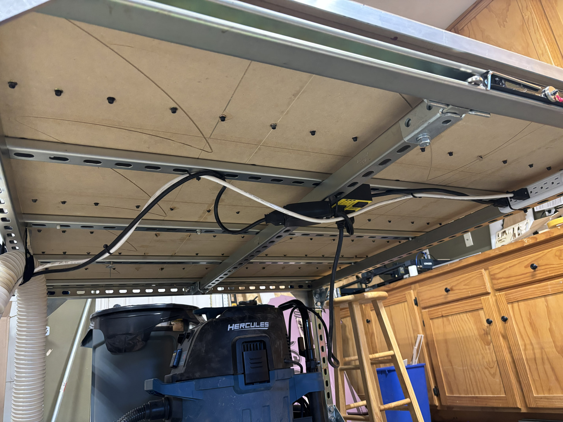

Did three things today…
  1. Failed to get MillMage (from Lightburn) to work with the LR4/jackpot (but I haven’t given up).

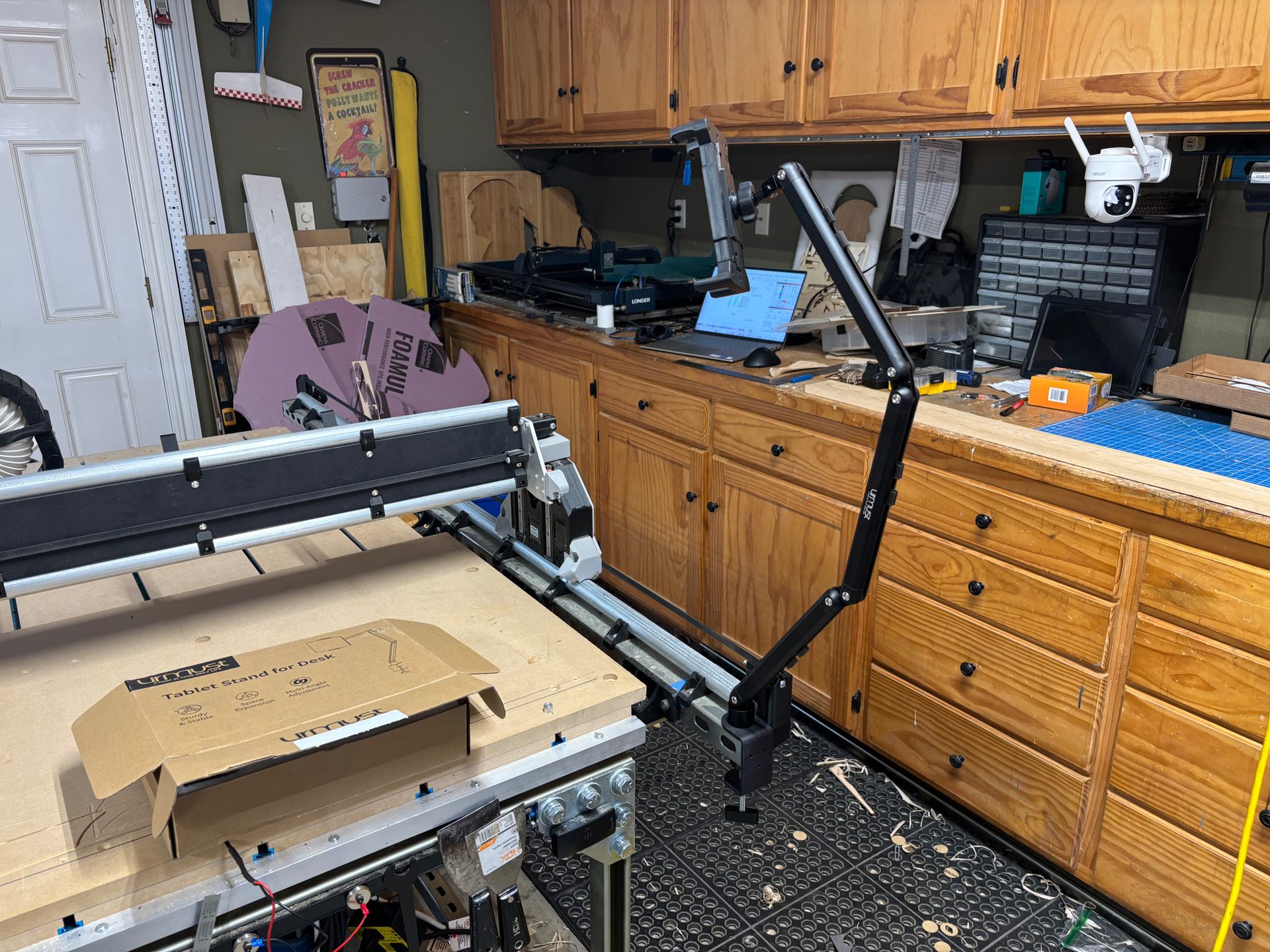

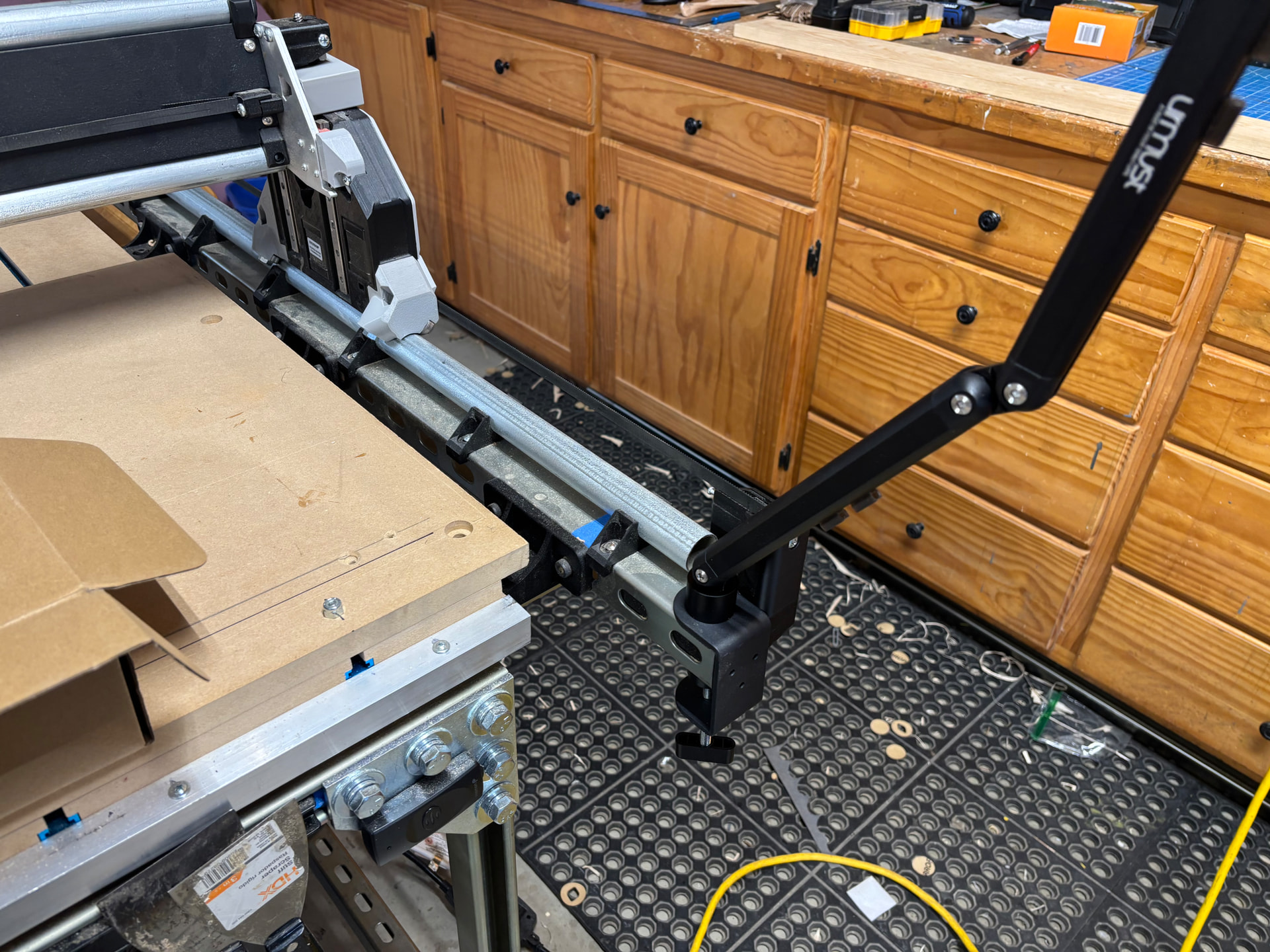

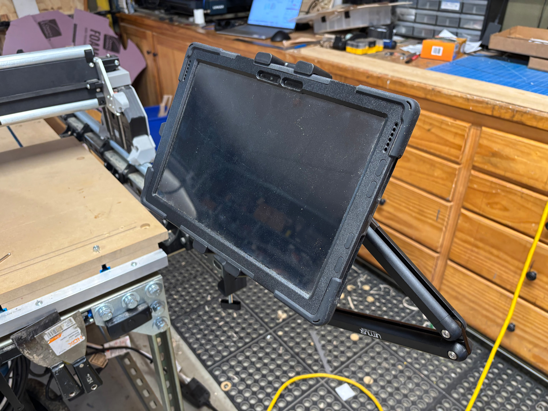

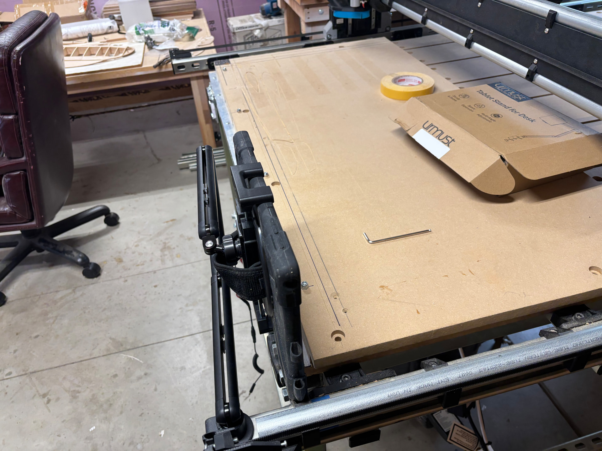

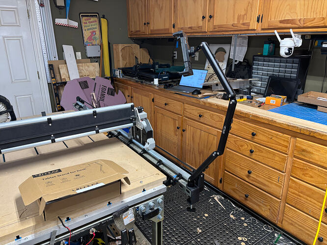

  2. Installed the adjustable arm mount for the Surface Pro. The extension arm fit perfectly on the end of the max Y strut channel.

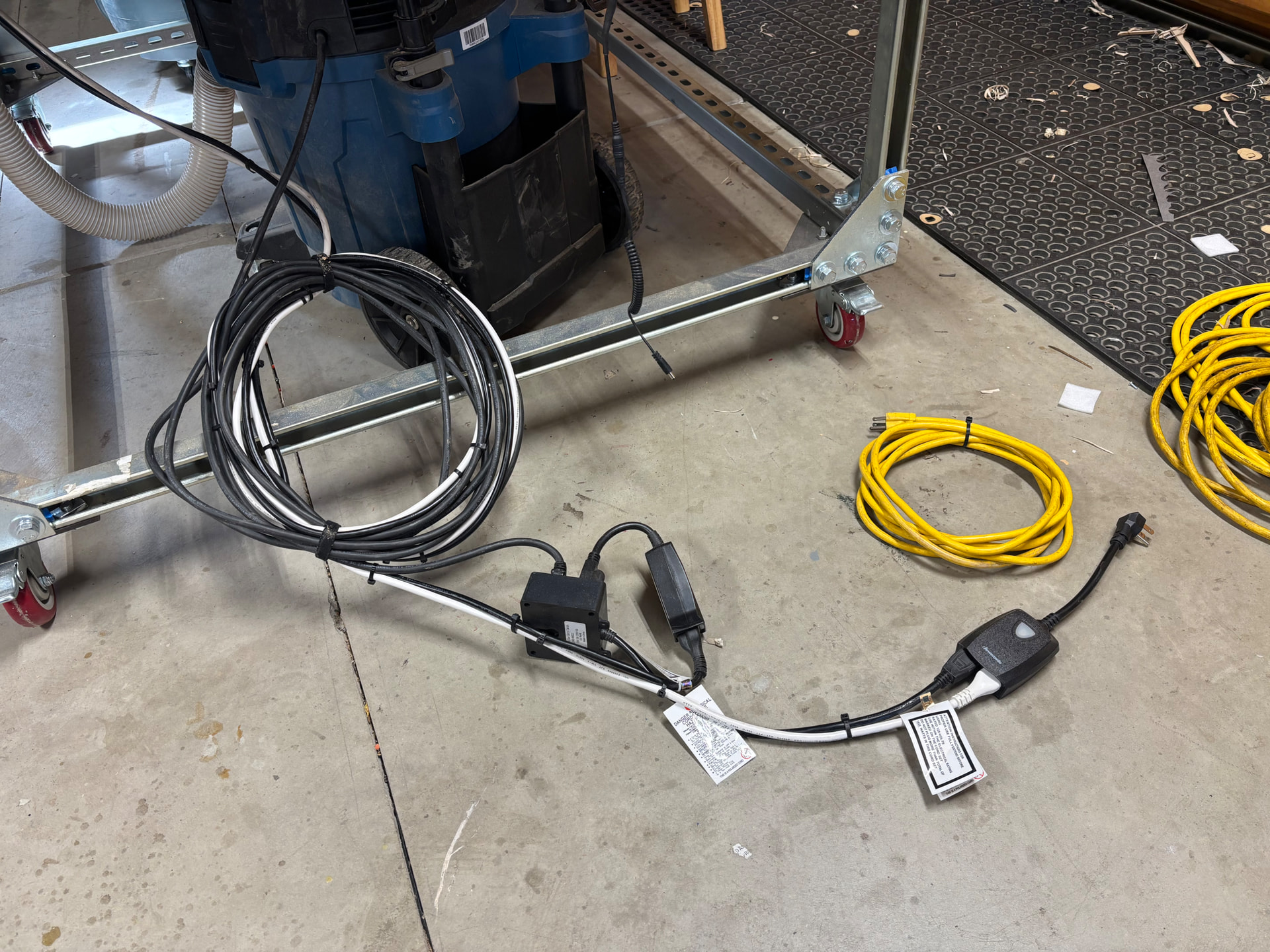

  3. Rewired underneath the LR4 strut-channel frame table redoing all the temporary wiring tucking all the wires, installed main power switch that also acts as emergency shutoff.
Before wires and such
after proper sizing wires and tucking them away…
