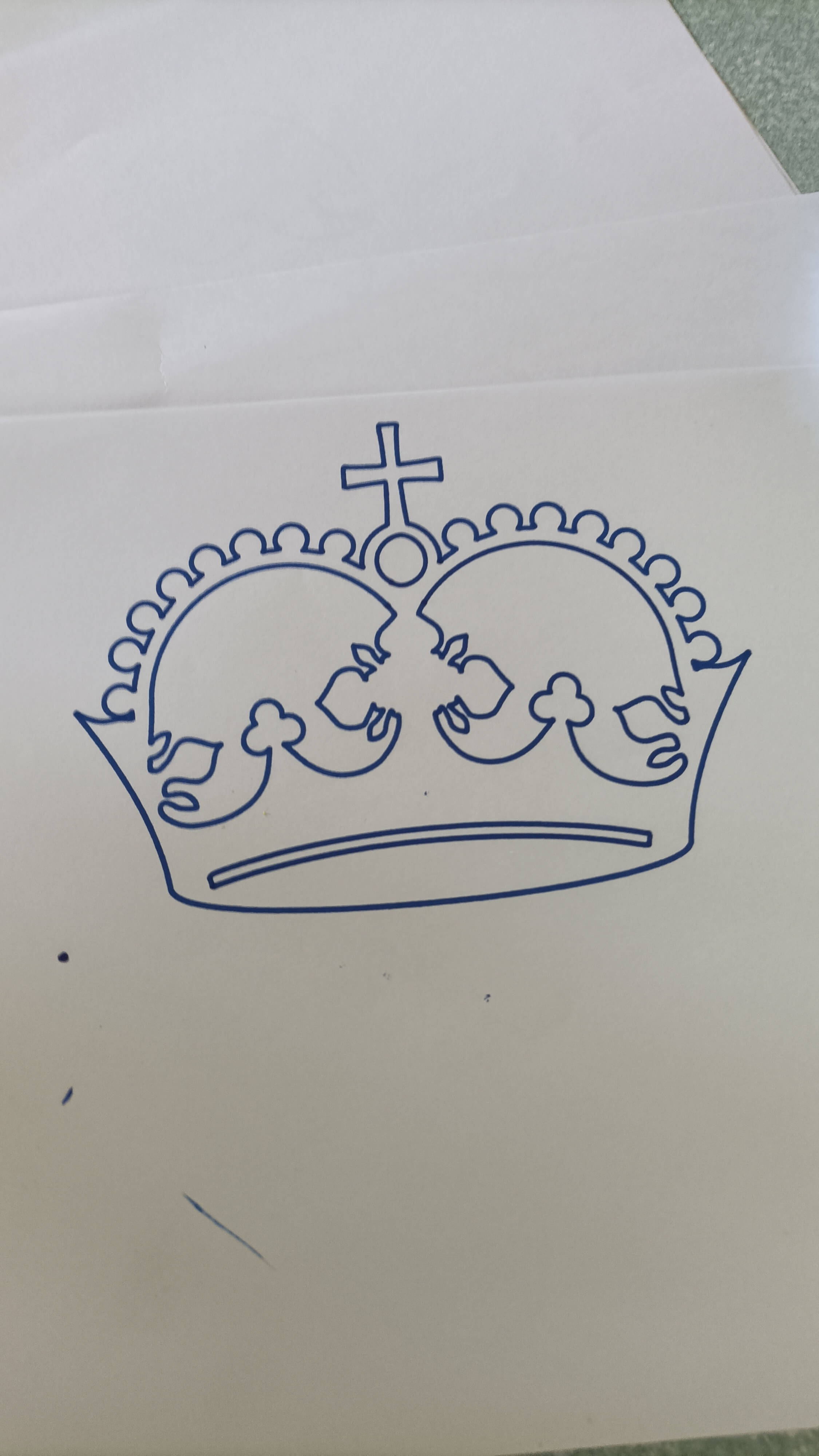

A perfect crown for posterity - we got there. :tada:

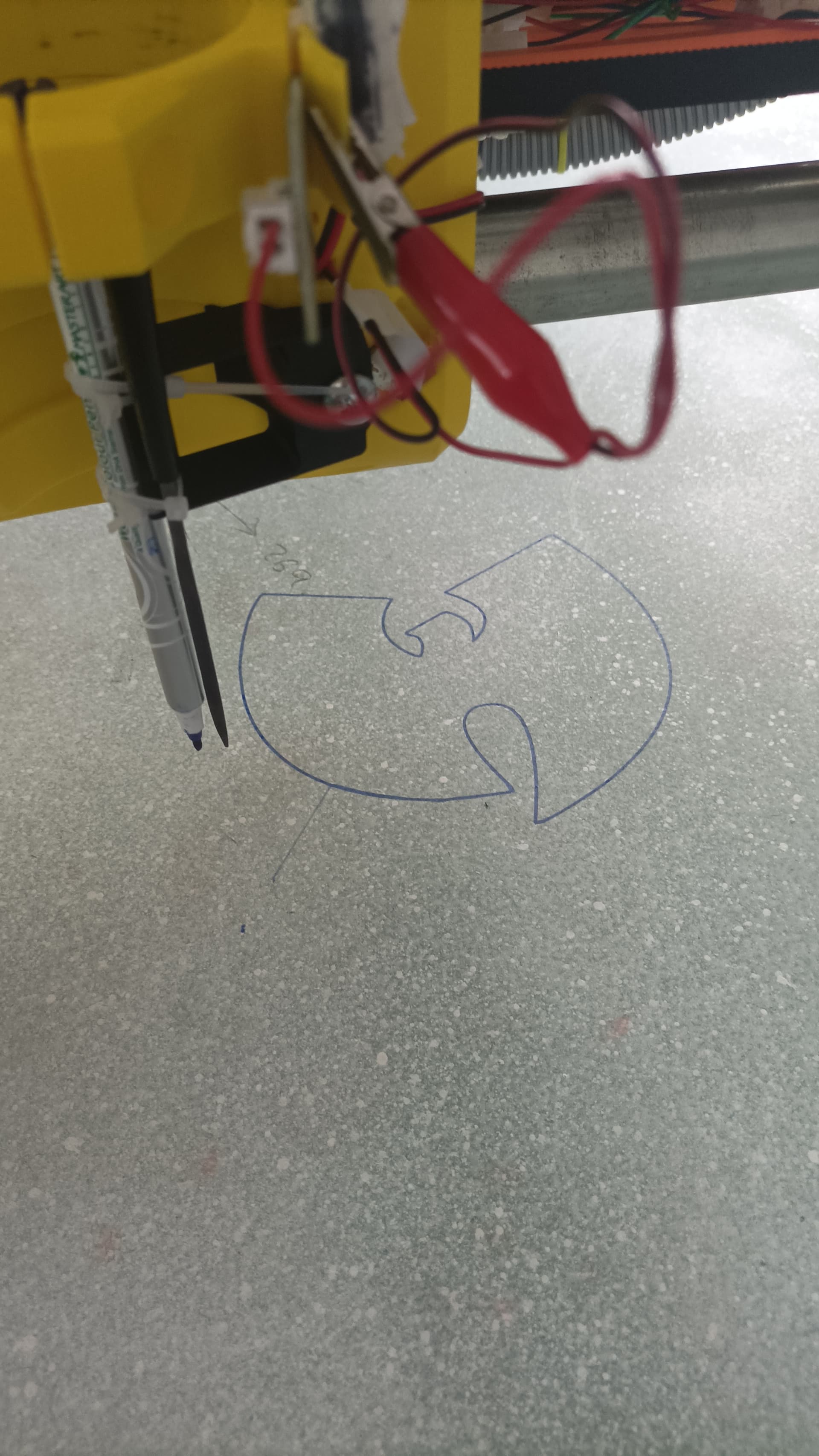

Also hacked together a touchplate probe to use while pen drawing (a file that sits next to the pen).

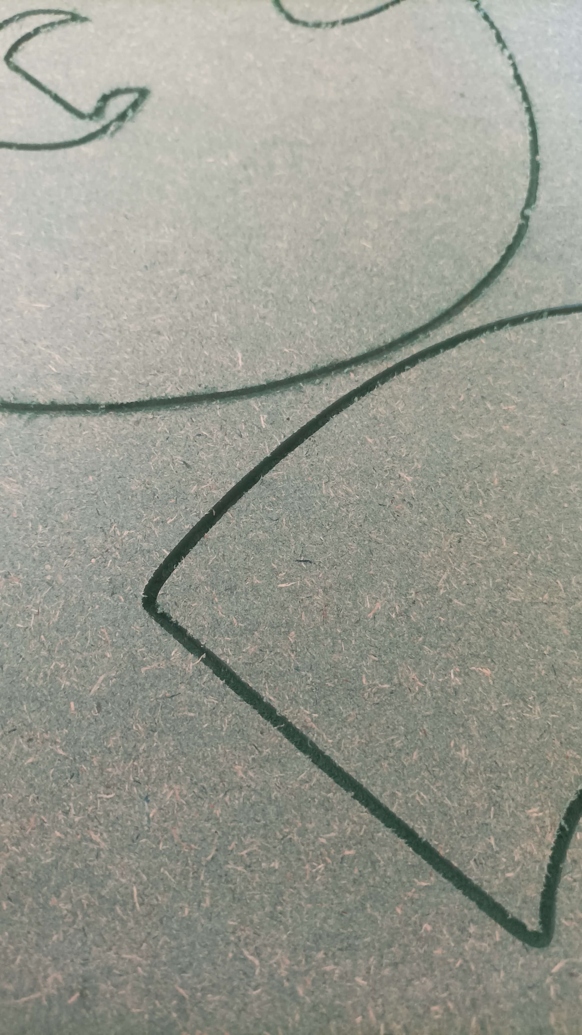

Example finish (the one closest to bottom):
3mm @ 25mm/s cuts well without any noticeable chatter but the edges are a just a tiny bit rougher on the finished cuts. (No finishing pass, this is just a single straight peel cut at a single set depth)

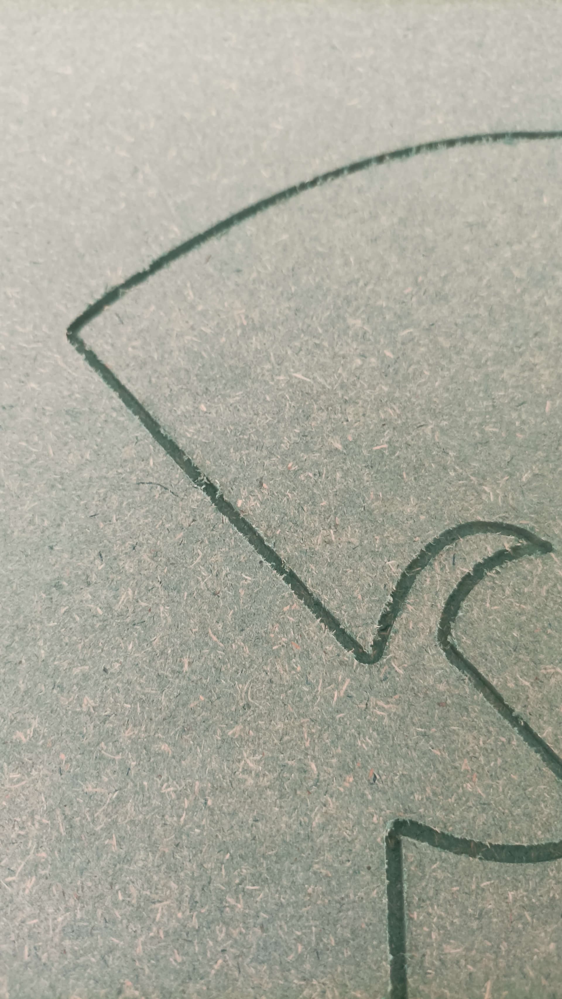

Example:
.. so I’m gonna try a few different settings. I’m thinking the sweet starting spot is somewhere around 3mm DOC, 20-25mm/s and then next I’m gonna test from 2-3 on the Makita dial and see how it goes, and increase some stuff slowly.

Oh and your cuts look perfect, in MDF you will always get fuzz at the tops.

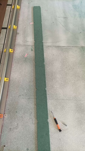

I managed to cut the struts after a few attempts (mostly crashes of the gantry due to various rookie mistakes)

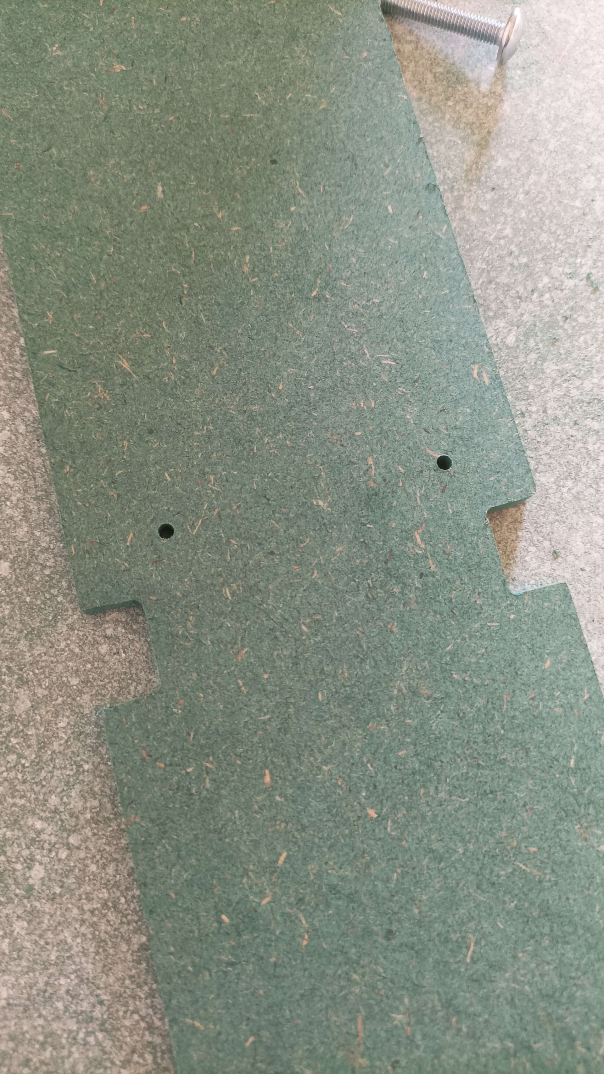

So in my joyful state after getting them cut out without issues I quickly took the core off and whole LR apart ready to mount the struts.. then realised the drilled holes by the gcode/ESTLCam are the bit diameter.. not the right size for the screws? And at one end they are not in the center of the tab opening, on both. The holes gradually move out from the tab position along the length of the strut.
Pictured is near one end. The other end of the front strut has close to middle holes and at the opposite end it’s far out.
Not sure what I did wrong there, but I’mma have to manually drill holes now instead I guess.
I just opened the gcode in a viewer to see if it was the actual file, and no - the file looks good. Holes in correct place. So why/how would it do them incorrectly? First thought is the LR is obviously not square or whatever, which I’ve had trouble with, but if that was the case, wouldn’t the tabs also have moved along with the drilled holes?
The strut itself looks perfect, perfect length, fits perfectly between both Y ends, just the holes are wrong.
A longer view where you can see the hole position changing along the length.
Could this be because of the hole diameter being smaller?
Not sure how CAM and gcode works in the background, but if instead of drilling the full size hole, it’s just drilling bit diameter in the center, that extra missed mm or 2 could add up over time, where gcode or whatever is reading movements from the svg type path to the next ones rather than the drilled hole? That would explain the increasing movement from center over time. Not sure if I can explain it well, but could it be the culprit, something to do with the wrong drill diameter setting or highlighting the drill circle incorrectly in ESTLcam?
