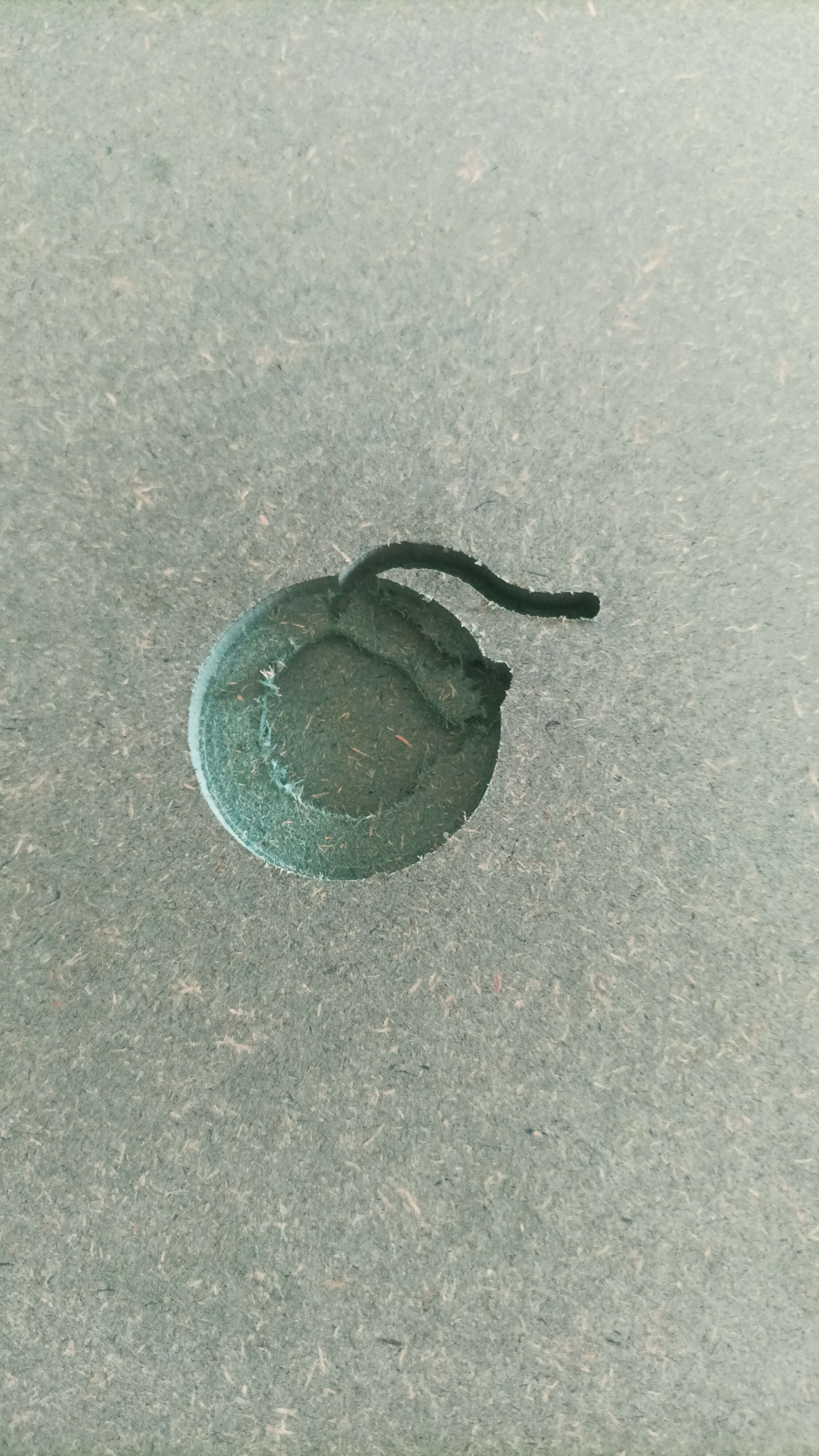

The diameter has nothing to do with the positioning of the holes. It would still drill the holes in the correct spot.
You have to choose helical drilling (I think that’s the English name) for those holes in Estlcam. :slightly_smiling_face:
Oh, that must have been it with the size yep. The annoying thing is for every failed cut attempt I’m pretty sure I used helical when generating the gcode but made other mistakes or just had settinsg wrong, and the final one that did actually cut well with correct settings for everything else (e.g previously I forgot to use peel and used linear), I must have used the standard drill option. :roll_eyes:
Any idea why the position changed though?

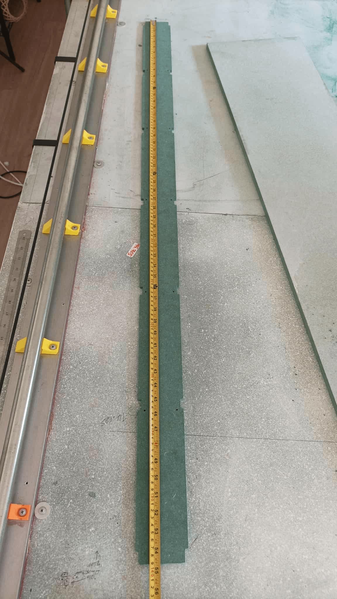

The strut length is perfect, beautiful fit. I wondered if it might be that the tabs that are wrong, so I checked but the tabs all line up on both struts. When laid side by side like in the gcode drawing the tabs on each struct match position too. It’s puzzling.
I’ll check again in the morning and measure hole to hole, see if that shows anything.
Wow what a puzzle. The holes are drilled first so it could not be lost steps if the struts are the right length. It has to be your CAM in some way. There is no way the machine could miss steps and perfectly come back to the right dimensions after.
Wild, I need to know how this happened.
It has to be CAM right? Otherwise other sections would be off. But if it is CAM, why does it not show up when viewing the gcode, only when cutting?
It’s a longshot, but could anyone test the file I uploaded above if they have scrap wood lying around?
Here’s the strut measured where you can see the length is spot on.

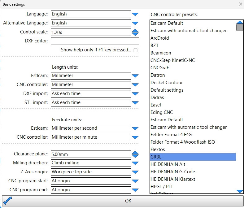

Here’s the tool settings:
Basic settings:
Values:

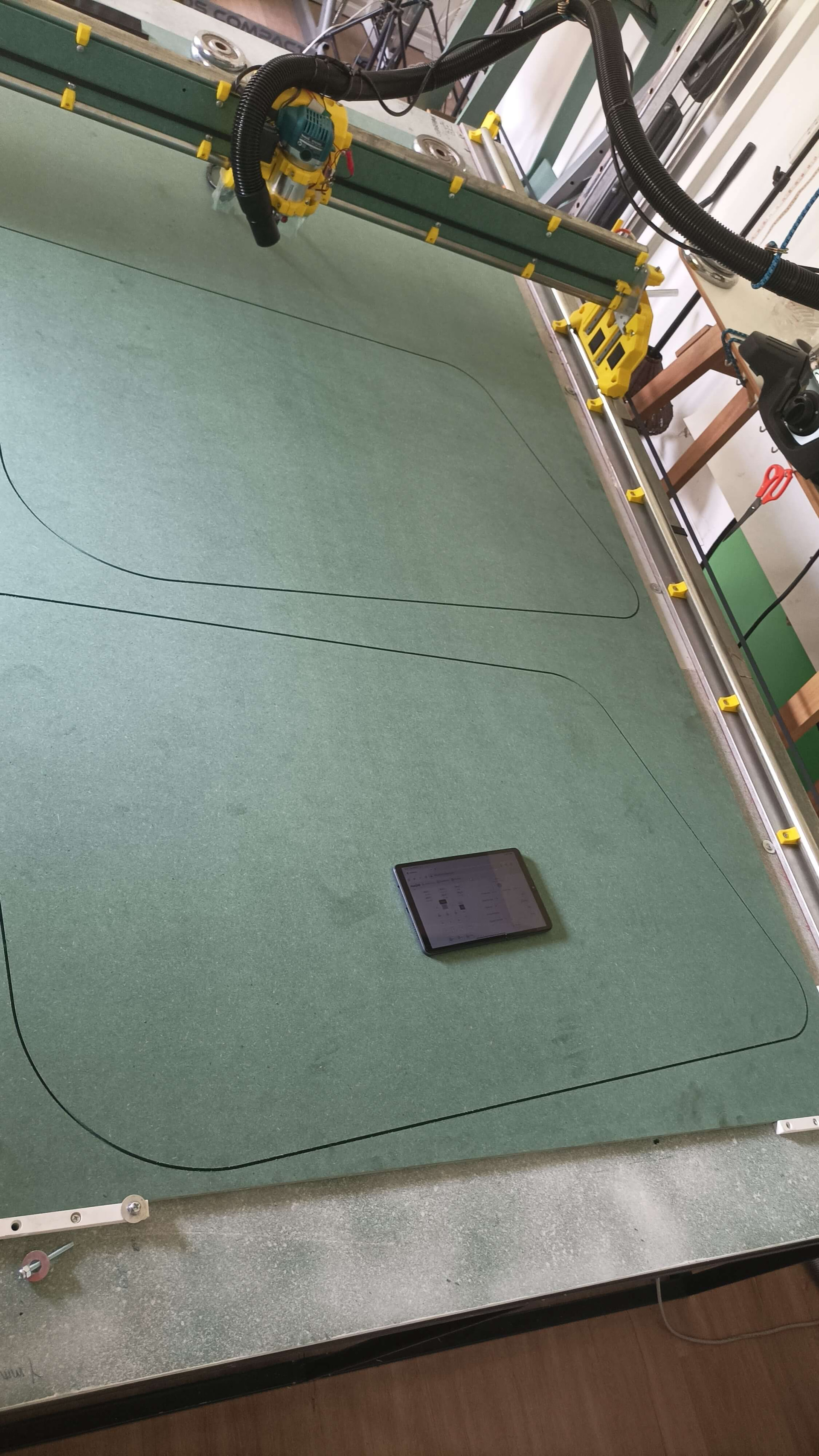

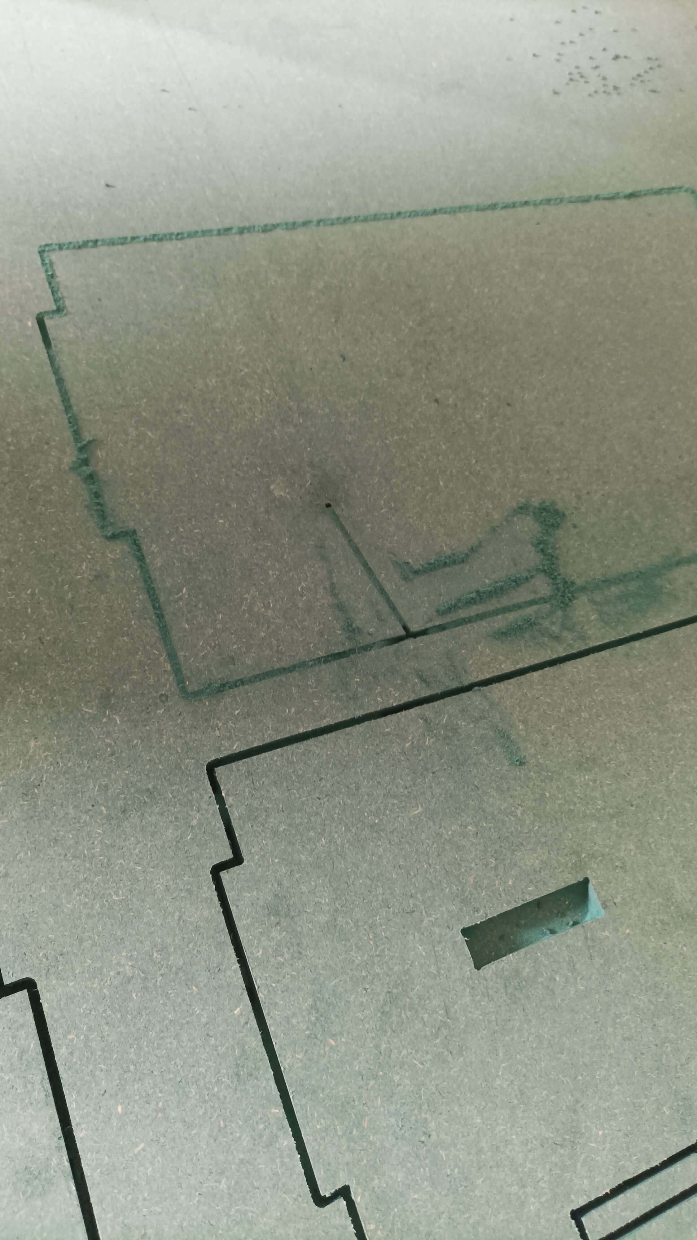

Essentially I would have a few pieces cut well, then others where it would just randomly veer off. Probably like 1/3 jobs would fail like this.
Both times shown I was babying it - 2mm DOC, 13mm/s feed rate.
Slight loose core - tightened.
Grub screws - all tight.
Endmill - changed to a fresh one multiple times.
Couldn’t for the life of me figure out what was happening and why it was losing steps.
Then after yet another failure, I was about to throw in the towel, and figured I’d home everything - X didn’t move. Strange, what’s up here? Wait.. this has to be wiring.. Checked the wiring, and after some deep inspection I noticed one stepper wire was loose inside a connector. Stripped it and reconnected - cut the next piece without issue.
That was today, so I’m hoping and praying I’ve finally found the cause of these endless problems - a slightly loose wire that I guess might have been just not passing current at a certain point or due to vibrations etc causing random missed steps and the machine veering off.
