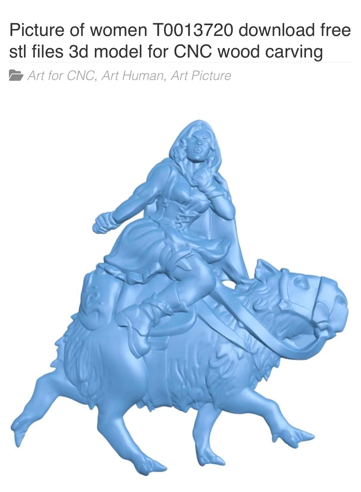

Found this random STL of a D&D type lady riding a majestic capybara and was like “yup that’s the one!” Picture of women T0013720 download free stl files 3d model for CNC wood carving – Free download 3d model Files
  • Simplified in FreeCAD by converting to solid and then refining it (I couldn’t get the decimate tool to do anything, this seemed to work well enough), and then exporting as STL.
  • Brought it into EstlCAM as an STL, resized to roughly 80 mm x 80 mm, 4 mm depth. I have some really pretty 4x4 posts that make cool wooden blocks when sliced on the chop saw, figured they’d be great for carving little things.

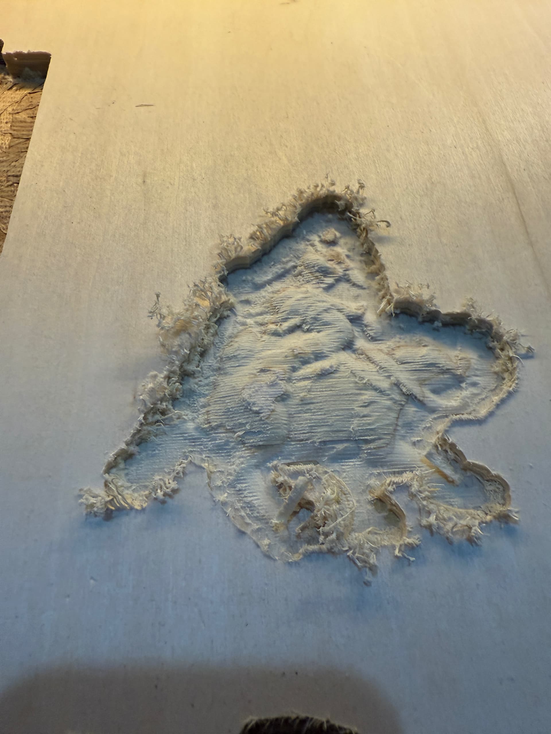

  • I did the automated Block Machining, using a 3 mm 2 flute upcut bit for both roughing and finishing. Finishing used a 20% step over.

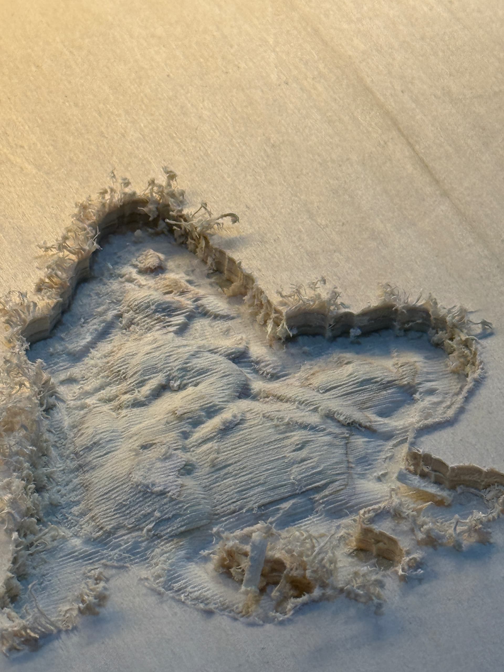

  • It worked!! Well kind of, I figure my bit is way too big and not the right style for this tiny carving… the great thing is that the machine behaved as expected, so I can actually enjoy experimenting to figure out what works and what doesn’t :). I have a 1 mm ball nose bit coming in today to use on the finishing, we’ll see what happens!
My photo isn’t great at showing the relief detail, but you can make out the cappy’s legs and seeing it IRL I can see the potential

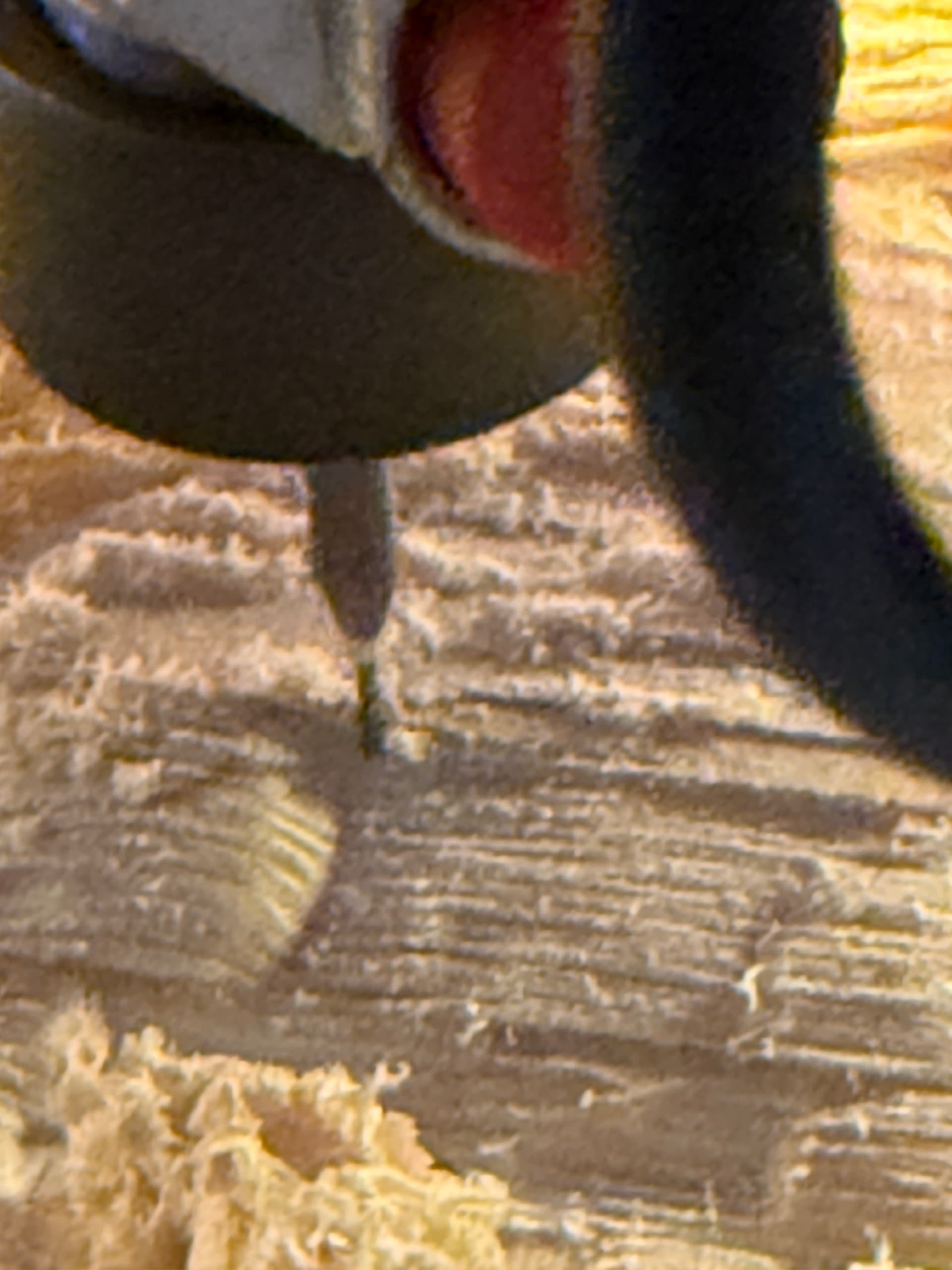

Tried again last night, this time with a finishing pass on a 1 mm ball nose, it came out much better! I also made the job larger in hopes of bringing out more detail. Only problem was my bit wasn’t set properly to cut at max depth so I was bottoming out at a lot of spots, and I used horizontal paths for both roughing and finishing, I think I’ll try the water lines technique next
I also realized that using the 5x zoom lens is like looking at this stuff through a microscope and it looks really trippy lol

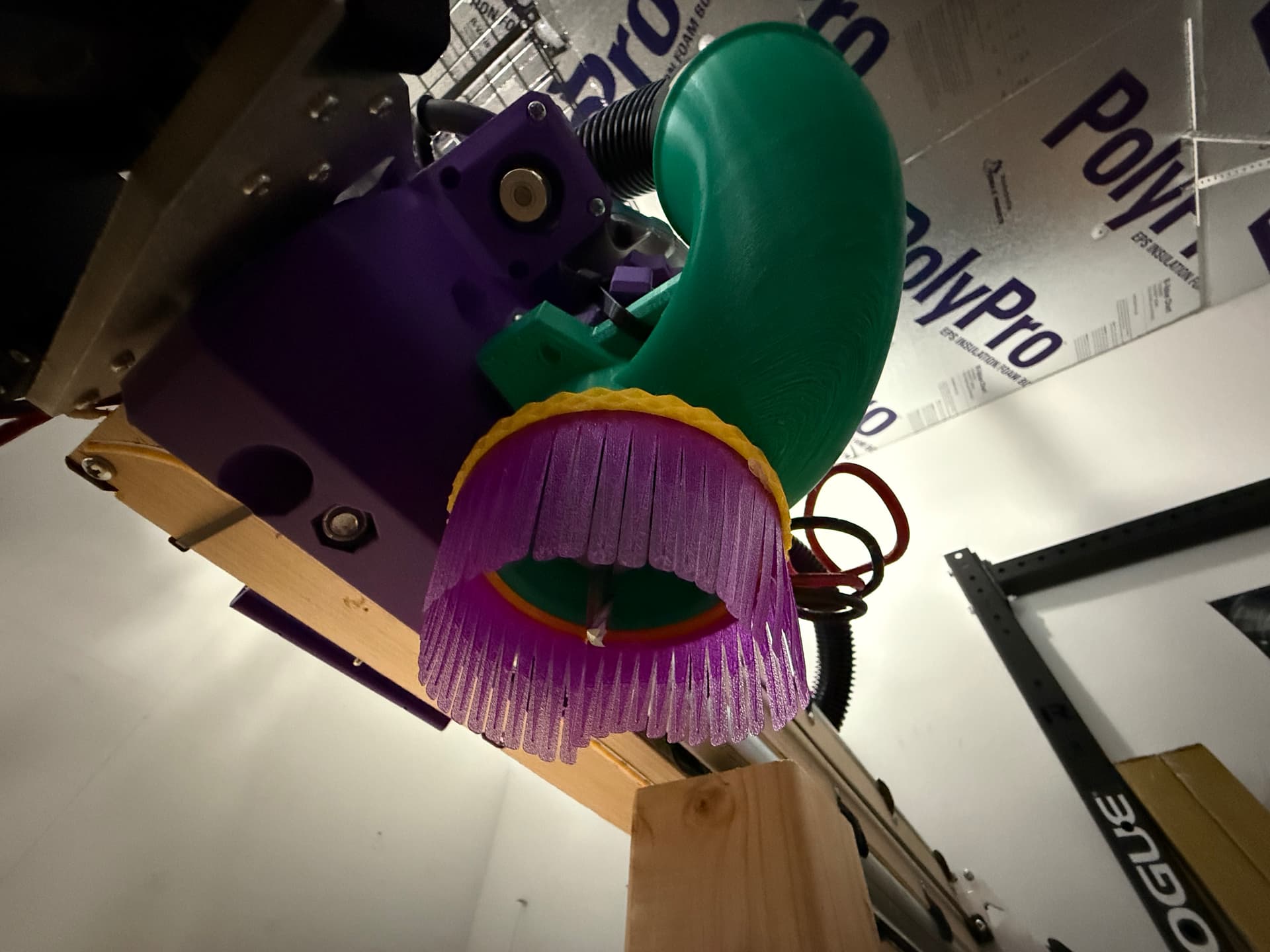

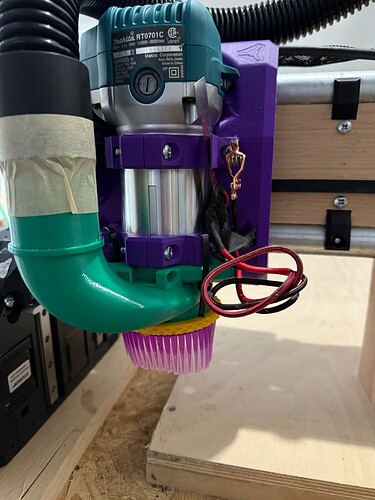

I did some experimenting with dust boots. The standard one in the printed parts files has two problems: the hose/airflow is not pointed at the bit, and the hose/airflow is far away from the bit.
I spent a lot of time taking measurements etc and then found this design: https://makerworld.com/models/1317443
It has a channel that points the air flow directly at the bit and brings said airflow much closer! Their quick attachment looks nice but I cracked one of the parts and said forget it, so I just ziptied it to the stock router holder. Eventually I’ll either re-print it the right way or figure out a magnetic solution, I’m just not in any sort of hurry to take stuff apart lol

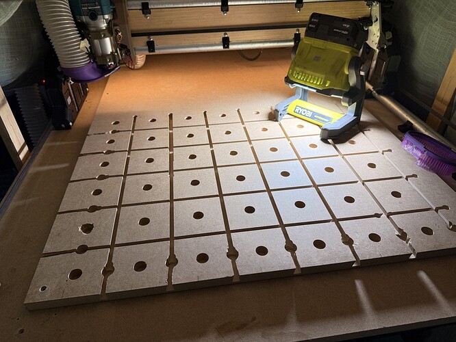

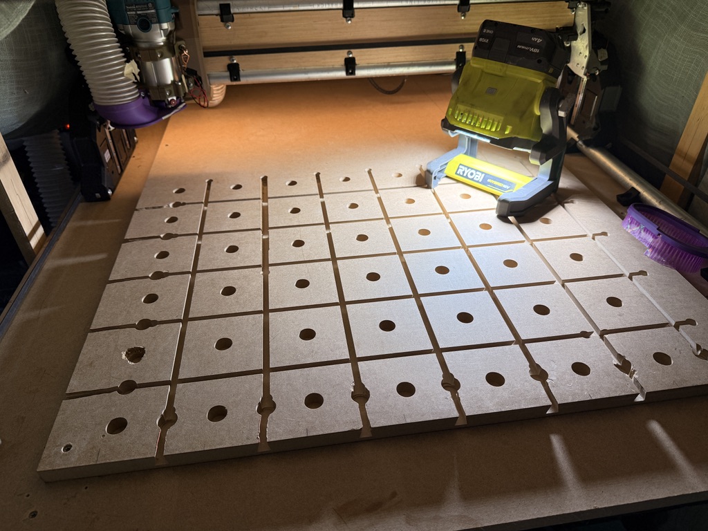

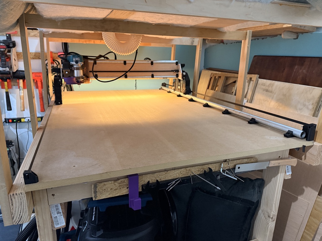

First time spoil board surfacing:

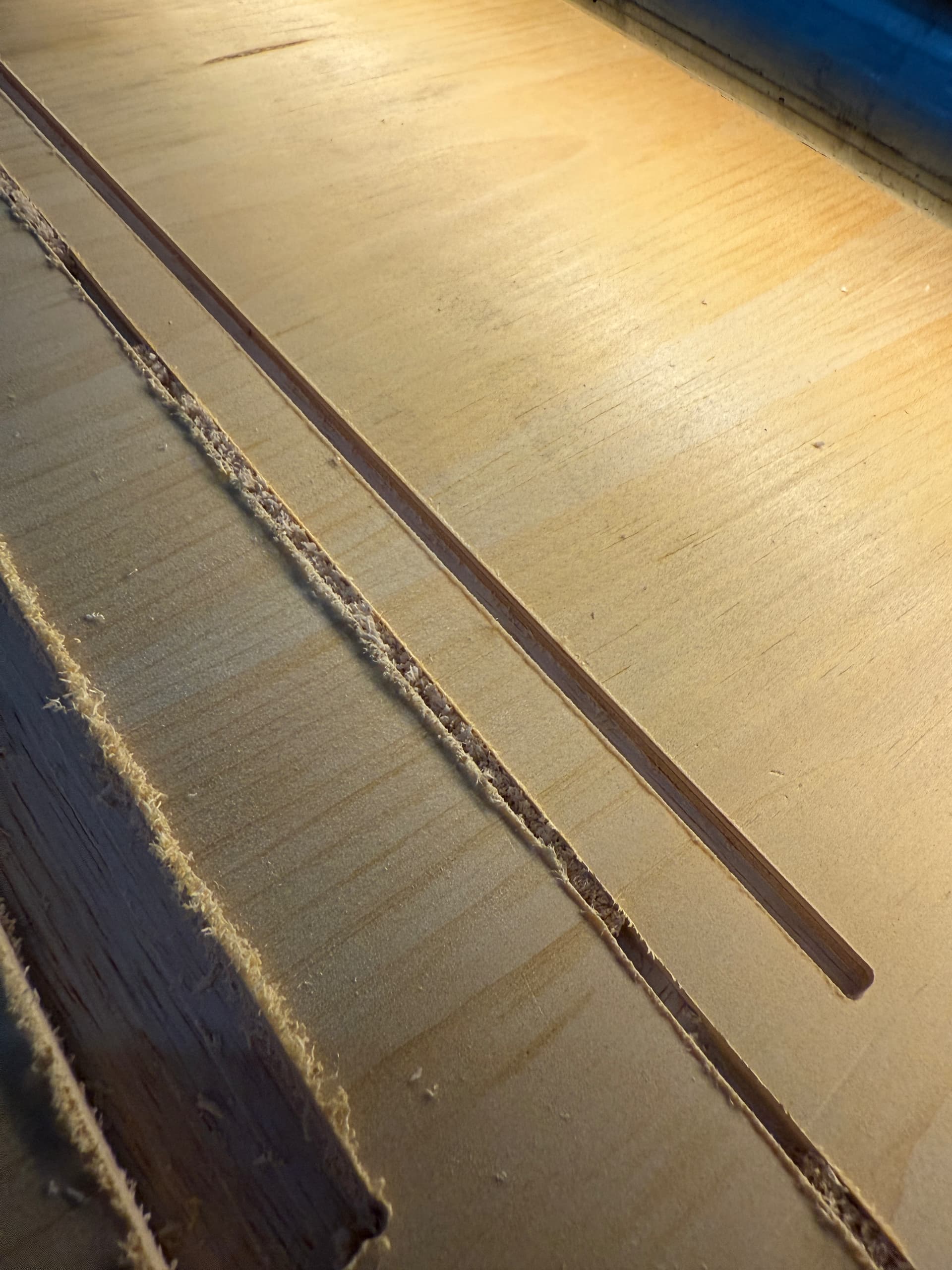

Shame on me for putting it off for so long, but I was having too much fun ignoring how uneven my table was :grin: Turns out my OSB table top had a bow to it because I didn’t have any screws holding it down in the middle :man_facepalming:. Just a learning moment! Screwed it into the “studs” or ribs of my table with 8 screws, very nice :+1: :+1:
Then I decided to use VCarve to make my spoil board pattern, first time using it for real. I probably wasted an hour trying to get its GCode to do what I wanted it to do.. eventually I wised up and just used good ol EstlCAM! Running it in Parallels on Mac works a lot better than via WINE, though WINE certainly gets the job done (and it’s free).
I bought a 2" surfacing bit on a whim (cheapo on amazon), but I was afraid to use it after seeing a post from Ryan somewhere saying those bits are much too big and that results will be poor, plus it’s a big heavy sharp thing whipping around, so it didn’t seem safe. Instead I’m surfacing with my biggest bit, a 6mm 2 flute upcut: 100 mm/s, 2 mm DOC (surfacing in 1 path), linear @ 60% step over. I started at 50 mm/s, but after a few passes I figured I’d pump those numbers up because I was getting dust. Going at 100 mm/s now and it’s going great (I hit pause to walk away for lunch). I’m sure I could go faster and much more efficiently, but this is working and is almost done haha. Will get a nicer surfacing bit for next time, running this in ~10 minutes would be a lot better than the ~30-40 mins that I have now.

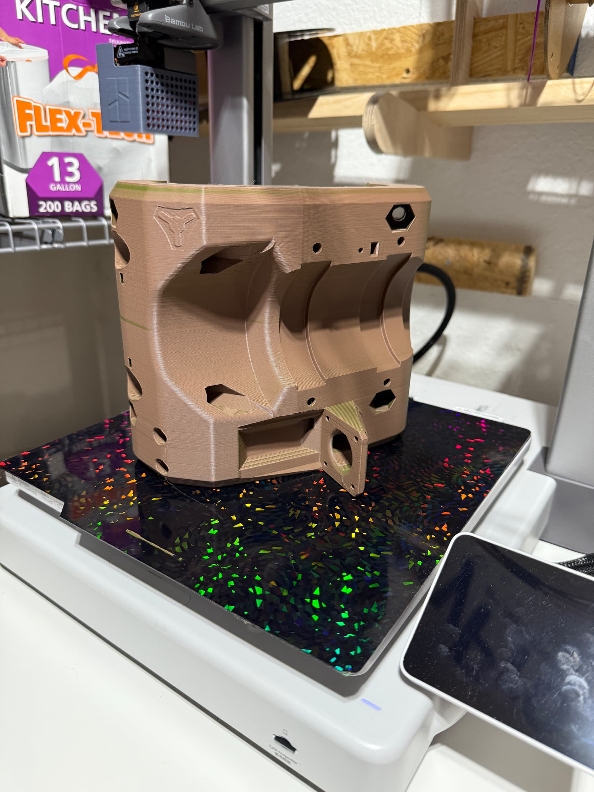

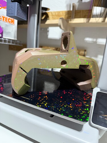

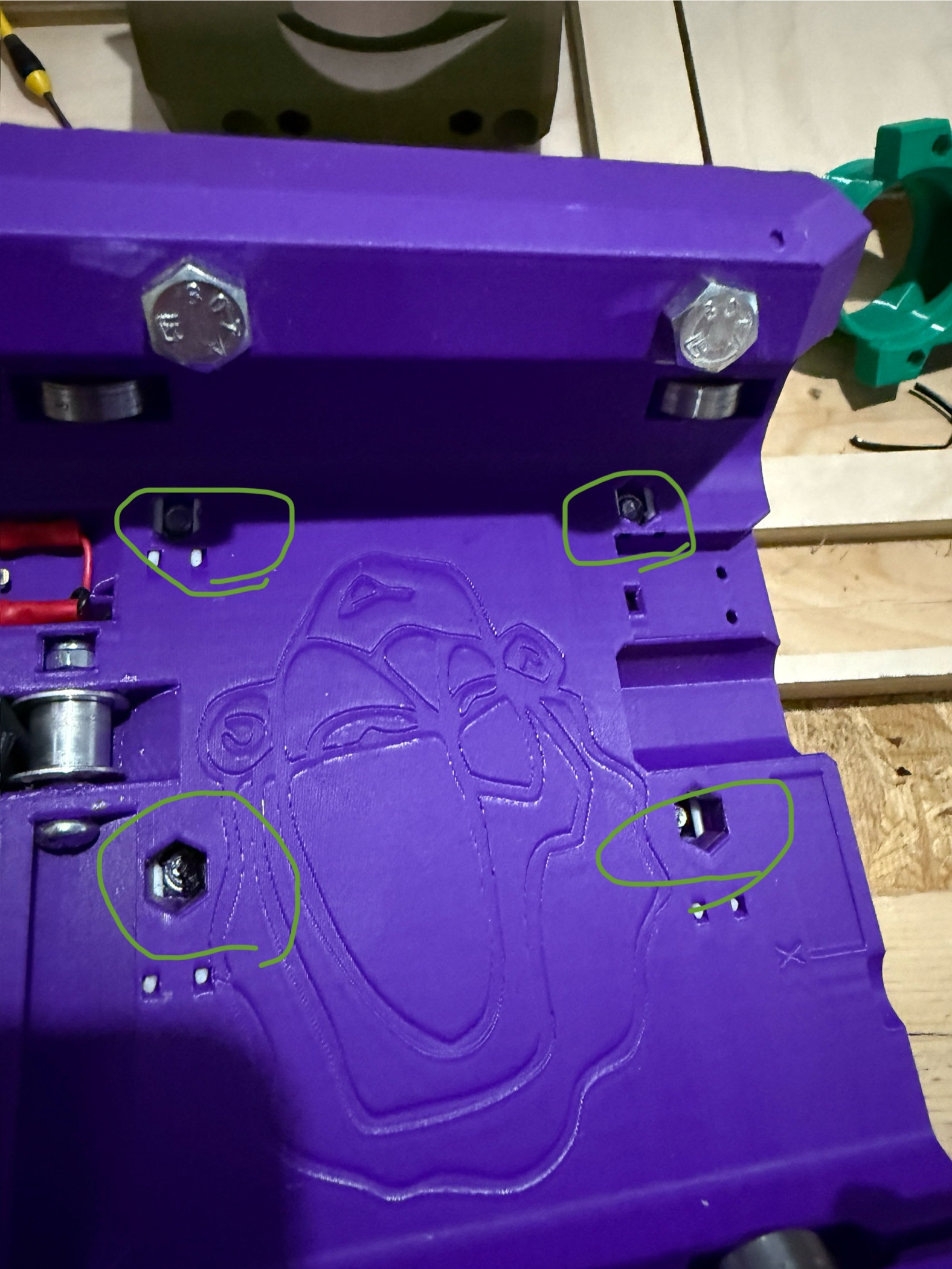

I ran out of my purple PLA+ filament so I used what I had on hand, this pretty green/brown PLA matte, and printed on a sparkly plate so one side of it will be repping the LGBT pride lol
The original core was the first real big thing I had ever printed so I didn’t have a real appreciation for the level of work that went into making it. Months later I’m still struggling with 2D CAD let alone a 3D behemoth like The Core (great terrible geology movie btw), so it’s cool having a new level of appreciation for this thing! The first go around, I had printed with supports so I’m sure the stripped nuts are a product of my frustration at the time dealing with ripping out supports etc… hoping round two goes much smoother :slight_smile:
Nice sparkles. Could you photo the old one where it failed? I am interested to be on the lookout should it show up again. Someone else reprinted a core recently though it may have not been the same model/version.
I understand you’re proud of the new sparkly core, but, you might be able to salvage the first core for your/someone’s future use using loctite glue to help keep the router mount nuts from spinning.
That’s a good point! I did try that but with weaker materials (hot glue, wrapping the nut in electrical tape), I also had some success by wedging small flat head screwdrivers in-between the nut and the plastic, but that quit working for me on these ones. I just applied some CA glue down around each nut, by wrapping a tiny flat head in masking tape and sort of shoving it down between the nut and plastic… will see if it works later today once it solidifies :slight_smile: That would save me so much time and effort lol thanks again for suggesting it!
Update: glue did not help :frowning: the stuff I have stayed a little gummy instead of hardening up. I think my options are to either dismantle and rebuild the new core, maybe get a different glue like JB weld? or… I could try drilling some holes on either side of each nut so that I could get some pliers in there and hold the nut? That might end up being more work than dismantle and rebuild?
It’ll have to wait a little bit either way, sliced my left pointer finger pretty good last night on a (thankfully) fresh razor blade (long craft knife). So while it heals up a bit, I got time to think of alternatives/buy something like the JB Weld.
You can pretty easily take off the core without having to do a full rebuild. :slightly_smiling_face:
Oh yeah that’s no problem, I had to get the core off to even mess with the glue etc. My bad for not posting pics, it would have been a lot more clear with them lol. Please see below, the nuts are circled in green:
So by “full rebuild” I meant “taking apart the purple core and putting all the pieces into the brown core”. Shouldn’t be too big a deal, I just hope I have enough bolts and nuts left over since I can’t remove 3 of those 4.
The only reason the plastic got stripped was because I didn’t see the note in the build guide about screwing the bolt into the nut to loosen up the nylock, prior to installing. So it got stuck and as a former power lifter, I applied too much monkey strength and broke stuff… c’est la vie I suppose
Gluing it is tricky, you need to surround the nut with epoxy, but not get any on the threads. Difficult in a small area like that.
Most pliers are usually too big (you would need a YUUGE gouge out of the core), and small needle nose pliers are usually too flimsy to hold any torque.
I had this issue with my LR3 core. I used a very small screwdriver jammed beside the nut to hold it from spinning.

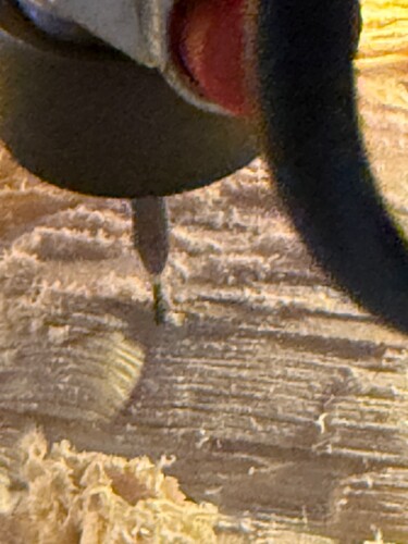

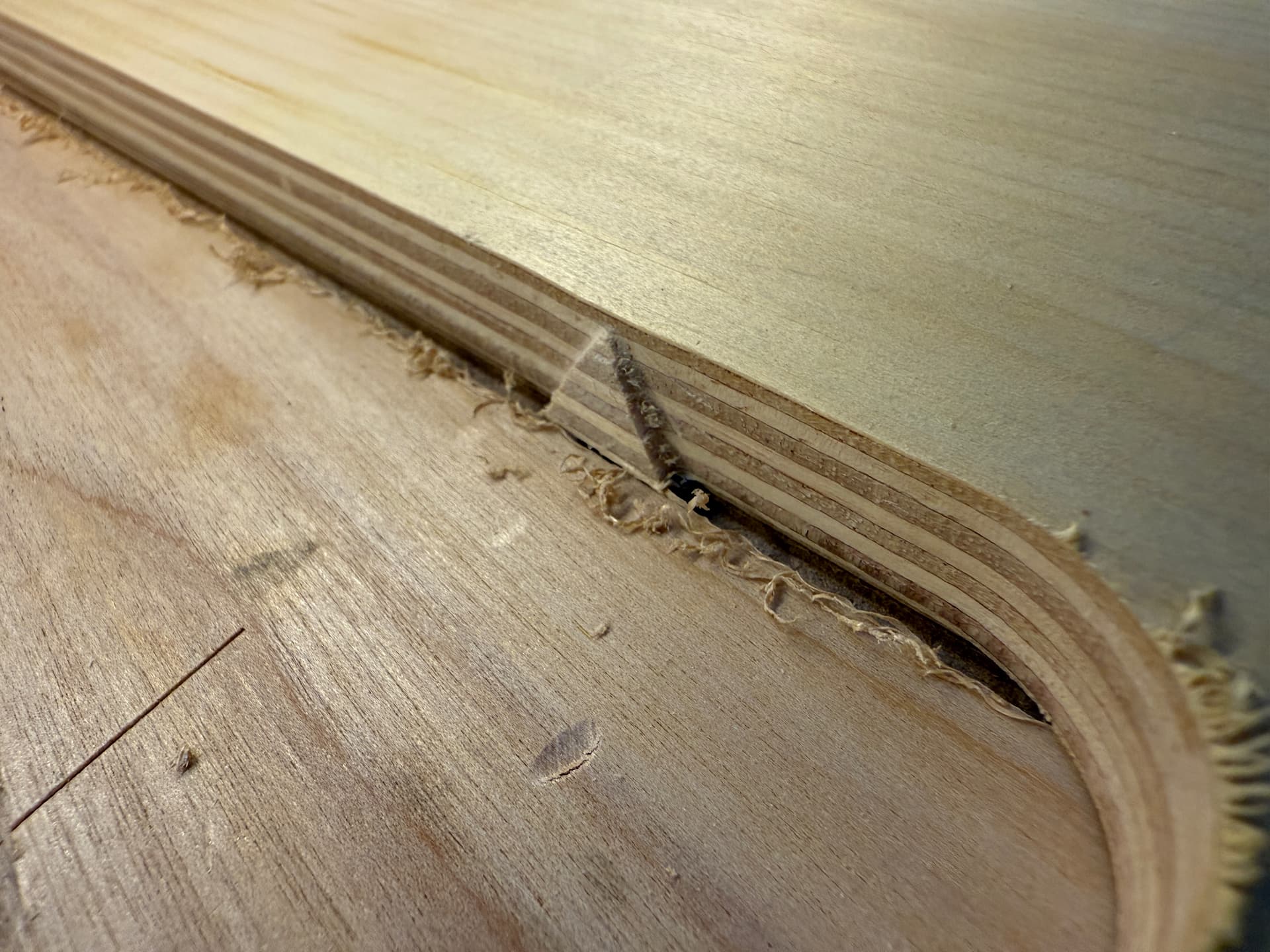

I finally got some time on the machine again, I fixed some problems and learned a lot! I was getting usable parts and pockets in plywood but they had wobbles and needed some serious sanding. Some things I did that made the experience much better:
  1. With Z homed, my X axis was ~2 mm low on the Xmin side! I only noticed bc I saw that one Z end stop was at max height and the other was at min extension, and I thought hmm that can’t be right. I adjusted the Z0 end stop a couple times and got it Damn Near Level. 4’ alu level with the bubble as in the middle as possible :smiling_face_with_sunglasses:
  2. I had to tighten the core-to-rail adjustment to eliminate some wobble. I was too scared of making it too tight, that it was always a little bit less than marginally tight.
  3. My feeds were wayyy too fast, I last tried 50 mm/s on the v1 1/8”. After seeing many posts from Ryan about how slow he cuts because it works on the first try, every time, and I took that advice! Dropped it down to 15 mm/s, it took longer to cut but I have the time and it’s fascinating to watch… plus it worked on the first try!
  4. I swapped in a fresh bit and could feel by hand how sharp it was compared to the bit I was using

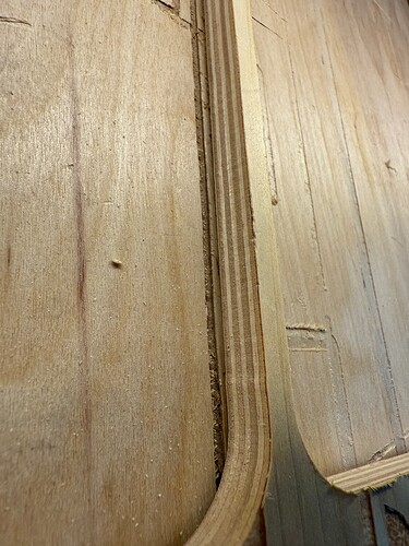

Some comparisons before and after the above changes. It’s truly amazing how well the lowrider works even with multiple things out of spec! She’s cutting laser beams now!
Fuzzy cut is old, clean cut is new:
Waves left in the workpiece before, no more waves and a crispy clean holding tab now:
This feels great :slight_smile: to not only have it working really well, but knowing WHY it works well. I really love this thing, I’m so appreciative of this product and community <3

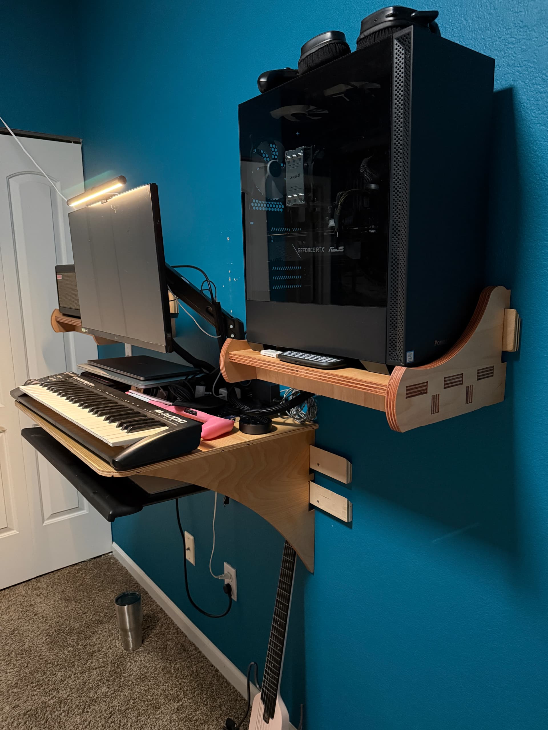

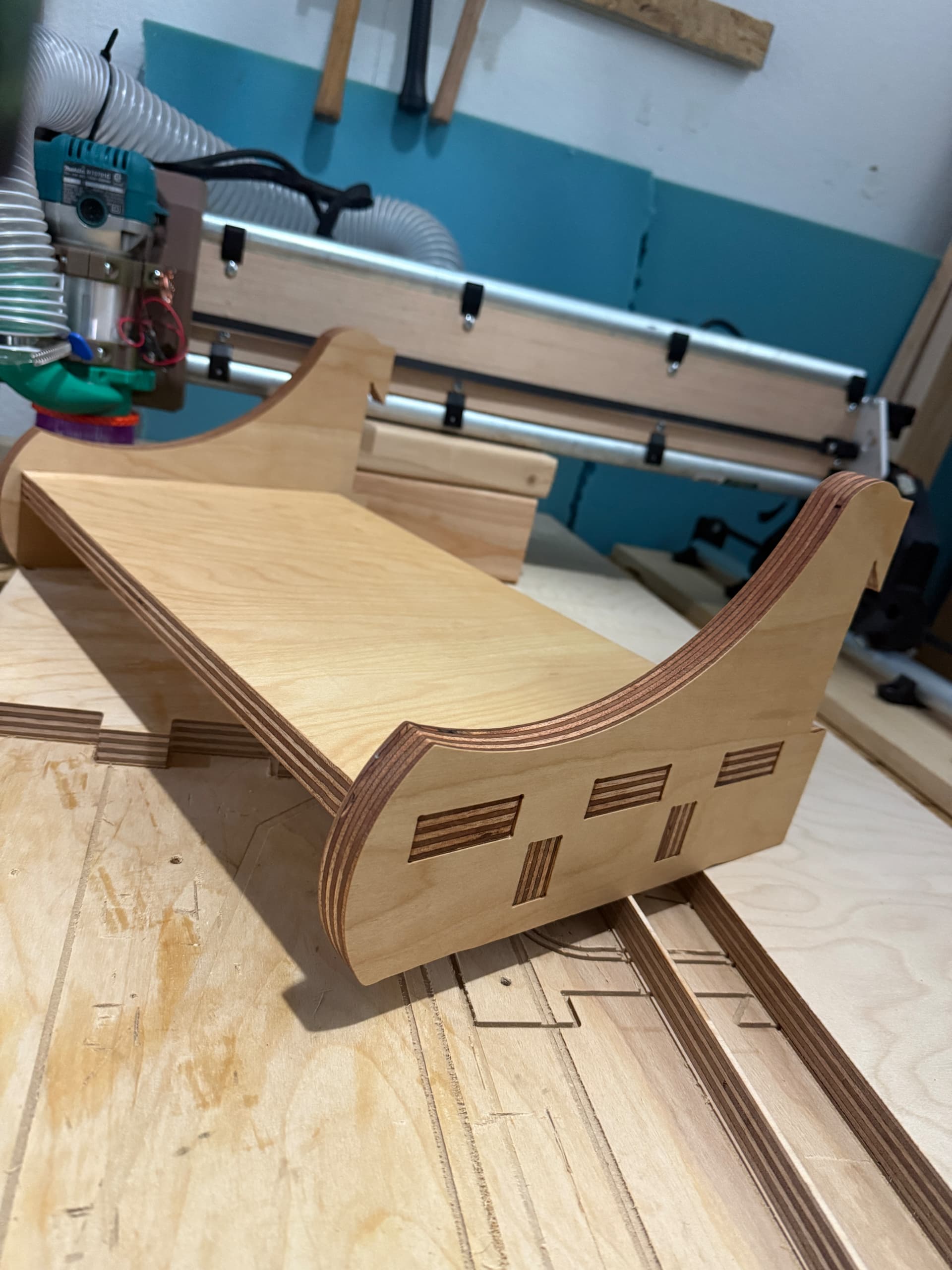

I got to experience 3/4” (19 mm) thick plywood, both a maple and a Baltic birch, and it is amazing compared to the thinner stuff! It turns out the thick wood stays flatter and more rigid while being cut, so I got nicer cuts overall (due to less vibration in the wood?) and the finished pieces are just beautiful and so substantial!
I’ve been getting better at finishing the wood now too :slight_smile: I used to chew everything up with the random orbit and some coarse grit stuff. Turns out it’s way easier to just hit it by hand once over with some 600-1500 grit (I got a ridiculous variety pack of lil sandpaper squares on Amazon, this range had best performance IMO). I then wiped off all the fine dust (crucial), applied some linseed + bees wax, spread it around with a plastic putty knife, wipe off the excess, one and done.
I made two of these shelves, to hold my computer tower and guitar amp. Solid as a rock with the cross beams and being 19 mm thicccc
Will make a proper thread on them and my other French cleat desk/office stuff once I get it all figured out. Sneak preview below:

Long time without an update! I tried carving name plates for my coworkers, but that showed me my table wasn’t flat enough ( What holiday gifts are you making? ) so I replaced my OSB top with MDF. Much better, but still had a bow/sag, so I took the top off again and did my best to shim the table to be level across (more detail and pics in the linked thread).
Now that my table is nice and flat-flat, I was able to carve the name plates across basically my full X axis just about perfectly (meaning nobody would notice but the guy who made it lol). But then… Murphy struck.
