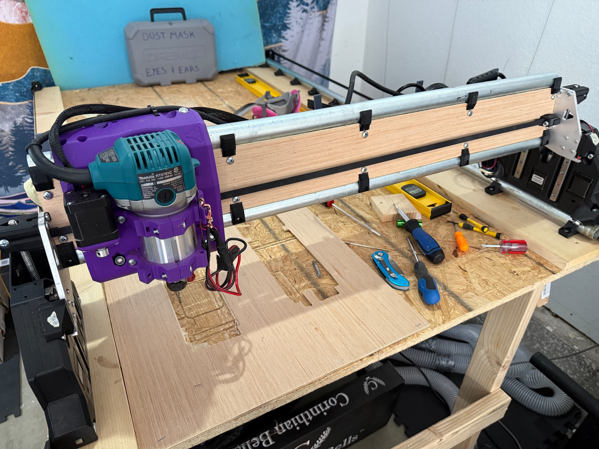

LR4 build by a complete newbie

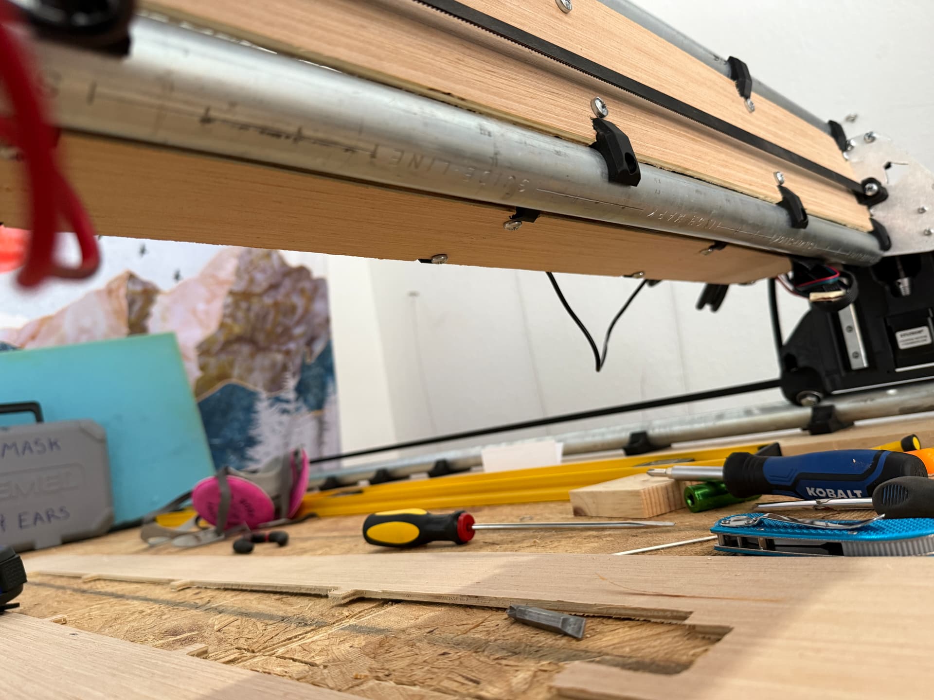

Oh something else I thought of, when I power it down, only one side drops down (X0). If I manually raise the low side by twisting the lead screw, I can get to a point where the other side will fall evenly with it. I’m not entirely sure what to do to get them to stay level and aligned.
Also I’m pretty sure when I homed Y after one of my tests, they were not even and Y-Max was last to hit its end stop. Y-Max end stop has the adjustment screw sticking out a decent amount, and Y-Min isn’t using a screw at all. After pulling off and re-homing, it was even and hit the switches at the same time again.
Sorry for the info dump, and thank you for the help!
This is normal. Assuming your core with the router is at X0 its that weight that pulls it down. Nothing to worry about. The machine is designed to allow for that. And when you start it back up and home it brings it right back level where it should be. If you power down and it doesn’t go down then its past time to lube your lead screws.
This most likely means that the Y max side had skipped steps at some point since you last homed. But once you homed it brought it back straight and that’s why they hit at the same time the second time you homed.

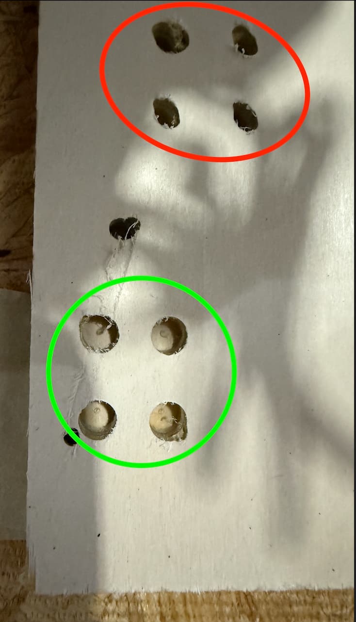

well, I think that might have been the solution! Two of them look about perfect, and the other two that have a little extra piece taken out, the little extra bit is only on the top layer of the ply. The ply is from the cheap offcuts pile at the local lumber yard, so I wouldn’t be surprised if it was just low quality wood unable to keep it together?
(first and worst attempt circled in red, that was with a loose core)
This was cut at 5 mm/s Fx and 1 mm/s Fz

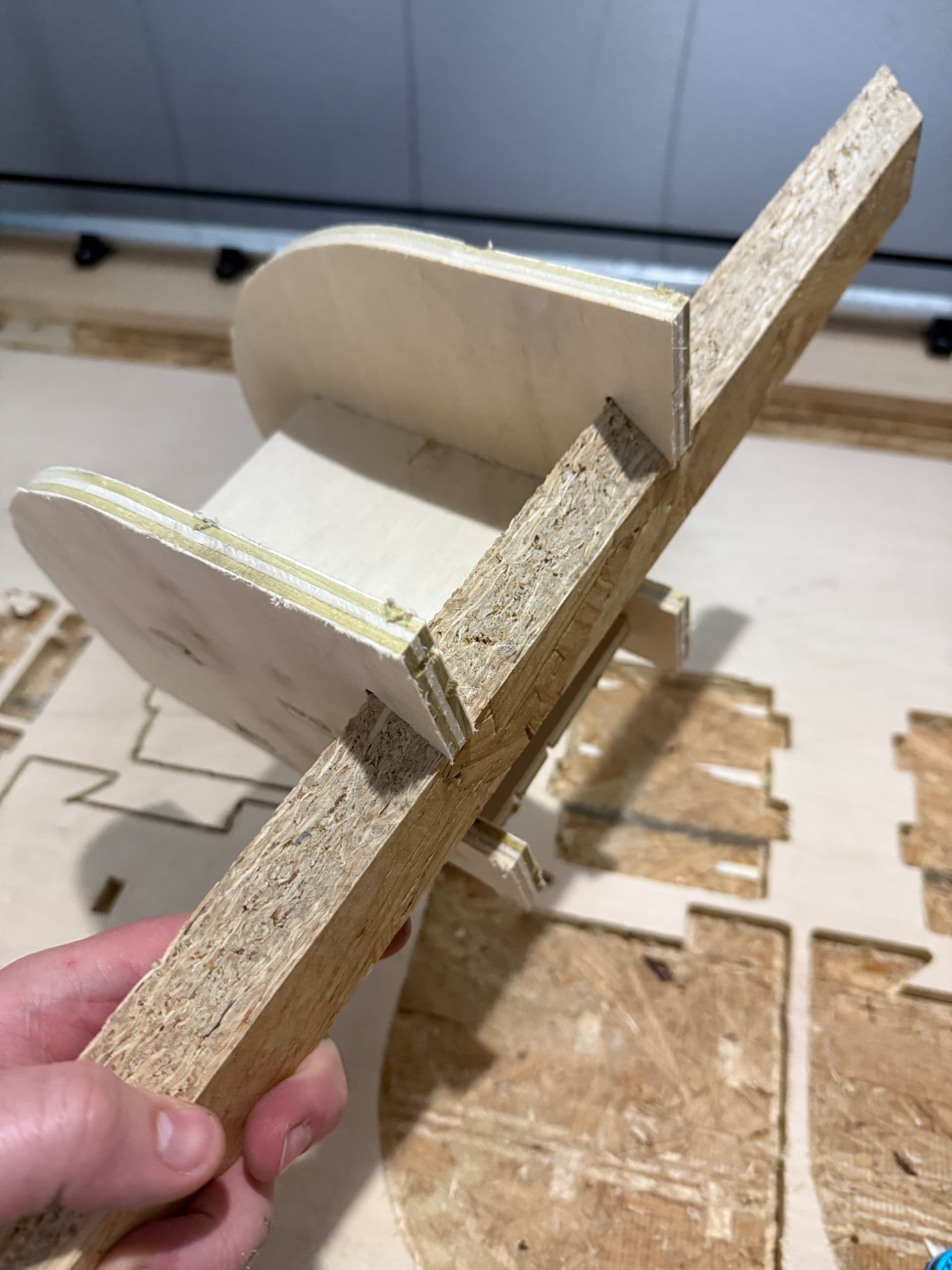

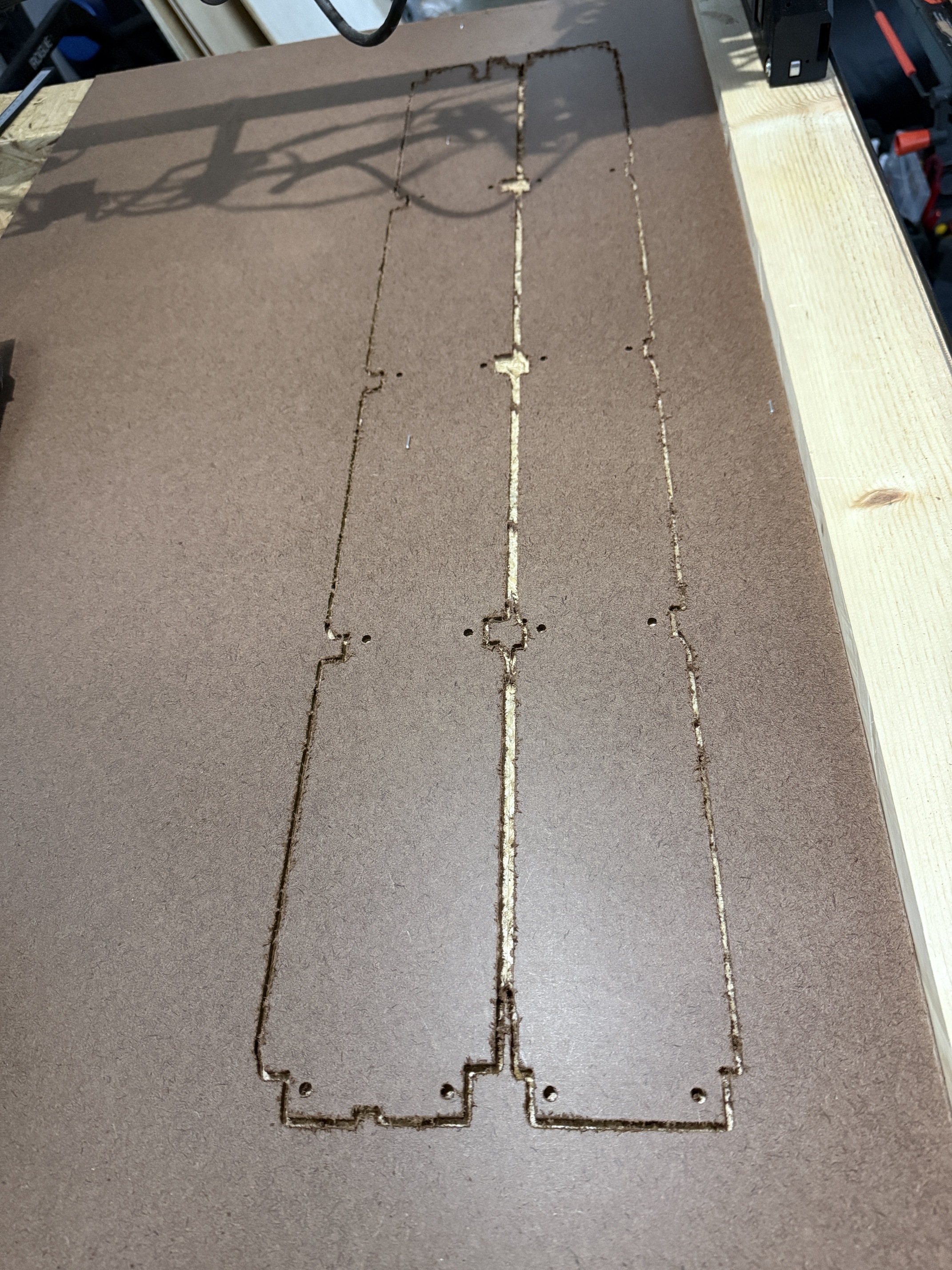

I spoke too soon boys (gender neutral)… somehow the braces are too tall to fit in the struts by a couple mm, the holes are not aligned with one another (though they are pretty circular), sharp right angles aren’t always cut right/they have a taper to them. Of course I didn’t realize this until I took the temp braces and core off…but I did some very much necessary wiring cleanup and got the temp struts back together. Got it all back together and realized my X motor got flipped around so I said to hell with it and took a late lunch break.
I’m wondering if I have stretched belts, either from accidentally over tightening, or from the machine crashing off the rails a time or two… I have a spare roll of belt, so I think I’ll replace them for good measure either way. It’s super easy if you (masking)tape the end of the new belt to the end of the old one, and just pull it through :slight_smile: To start a new belt without one in there already, I’d tape a PETG filament piece to it and curve it hard, and use that as a lead-in device. Just a tip for those who didn’t know it yet. I’ll give this a shot in a bit and will report back.

Do you have some pics of how the struts don’t fit? Something seems very off. Stretched belts is very unlikely. I have only ever done that once and it was super obvious in the section it happened. And that was outside forces that caused it, not the LR4. You will skip steps before you stretch a belt.
I am wondering if you used the wrong operation to cut your struts making them come out incorrect sized.

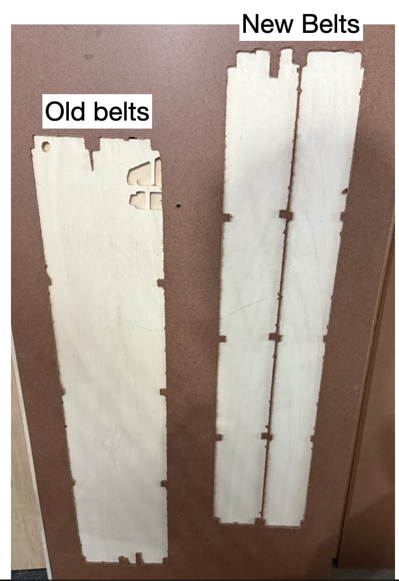

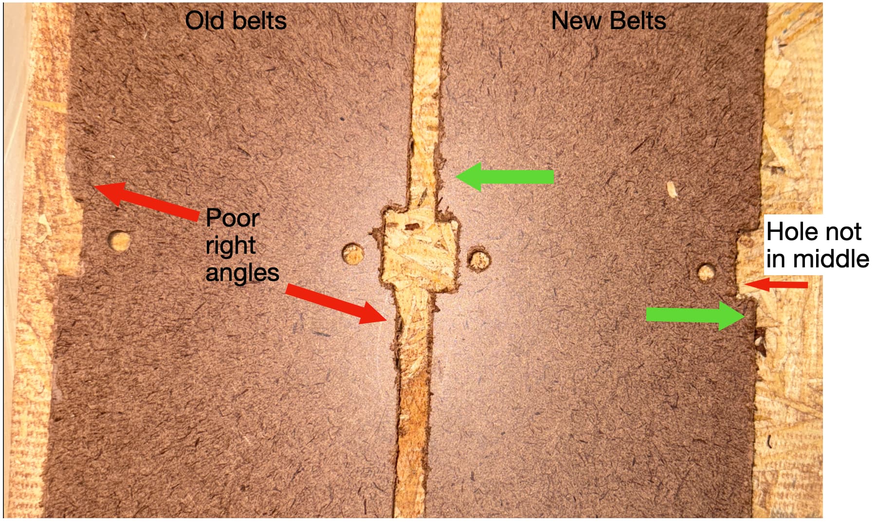

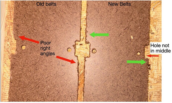

I re-cut the struts on the same material as before, same bit, same gcode, and the results are much improved but still some problems:
  • The lines are now straight
  • The braceheights are now consistent and correctly sized, ~2 mm smaller than before
  • Holes are perfect circle shapes IMO and consistent depths
  • The Problems
  • The holes are not aligned in their respective brace, and they seem to be differently positioned in each brace
  • Homing after the cuts showed Y Max taking longer to hit home, meaning steps were still skipped?

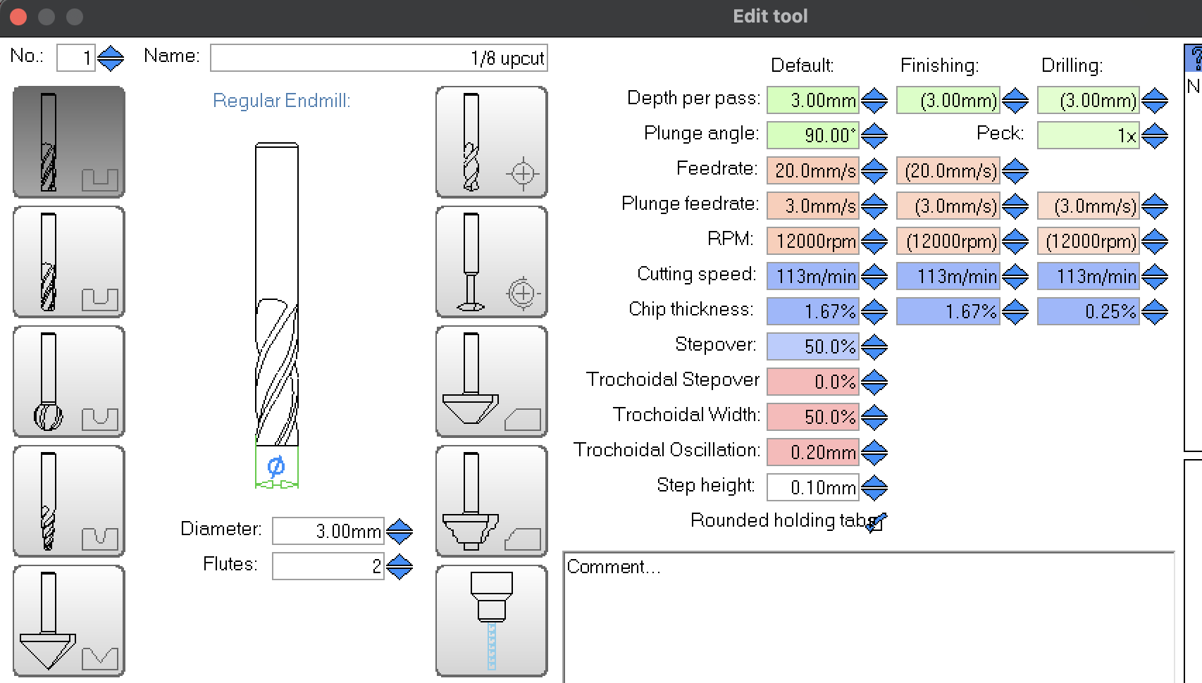

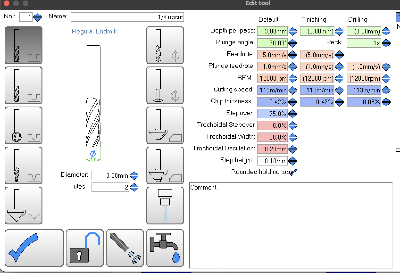

  • Bit: 3mm 2 flute upcut spetool, brand new and fully seated
  • Router: Makita router on dial setting #2
  • Major Settings: 5 mm/s Fx, 1 mm/s Fz, 3.75 mm cutting depth all in one pass (the hardboard is ~3.4 mm thick)
  • GCode made in Estlcam. Braces were CAMed via “Part” tool path button, holes were made with “Hole” tool path button
Pics:
Just comparing the braces that were closest to X0, since I realized that cutting the second brace to the right is likely too far out for the temp brace to handle
You can also see the overall improvement in the outlines left behind:
The edges seem to indicate that the stock may be lifting or moving during cutting. This can happen with thin MDF or hardboard.
I suggest to set up the cuts in EstlCAM to cut all of your screw holes first, followed by the parts. Then edit your g-code (w/ Notepad) to put a pause between the screw holes and the Parts. Once the screw holes are actually cut and the job is paused, then put a small wood screw into each hole. That will hold the MDF/hardboard to the spoilboard, with minimal movement during cutting.
Also I suggest you use a finishing pass (approx 10% of tool diameter), then VERY lightly sand the edges of struts after cutting.
You are skipping steps. That’s why its not lining up properly.
I agree with @Bartman to do your screw holes first, then you can put a screw through some of the holes and then do the part cut. That will help hold the material down better.
You might need to do 2 passes if you are still skipping steps. I wouldn’t think you would be with the settings you are running, but I never tried to cut struts with the temp braces so I am not sure how much weaker it is that way.

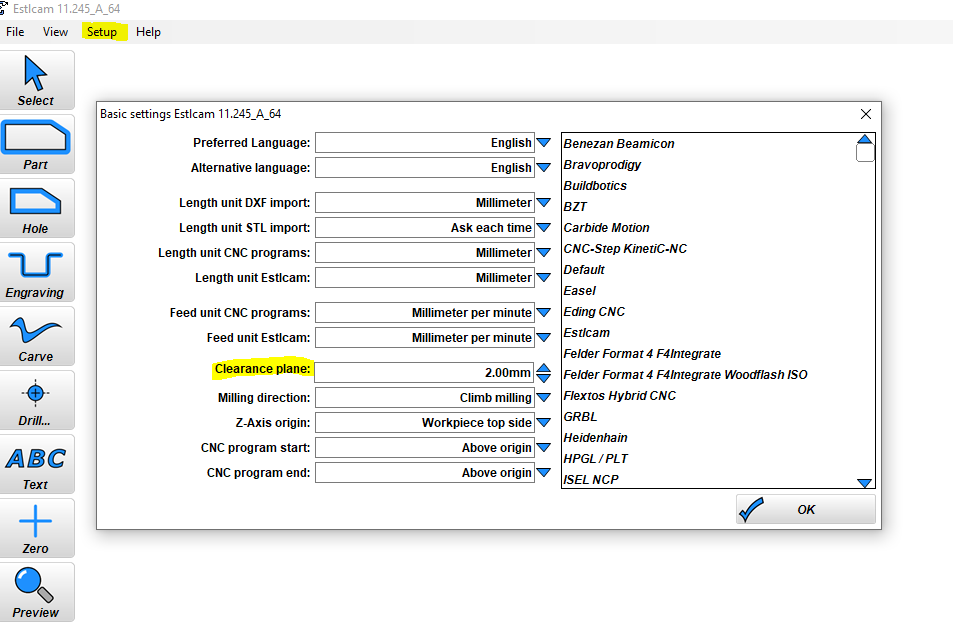

I did the same thing on my first set of struts. You may need to increase the Clearance Plane in EstlCAM.
Go to Setup - Basic Settings, then select Clearance Plane. You should set it for at least 6mm, and up to 10mm, depending on the screw head height.
EstlCAM Clearance

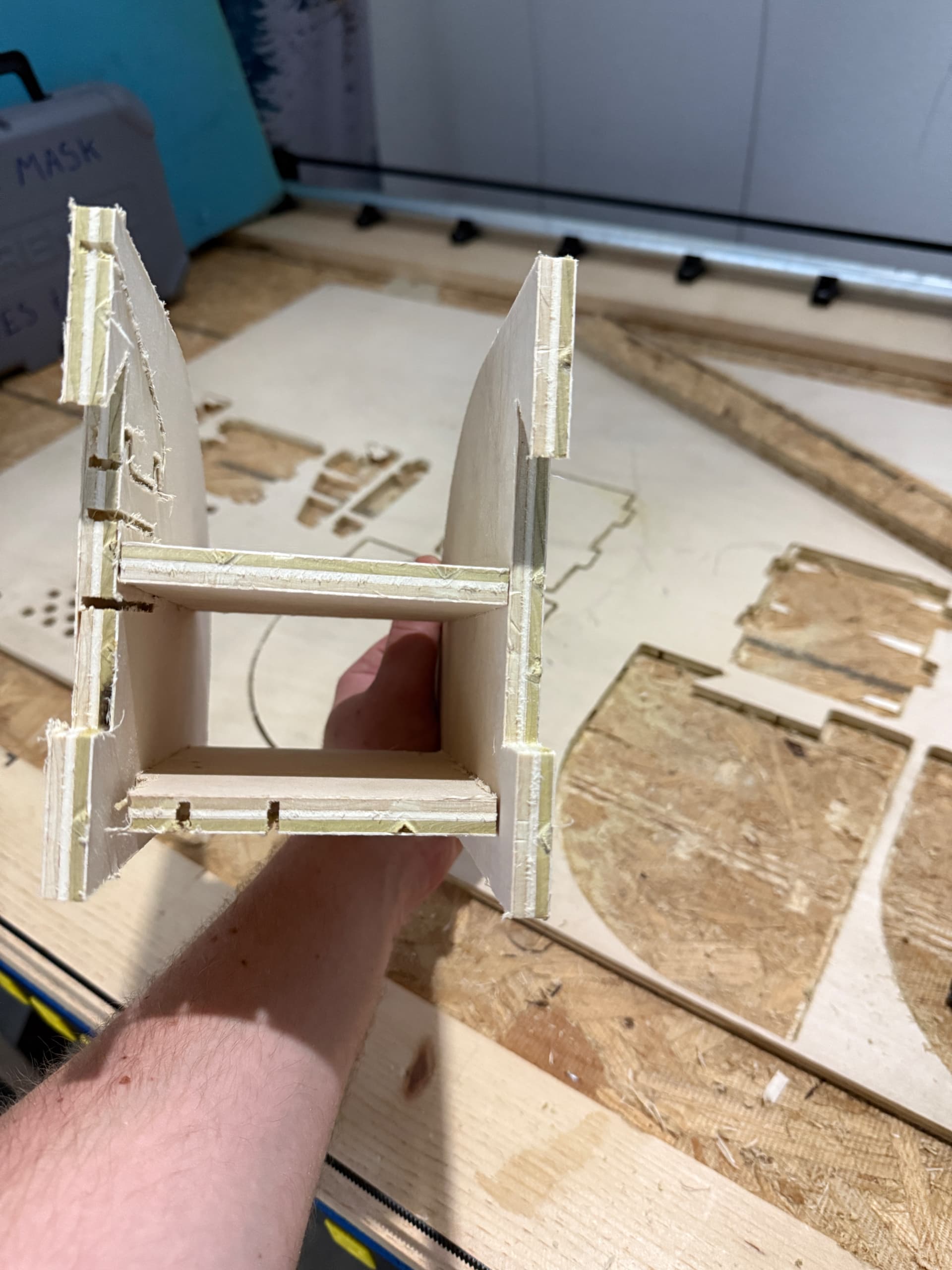

OK I think we finally did it! Bottom plate snapped right into place :smiling_face_with_sunglasses:

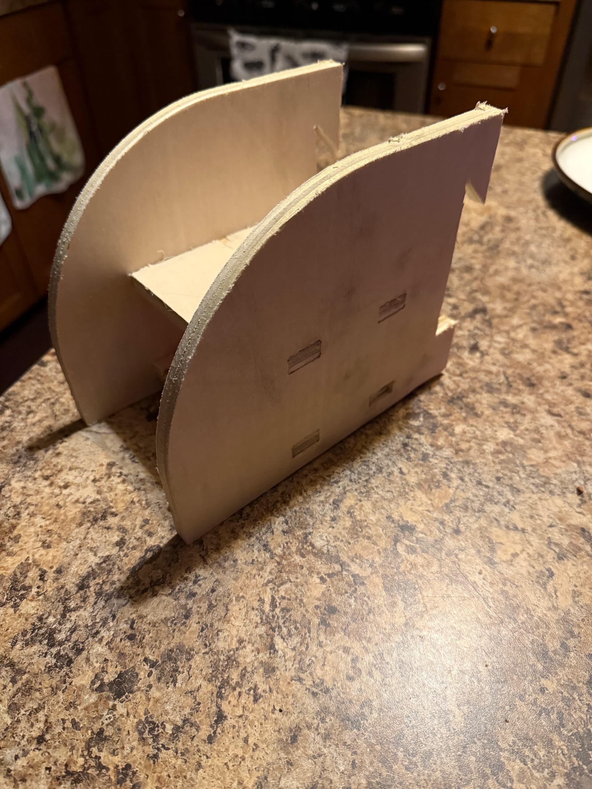

Anyways to cap off a successful weekend (thanks again yall!) I tried my hand at making a French cleat “unit” for my computer monitor to clamp onto… first ever thing I edited heavily in CAD (it’s based on @Tokoloshe ‘s cordless drill holder) and then made on the CNC! It ended up a little jank because it’s scrap wood that already had cuts in it, and the first attempt my Y Max grub screw came loose again so I loctited it back in and cut again. I went to press the pieces together and was like “uhh why it no fit? CNC must be broken again” and then :light_bulb: the tab and the opening are the exact same size!! So I hit it with a mallet and it went together like a dream (minus the cracked and broken parts from the scrap wood lolll)
It’s damn beautiful and I’m so excited to bring it to work tomorrow and show the boys lol
