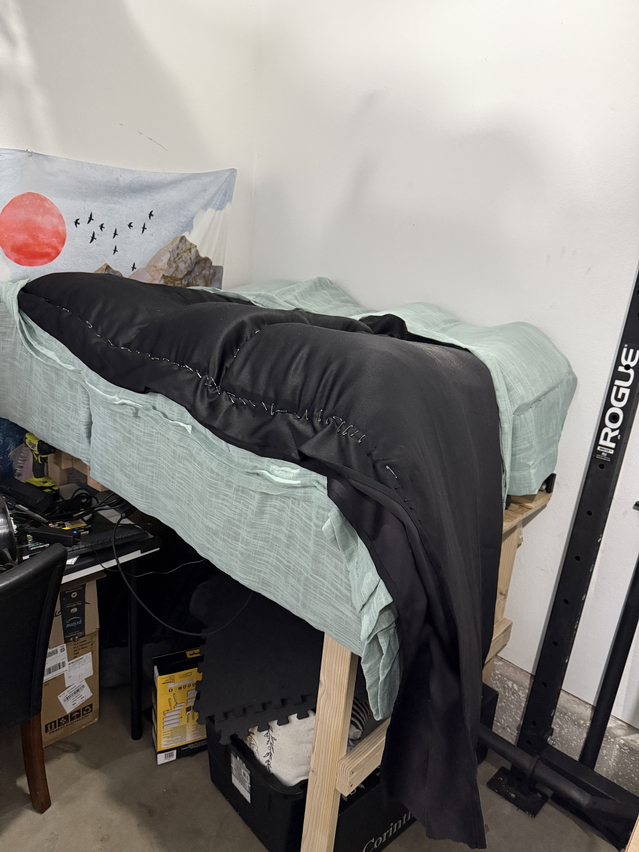

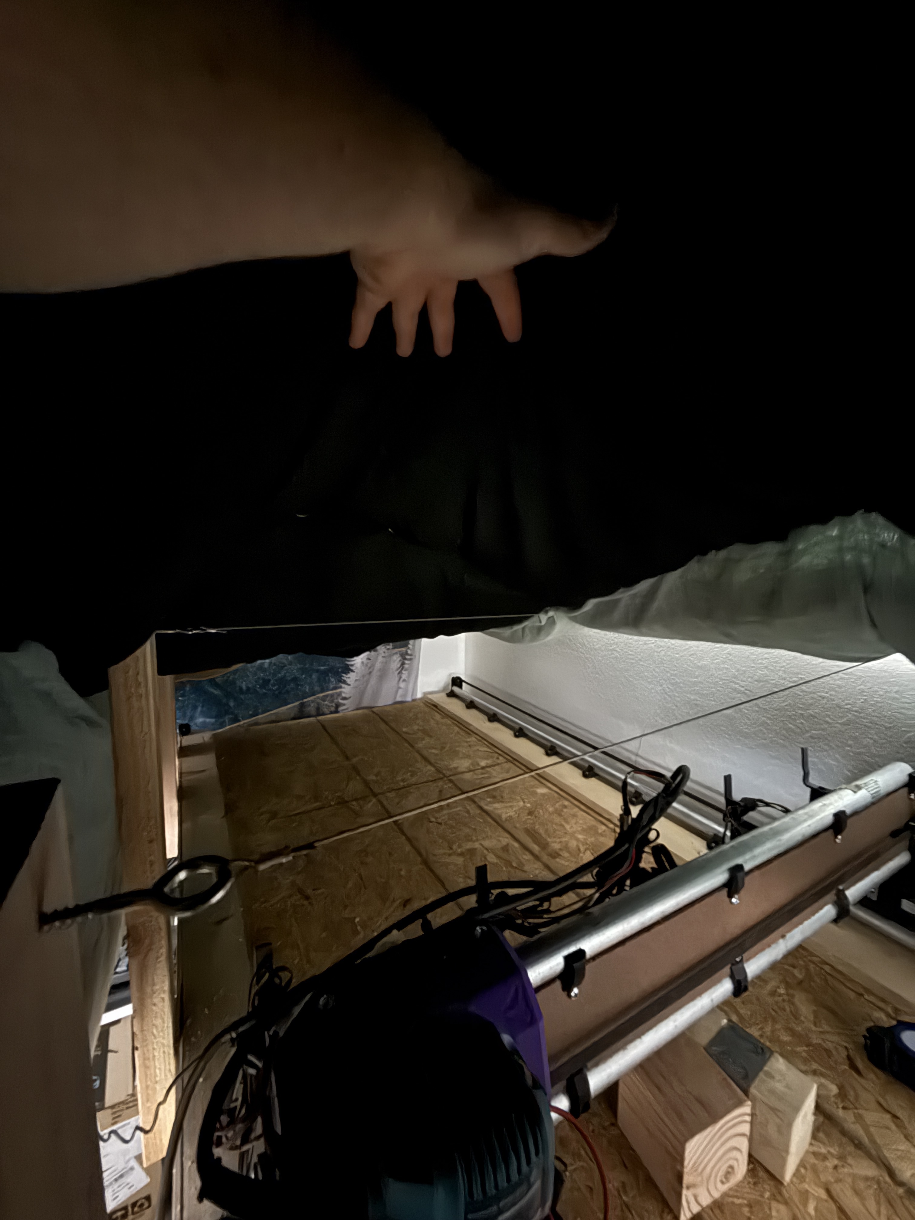

So prior to realizing my build wasn’t square, I knew the machine was way too loud to be used casually in our attached garage. And that’s a bummer because it’s my robot, and I want to use it casually lol.
I knew I wanted some kind of soundproof enclosure, but I also knew adding mass to the top of the table would be bad news, so I struggled for a while to think of something that’d work. But eventually it hit me…
I had some old curtains in my “diy scraps” box, and a giant baffle of rockwool insulation, so I essentially turned the curtains into pillows stuffed with 3” thick rockwool :smiley: To drape them over my table without adding too much wobble inducing mass, I attached QTY4 2x4s along Y0 sticking up vertically (plenty tall to clear the machine). Y1 is along the wall, where I mounted QTY4 steel eyes into the studs, parallel to the 2x4s. I then connected steel cable (that stuff is so cheap wtf) from the 2x4 to the respective eye-in-stud, so it’s kinda like a suspension bridge?
Anyways, I draped the heavy ass “sound proof curtain” over top of it, and holy crap does it work!! I mean it’s far from perfect, but for a “hey let’s see if this works”? It definitely works!
…it just looks stupid :rofl:
I don’t have dB numbers yet, haven’t bothered since it has obvious improvements to be made as the back and Y1 wall are totally exposed and free to echo. I need to stuff rockwool under the table too, luckily I still have more lol. Will share an update when I have it better sorted out

Oh absolutely agree with all of that! And I’m glad you bring it up because I (and I’m sure many others) assumed you could just let it work like you would a 3DP.
A crucial detail missing in my sound proofing post is that I can easily lift up any part of the curtain and take a peek at what it’s doing, so it’s not flying blind :). I either stare at it in awe the entire time, or watch it get started and then stand right next to it and periodically (every few seconds) check in by peeking thru the curtains. I also keep a fire extinguisher on hand at all times just in case.

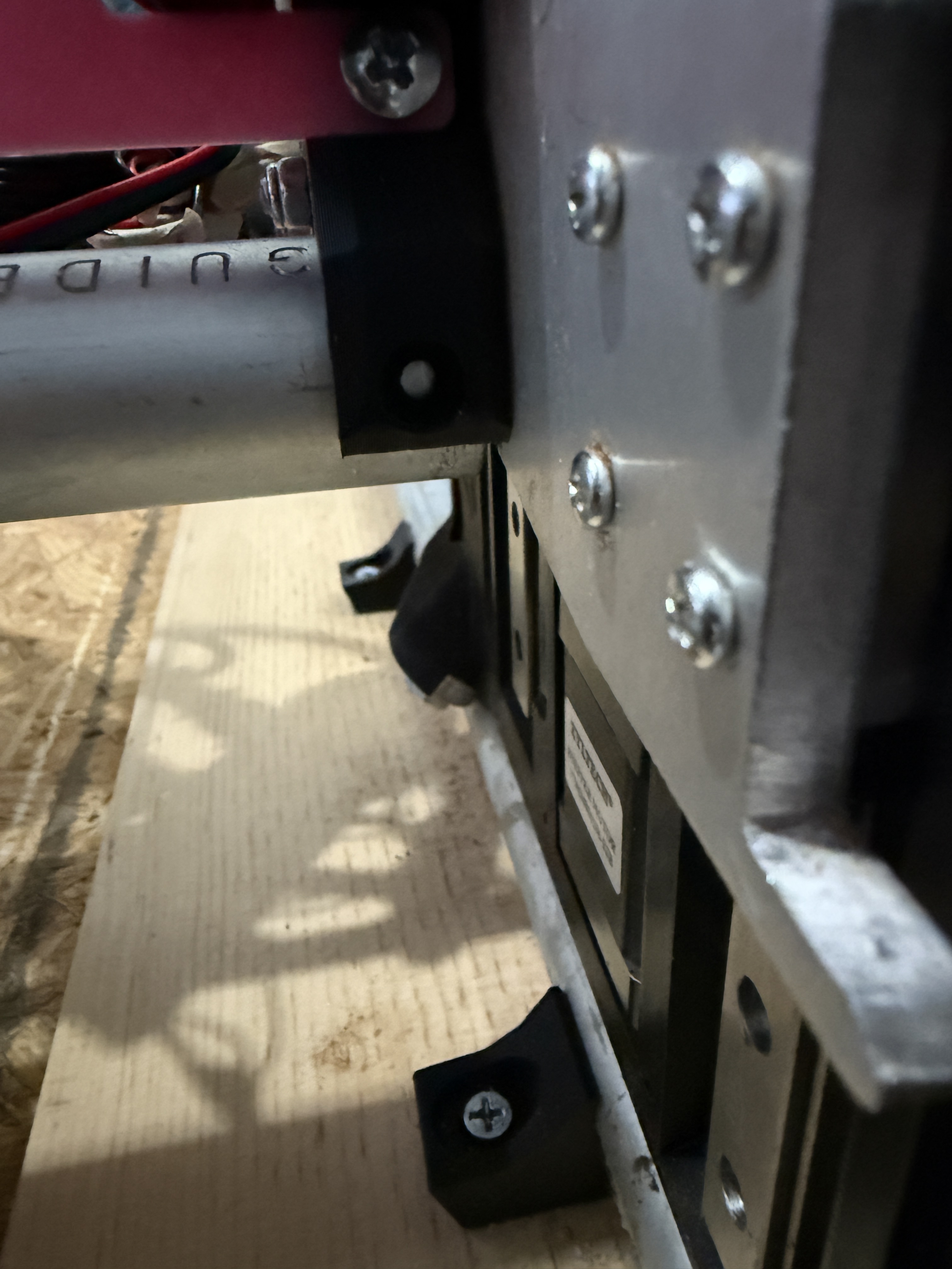

I would guess that your endstops (the part that the Y limit switches touch against) aren’t attached to the table squarely. I think that you should be able to use the small screws on the endstops to get within a few mm, without using the offset, but you may need to reposition the endstops first. (I have an LR3, not an LR4, so maybe someone else can chime in here if I’m out to lunch…)
Maybe post some pictures of your table, with the endstops clearly shown.
Ooo yeah good call on the endstops, I’ll investigate those right now as best as I can… Earlier when I thought my setup was good to go, I moved the table to the back corner of my garage and it’ll be a royal PITA to pull it back out… I mean I’ll do it if I have to, but not tonight lol.

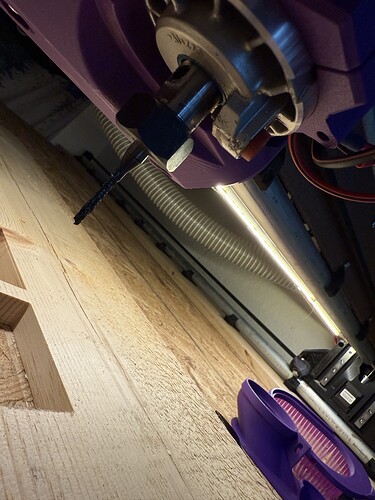

I pulled my table out from the corner and did some things, took some measurements, would love a diagnosis:
  • I removed my sound dampening curtain and the 2x4’s holding it up, turning it into a more basic table
  • Surprisingly, my end stop width only differed by ~0.75 mm (0.75 mm wider in the back/YMax)
  • My table is level now, I raised the front like 1.5"… the garage floor tilt is no joke!
  • I made sure my grub screws are solid with purple loctite, my X rails aren’t touching the XY plates, my Z screws are lubed
  • Now on to what my problems most definitely are:

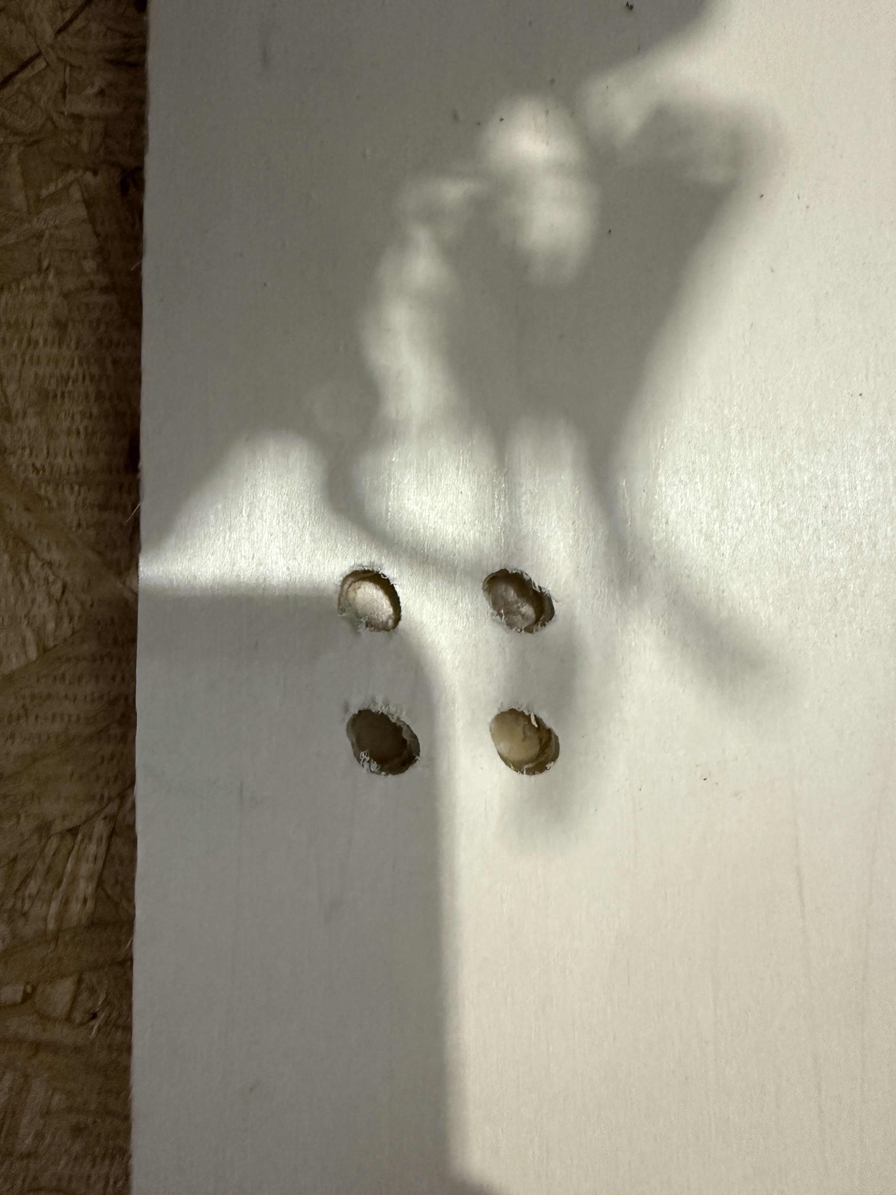

  • My heel toe is off by 3 mm, wider up front. I have messed with this so many times and I can get them even, but it seems they get pulled out of whack. I checked all the screws and they’re tight but not too tight I don’t think (temp struts)
  • When I run the automated squareness test, it cuts ~2.5 mm deeper at X Max than X Min, for both Y Max and Y Min

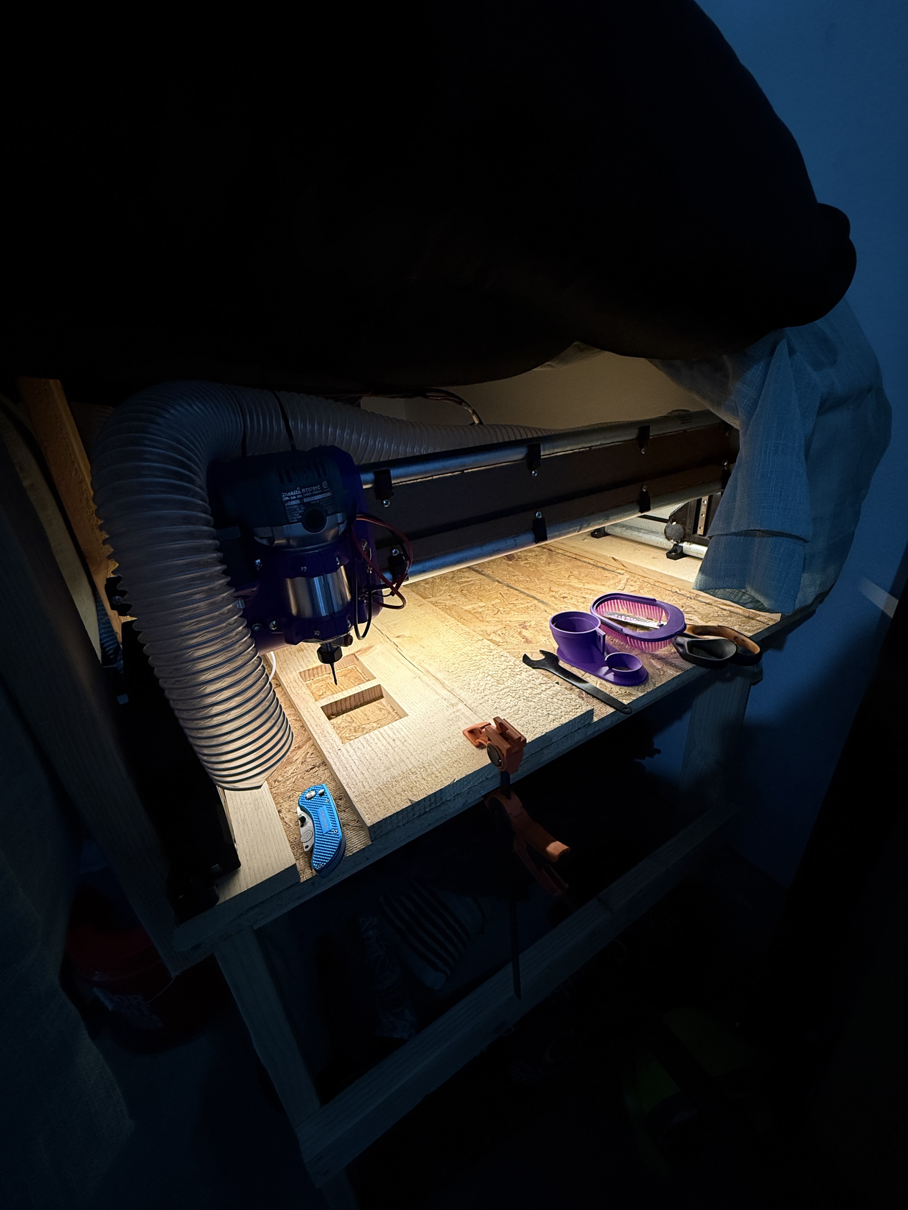

  • I saw a bunch of stuff about drop tables and was always like “why wouldn’t you want some extra cutting depth?” so I made mine with whatever I had on hand, which was like a 1"x12" pine board that I ripped into strips to elevate my rails. Tomorrow I’m gonna try removing them and just building flat on the table…my table top is OSB though so I’ll probably need to grab some MDF.

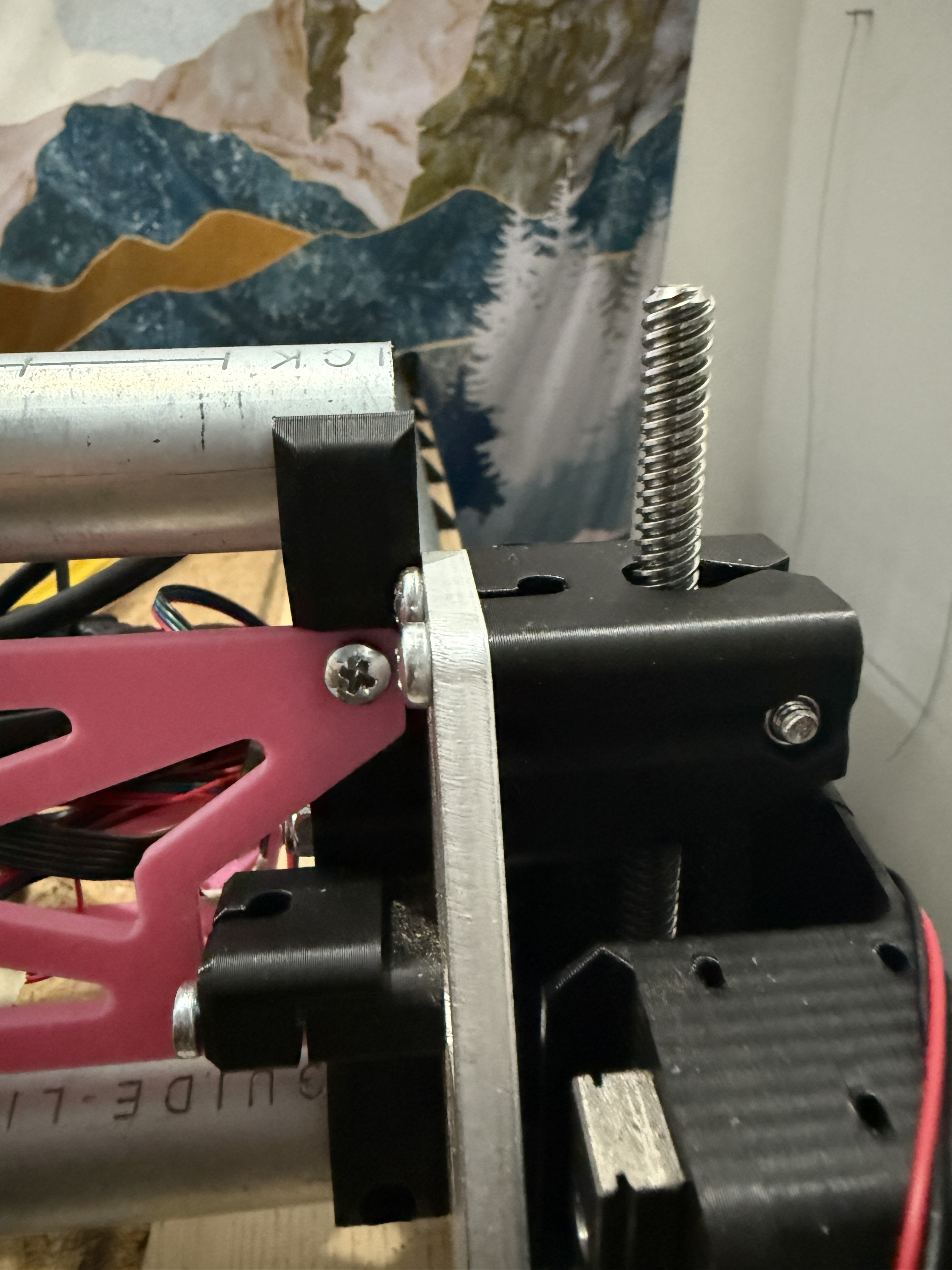

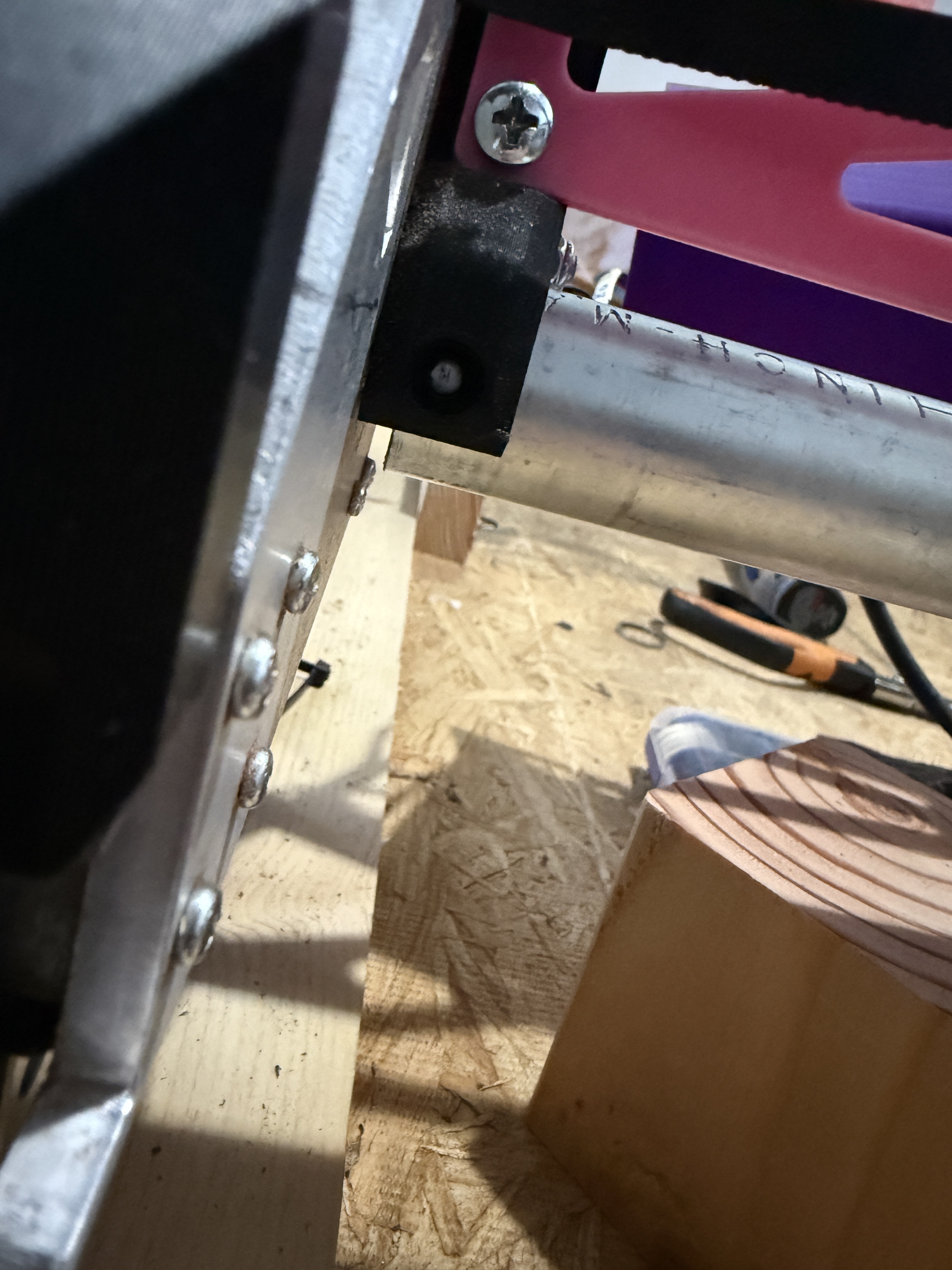

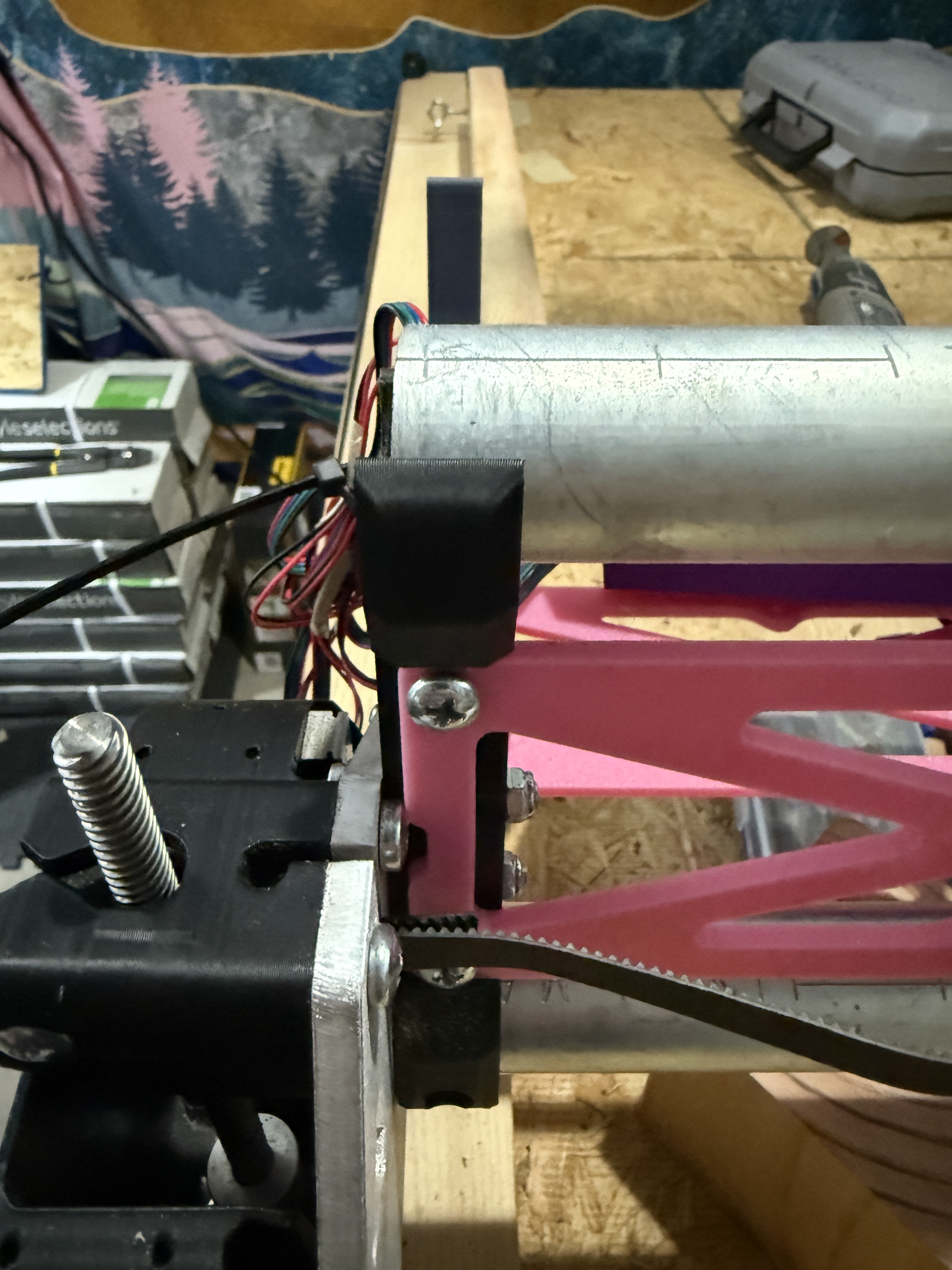

Post two pictures, one of each side of your X axis (Gantry). We want to see where the EMT sits in the end brace. Each tube should be slightly inset from the brace. If any of the tubing is sticking out beyond the brace, this is an issue to work.
If you made elevator plates, then you can always take them off for testing.
The MDF I made my elevator plates out of is very consitent thickness.
Get a large straightedge (a metal level is usually a good candidate), and sweep it around your table. We want to find out if you have high or low spots and/or a crown in the center.
Thank you! I couldn’t get a good pic of the X rails but I can confirm they are part of the problem, I could only slide a piece of paper between one side and not the other on the bottom. On the top rail I’m like RIGHT on the edge of the braces, so I’ll definitely file them down! Doing the paper test was crucial cuz it looks like it’s not touching, but an unseen part was and the paper found it for me…

I passed a 4’ alu level (brand new nice and straight) and it was pretty much flat throughout. There was a small peak detected in the middle, but only perceptible at /just/ the right spot and angle of the level, and even then it was .5 mm or less
Trimmed 2-3 mm off my X tubes this morning before work (this thing is a real addiction haha), now they sure as shit don’t rub! I ran out of time to do anything more than trim and roughly put them back in place, will focus on getting the heel-toe situated this evening. Pics of the rough tube placement below, they aren’t perfectly aligned left to right yet, but you can definitely see that they won’t be rubbing… hopefully I didn’t trim off too much of it tho lol not end of world if I did, I have extra conduit I can cut up :slight_smile: anyways:

Only thing I haven’t tried is removing the elevator plates, but I rrrrreally don’t want to and they seem pretty flat and smooth to me… but I will if I have to. Could really use some guidance as always, it’s so close to being good man I can feel it :slight_smile:
