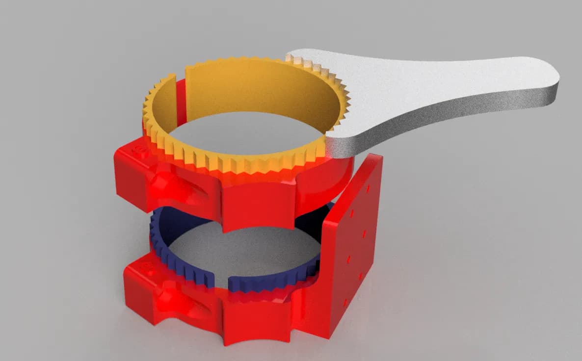

About the “points”, you can also remove them and leave holes for three M3 or M4 screws
They’d reference the “flat” side against the bed, so they shoud be pretty consistent in height
Here’s the F3D file for the cam-bracket thing, if you want to test it…
https://www.printables.com/fr/model/549854-lowrider-3-cnc-makita-tool-mount-with-traming-adju
I thought of that, and of course - if they are bolted all the way they are going to be close enough. Mk2 model out next week! :wink:
(unless you beat me to it.)
This would give you the ability to measure with the touch plate as well
Maybe just both… keep the little stub you designed, flat top, and add an m3 hole in the middle…
Best of both worlds
Love the spanner- might need two at once! I’m almost sad my printer is having a long weekend!
I never printed it and don’t know if it even works because the tooth prifile is very “round” :stuck_out_tongue:
But I thought about you when adding this feature, like “oh, yeah! that’s definitely something Peter would add, even if it’s totally useless!” :smiley:
