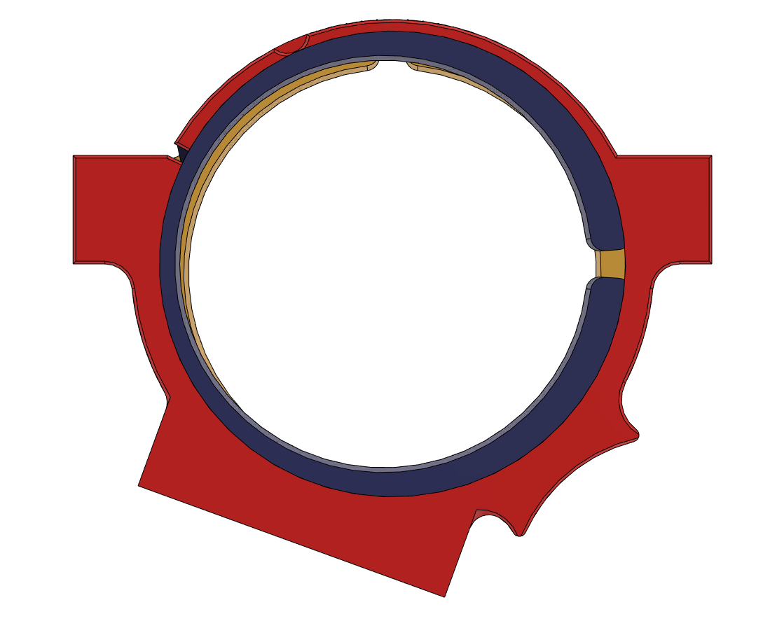

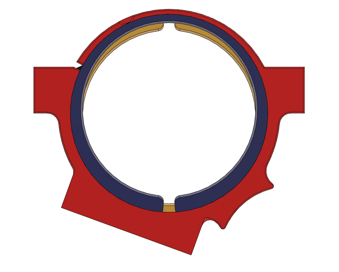

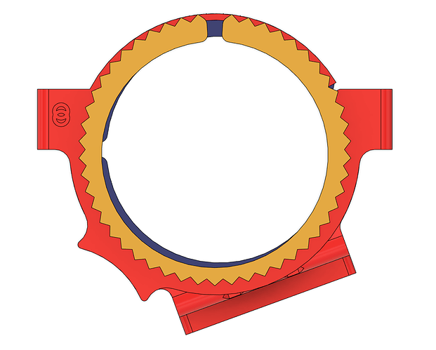

On the “cam adjust” thing side, I just realized I made a design error on the rings, and need to reprint them >_<
For illustration purposes, here’s what it looks like
180° - Top and bottom
90° - Top and bottom
You can see the rings pushing the router, and compensating one another if it’s turned 180°

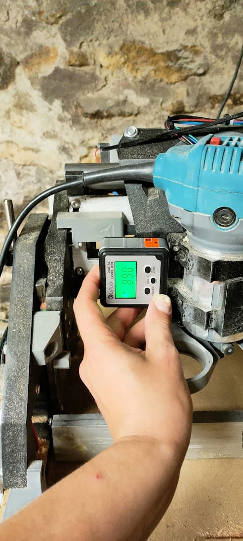

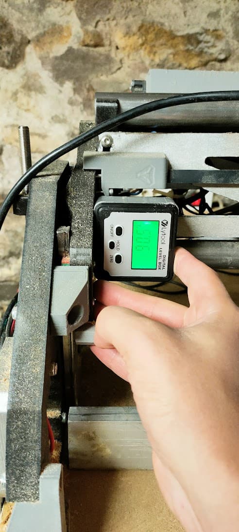

If you’re going to chase zeros, chase the right zeros! You’re checking that the bracket is perpendicular to the gantry?!? That means diddly-squat. I mean, sure, it helps a bit, but the real culprit is the actual spindle core, i.e., the axis on which the bit spins. Which may include some amount of runout. You actually need to get a length of 1/8" or 1/4" rod (or whatever will fit your collet, and allow you to measure w/ your digital level), and chuck it up, then test that for perpendicularity to the gantry. And then rotate the “bit” to see what sorts of runout you have.
Well I’m chasing a bit more than zeros here :slight_smile: above one whole degree in fact :slight_smile:
But yeah, you’re right , this should be the right way to measure, although, really, measuring at the collet should get me right in the ballpark at least (not trying to get an absolute perfect traming, just a usable setup with reasonably sized bits)
To give you an idea, that’s already 0.21mm between edges for a 16mm wide surfacing bit, 0.1mm ona 8mm bit…
So, yeah, not very noticeable on a 3mm bit when surfacing (but who would do that?), but as soon as you get past 6mm wide bits, it gets very noticeable
Also, even witha 3mm bit, the walls turn out slanted, thats 0.23mm difference in the X axis between the top and bototm on a 18mm (3/4") thick stock
