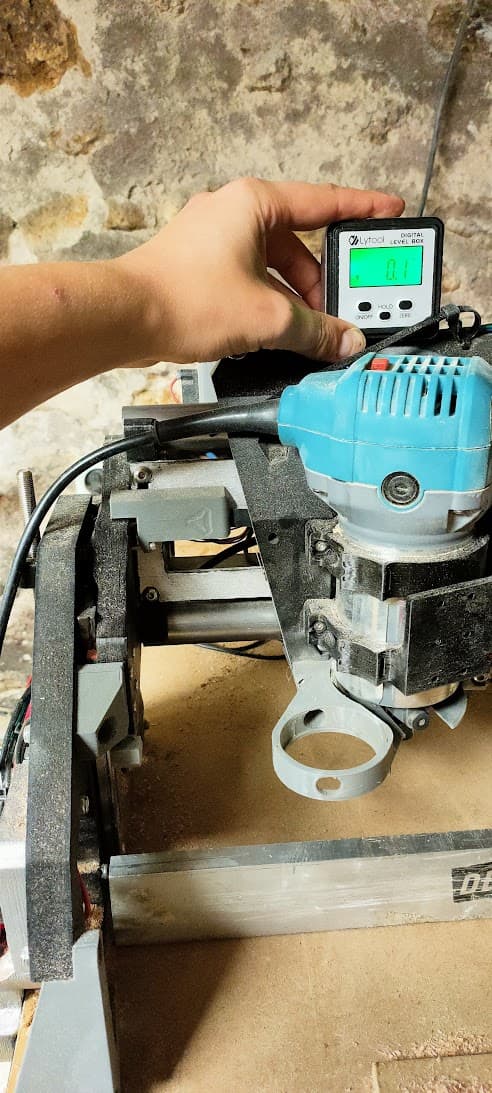

Just received my digital level I ordered at 11AM (it’s 9PM right now…)
Much easier to measure and see what’s going on…

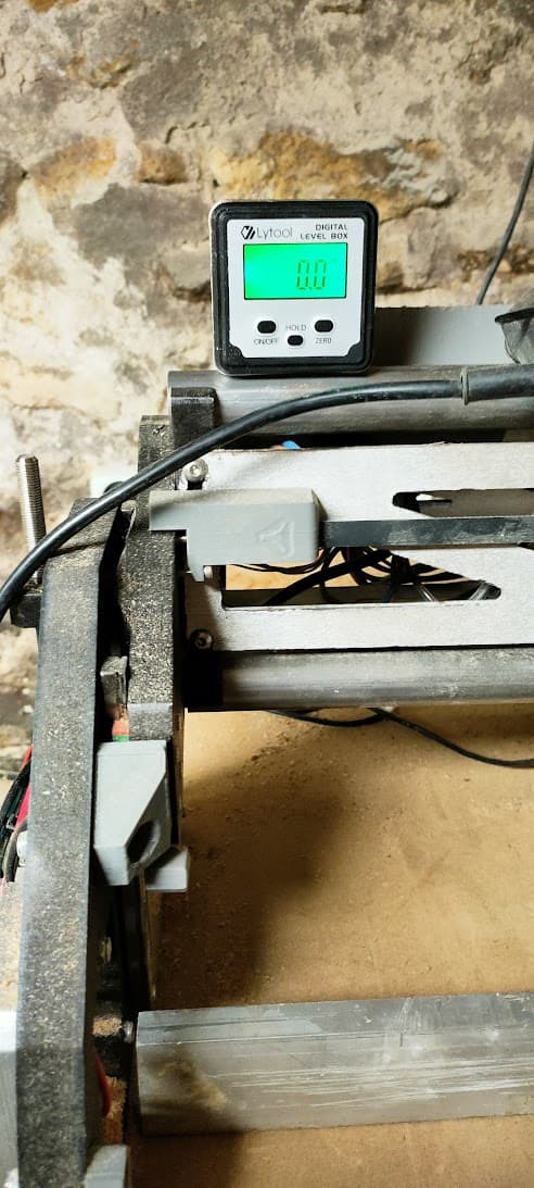

Put the level on the gantry and zero’ed it (btw in absolute mode it’s leaned 0.1° to the horizon…)
Then on the side of the mount (made contact with the small stub on the side of the brackets where the screw go in)
This should read 90° relative to the gantry, it reads 88.9°, so that’s 1.1° off, pretty much what I measured with the traming tool
Now I need to find why this is crooked…
Either I reprint a core overnight, or I try to remix and print customized brackets accounting for the tilt now that I know how much it is
Advice?

This is not the height of the gantry relative to the work surface, it’s the perpendicularity of the tool relative to the gantry, and therefore its perpendicularity to the work surface
And that’s indeed noticeable, at least with the amount I currently get…
When surfacing, I get those wavy lines along the surface
And that’s just with a 3mm bit…
If I try to use wider surfacing bits like a 12/15mm one, this get even worse…
Moreover, I get a slight skew on the walls too
The walls that are supposed to be perpedicular to a surface are in fact 89 or 91°
It may not be that important on some pieces, but as soon as precision is important, or you need the part to fit witihin another, this get quite noticeable
eg: when I made the routing jig for my door handles, the router definitely eated at the template because of this slight skew

That much deflection can probably be fixed with a piece of masking tape in the tool mount. Maybe one on the top and one on the bottom (opposite sides)
I would also most definitely check the whole X/Y plane, since you will also get artifacts where the bit goes across as well. That wont adjust the plastic that the tool sits in, but it will affect the router.
On my Primo, I.was getting a similar issue, and fixed it by tightening one top tool mount screw (to the Z tubes) about a half turn. The equivalent would be the mount ring to LR core screw.

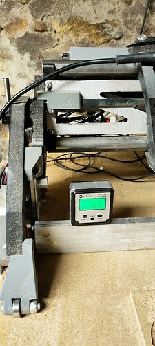

Here’s the whole measurment the arrows indicates if the left side should go up or down to be level)
Zero-ing on the gantry first
Relative to the table (averaged with a ruler across the X length)
Not that it matters much for traming anyway…
Relative to the top of the LR core → 0.1° - Down
Relative to the tool brackets → 89° - Up :
This correlates exactly with the measurement of 3mm between sides I made with the traming gauge
Relative to YZ plate → 90.5° - Down
I don’t really know why it wouldn’t be perfectly perpendicular, but in my comprehension, this shouldn’t matter much , it just means the rollers have a bit of inward camber (LR3 “Tokyo drift edition”) and I need to compensate a bit with the Z height on this motor
OK, if you haven’t already started the big print…
If you print the tool mounts with the router diameter about three mm oversized, you could then print two concentric inserts with an offset centre the correct size - to give roughly 1.6mm of offset on one side compared to the other.
Insert one in the top mount and one in the bottom mount and simply rotate them until the router is perfectly trammed.
Should I patent this idea, or just let you see if it works before I get too excited? :smiley:
If it works I’d put a little 45 degree flange on the “inside” edge and a matching one on the tool mount to make it captive.

No, the offset is infinite and in every direction - if you start with both cams in the same spot, you have zero offset. To adjust turn in opposite directions, to adjust the axis of the adjustment, turn in the same direction and repeat.
The maximum offset in the above diagram is stupid large (2.2mm top and bottom which totals 4.4mm!)

You can think of it as needing an offset in X and an offset in Y. Those offsets add up to a vector (X, Y). The vector has a magnitude (length (sqrt(xx+yy))) and direction (tan(y/x)). You can rotate both rings to change direction. And then rotate them relative to each other to adjust the magnitude (length).
It’s a bit like corexy. Very creative. Very useful. Very unintuitive.
You need to start with a very good measurement of XY needs without any adjustment. Write it down. After adjusting the rings, measure them again and subtract the original measurement on paper. That difference is what you can control. You can use that to see if your direction is right or your magnitude is right. You can’t tell from just a single measurement.
It may be possible to just adjust it with the measurement tool installed. Our brains are amazing calculators. But I know from experience that if you want to measure it, use paper (or a spreadsheet)
