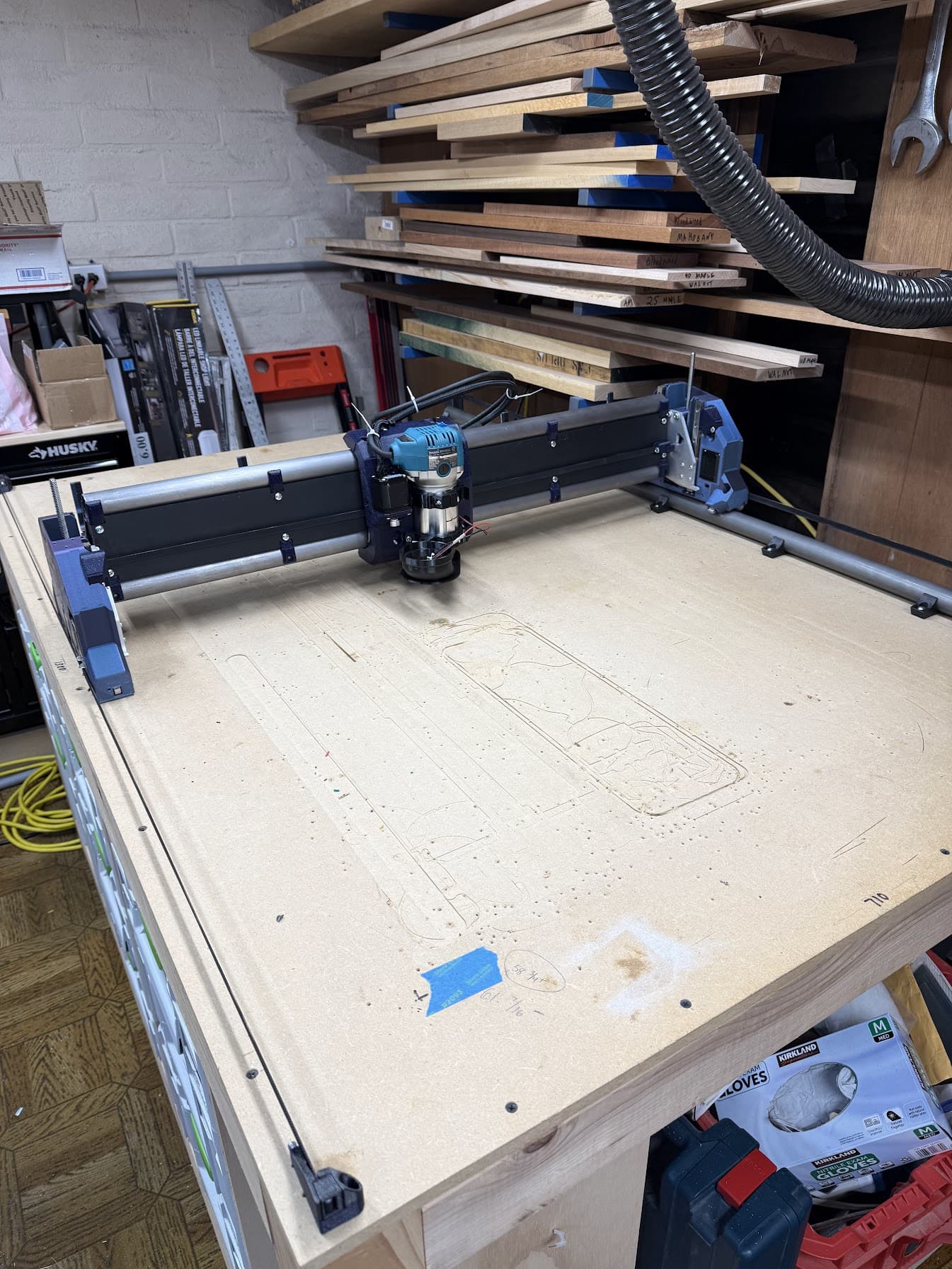

LR4 is under power, all axis move how they should. In the middle of getting it squared / leveled.
I also switched to Jackpot at the same time. So far I’m a little hesitant with FluidNC. It locked up / froze randomly twice so far. I had to reboot the Jackpot.

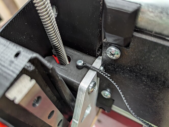

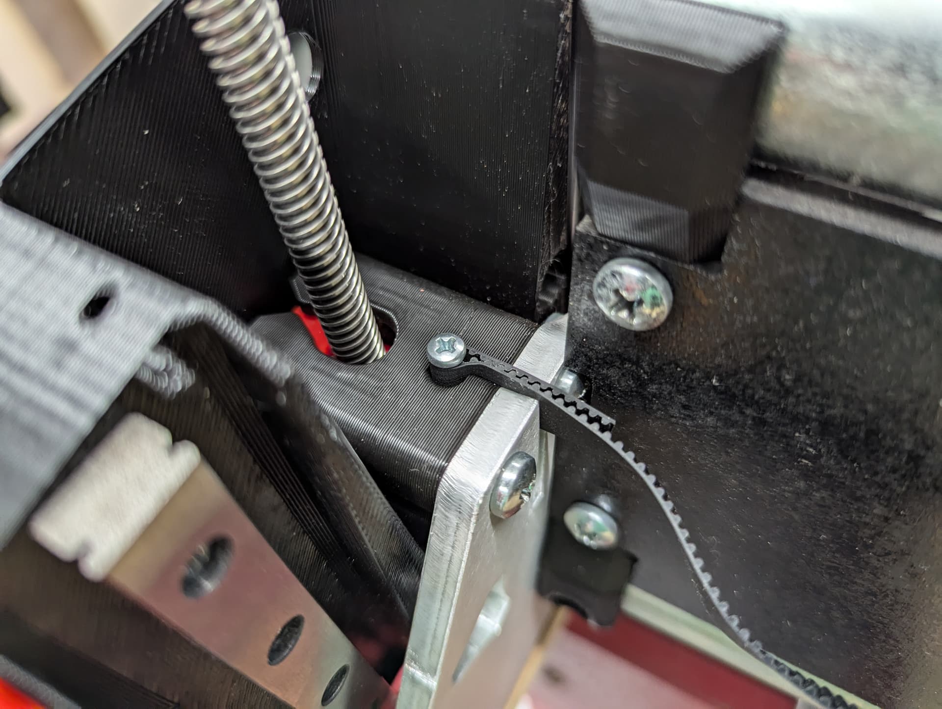

The x belt min was one of the hardest steps (pic from docs). I think maybe it could use more tolerance. I could barely get it in. All my other parts felt perfect tolerance wise.
Use a screwdriver and lean on it. :smiley: Trust me, I did it twice. :stuck_out_tongue:
Yup, also did it twice. First time the belt wasn’t long enough.
None of the other parts needed that much effort, so just calling it out as an anomaly
Its a little tight but not bad once you get used to it. Should put that side on first and not leave much hanging out at all, put all your slack at the other side. I realize this doesn’t help you at all since you have done it already but maybe it will help the next guy reading it

That new firmware resolved my concerns with the Jackpot / FluidNC

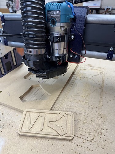

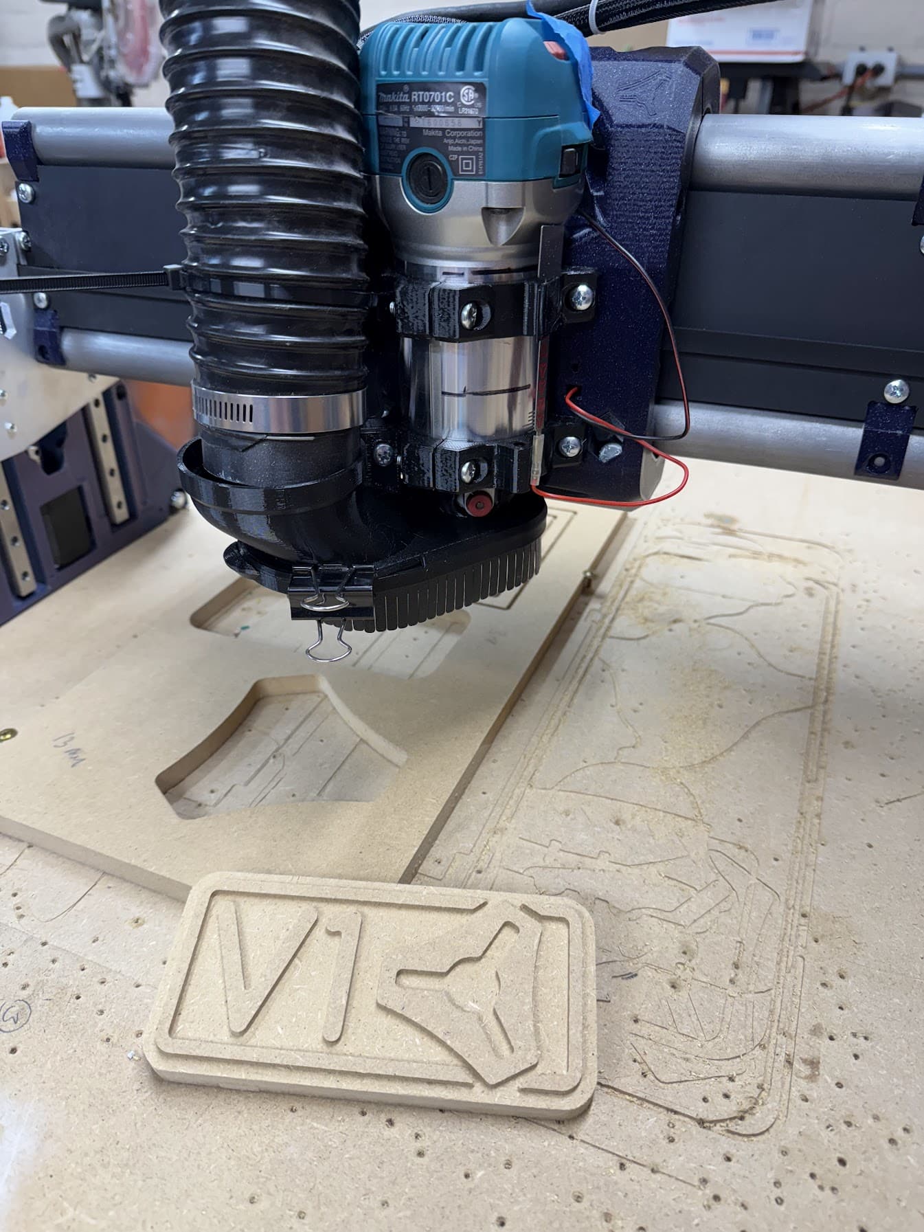

Here is my crown from last night
Heck yes, I love it!!!

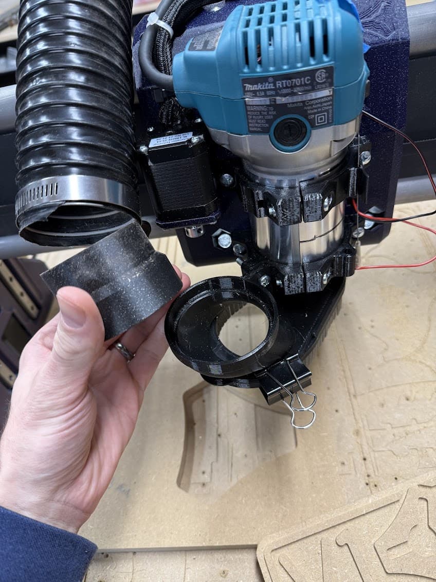

I have also been thing a lot about the dust shoe clip, I have not forgotten about you.
Nice, The dust shoe works amazing. I didn’t have any dust with that test cut. Made this fancy little adapter.
The clip I am using is actually a bad idea because it can catch on the screws / piece.
I am a little extra sensitive too since the modded one I tried (not picking on anyone specifically) for my LR3 fell off and into the router bit during a cut. That wasn’t cool.
Everything else on the build was perfect tolerances, so I can’t be the only one with a loose shoe.
What’s the diameter of your hose? Looks similar to mine, so I’m curious about your adapter. Does it just make for a more solid connection vs hose alone?
(side note, my pla dust shoe+boot for Kobalt snaps tight, I must be lucky! Assuming that part of the makita shoe is identical)
