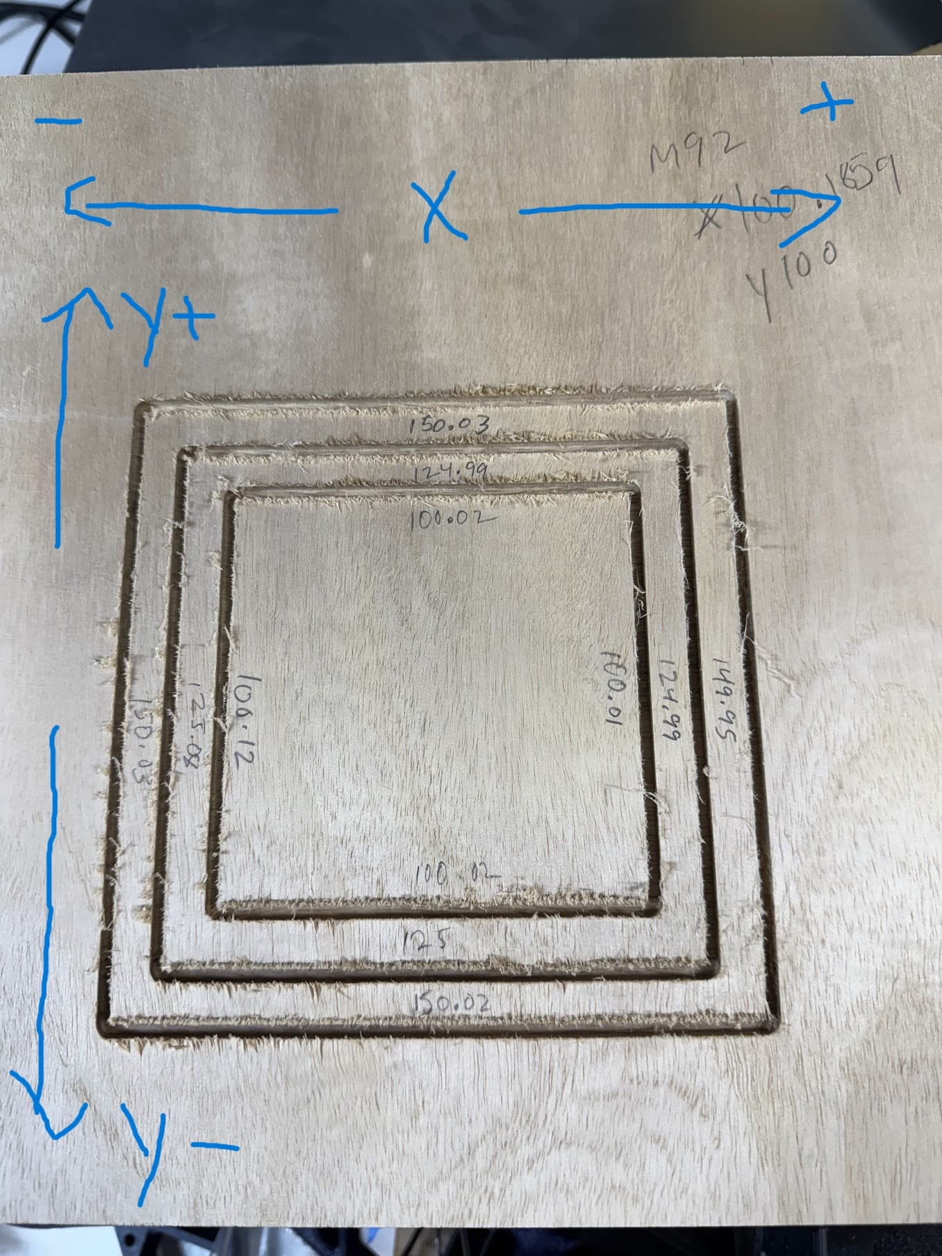

First, check steps/mm. This really ought to be correct, but make squares 3 different sizes that you can measure accurately. There is likely to be error, but you are checking for a variation in error. Say you choose 100mm, 125mm and 150mm (I can check those with my calipers.) And you measure 100.43, 125.45 and 150.47. This would indicate a static error of about 0.35mm and an error of about .8mm/100mm (grade 9 algebra word problems anyone?) You would want to correct both. Correct the 0.8mm/100mm by adjusting steps/mm by 0.8% down, and the 0.35mm by adjusting the diameter of your bit in CAM by 1/2 the static error.
In my case, steps/mm was dead on at 100, and only a static error was present. I think my LR3 has an error of about .5mm over a span of 800 in Y, and that may be a measurement error, or a bad spot on a belt, so I didn’t correct for it.

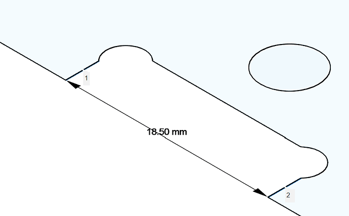

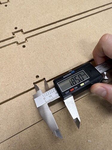

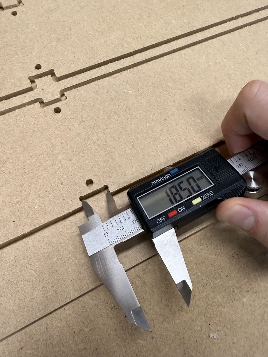

Ugh these still won’t work. Now This measurement is off
I’ll check my steps again and then cut this out of wood.

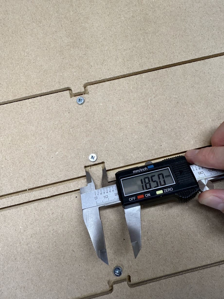

That measurement looks right to me. I believe the braces are 18mm

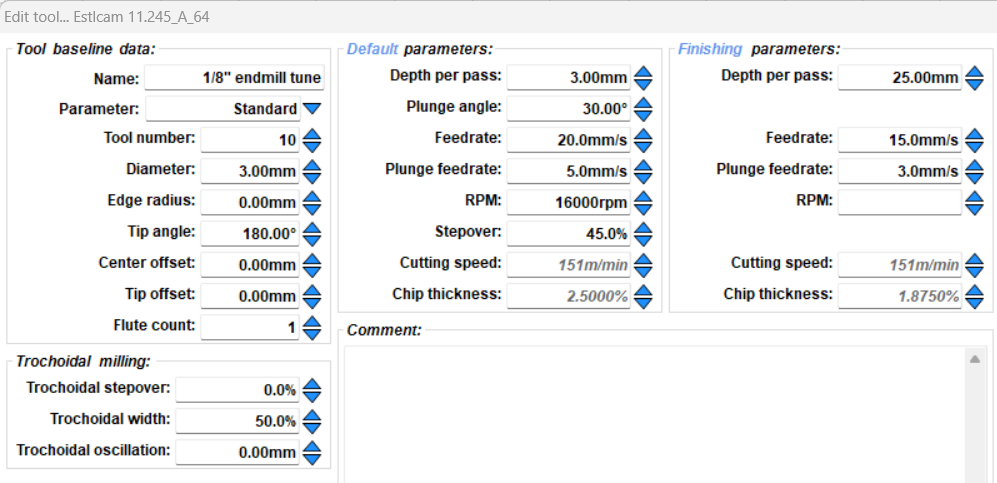

These are the settings
Yeah 20mm/s might be too much. I cant remember what I run but usually when I see it start deflecting I slow it down just a touch.

Okay, so taking a step back.

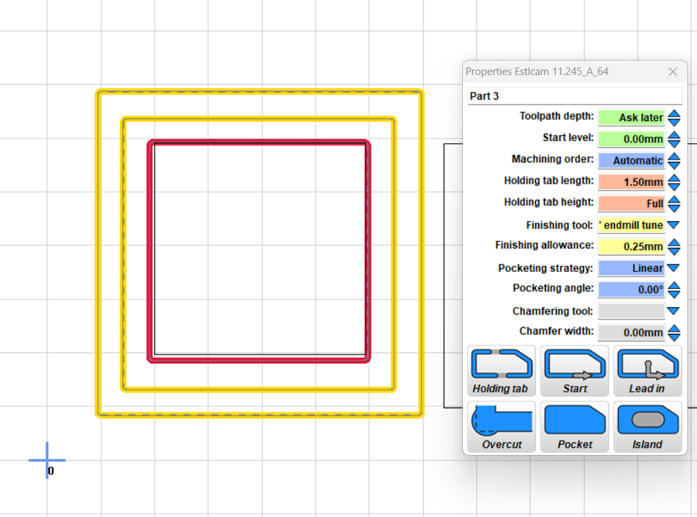

I tightened all my belts. Y steps were good, X steps were updated to 100.1859. Endmill is 3mm in Estlcam (not 1/8" - 3.18mm"). I thought “mathematically” we don’t need to change the steps. This must be compensating for something else?
This is my latest calibration cut.
I thought it was interesting that I get ~.08mm difference when I measure the Y sides. I did recheck my square at 700mm x 1250mm and I am within 1/64". I used a sharp v bit to poke a hole in the tape. I bet I have more error in measuring, than actual error.

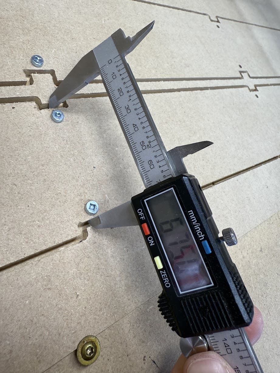

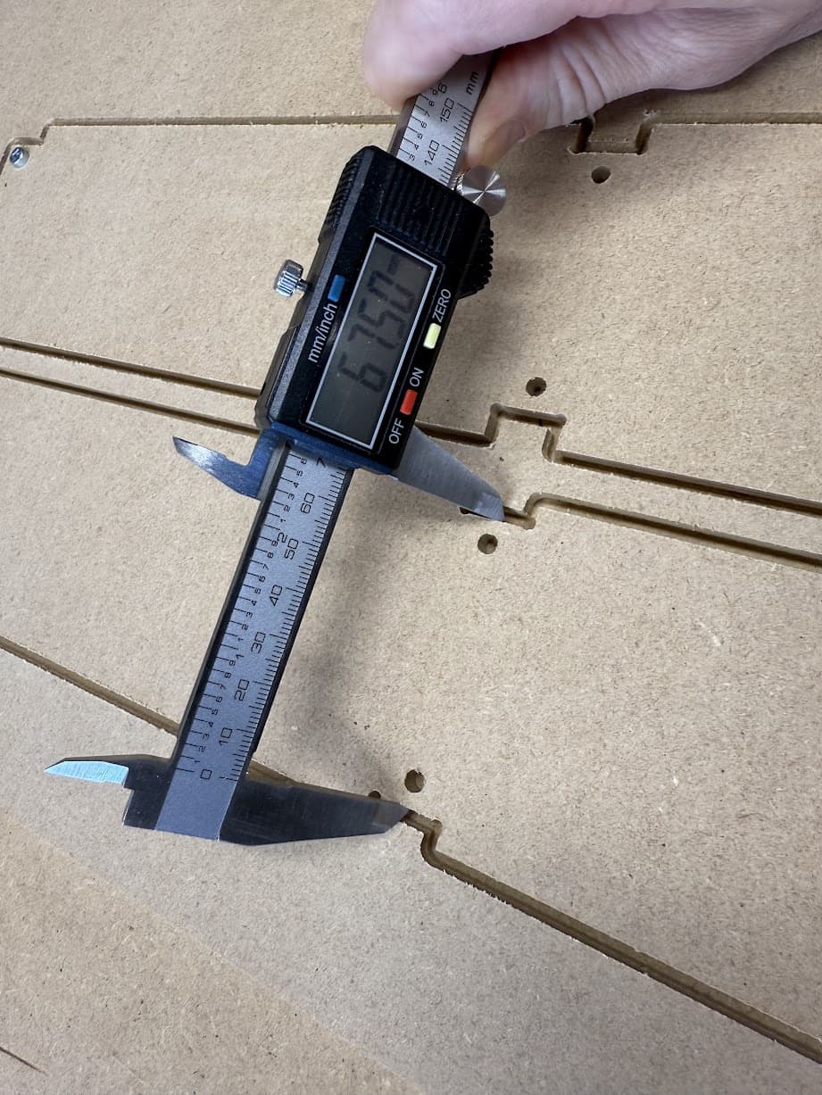

I think this is close enough to cut out struts in 1/4" MDF, and then I can take the machine apart. I’m more interested in building the LR4 and putting the time into getting that dialed in better.
.08 from a printed plastic design! Damn!
