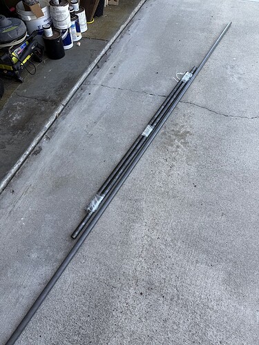

I’m excited to upgrade my LR3 to a LR4. My reason for upgrading is that the LR4 is cool. I have no problems with my LR3, it works perfectly to cut and pocket things for Etsy (and fun).
I decided on round steel DOM tubing. 32mm, and 1.651mm wall from a metal supply house. They cut it to the numbers I gave them. Cost me $88. This is a little thicker than conduit and conduit would have cost me $62.
Also I will upgrade to Jackpot at the same time.

Buying metal is hard. When I went to pick it up, I owed $15 but didn’t have to pay it.
Then they also told me I get the “drop” (extra?)
So I have an extra 152" of rail now.
