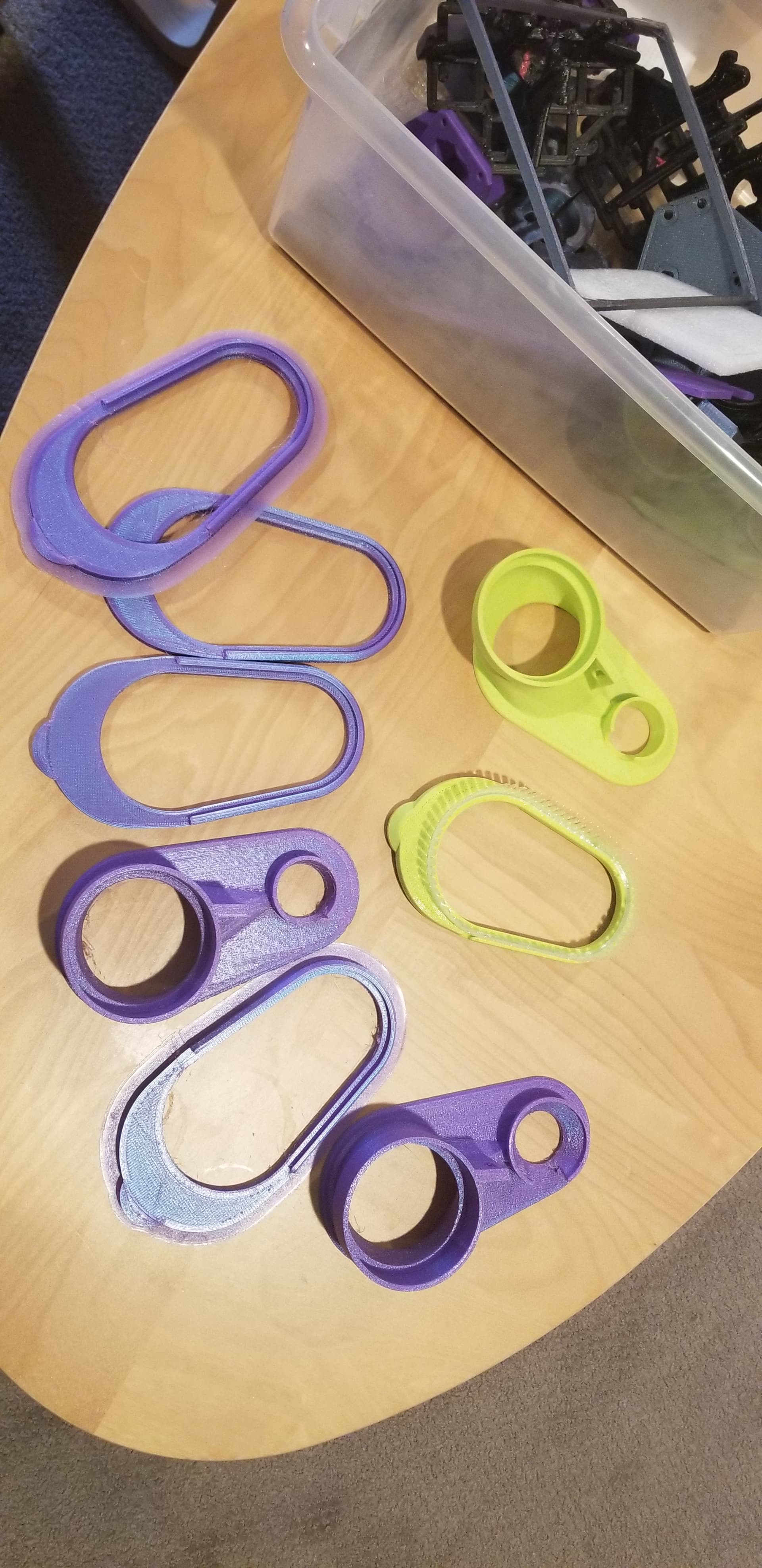

Almost done printing all the parts. I think the hardest is the tool mounts in PETG but I got it working. It’s hard to get PETG to stick good when you have finer details.
I worry about my tool slipping up. My Makita used to do that in my LR3 and I would just have to tighten it more. PETG it is more slick, the tool might move around more.
I used an ASA tool mount on my LR3 and never once had any issues with it slipping. Not sure if that is an option for you or not.
I do actually have some ASA. Since my PETG is almost printed out, I’ll give it a shot and see if I have problems. Then we know if we should change our guidance

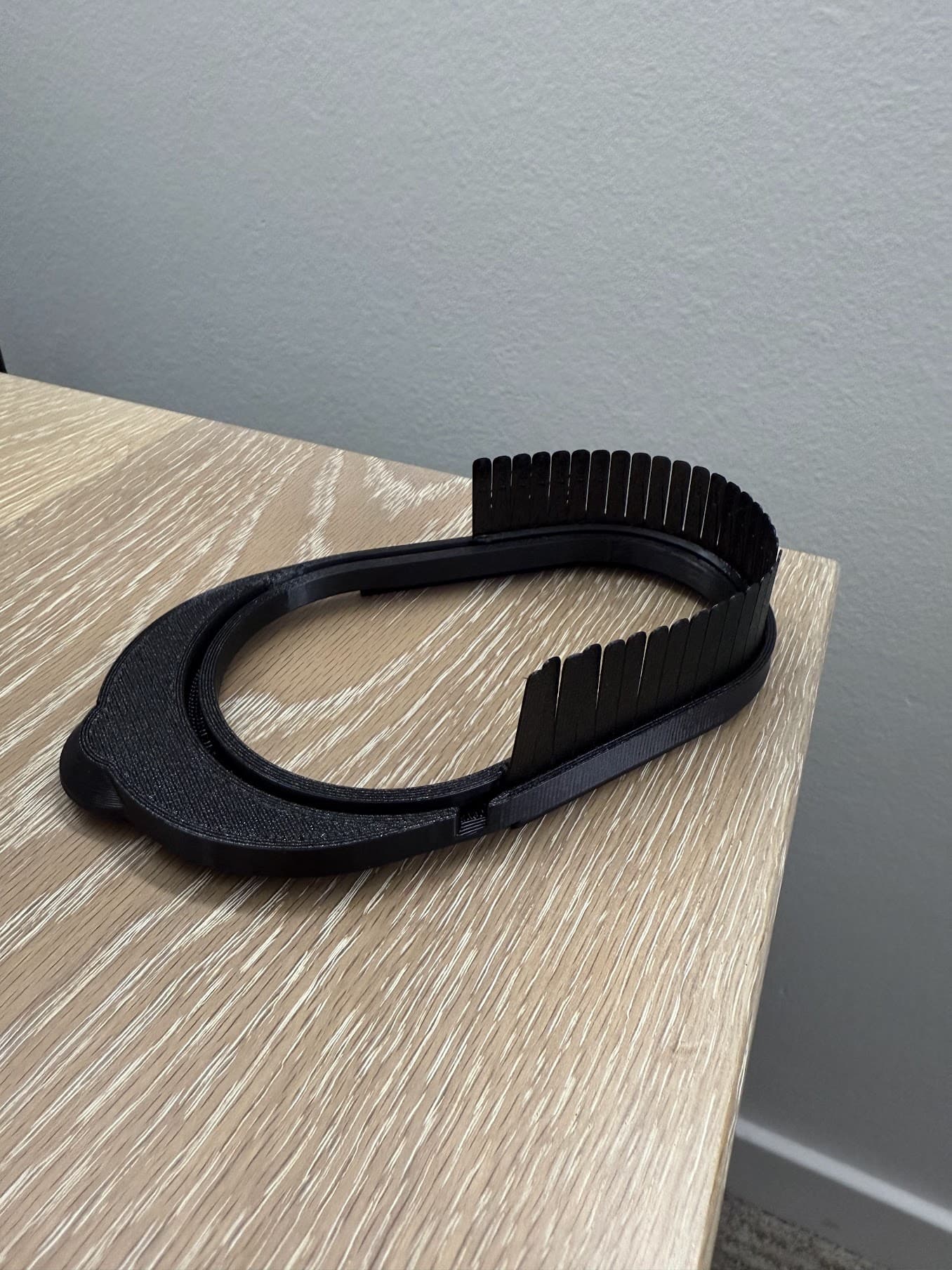

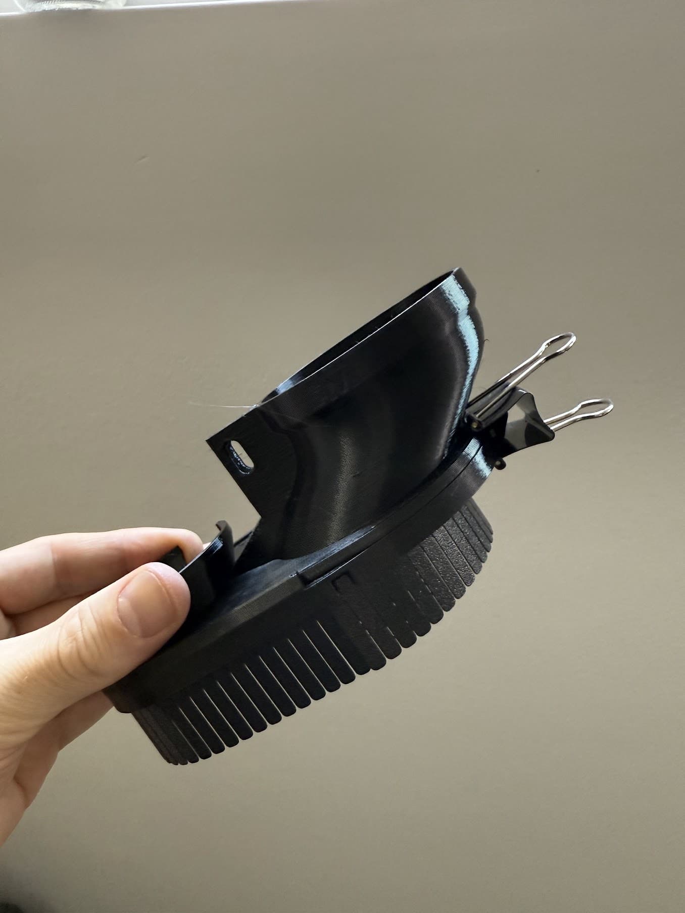

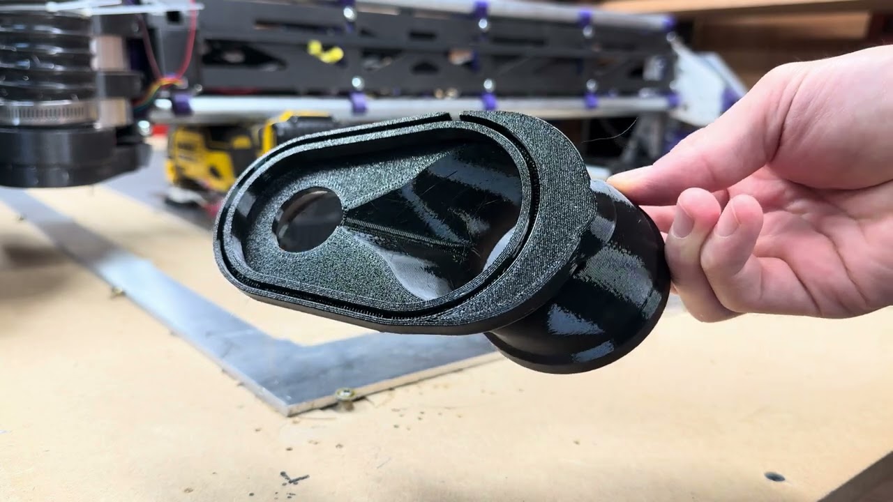

The dust skirt is way too loose on the shoe. I can’t imagine this is going to stay on once it has TPU bristles.
Thoughts?
It’s a really loose fit for me as well, but it has never fallen off during a program. :smiley:
What nozzle size, wall count and infill did you use?
Loose fit came up during the beta, and was noticed when the more recent compact shoe/skirt was made. Ryan then edited for more positive connection. There’s been a few versions…
0.6mm nozzle, 3 walls, 30% infill, 0.3mm layer height.
I think it should be tighter.
Edit - mine is PETG which is a slippery filament. That probably doesn’t help.
The bristles fit perfectly. Also I guess I needed to print two of them :laughing:
This is going to be chewed up faster than Doug’s remix, but I will try it :joy:
Perfect
