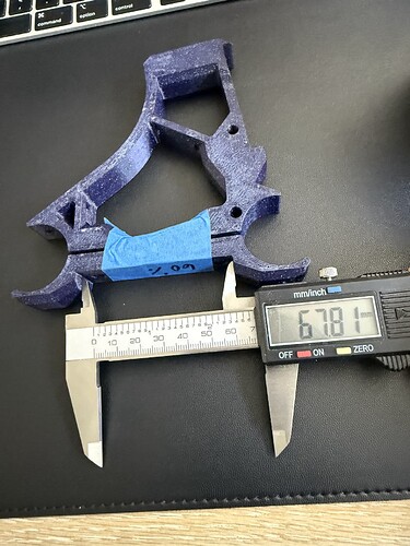

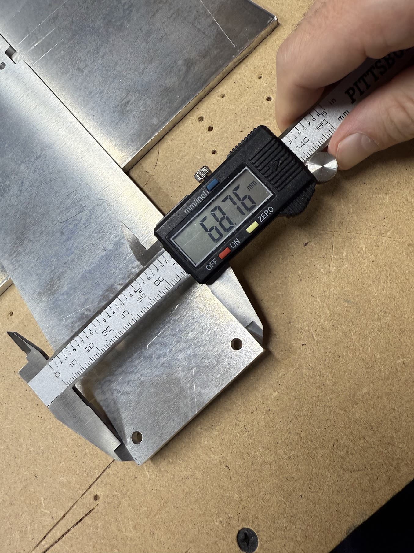

These are a little off dimensionally though. I think I need to do a finish pass. How much should I leave for that last pass? 0.2mm seems safe?

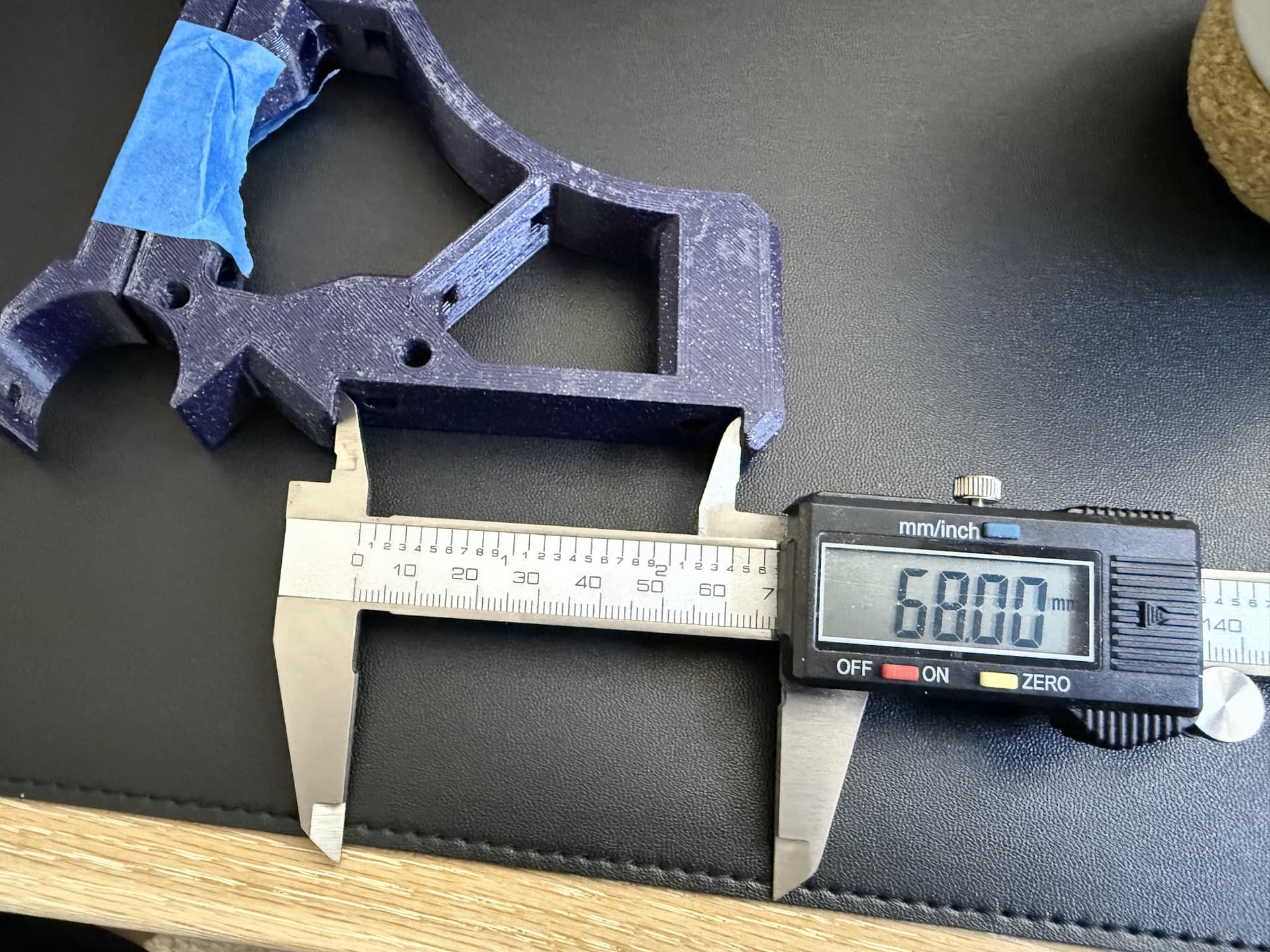

98% doesn’t fit.
99.25% doesn’t fully seat in the back
99.75% is still printing
Just wondering if you did any printer tuning prior to printing these parts? You are very very close.
Not saying you need to, just wondering what sort of tolerances we are really needing on this part. Obviously, I need to make some tweaks.
Always do a full depth finishing pass.
0.2 is probably okay in metal, depending on how rough your roughing pass was. The rougher it is the more you need to leave, sometimes that means doing two finishing passes.

99.75% is better, but I don’t have much confidence in the locking mechanism. I tried a remixed dust boot on my LR3 and it fell off into the bit during a job, so maybe I am being overly cautious. That wasn’t really cool.

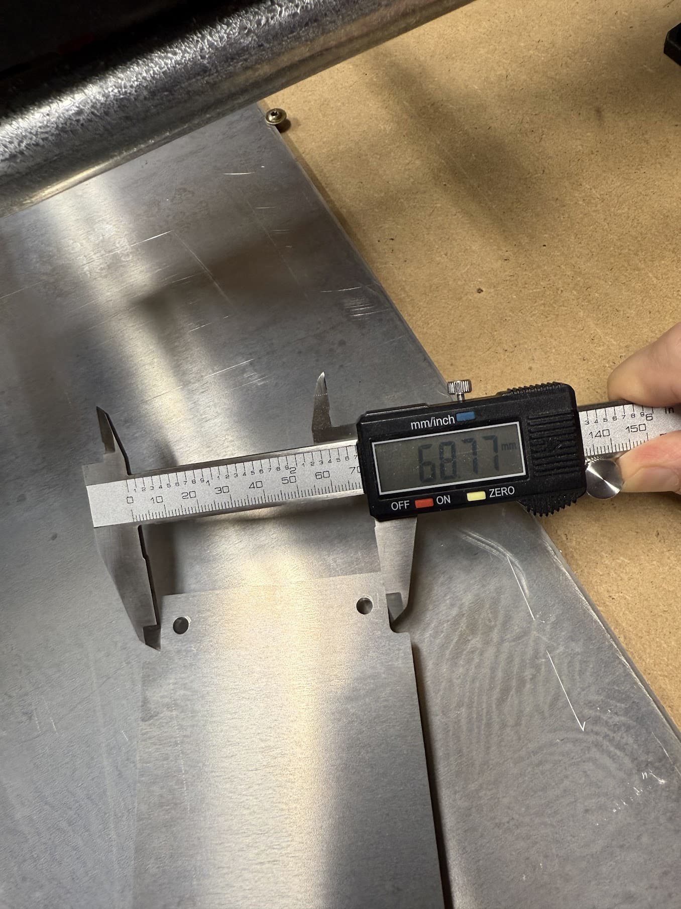

I use 0.35mm finishing pass, which is a hair more than 10% of the 3.175mm (1/8") bit size. That is with Trochoidal Climb roughing cut, and it leaves a reasonably smooth surface
Yeah I believe it’s square and I’m off by the same amount at Y+ and Y-

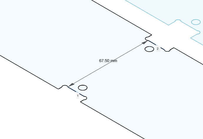

I expect this part of the strut to be
My plastic parts are
Both ends of the struts are
So TLDR, the strut came out 1.25mm bigger than expected using trochoidal milling without a finish path.

I don’t think it is just finishing pass that is the problem.

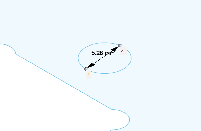

The holes are supposed to be ~5.28mm diameter
But when I cut them I get ~4.8mm
:frowning:
Sounds like your bit isnt as large as your CAM thinks it is
