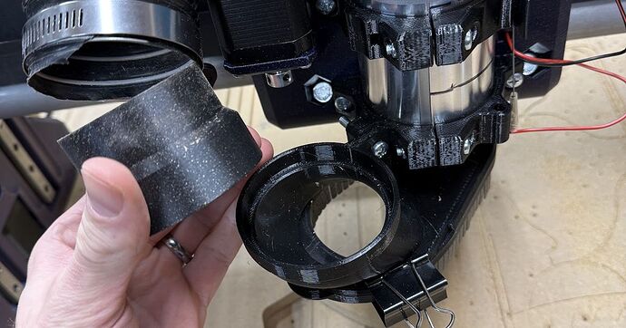

The top part is 61mm so the hose can fit over it.
I didn’t make it super tight into the shoe. You still need to zip tie the hose on.
I see! Mine fits so they must be just similar in material appearance.
