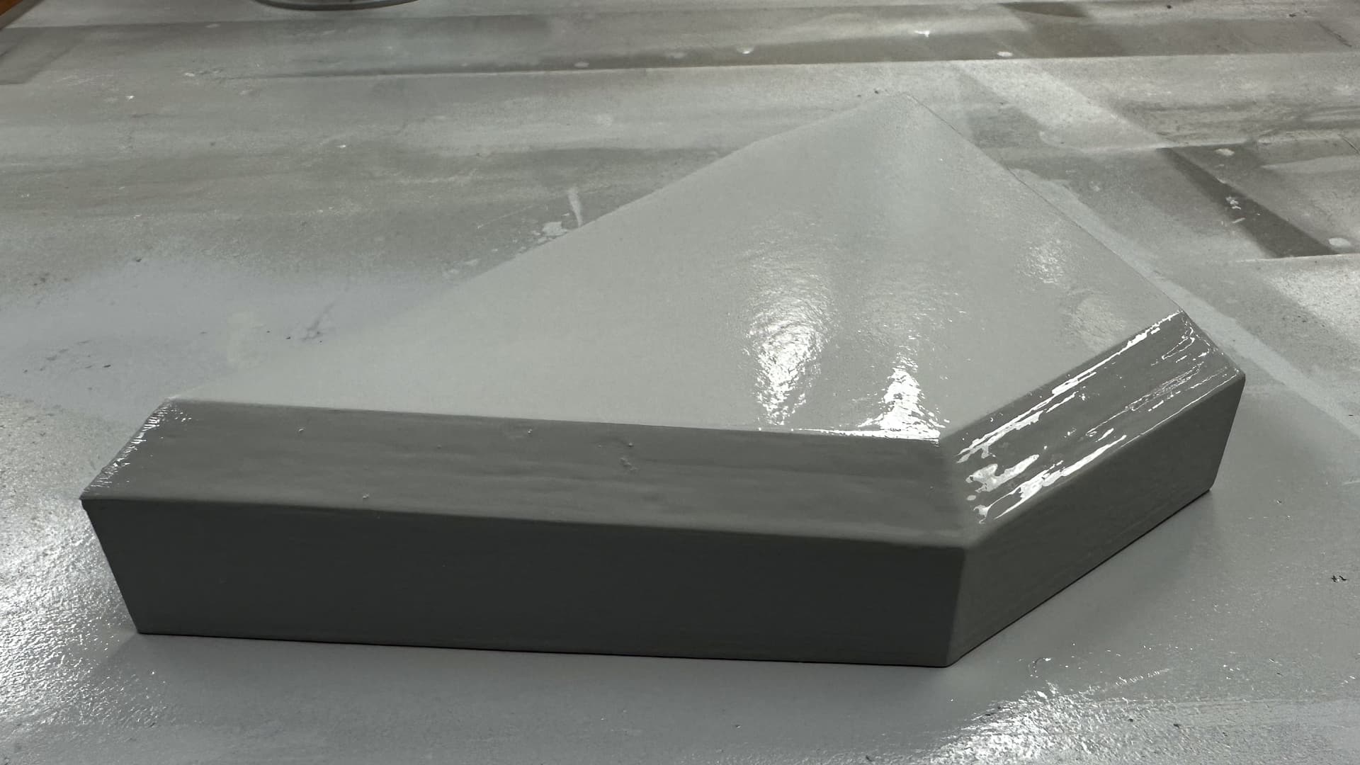

I thought I might document the painting process out of interest. This is one of the prototype covers in PETG - it was a very quick and dirty print and the real ones won’t be anywhere near as challenging.
Usually I give everything a coat of plastic adhesion primer but for this test piece I didn’t, and usually I just go straight into the primer filler, but I have a ton of left over Zinzer BIN and thought I’d lay down a couple of quick brush coats as it should sand pretty easily - all that dust looking stuff is actually texture from the build plate (I used a smooth plate for the PLA).
Coat ONE.

Sanded the seal coat, (waterbased)
One coat of spray putty (solvent based)
Filled with ordinary waterbased wood filler (because it’s easier than Bondo)
Quick sand with 120 grit and one more coat of spray putty
I’d normally repeat the last two steps a couple of times, with finer sandpaper between coats.
This print was pretty rough and if it was for real I would have used body putty (like Bondo) but I’m really trying to see how stable the finishes are - I’ll be using an acrylic top coat too, so it’s all a bit silly.

One hour is not enough to fill sand spray and sand again when there are three coats already that need curing, so I botched the sanding, but have seen enough to know it will work, and gave it a quick squirt of silver to satisfy my curiosity - the clear will dull it off a bit but the sample isn’t going to get any clear.
