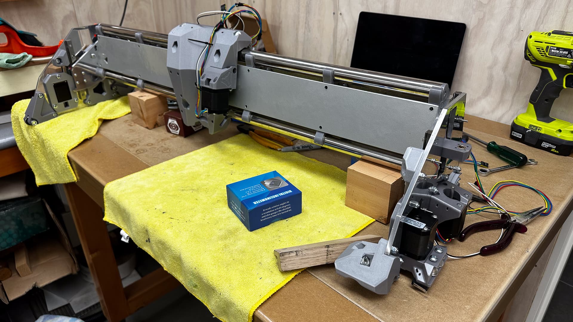

After the excitement of the last few days it’s time to get back into more mundane stuff and brace myself for the let down that building it in dull grey will no doubt be!
First job: - Drizzle a little epoxy into the captive nut socket. If any of it leaked down into the thread from below you might hear me from where ever you live in the world! Look at all those screws that need cutting off!
With really rough assembly complete, I’m happy to report we have clearance to burn - I’ll actually put some washers under all the brace bolts now just to give a tidier job against the paint.
Ready to build the wiring loom - after a big tidy up.
When I said that we were viewing the “fenders” in isolation - this is what I meant - if anything to quote @vicious1 , it’s getting better again - it really looks proportionally like part of the machine. I cannot lie, I have been really tempted to order another spool of orange filament, print a new core and paint the braces white. I can see some super colour schemes coming up if anyone else decides to use these “fenders”. Should I just start referring to them as “covers” because that’s what they are?
My original colour scheme was an ultra conservative grey on grey and I’m going to stick by my guns no matter how boring that is going to look compared to the white and orange version, and keep reminding myself that the white bits are already looking a little grubby.
All up though the machine is really starting to look more like a commercial product than a home built one, which is very satisfying.

I can’t say I’ve ever noticed it being a problem, but with the aluminium plates there’s no easy way of securing wires, and the prospect of loose wires hanging from a moving object 6mm above a table top was not appealing.
So I made a little cable tray/skid plate and that made me almost as happy as the orange “quarter panels” do!
If you had noticed that I’d left two bolts 1.6mm longer than the rest when I was cutting them off yesterday, and were too polite to point them out, this is why:

I have a couple of other non-issues that the “cable tray” sorts as well, the biggest of which is the length of the Y stepper cables, so neatly cut and re-pinned to fit perfectly on the LR2. The connectors are in exactly the most awful spot - under the Z stepper!
This mount stops any risk of sag, and keeps the wiring off the steppers at the same time, but even more importantly there are no pesky stray wires to catch between the fancy covers and the plate and the cable now has no need for any strain relief.
I was going to solve all of those “first world issues” with loom tape, but this is nicer.
