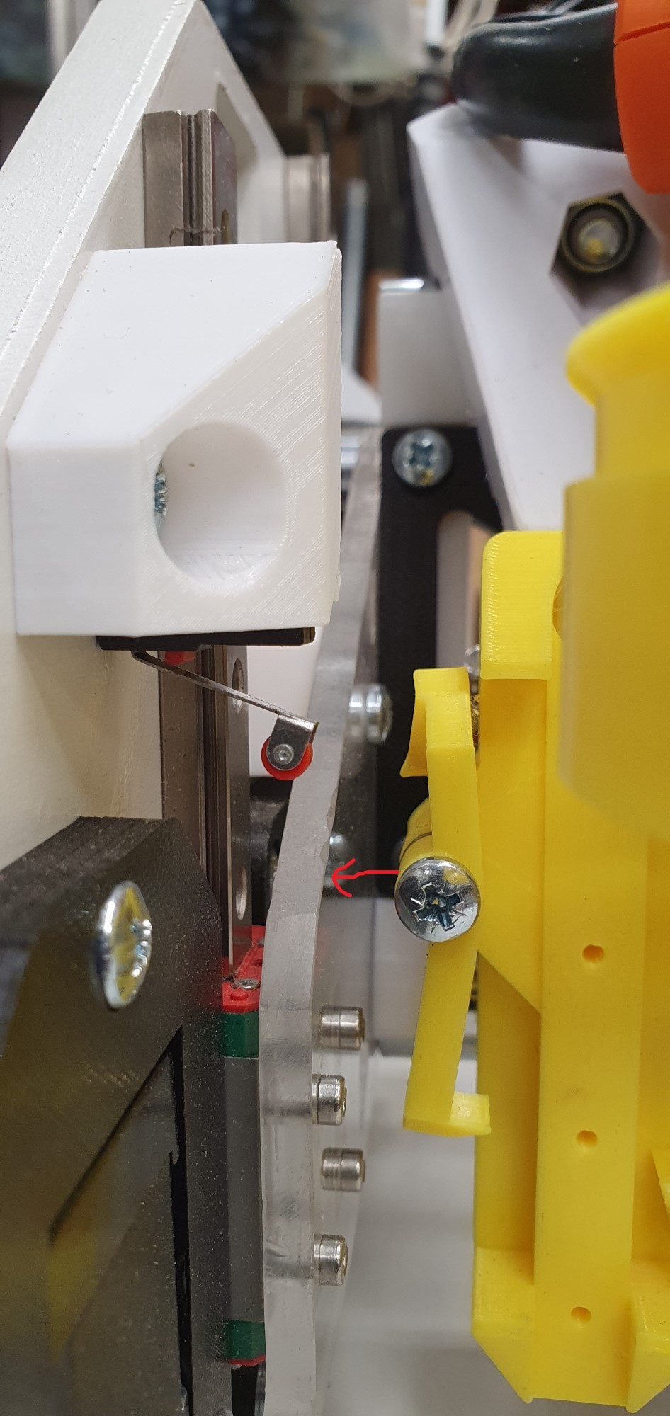

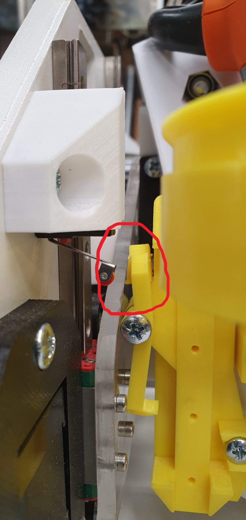

From what I can see, it looks like you are missing the fact that the end stop switch for the X axis is supposed to use the X-belt tensioner’s “end stop nub” as its end stop. It appears from the photo, you’re trying to get the end stop switch to use a bolt head as its end stop. Do you have this part installed?
If so, the end stop switch should be using the right side of that little nub at the bottom of the printed part as its end stop. For me, that nub is further right than the bolt head. Does this help?

Exellent info! When I saw the picture of the X tensioner I checked my Printlist and noticed that I had forgotten to print that piece. Totally missed that I didn’t have a checkmark there.
No wonder the endsw. didn’t reach.
Since I haven’t set up the belt yet I never noticed that this piece was missing.
With the X-gantry at the lowest point and the X-tensioner not mounted yet, the floating Z slide latch is stopping at the XZ Plate as I try to show in the following pc’s.
But that shouldn’t be a problem with the X tensioner mounted. :smile:
