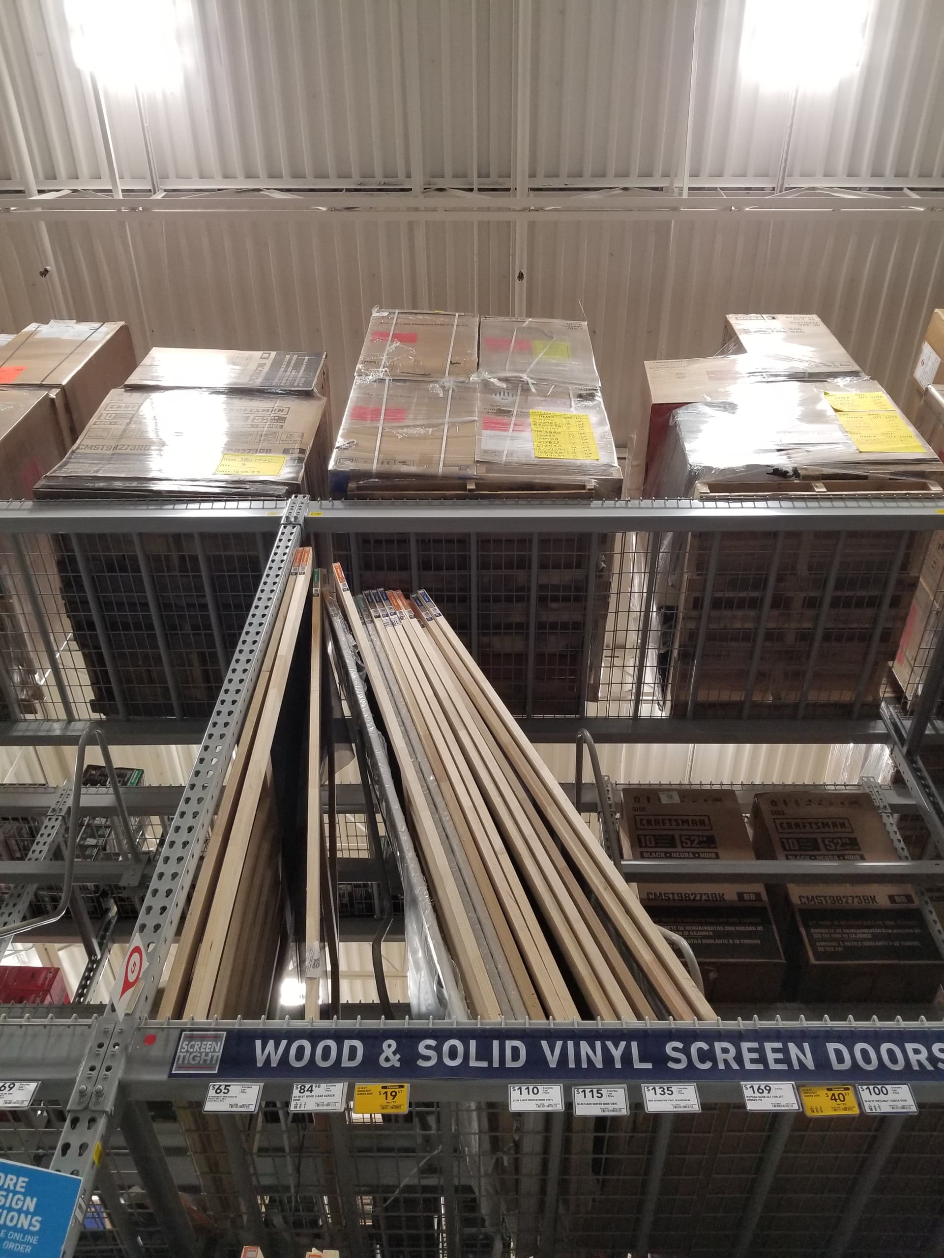

They have six at my location.
And here is the back side:
Did they sell you one or are they making you wait?
Sweet, no collisions? Share it and I will add it to the printable list. Can I offer it for sale with the MPCNC printed parts kits?
You must be in the woodworkers meca! Online does your store show a bunch on hand or maybe they will get distributed to other stores or something?
