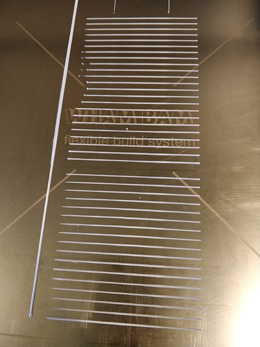

Ok. I am not sure which linear advance is even close to best. I have been staring and staring at this and I am just not seeing clear results.

I’ve honestly convinced myself all over the place. I am not seeing a really great line anywhere. I don’t want to seed your guesses with what I think, because I am confident I am wrong. So what do you all think?
It’s been a while since I dialed in my linear advance, but I ended up with very small values, like between 0 and .20, I think (I’m not near the printer at the moment). I ran the first numbers from 0 to .5, then picked the best line and ran another set between .10 and .25.
Yeah. This has a 700mm bowden though, so I am comfortable with it being larger. Clearly the largest values are bad. The lines don’t even start right.
Pick the two lines that look best, or the ones to either side of the least bad one, and run another set “zoomed in” between the extremes of those values. You may be able to discern more difference at a different scale.
I don’t even know what you’re doing with this… looks like I have more reading to do.
Right. I’m hoping some of you will zoom in and tell me which ones you think are the “best”. I’m having trouble deciding.

second picture, directly passing through the H of “Wham”

To me is on the 2nd Picture and the line that just touch the top of the Wham bam.

In the third picture the start is ok, then underextruding, then ok again, and then poor again. Im not sure how this can happen unless there is another effect superimposed on the linear advance variable. I’d run a pattern with constant linear extrude value to estimate the magnitude of the anomalous signal and if it is regular or random. Otherwise the “best” might be just random noise.
Linear advance messes with the extrusion. I have to smash the Z a little to get good enough adhesion across the whole line. I am guessing I still have a little funkiness at the very front edge of the build plate too.
You might be right Jamie. This is a test with all the lines set to 1.75. There are still some lingering issues.
I’m starting to think I just don’t like the bowden. I haven’t had an easy time tuning it. I think it just really doesn’t have the dynamic control over the flow rate that I am used to.

I set linear advance to between 0.35 and 0.5 depending on the part. But usually it’s at 0.4

The 0.35-0.5 range is useful. I’ve had it at 0.7 for the last few weeks and it has been ok, but it really affects speed. I’m not sure if it is a property of one of the associated accelerations or what. But I tried turning it to 0, and the thing just flew.
