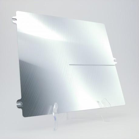

You’d need to figure out a way to mount it, but here’s my bed. It doesn’t warp with heat.
And heater
this. I always let the bed come to temp (at least 65C) and soak for a few minutes before starting any job. the bltouch probed value will drift otherwise.
