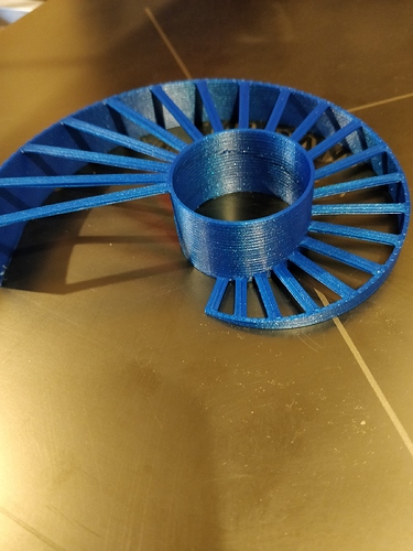

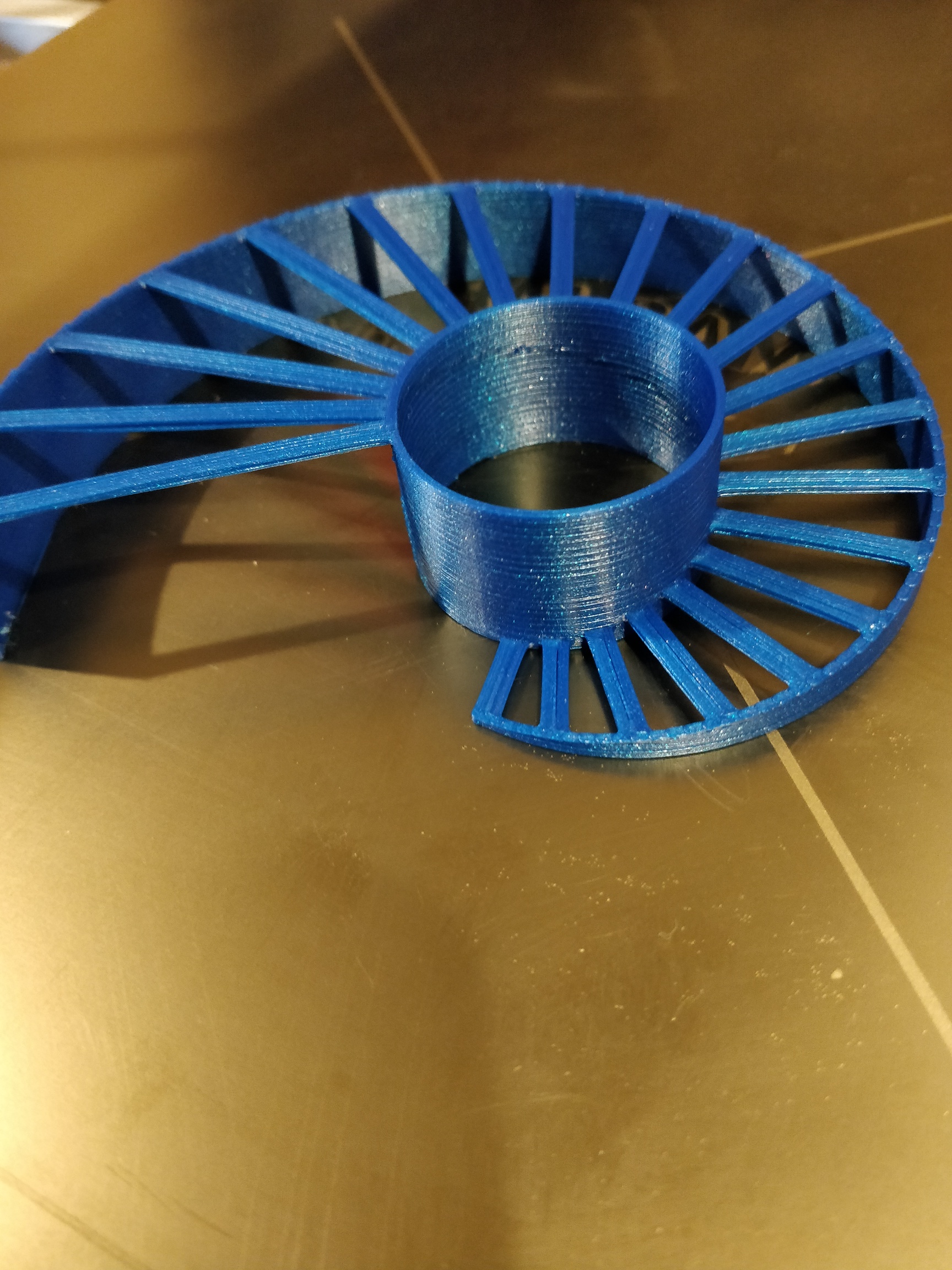

I printed an overhang test. It passed quite easily:

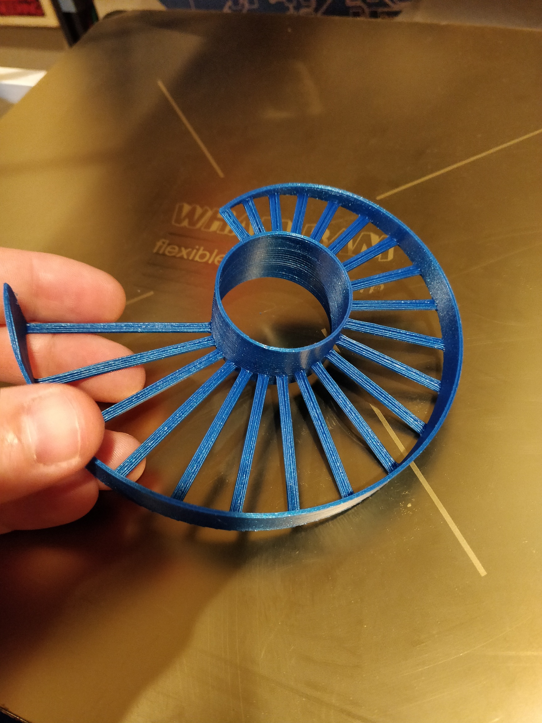

And it printed Ryan’s test part in vase mode, with a brim and no bottom:
In total, I am pretty much in love with it. I love how it looks and how smooth it moves now. It can print fast and big. Definitely an upgrade over my wanhao. It is a lot easier to work on too.

Realy like the overhang test, what speed and temp did you use?

I have this set to 80mm/s for perimeters, 40mm/s for external perimeters, 100mm/s infill, and bridging is at 60mm/s. The first layer is 30mm/s. Travel 150mm/s.
Those speeds are faster than I was printing on my wanhao. And they still seem conservative. I may try to push it a bit more, because I don’t want to leave half the time on the table, but I will always keep them conservative. I would rather it run all night than run half the night, and I wake up to a failed print, and half a spool gone.
