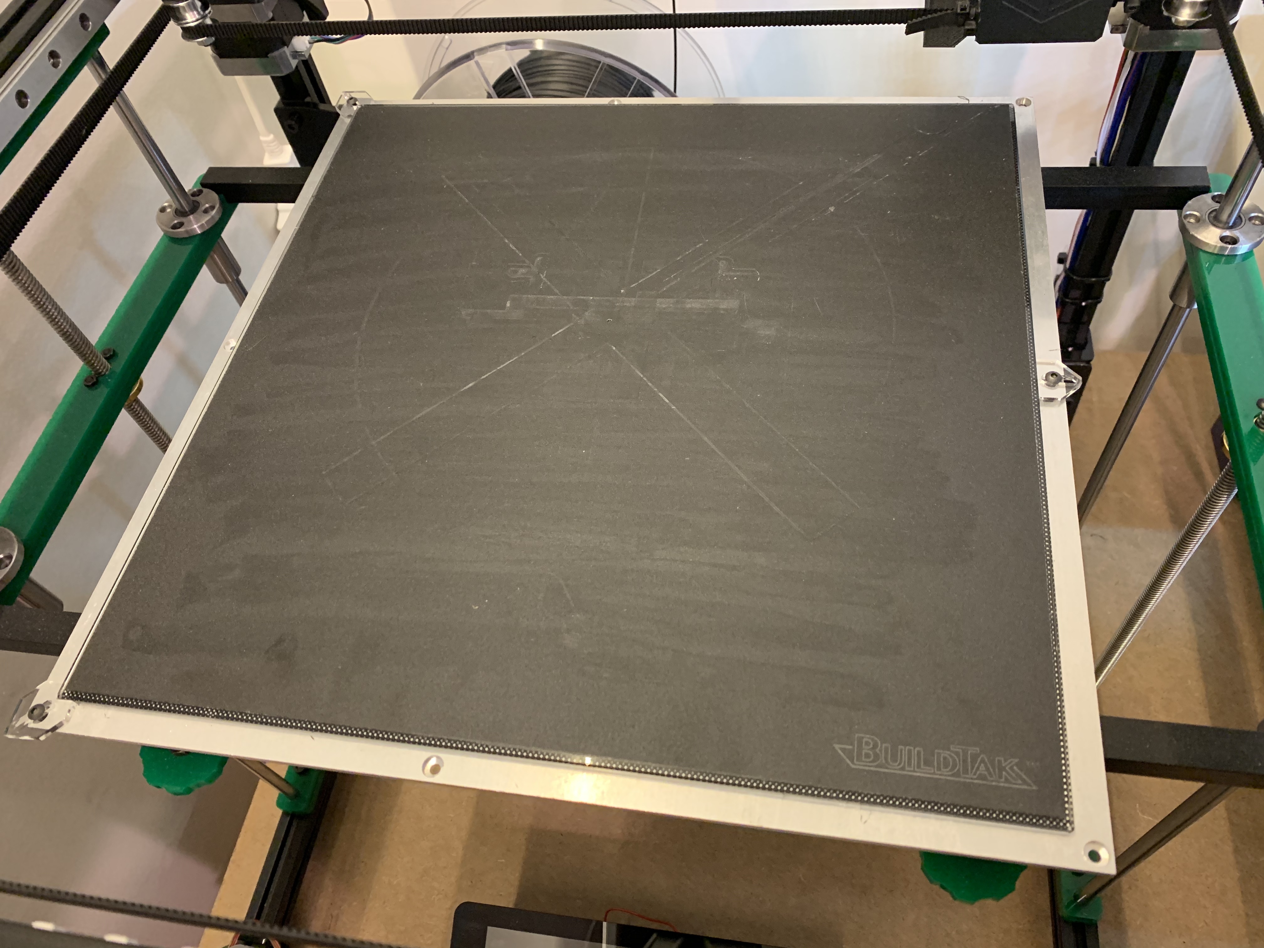

Does the bulge go away if you leave the bed up to temp for a while?
I don’t think so. How long is a while?

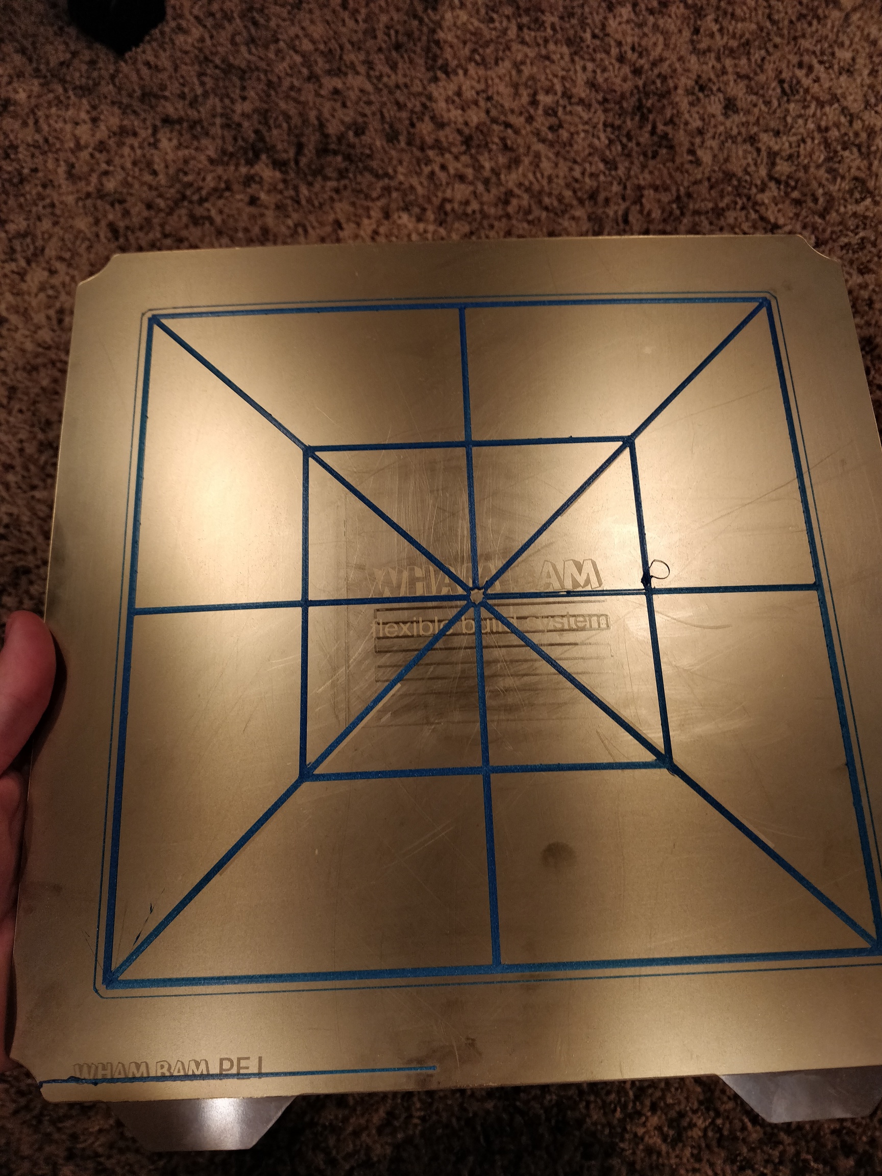

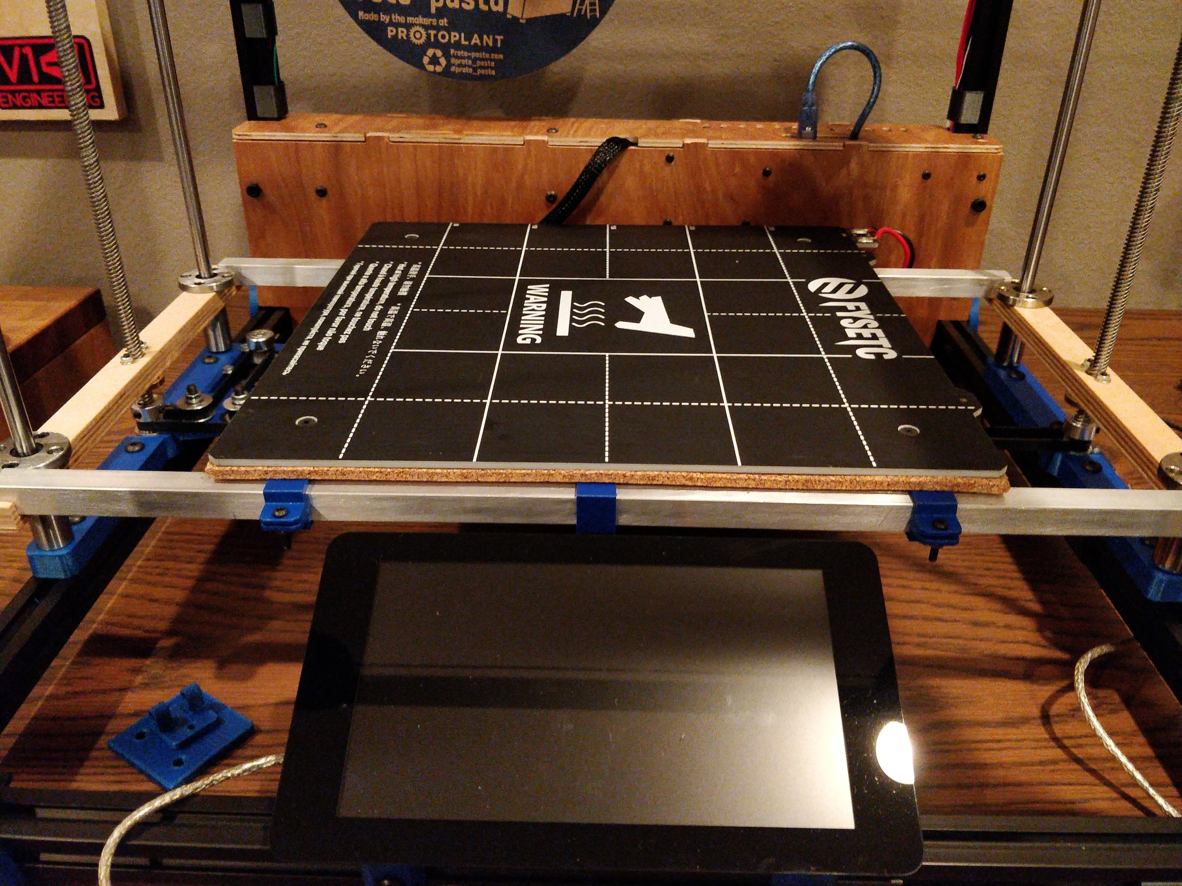

Just an FYI, this is a PCB bed, with a heater etched on the top, and the bottom has cutouts for magnets, which they epoxied in. On top is a spring steel sheet, with a PEI sticker on it. Underneath is a piece of cork. The whole thing is mounted rigidly (no adjustments) to the two aluminum C channels.
I’m not sure which part is bulging, but since it’s in the middle, I think it is the PCB. I am guessing you’re asking because a piece of aluminum will expand with temperature, and that would even out over time, which would make it flatter.
I don’t like the one I put in there either. I inteded to make a cheap bench power supply with it, and it defaults to having the output off, so I have to keep lifting the printer to push the power button.
I leave my beds floating on three thumb screws. The screws are positioned in such a way that they “capture” the cork, thus no sliding around. But also, the bed isn’t mechanically bound against expansion and contraction.
I could try to loosen the screws and see if that helps. I need to do some comparisons. I’m interested to see if it is a problem day-to-day, or even right after warming up vs. after a few minutes or an hour. The bulge doesn’t really bother me, as long as it is consistent. I can definitely loosen these nuts that hold it on to give it some slack.
I’m getting to the point where I’m happy enough with the bed levelling. I certainly think I could print a big object, although it might have a tiny foot on it right now. I am printing a big spider web, and then measuring the thickness with my calipers, and it is between 0.1mm and 0.18, when it should be 0.2mm. So I should be able to tune that out with M851.

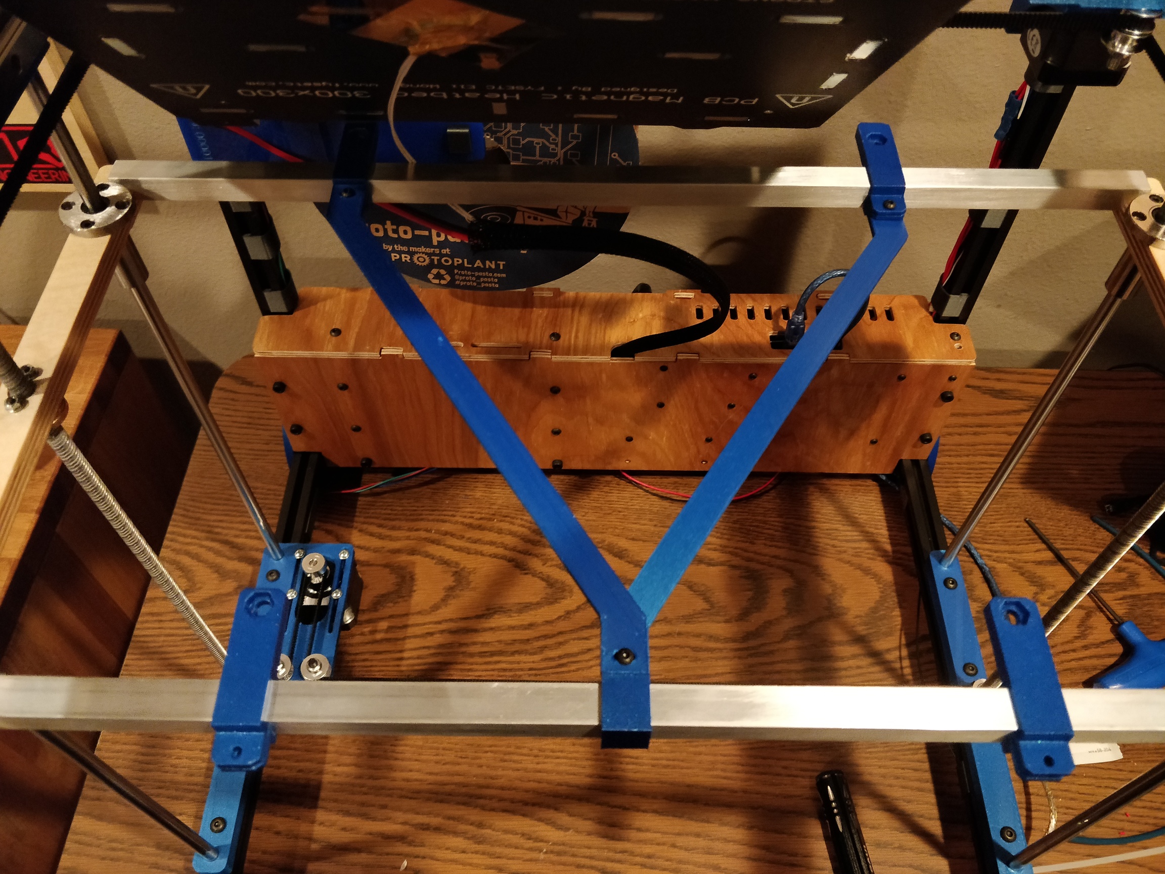

I’m getting around to printing those braces for underneath the bed:
Not sure it will need them, but I’m curious to see what affects it will have.
I installed those cross braces. I also had to rotate the bed by 90 for the cables to clear the enclosure.
I don’t know if I’ll ever print this high. But it’s nice to know it’s clear. I also loosened 3 of the bolts holding the bed down. So one is tight, nearest the corner I home. The other three are loose. I am not seeing a difference in the bed level though. NBD.
i see. your heated bed is smaller than the ones I sourced which are 330x330. so on my printers, the bed sits on the thumb screws just outside the cork.
