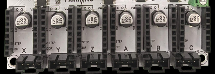

Connecting external drivers is possible via the Jackpot. Just connect the external drivers to the corresponding port on the Jackpot .
With little problems i can find dir and step here.

The signal is the same, should work. All these boards are basicly the same.
