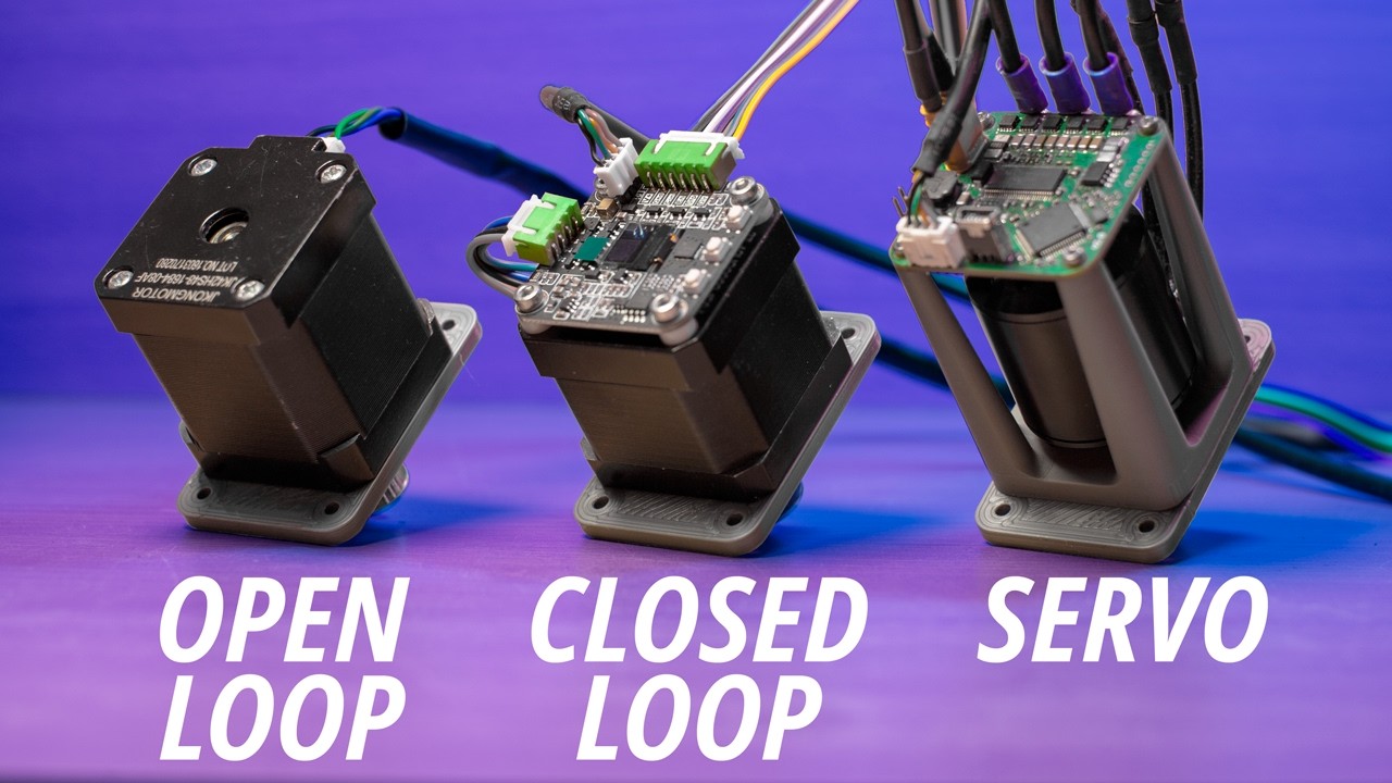

Jackpot with closed loop steppers?

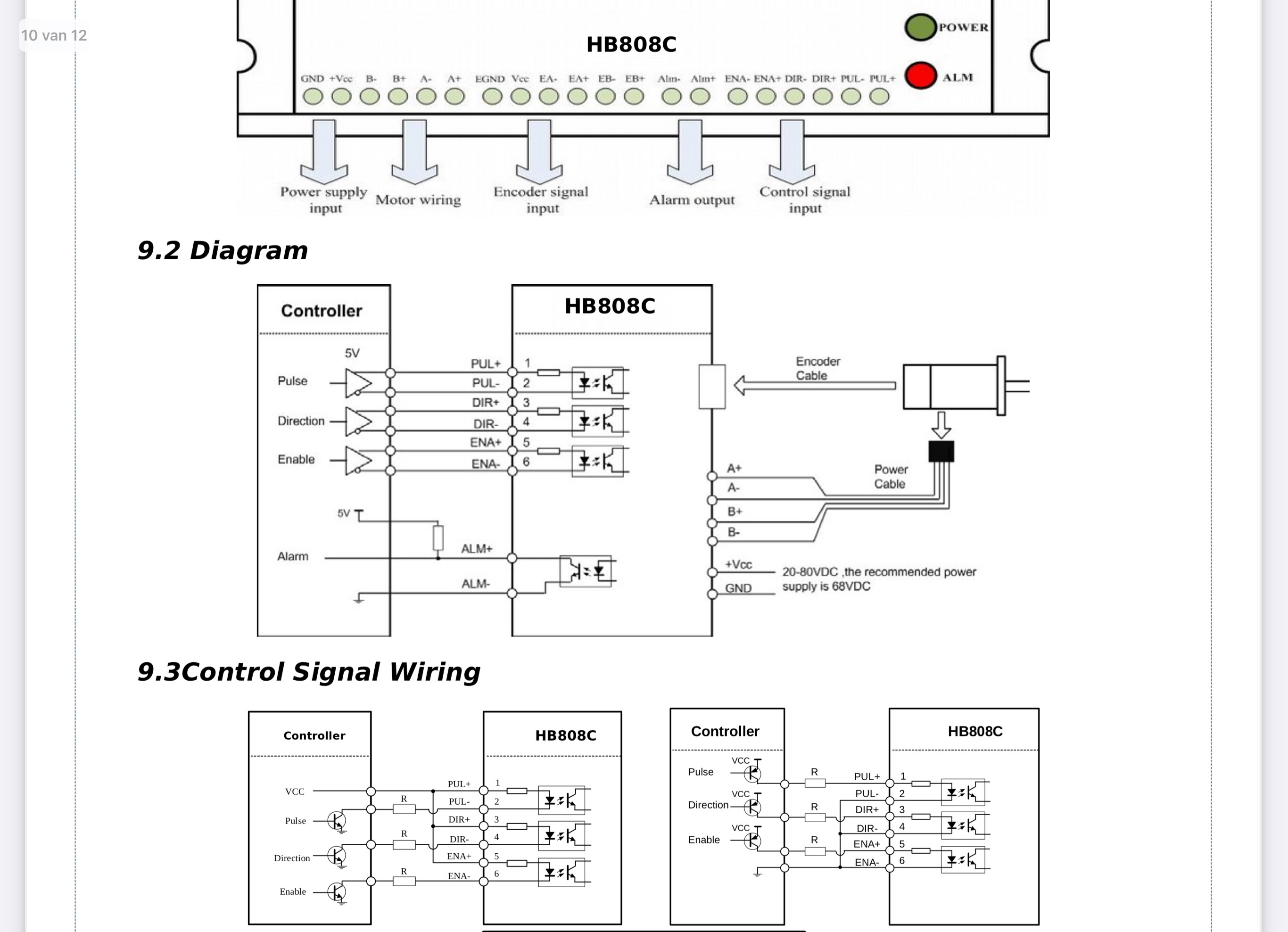

This is from the manual of the HB808C:
What is called controller is your Jackpot with the previous ports mentioned.

I was just remembering, I don’t think external drivers will work with the Jackpot. I think it’s using 3.3v signals and external steppers need 5v. It could be a case where they might work at 3.3v but not designed to.
http://wiki.fluidnc.com/en/support/external_stepper_motor_drivers
It also notes you shouldn’t mix TMC drivers and external drivers. That’s in reference to a different board but talking about using 5v.

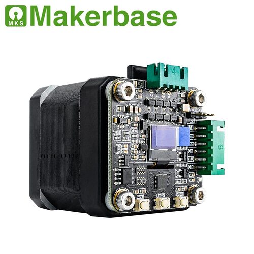

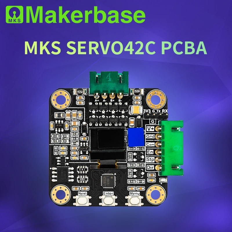

To be mounted on existing nema 17 steppers and Jackpot :slight_smile:
And provide level shifting from 3.3V to 5V IO.
Also provide ESD protection so you don’t blow up the ESP-32 in the jackpot.
I have a set of closed loop steppers, and a pile of jackpot boards, but there are details- like ESD protection- that have prvented me from testing this (yet) on X my LR4. Y and Z present packaging issues.

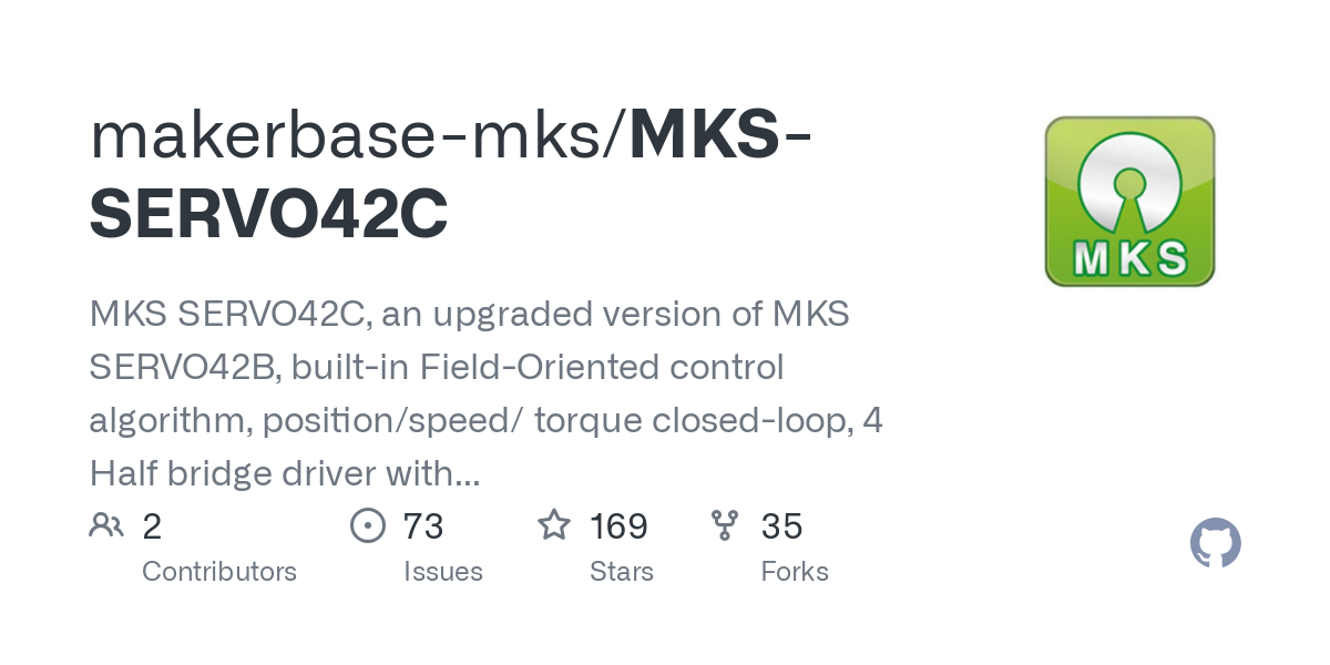

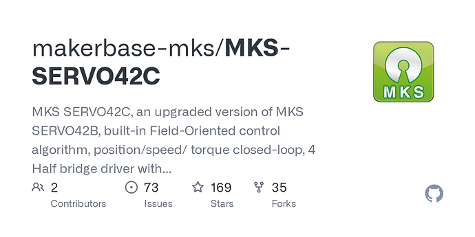

Interesting. That link didn’t work for me but I see a couple versions here.
And cpmplete github wiki
