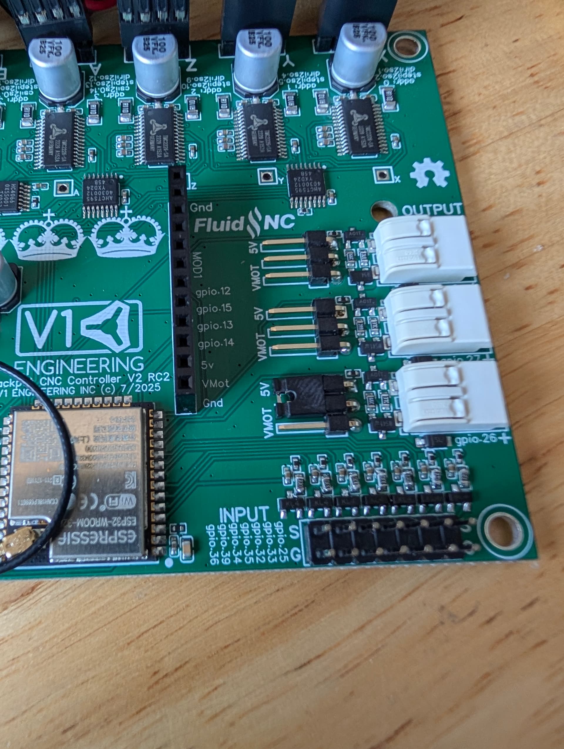

You know, I can just change the 4 wire connectors on the jackpot v1 and people can make their own choice. No instructions to change, nothing.
I like the jackpot 2 but adding the jumpers for output selection honestly took away the whole, “i don’t need to assemble anything”
How about screw terminals or attachment poins for a solder on for the technicality advanced ?or does this not work.

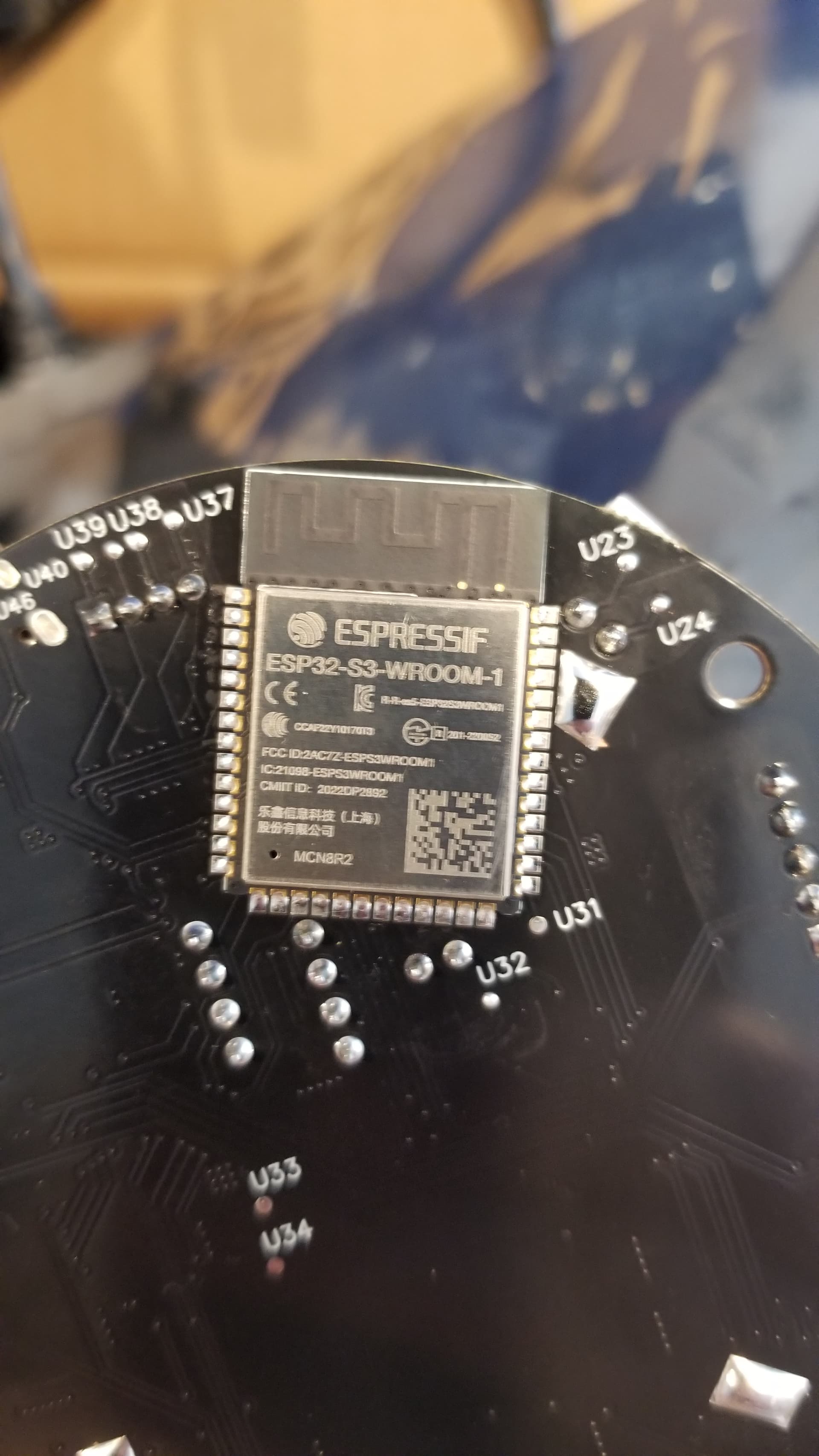

Maslow 4.1 controller has ESP32-S3 WROOM. Runs FluidNC fork customized for Maslow.

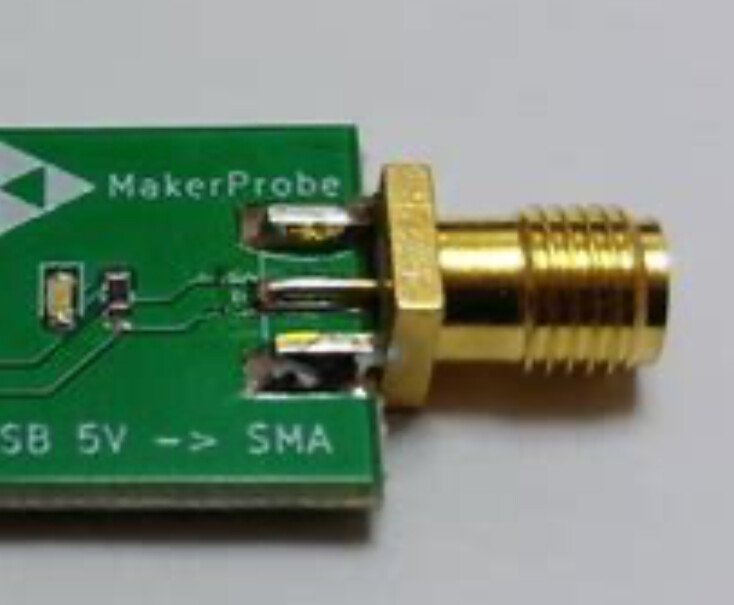

and is it possible to have pcb antenna which ends with solder pads so one can solder extension to it? Sorry, I don’t know a lot about radios :slight_smile: That would work for people with soldering iron? Or ones who so desperately want it so they go to some local solder guy who does this for them for little money :wink:

If you’ll take my advice please consider a direct on board SMA for the antenna rather than that board plug. They are too delicate and easy to damage.
Something like this lets you attach a whip antenna or a short flylead and is at much less risk of damage.

With that said does grblhal support the s3 already, I think it does.

That is already on the ESP32 can’t change it or I would have already. I am very afraid of the delicate little miniature plug my fat hands have a hard time using.
“If you are going to use native USB for the main connection it will be a somewhat faster. Other than that it will be comparable to a plain ESP32.
Native USB and more pins available are the main plusses, a negative is that RMT stepping is only available for up to four steppers vs. eight for the plain ESP32. And I2S stepping was hard to crack but should be ok now, except for 16 bit.” ESP 32 S3 Support with and without I2S · grblHAL/ESP32 · Discussion #107 · GitHub

This board was supposed to be the easy board. The v1 can easily accept an external antenna, no reason to have both antenna versions of the new design. If anything, the V2 has one less output. Other than that, functionality is 100% the same. V1 can have either antenna style, problem solved, no extra boards need to be produced.
I have been doing everything possible to make better heat dissipation to try and get rid of the heat sinks as well (which might already be fine, definitely with a fan and slight board box redesign).
So now, any ideas about getting rid of the voltage jumpers? Maybe a tiny switch?

No brainer for $0.02, Slide Switches | Electronic Components Distributor | LCSC Electronics way cheaper than ordering and hand packing jumpers.
