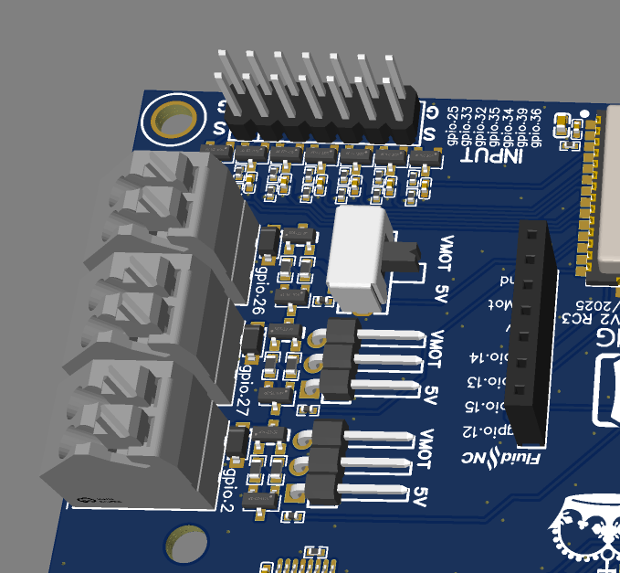

I’m interested in this what would I look for for android, or windows? I hesitate to tell people to do this with their main machines but if it is just a shop machine this seems okay.
Seems like the perfect application for a block of dip switches.

I went there first and they are just two pin on or off. These are SPDT, on a reel, handle up to 50v, hanxia SK12D07VG3-T Pinout Diagram & Footprint Diagram | LCSC Electronics $0.04 each, Looks good to me.
Nice!
That works-ish. The thing I dislike about those style of switches is that it’s sometimes hard to tell which position they are in because they move so little, particularly when they’re in that orientation, rather than facing upwards… but are probably better to be in that orientation so they don’t get accidentally toggled.
I was thinking about something like these: 76STC04T | Grayhill | Price | In Stock | LCSC Electronics
…but they’re stupid expensive and only 30V 0.15A.
Can LCSC not supply the jumpers already installed?
nope, that is what I was thinking when I put them on…such a bummer.
Looking at the image of the board in the very first post, and thinking about the yellow brick road, have you considered changing the silkscreen labels for the stepper motor headers to X1 (or Xmin) and X2 (or Xmax) rather than X and A, etc.
Problem with that is it would have to be different for the LR4 vs the Primo. So for that reason its probably best to leave it how it is and explain it in the docs.

Not quite. The V2 has 4 GPIOs on the expansion connector instead of two. This might be quite useful.
Maybe V2 is the more expandable board.
I need to noodle on that a bit
They both have 4 right?
Oh, shoot. Right.
It’s Bart’s integrated 4driver board that went down to two.
I think We need a pin swizzler expansion carrier to take best advantage of those 4 GPIOs.
Technically yes, but not really. The trace layout, width and impedance all matter quite a lot for avoiding signal reflections etc.
I don’t know how much performance you’d get relative to a ‘proper’ connection, but I’d wager maybe 50%?

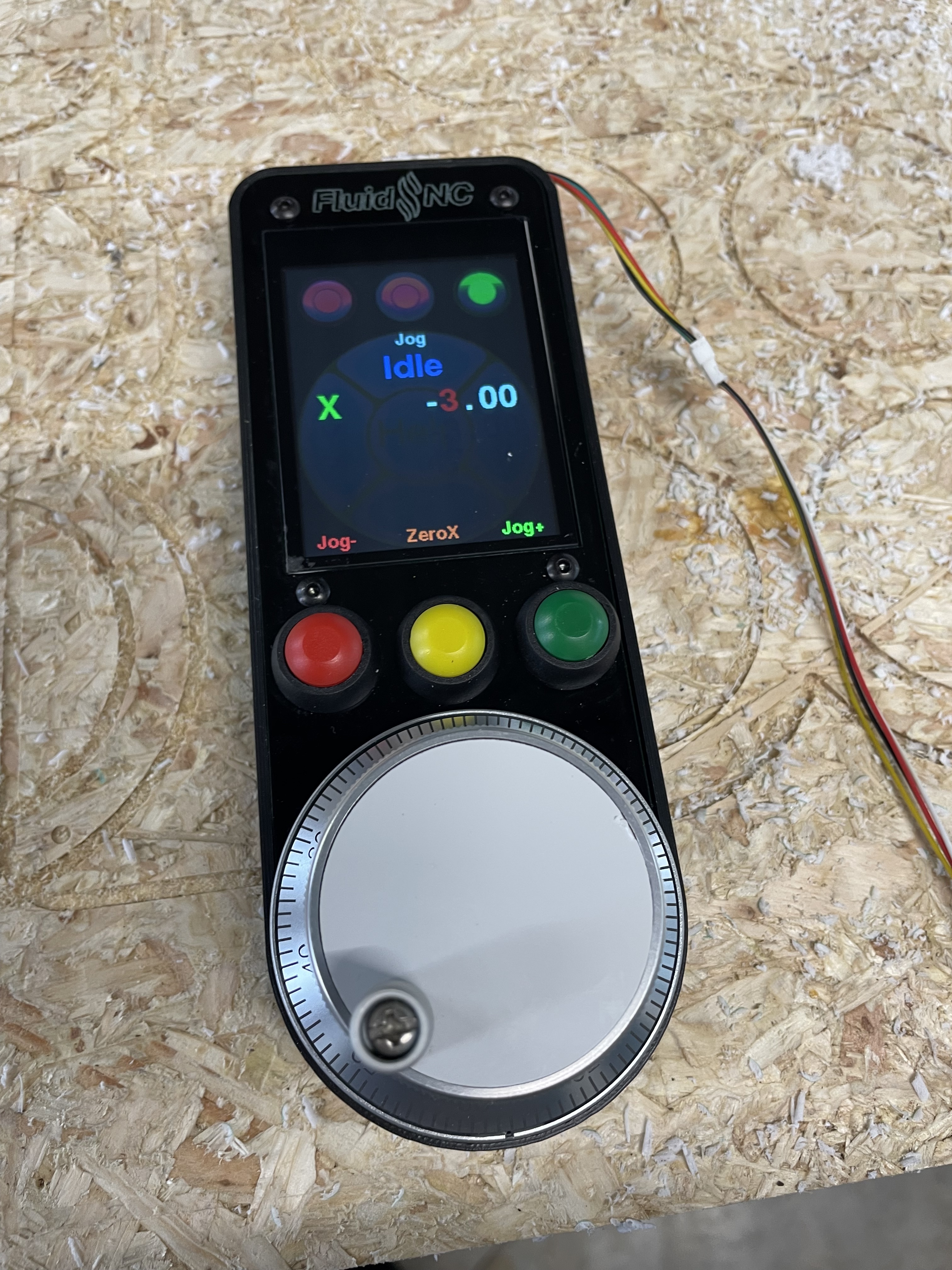

I have 2 of them. One on my MPCNC and one on my LR4. I started with the M5, but didn’t like the dial on it. The CYD dial is much better.
Cool, I have a couple of the screens, I need to grab the fancy dial and the cheap dial and give it a shot.
I’ve a CYD pendant too and I agree, I much prefer it to the m5dial.
The jog wheel is more responsive - I can leave it on single mm and sprin it fast enough to really move.
It’s also smooth enough that I can use it one handed while squinting at the end of the bit :grin:
