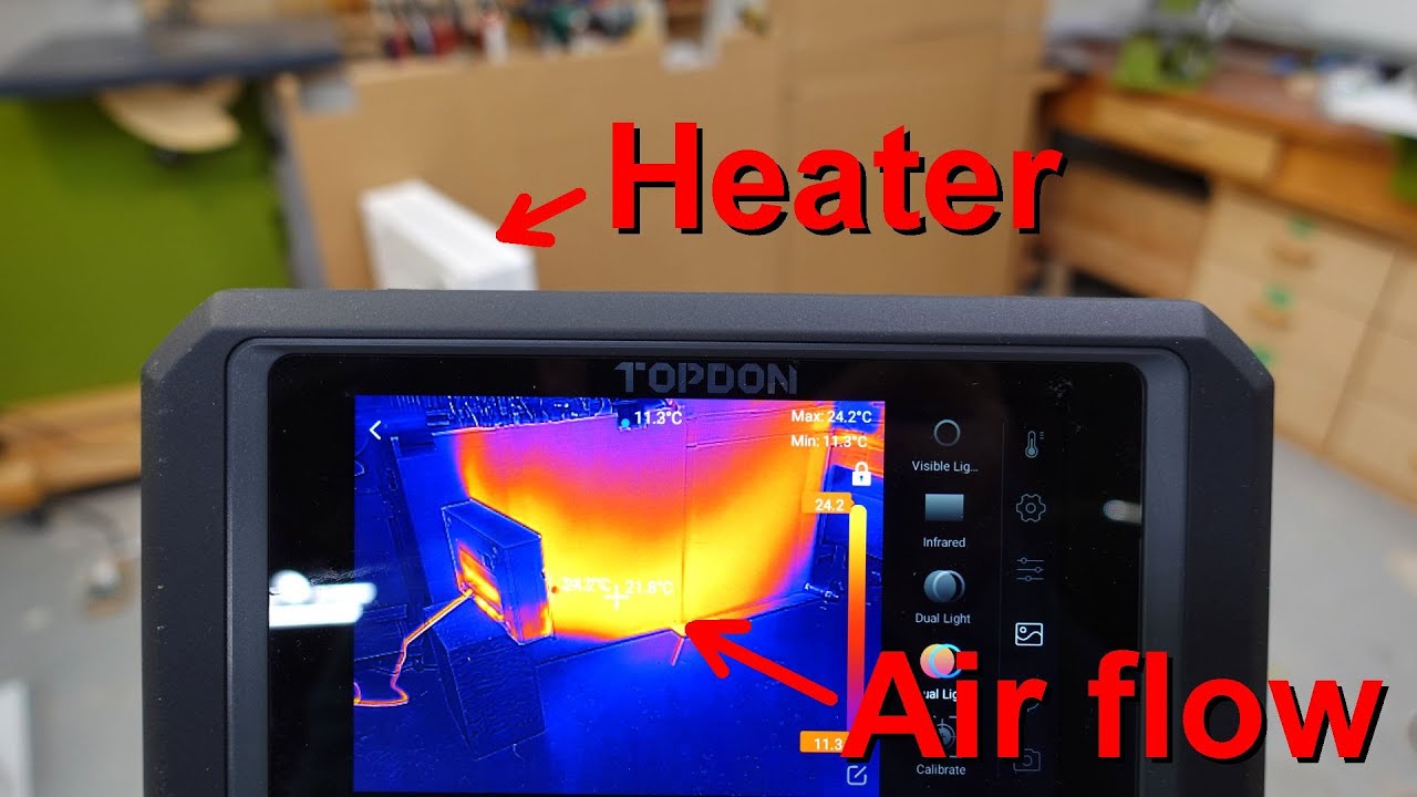

Is it one that others can afford, or do we all have to borrow it from Jeff?
It’s a fairly affordable Topdon camera. Looks like they go for around $200 on Amazon, perpetually on sale
Oh yeah that is 256x192, mine is 160x120! For most things I don’t think it matters but on these boards…That added resolution shows a lot. I need to trade up, putting my flir on ebay.

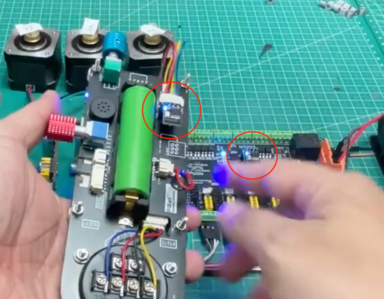

Ryan did you see that PiBot board from the other thread?
The product page shares the whole schematic too.
I don’t see a schematic for the pendant. They have a PCB carrier but no enclosure yet.
It looks like they’re using bluetooth serial bridges- one module on the pendant, one module on the FluidNC host board.

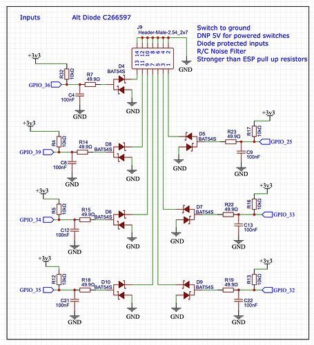

It just occurred to me, would these not be better than what we currently have on the inputs?
Seems like there is more protection and less components? Maybe a slightly better price.
Paging @jono035 .

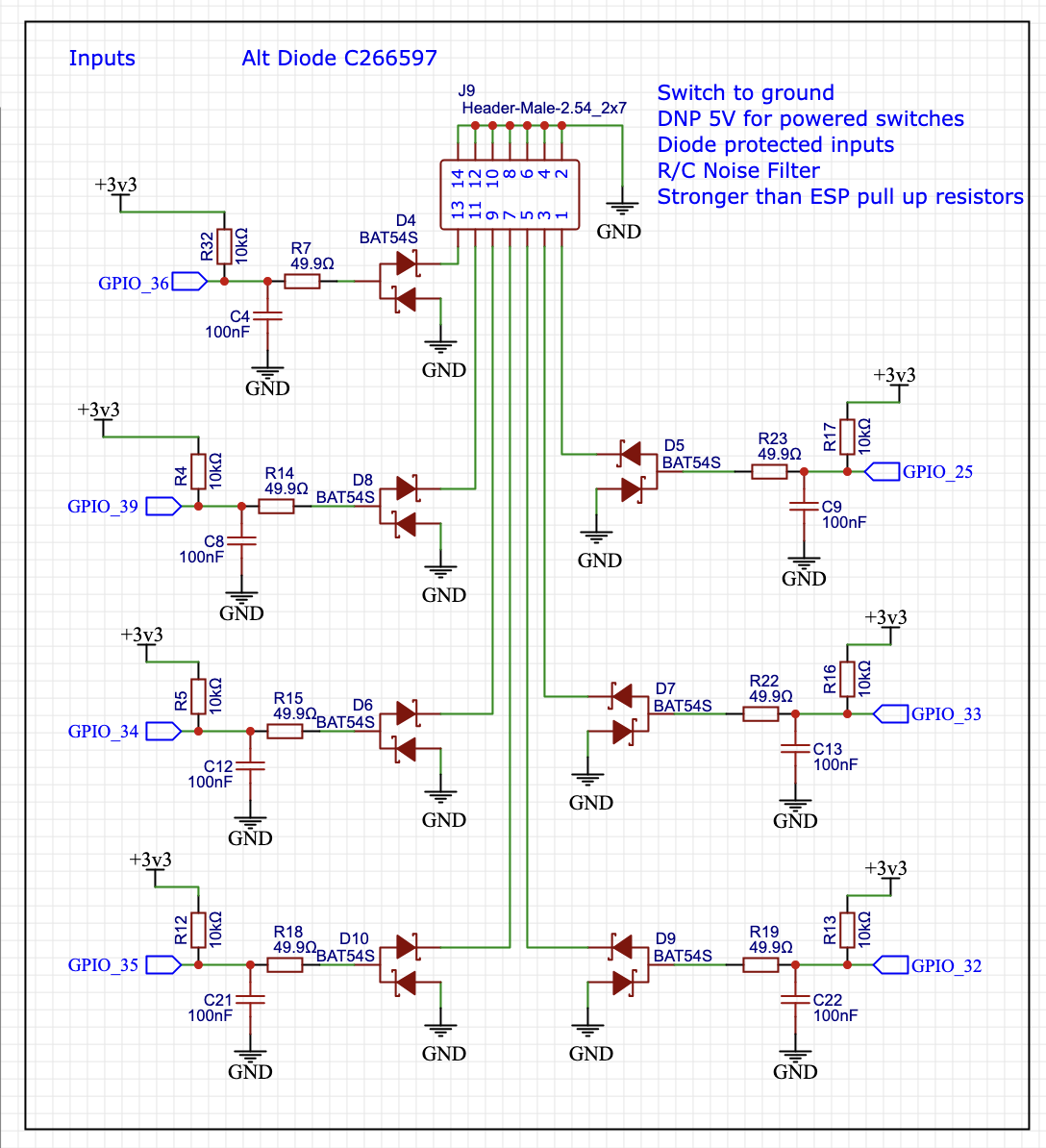

Present Jackpot V2 design looks like this for the inputs:
@vicious1 - Bart just released 3.9.8. Should have fixes for the enstop issues.
Potentially. They’re quite different approaches.
The current design will accept any input voltage from 0V to the 30V blocking voltage of the BAT54S and has different timing going from high to low and low to high.
The input with the ESD suppressor on it will only accept 0 to 3.3V but has very little impact on the speed of the edges.
As for less components, you’d still need the pull-ups and filtering components, so it’d be replacing the 7x BAT54S diode arrays with 2-4 ESD suppressors, depending on routing etc.
It wouldn’t be a bad idea to have some ESD suppression on those inputs, as well, but it’s much less of an issue given they’re hooked up to normally closed switches so are normally just shorted. That’s the kind of thing where I would think it’s acceptable to just recommend standard low-ESD practices while assembling and then not worry.
