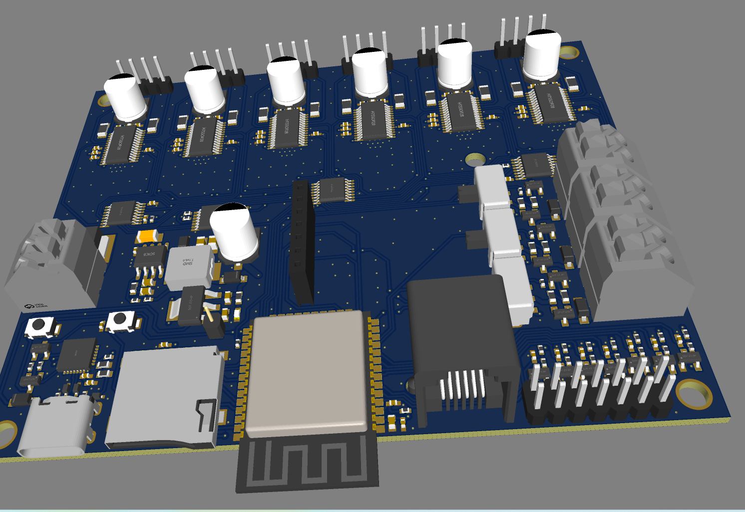

But, Jackpot V2 is an integrated board- so you want to at least try and avoid someone ruining a $75 or $100 board because they did a common thing like plug in a pendant connector that they handled with their thumb or accidentally unplugged or plugged in at the wrong time.
In the ecosystem, the other sibling board designers have reported they get notably less returns with their admittedly non-ideal protections. That’s probably the right level of effort, and Ryan working to make his board just a bit better is typical Ryan.
What I’ve seen in the thread above for the new design looks like it’s going to be the right compromise between perfect (Impossible) and nothing at all. Said differently, good enough. I think the Jackpot V2 is going to prove to be better than good enough. That’s what Ryan has said he’s shooting for- and I think he’s got it.
Yes, this. What Ryan’s designed above doesn’t look utterly ridiculous to me and in fact looks reasonably good for an inexpensive design.
It’s got a reasonable ESD protection, series protection resistors, an appropriate looking amount of capacitance in the right places for the interface.
It doesn’t look like it will cause problems for a 1Mbps serial interface, and it shouldn’t get in the way of using the expansion header in the normal way.

It just barely fits.
Come on, not you as well… :eyes: But it looks great, it is going to be an awesome board! :slight_smile:
Why not just make the board an inch bigger? Is this like the optimal size for paneling or something?
Then you can have even more cooper for cooling
:nauseated_face:
NEVER!!! Most efficient package! I just can’t bring myself to make it bigger if I can make it fit.
If we add more room you guys will want more stuff built in…

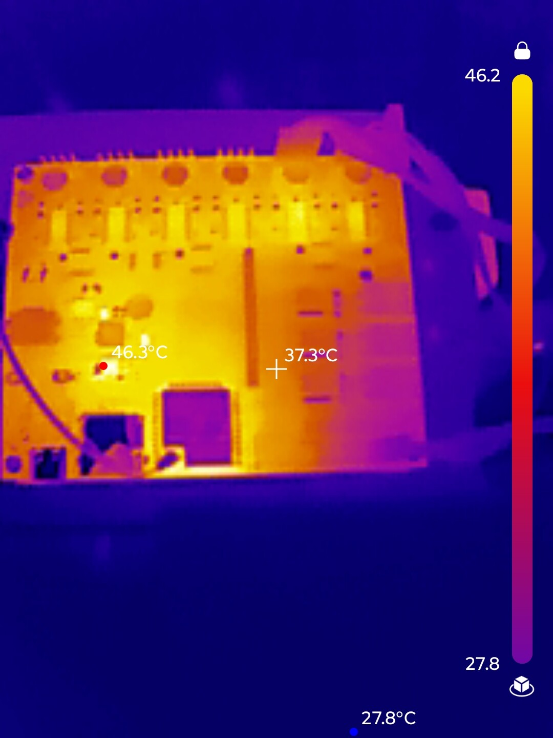

I took a bit of a journey down a rabbit hole.
@jeffeb3 loaned me a thermal camera, and I happily went to throw it on the one android phone I have, which is a backup for when I travel.
That old clunker didn’t have a USB-C port and I didn’t want to start making an OTG+adapter cable+hand managed external camera.
So it turned into research on what affordable, 5g, Android, mediaTek, unlocked phones there are.
That took days longer than I intended.
Result: some jackpot V2 thermal pics.
This is on the JL1. Not a stressing application. Today was cool unlike the days this week which were up around 100F. It gets to 112F in the garage. No PLA sagging now for several years these machines have been in there.

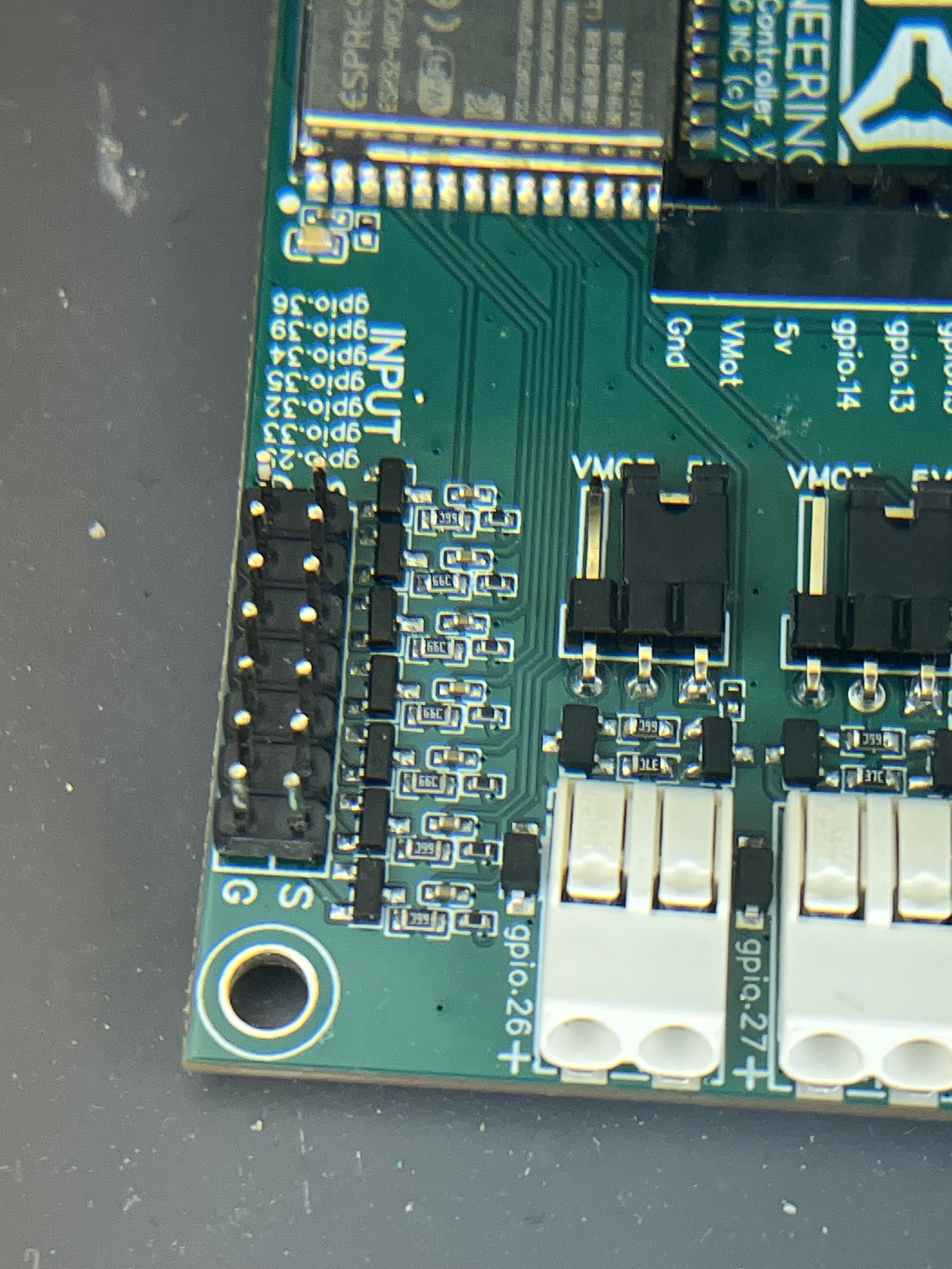

I managed to get some tiny SMT resistors removed on the board I am modifying but still need to add the different parts back on.
My eyes, hands, and eye/hand coordination aren’t what they used to be. Don’t get old!!
Those suckers are tiny!
This board doesn’t have the better connectors that Ryan found for the release boards.
And I’m still learning how to drive the camera app. Don’t trust any numbers.
Have you got a viewer or microscope? That and reorienting the board so you can keep as much of your hand touching the benchtop are what works for me for real small stuff, although I’m still at the point where I can work down to 0603 without magnification.

Nice, that camera has much better resolution!
Argh. I didn’t even think about that. I hope you didn’t spend to much on a burner phone. The camera itself was not that expensive.
Why were u removing them?
A component change happened in the design, no reason to trash an otherwise perfectly functional board- so I’m reworking it.
