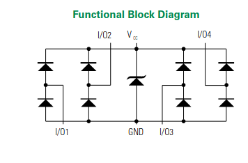

This is the type that I suggested:
Each IO pin has a diode to Vcc and a diode to ground. That’s basically the same structure that’s in the ESP32, just that it won’t be designed to handle a lot of current because they’re trying to cram a ton of other stuff onto that die and using tiny structures in order to keep the die size and subsequently costs down. In this device it’s designed to take much higher pulses of current specifically for ESD strike situations, although it’s still relatively small as protection devices go as can be seen by it’s 4.5A rating, it’s a ‘bit extra’ protection, not anything super bombproof.
So when the ESD strike occurs, it’s basically the same as having a tiny capacitor charged to several kV connected directly to the incoming pin. With no protection devices that voltage will get applied directly to the ESP32 and lead to a lot of current flowing where it shouldn’t, burning out the pathways on the chip.
These devices work by redirecting that energy elsewhere, ideally before any of it gets to the ESP32 but in reality more like sharing it out. With a plain TVS is is basically just a big zener diode with a crappier datasheet. Assuming a positive ESD strike, the one you posted above will do nothing until the voltage gets to around 16V then it will start conducting. As the voltage continues to try to rise it will start conducting more with its terminal voltage rising accordingly until it sees ~18V at a few amps or whatever. Depending on how serious the ESD strike is, the current will keep rising to a point and then start to drop back as the capacitor is discharged into the device. The TVS is just there to try to reduce how much of that ~10kV actually makes it to the ESP32 or other devices, or even the circuit board traces themselves. You’ll never actually see that 10kV because things will start to break down and conduct before that, which makes the explanation difficult, but if the TVS was soaking up 4-5A at 20V then if it wasn’t there that same current would have to go through the ESP32, eventually. The TVS is designed to handle that, though, and so it survives, just getting a little warm in the process as the energy is dissipated in the lossy semiconductor junction.
With the diode bridge style then ideally they’re connected with the Vcc and 0V pins to your rails. As the ESD event happens and the voltage starts to rise the diode between the IO pin and Vcc starts to conduct and essentially ‘clamps’ it at Vcc. For a small strike and low current that might keep it to Vcc + 0.5V, let’s say. For a larger strike there will be more voltage between the IO pin and the Vcc pin but it also starts to depend on what happens to the Vcc pin. Maybe it ends up going to Vcc + 2V at 4A, let’s say. The next part of that is where the energy goes because all that diode is doing is steering it to the Vcc connection. If there’s nothing else connected to the Vcc pin then the internal TVS will start to conduct and the voltage will rise to 11V or so. If the Vcc pin is connected to the voltage rail then the rail itself will start to rise, charging the capacitors. An ESD strike has a lot of voltage but not actually that much energy, fundamentally. It just delivers it very fast and in such a way that a lot of bulk capacitance like electrolytic capacitors won’t be able to ‘keep up’ and respond. That’s why having a decent high-frequency decoupling cap on the pins is a good compromise, it’s not so much energy that it can entirely swamp the ESD strike but it’s fast enough that it can respond and absorb some to limit the voltage rise further. The other nice thing about having the strike redirected to Vcc is that it can cause Vcc to rise slightly during the event which also helps to protect the IO pins. Usually the damage to the IO pins is because of them exceeding Vcc and causing parasitic conduction within the die. If Vcc rises along with the IO pin then this doesn’t happen. Of course, that puts you at risk of damaging the entire chip with Vcc getting too high but that’s less likely given the limited energy of the ESD strike and the number of decoupling capacitors around the place.

This is where the diode array style ones come in. Rather than relying purely on the somewhat poor and ‘slushy’ specs of the TVS, they use the voltage rails themselves. Rather than trying to dissipate all that energy as heat, instead it re-directs it into the voltage rails to be stored in the caps, to be used by other devices and then to be absorbed by a TVS if necessary. This has the advantage that the TVS isn’t connected to the pins unless there’s a high voltage event, so you don’t have a huge capacitor connected to the pins. It also means that the effect is distributed a lot more which can minimize it somewhat. A pin being at 9V while Vcc is at 5V is very bad. A pin being at 7V while Vcc is at 6.3V is less bad and much more survivable.

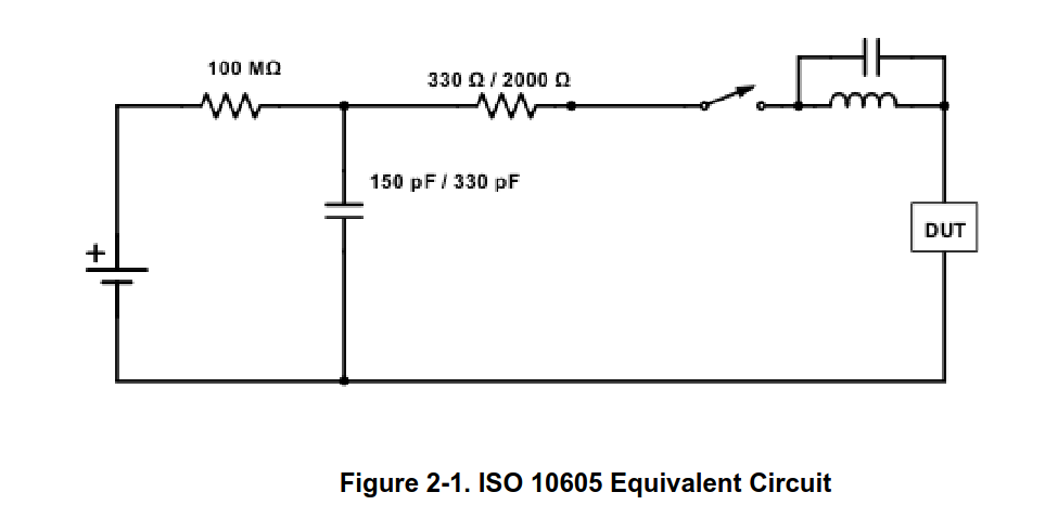

The thing is, you’ve gotta know the waveform of what you’re protecting against. That’s why there are standard ESD/surge/EFT etc. test waveforms, they’re intended to give you a relatively easy way to evaluate your designs without needing to rub a balloon on a cat or roll around on a carpet. ESD is usually defined by a circuit model, such as this one for ISO 10605 which is an automotive ESD standard I’ve looked at in the past.
The ‘battery’ on the left in this case is charged to whatever test voltage is applicable, could be 5kV, 12kV, 20kV or worse, depending on how stringent the testing is and what the expected use case is. The switch is deemed to close instantaneously and without bounce at the time of the strike initiation. It’s also done at least twice, once with positive voltage relative to 0V, once with negative.
The standard resulting test waveform is something like this:
So a few ns rise time and then 100ns fall time. That’s pretty fast, with broadband frequency components well into the 10s of GHz range. That’s why sparks make such good interference generators. That also means there isn’t much actual energy there at all because it’s over so quickly, hence why directing that energy into the voltage rail works well.

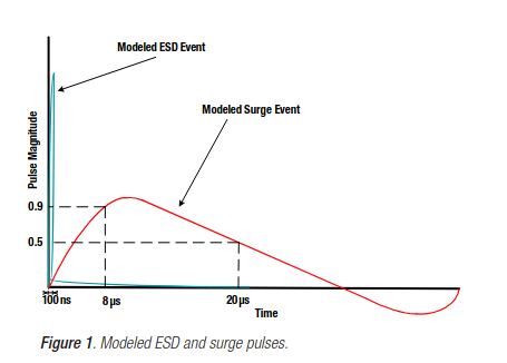

For something like a surge event, that may be an 8/20 or 10/1000 waveform, which is rise time/fall time in us.
That’s from a TI appnote showing the difference in speed between an ESD strike and a 8/20 surge waveform. The surge has much lower peak voltage but MUCH higher total energy and is usually more destructive on a systematic scale. That’s something you won’t see in this situation, but is a consideration for anything connected to cables that run between buildings or are connected to the mains. Typically they’re caused by lightning discharge currents causing huge ground lifts even many miles away from the strike area.

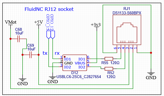

Ah found one!! USBLC6-2SC6 | ST | Price | In Stock | LCSC Electronics
And another, USBLC6-2SC6 | TECH PUBLIC | Price | In Stock | LCSC Electronics
Now lemme read that. yup, unidirectional.

Yeah, there you go. Anything specified as low capacitance is a good bet, not because we need that spec necessarily (although at 1Mb, we probably do need it), but because that directs you to that style of suppressor.
So, key things here:
Specifically says ESD, which means it has low inductance and good response time, necessary for the ~1ns rise time that ESD events can have. For this reason you MUST route traces through this part, you can’t just put it off to the side somewhere. Traces should go from the landing points to the pins on this part and then onwards to the rest of the board. It should also be as close as is reasonably possible to the landing point, really. Actually, looking at it there’s an example of that on page 5.
Peak protection is 15kV discharge both air and contact. That’s pretty good, I’d be perfectly happy with that for this situation.
Clamping voltage - Max 12V at 1A. That’s quite a high voltage but that will be just this chip in isolation. You can add a gruntier TVS or more capacitance at the Vcc pins, or connect it to the Vcc rail, and it’ll do better.
Another key point is that this isn’t the only ESD protection, the ESP32 will have its own internal ESD protection. This is just to make sure that it’s not seeing the full 15kV strike, which means that the internal ESD protection will see less stress and it’ll be much more likely to survive the dramatically smaller resulting strike. The absolute maximum ratings will also be misleading because they don’t have a time component, so you can’t say for sure what the actual pin will survive, short term.
Figure 15 on page 8 shows another great ‘defense in depth’ approach to ESD/surge protection. They have an external bidirectional TVS that’s protecting the transformer, then the transformer itself, then the TVS array, then the data transceiver will have its own internal protection. These things often end up being a bunch of parts all designed and intended to work together, either protecting against individual situations or each providing a layer. A big differential mode surge on the line will get somewhat clamped by that TVS which will stop the transformer being burnt out. The transformer might saturate and not let the whole pulse energy through. The energy that does get through gets directed to the rails by the ESD array. The energy leftover from that gets absorbed by the transceiver and stays within its limits.
Even if you start using Digikey to earmark half a dozen parts and then find equivalents on LCSC, that’s what I’d be doing. That part you’ve found appears to be an ST part and then the subsequent knock-off which has a decent chance of being made in the same factory :expressionless:
The ST part would be findable on Digikey and then further searching would lead you to the low price Chinese option. You probably won’t get the lowest of the low, price-wise that way, but think about how many boards you’ll sell over the design’s lifespan. If 1k boards would be great, then I’d budget MAYBE 10 minutes per $0.01 saved. I’d be looking for savings in the $1-2 range first and then moving on.

Yeah, that’s pretty much how I’d do it. If it were me, I’d add footprints for a resistor and capacitor between socket and the ESD array to create a filter in the appropriate direction (ESD array-resistor-capacitor-to-0V for TX, ESD array, capacitor-to-0V, resistor for RX). I’d also add a decoupling capacitor on both Vmot and +5V at the socket.
Don’t need to do anything other than maybe a 100R resistor and DNI the capacitor, but I’d always at least put something there.

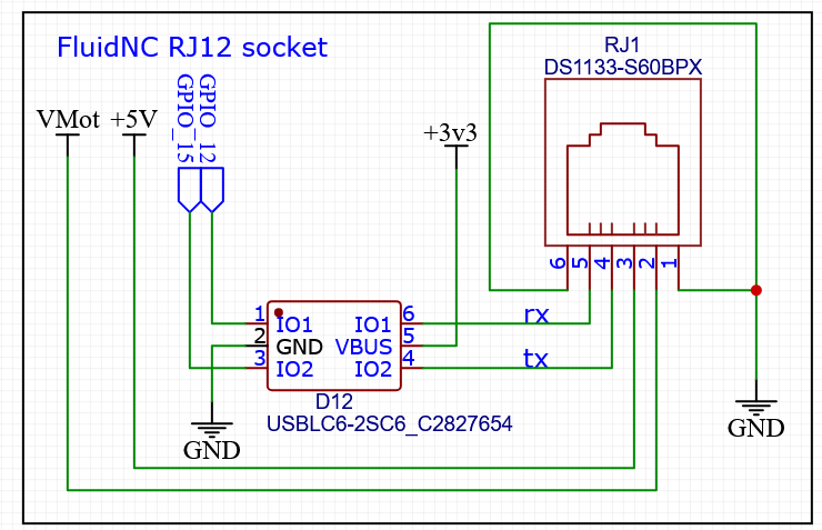

Boxed myself in real good with this schematic.
I used 120R because that is what the FluidNC guys have on their boards in case there is any tuning, we match.
Yeah, that’s a common enough experience. These days I always start with multiple sheets and try to make each sheet a single logical sub-group, even if it ends up looking quite sparse.
120R is fine. I would add the 10uF caps with their own ports and I would always try to minimize routing from ports. They can go anywhere so shortening those lines makes it much easier to verify by eye.
I’d also add a cap to ground (even DNI’d) between D12 and R55 and then another between R52 and RJ1 so that you can make it an actual filter.
So I’d have a +5V and Vmot port on the right hand side of RJ1 with short lines. I’d add a 2nd GND port for pin 6. I’d move C68 and C69 to the right side somewhere and give them their own Vmot/GND and +5V/GND ports directly on the pin.
Me philosophy with this is that the schematic has 2 jobs. One is to correctly connect things. The other is to display clearly how things are connected to anyone looking. Drawing long traces like that doesn’t help with either of those goals when ports are involved, so they can be omitted.
