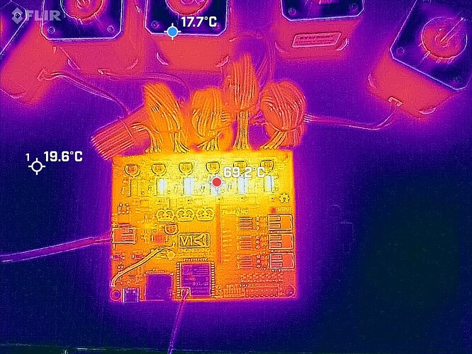

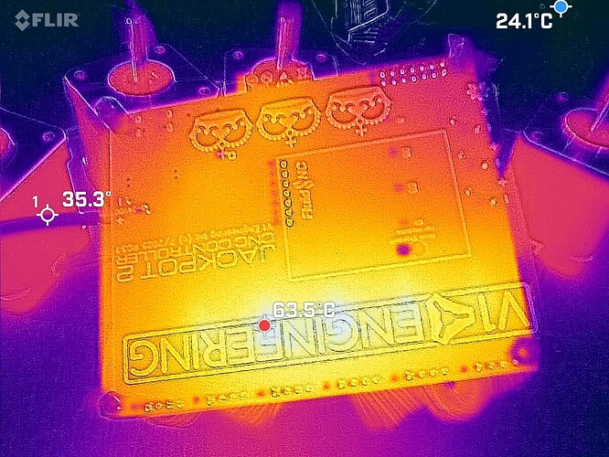

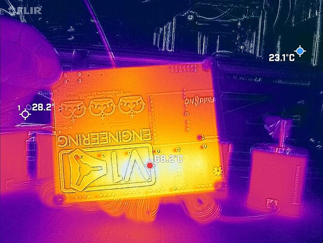

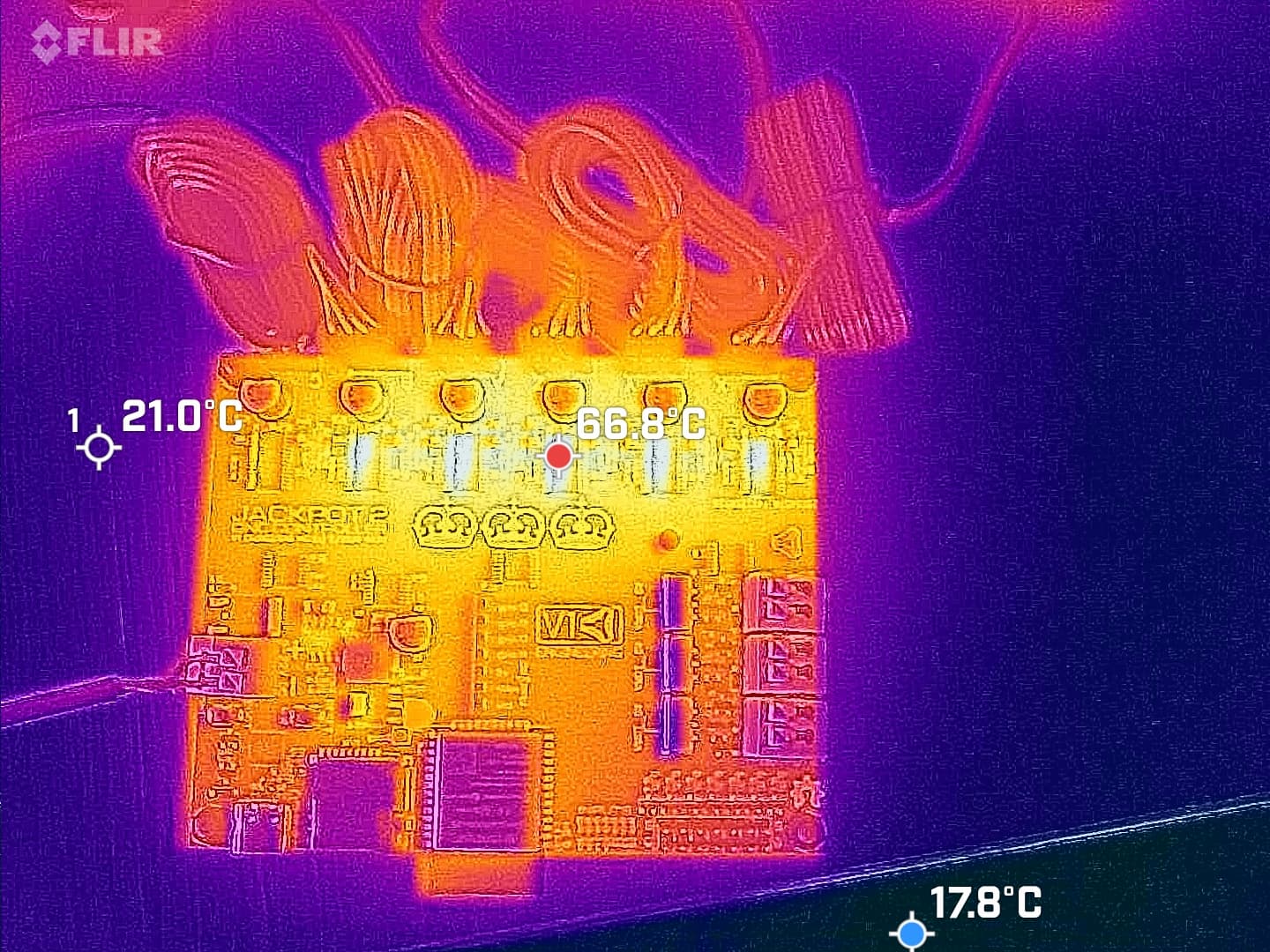

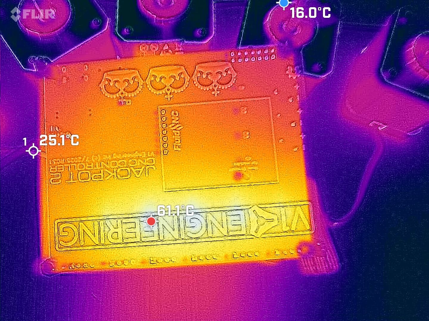

New
old
new
Old

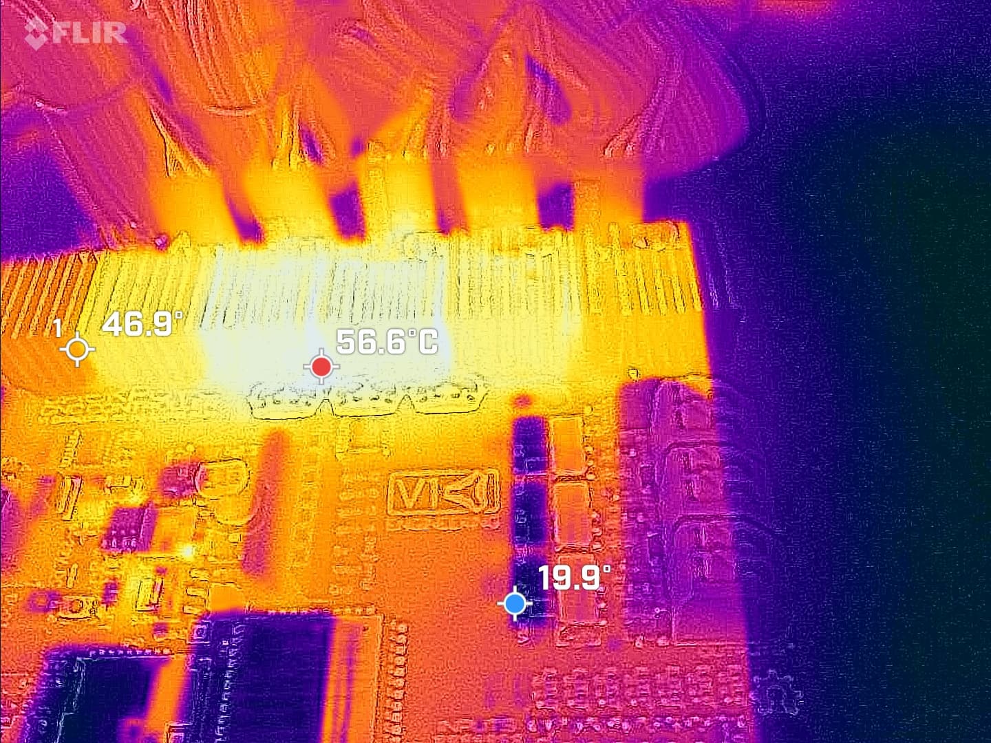

7.1C cooler on the bottom, and 2.4C cooler on the die itself, That is amazing!!! (at least it is to me).
The new one has been heat soaking at least twice as long as well.
Looks pretty good. I will say that 70 C on the board would be beyond what I’d be comfortable with, long term, but it’ll work. I suspect most of these machines will have runtimes in the 10s of hours median, 100s if someone is really keen or doing production work. I’m used to designing for 100k+, so that’s probably fine.
I’m still concerned that you’ll see thermal issues in an enclosure so it’s still well within fan needed territory.
Fan and heat sinks for sure.
I’m very glad. I’ve been sitting here thinking about what other test could be done to verify the thermal margin.
Do you know how the board behaves if a driver overheats? Does FluidNC catch it gracefully? Sticking a small cardboard box over the board and letting it thermally soak is a cheap and easy way to do thermal testing. If it cuts out with the backside of the board at 80C then you know you’ve only got roughly 20C of thermal margin.
That 2nd post with the heat-sinks really does illustrate just how poor the cooling is through the top of the package. All that extra surface area and it’s a 5-6 degrees cooler.
Maybe for interest’s sake you should try the heat-sinks on the bottom of the board.
I still think a gap pad to an aluminium plate as a base for the enclosure is the way I’d go, it’s just so alluring to have an option that isn’t blowing air and potentially chips onto the board, especially onto the populated side.
It’s just expensive. These heatsinks are commodity and cheap. Custom aluminum and custom placement of thermal compound/tape is in this case astronomical. That is a mod for users.
