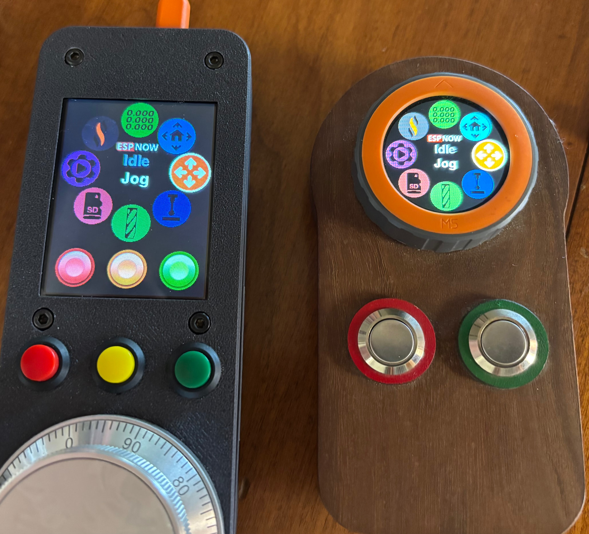

i can confirm that it works of CYD as well if you add espnow init here
damaged my CYD touch cable in while testing so wont be able to do better testing until replacement arrives
Nice, I’ll make that change tomorrow! Thanks on behalf of CYD peeps!
As far as UI changes I tried to just add the ESPNOW logo to indicate it’s active, hopefully that will suffice.
Thank you @zerg32. I will make the change and try it out.
That didn’t work on my CYD. Mine still says N/C Status.
Did you have anything else plugged into the CYD, like the dial or buttons? I do so I was wondering if I need to unplug them to install esp-now.
On the CYD there isn’t an ESPNOW logo. Maybe because it doesn’t become active?

I finally figured out that goes in the ESPNowTranport.cpp file.
It didn’t work either.

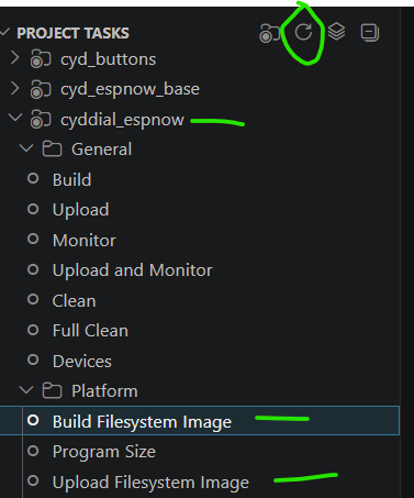

I updated GitHub with the code that should work for the CYD hardware, go ahead and pull that (commit is “Init ESPNOW for CYD hardware”.) Be sure to Build Filesystem Image and Upload FIlesystem Image from platform IO first for the ESPNOW.png graphic. (then, build and upload your cyd*_espnow profile)
The only instance of Build FileSystem is under M5Dial. When I try to upload the Filesystem is get this error message:
A fatal error occurred: This chip is ESP32, not ESP32-S3. Wrong --chip argument?

The new build WORKS! Thank you so much @coinbird!!!
I couldn’t upload the filesystem, but I could install espnow.
Woohoo! I hadn’t realized the filesystem thing is for the m5dial. Taking a look now, but glad the connection is working! (Edit: looks like the espnow.png should be rolled into the build via a different mechanism, so hopefully you see the icon. If not, I can try to figure out why.)

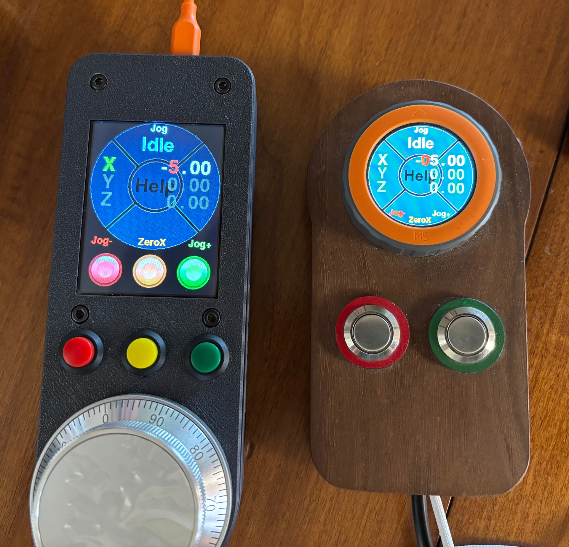

So technically (I tried) to allow multiple pendants. Would be curious to see if you can simultaneously use the M5Dial and the CYD… like a DJ of sorts
Weirdly, in PlatformIO I hit the little Refresh button and then (eventually) I saw Build Filesystem for cyddial_espnow:
and if you see that, then this should be equivalent (further down in the same folder):
That worked. I have the ESPNOW logo on both and they both connect and can control the Jackpot. NICE WORK!
Well that made my day, thanks for your help testing! And makes me miss my wooden FluidDial enclosure, time to make a new one! :grin:
(I did limit the number of attached pendants to 4 but that’s an arbitrary choice.)
I made the wooden enclosure when I didn’t have access to a 3D printer. It was fun to use when it first came out. I really like the handwheel on the CYD better.
