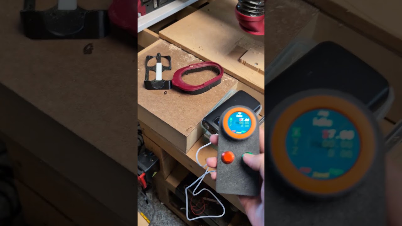

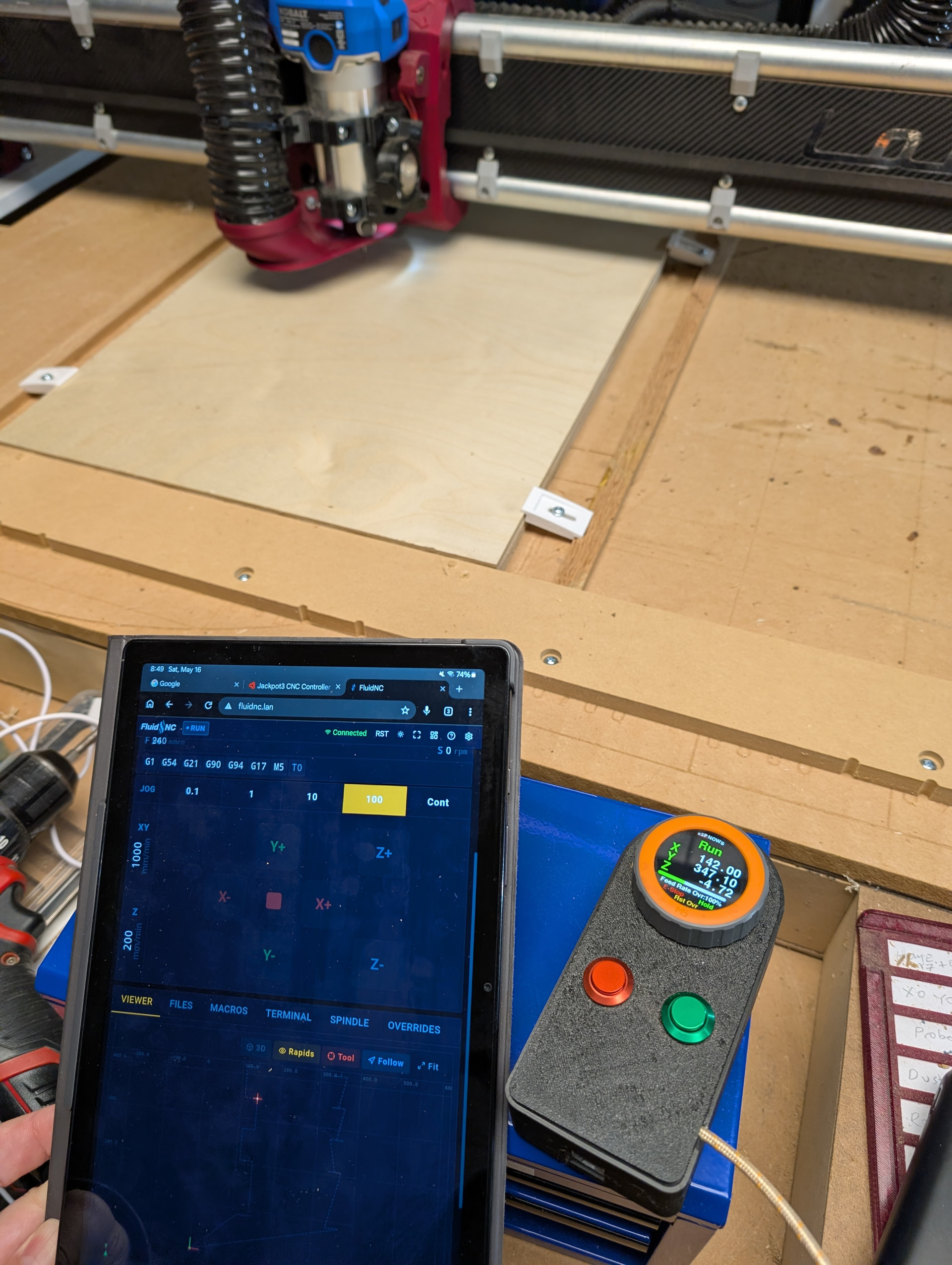

With FluidNC 4.0.3 the async web server got me thinking… with ESP-NOW ( ESP-NOW Wireless Communication Protocol | Espressif Systems ) I could maybe do wireless serial comms over ESP-NOW to the FluidDial and the Jackpot. And do it simultaneously with the web UI which uses Wifi through my home router. Would it work? Was it crazy? Yes?

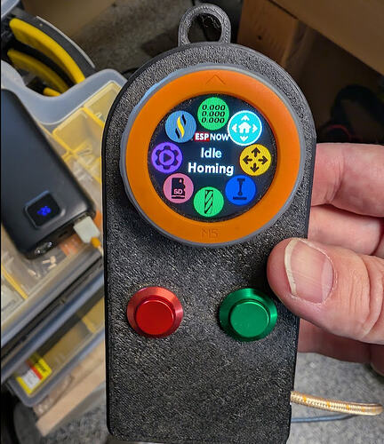

Hardware required is just the FluidDial and the buttons. I only have a Jackpot v1, but I assume it’ll work on the newer ones? If they mysteriously arrived at my doorstep I’d eagerly test!

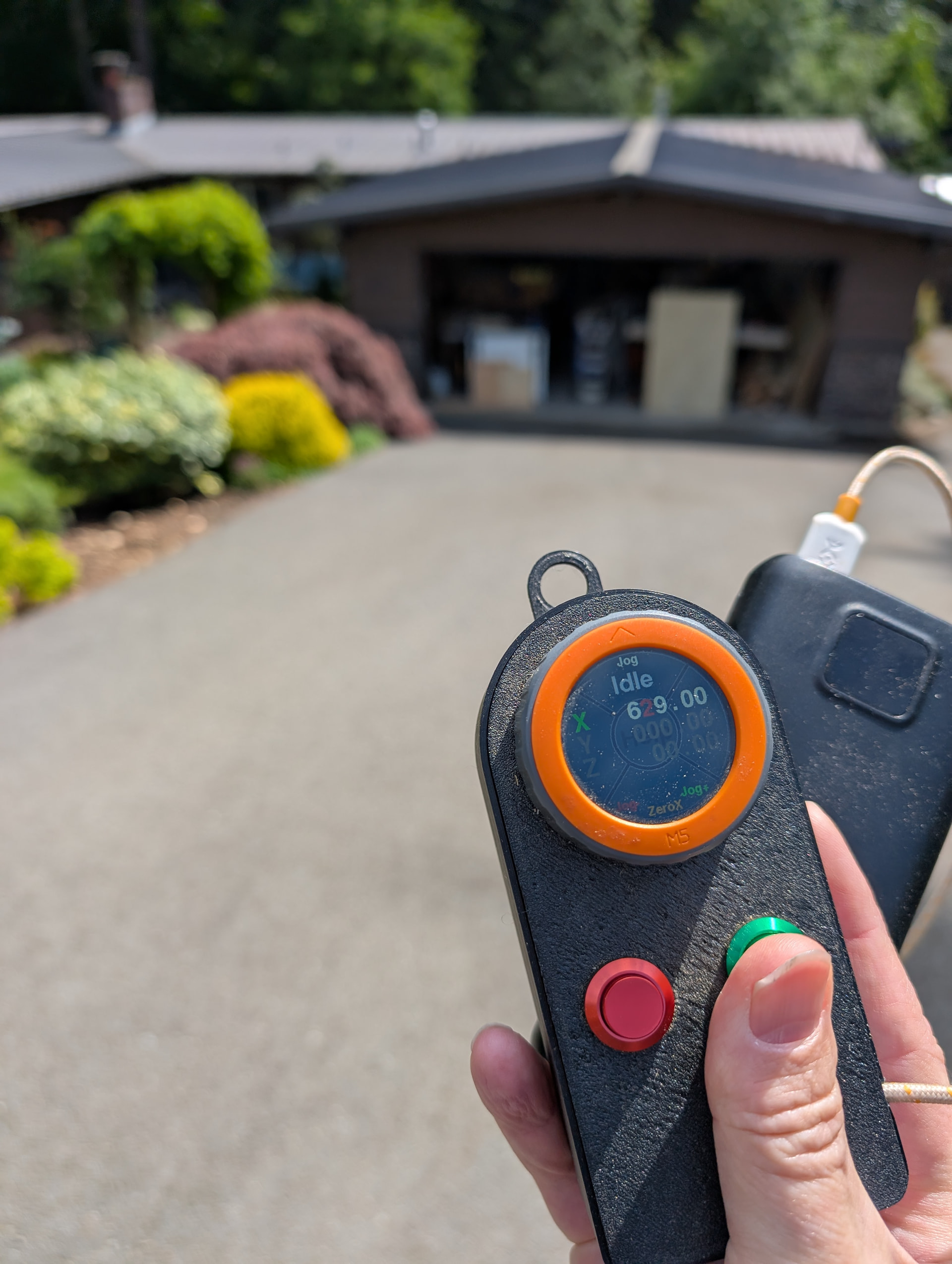

Oh and the ka-chunk in the video was something falling, not me breaking my Lowrider…
Now to make an enclosure that holds a battery… (actually, just a wall wart makes sense for those long sessions.)

They have to use the same channel (I handle that) but I haven’t had any issues in my initial testing. The nice thing is that this is a direct connection. In my video the webUI is going over my wifi router, but the pendant is talking over broadcast to the Jackpot directly 2 feet away.
E.g. if my Wi-Fi router goes down the pendant is connected via esp-now and stays connected.

There’s no pairing other than turning on the devices one after the other, it’s automatic. ESP-NOW is pretty slick. If the pendant is plugged in to RJ12 it will use that serial connection instead.

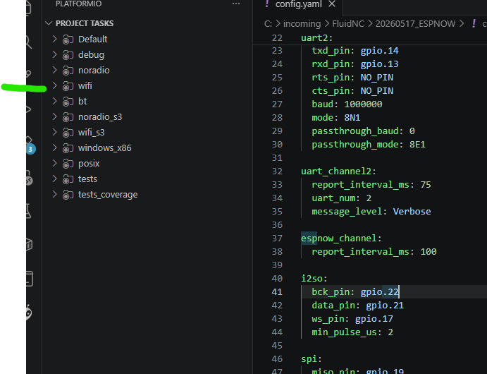

My Fluid CYD pendant doesn't connect to the Jackpot V2. I get this error:
[MSG:ERR: Ignored key espnow_channel]
[MSG:ERR: Skipping key report_interval_ms indent 2 this indent 0]

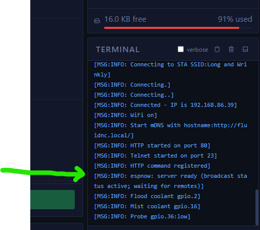

I didn’t know if this is ready for prime time testing, still working on docs etc. At a glance it looks like the FluidNC flash didn’t take, I have only added the code to the “wifi” profile so far. Which one does the jackpot v2 use?

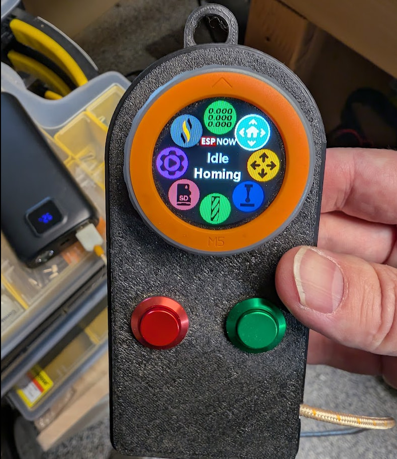

I did make a ton of progress today though and ran 4 jobs without issue. I kept reaching for the cable out of habit to prevent snagging during long fast Y moves!

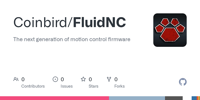

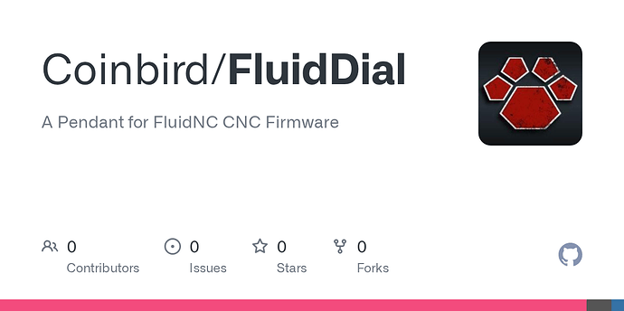

Made some major refactor and safety changes today, staying to come together… FluidDial/README-ESP-NOW.md at esp-now-connection · Coinbird/FluidDial · GitHub
The JP2 just uses different gpios than the JP1. I have both. I just wanted to point that out so you would know that’s why my uarts are using different gpios. I wanted to see where you added the espnow_channel: in your config. I was thinking I probably have it in the wrong place.
Thanks
I don’t touch anything gpio related at all.
The order doesn’t matter in the YAML as long as it’s at the top level of indentation. If it works, you’ll see the espnow logs after you flash your Jackpot. Note-make sure you pull the latest code from my esp-now-connection branch, made a bunch of changes yesterday.
I’ve only tested the wifi Platform.IO profile but wifi_s3 builds too if that’s what your jackpot v2 needs.

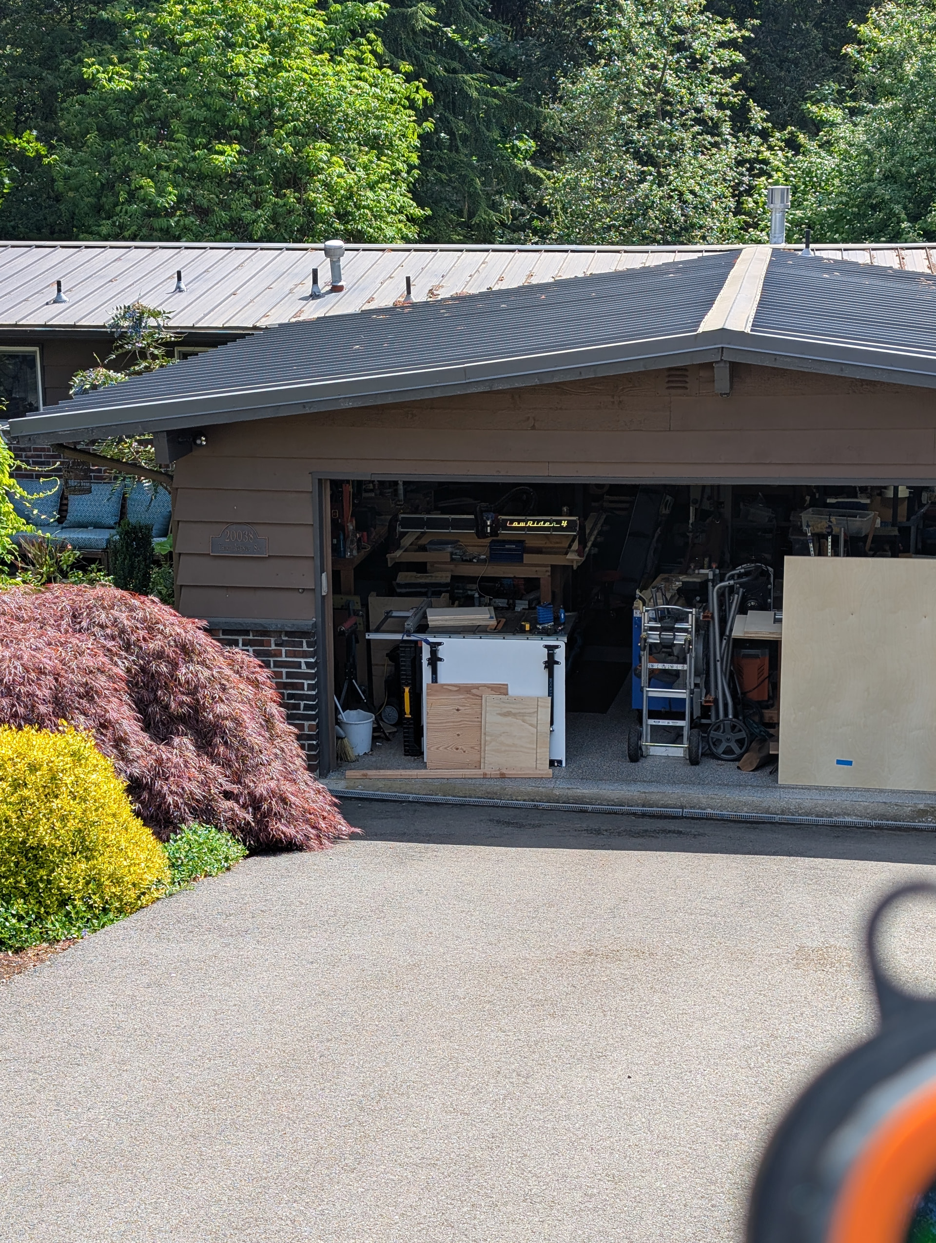

Range test is rock solid, so long WiFi! They say 200 meters outside but will never be anything close to that.
