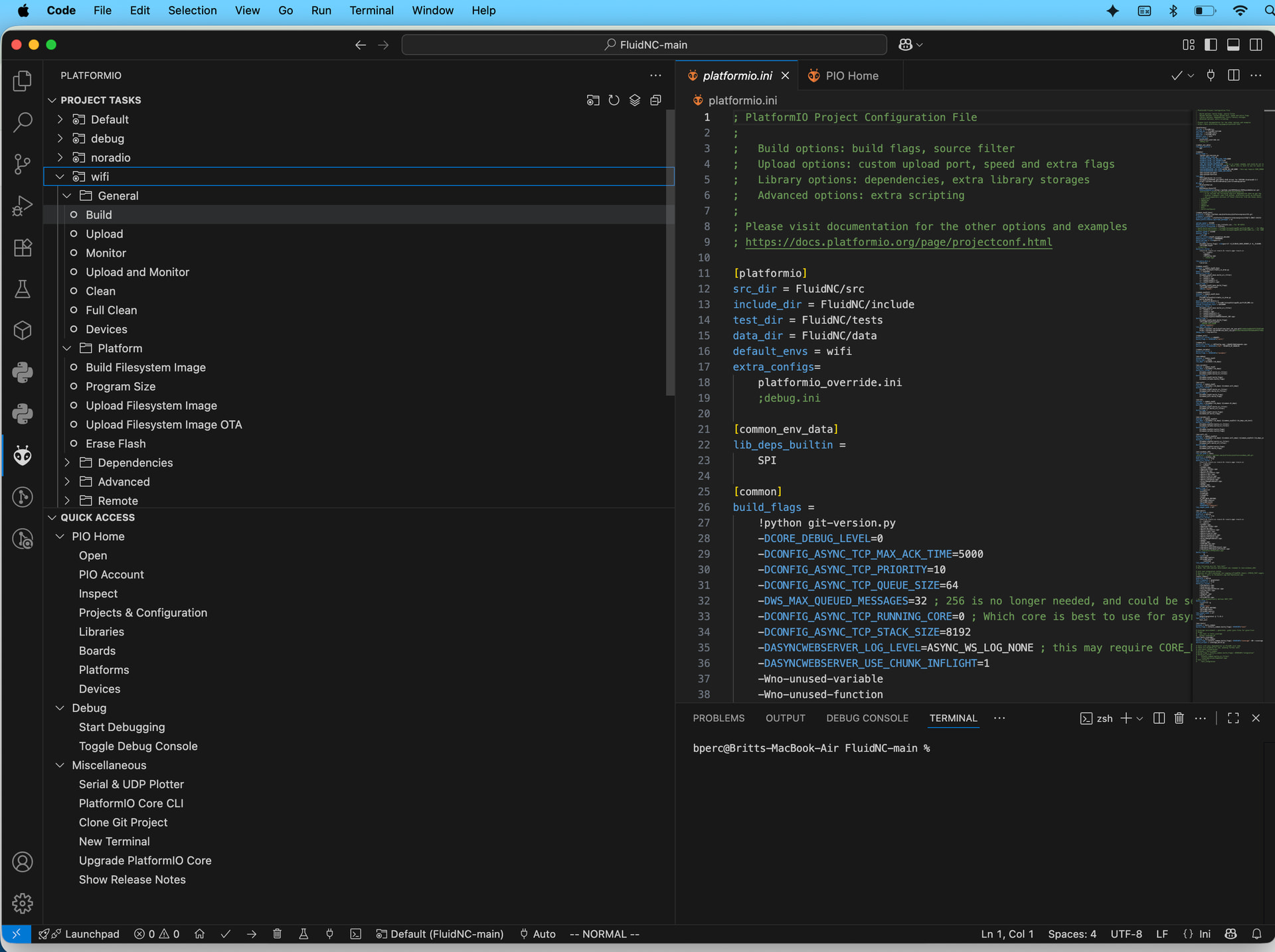

Yes, I installed Fluidnc 4.0.3 wifi on both Jackpots.
But did you install FluidNC from his fork? He had to make changes to FluidNC to support this.
No, that’s the part I missed. I have installed his fork now and it shows espnow server running.
But now $SS shows:
[MSG:ERR: Initialization error at /axes/X/motor0/tmc_2209: Step pin I2SO.2 type must be gpio]
[MSG:ERR: Initialization error at /axes/Y/motor0/tmc_2209: Step pin I2SO.5 type must be gpio]
[MSG:ERR: Initialization error at /axes/Y/motor1/tmc_2209: Step pin I2SO.13 type must be gpio]
[MSG:ERR: Initialization error at /axes/Z/motor0/tmc_2209: Step pin I2SO.10 type must be gpio]
[MSG:ERR: Initialization error at /axes/Z/motor1/tmc_2209: Step pin I2SO.18 type must be gpio]
[MSG:ERR: Validation error at /axes/X/motor0/tmc_2209: Step pin I2SO.2 type must be gpio]

My FluidCYD isn’t connecting. I’ll try reflashing it.
I installed it on my M5Dial and it connects. Still no luck with the CYD though.
I can connect with the M5Dial, but the steppers aren’t moving now. I have Ryan’s standard LR config on the JP1. I’m not sure why the error messages are coming up.
( Edit from the future: updated the YAML below to change stepping engine to I2S (was I2S_STATIC) )
Ah, progress! Glad the fork built. I can’t recall if 4.0 has a newer config format… here is mine if you want to compare (this is for a jackpot v1, stock LowRider 4)

Thank you.
I get these warning when building:
cc1: warning: command line option '-fpermissive' is valid for C++/ObjC++ but not for C
In file included from /Users/bperc/.platformio/packages/framework-arduinoespressif32/tools/sdk/esp32/include/hal/include/hal/i2s_hal.h:21,
                 from FluidNC/esp32/esp32/i2s_engine.cpp:16:
/Users/bperc/.platformio/packages/framework-arduinoespressif32/tools/sdk/esp32/include/hal/esp32/include/hal/i2s_ll.h: In function 'void i2s_ll_rx_get_pdm_dsr(i2s_dev_t*, i2s_pdm_dsr_t*)':
/Users/bperc/.platformio/packages/framework-arduinoespressif32/tools/sdk/esp32/include/hal/esp32/include/hal/i2s_ll.h:766:25: warning: invalid conversion from 'unsigned int' to 'i2s_pdm_dsr_t' [-fpermissive]
     *dsr = hw->pdm_conf.rx_sinc_dsr_16_en;
Compiling .pio/build/wifi/esp32/fnc_idf_uart_idfbuild.c.o
Yes, those warnings are OK–I had to add that -fpermissive flag because this is going to merge with Mitch’s “Portability” branch which requires it. Not sure what the timeline is for him merging that, which would happen before they considered merging this I would think.
I uploaded your confg and I’m still getting:
[MSG:ERR: Validation error at /axes/Y/motor1/tmc_2209: Step pin I2SO.13 type must be gpio]
I can’t move any motors.
Hmm, I haven’t seen that before but doesn’t seem related to my additions. (edit from the future - this was a side effect of rebasing to the Portability branch and me not testing)
Is there a weird space or extra line in there? Because seems like it would have choked on motor0 first… which uses I2S0.5 as a step_pin. My motor1 uses that same setting with no problem.
Here’s all the errors:
