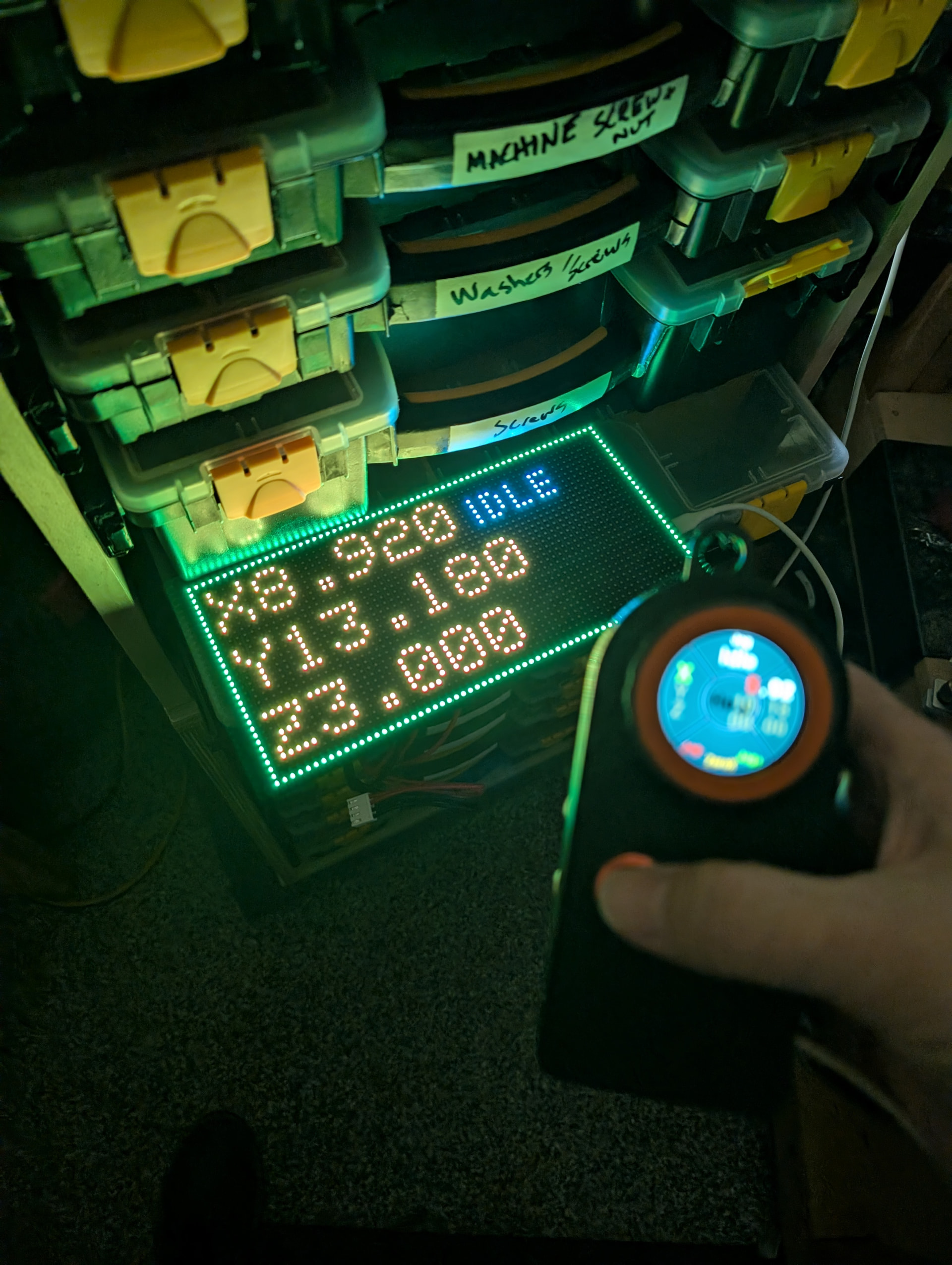

[MSG:INFO: espnow: server ready (broadcast status active; waiting for remotes)]
OK! Thanks for making me realize it @Britt ! The fix is bless(thankfully) easy:

I’m installing your Fluidnc espnow.
Woohoo! It worked. The M5Dial is working. No I2S errors. I can move the X and Y motors.

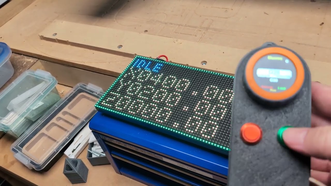

Broadcast mode should be cool, proof of concept works!
So how does this work for control if you have more than one FluidNC controller?
I know with WLED, pairing via ESP-NOW involves it listening for all ESP-NOW events, so it can display the last MAC address so you pair it to that MAC address.
Good question, I started to think about the multi-controller scenario and for now it’s (not ideally) first come first serve, so I do need to come up with a better solution. If you had two controllers you’d end up unicasting to the lucky one after it does the broadcast-to-unicast shuffle, as of now :slight_smile: Will add that to the backlog…
I installed your ESP-Now Fluidnc on my Jackpot 2. I was able to connect 4 devices to it at once. I had the M5Dial using esp-now, a FluidDial CYD plugged into it with RJ11 cable, the FluidTouch over wifi, and my laptop connected to Webui V3. I could control the Jackpot with all 4.
Neat! I found a bug regarding jogging, will push the change later tonight.
Jogging bug where the safety timeout was stopping jogs for webUI is fixed. Pretty slick passive broadcast, could fill the room with screens!
