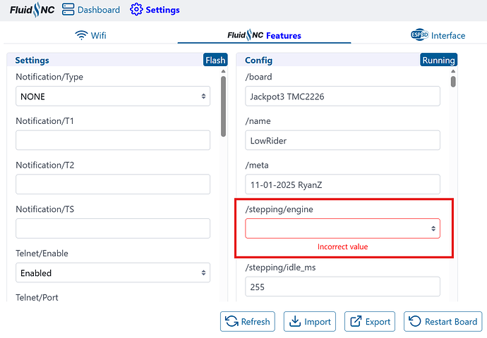

I installed Figamore’s ESP-NOW on my CYDs and Jackpots. After installing I kept getting an error that the Jackpot couldn’t read my SD card. It took me at least an hour to figure it out. You had me change
stepping:
  engine: I2S_STATIC
to
stepping:
  engine: I2S
That doesn’t work with his version. Once I changed mine back to I2S_STATIC it started reading the SD card again.
Just an FYI incase someone else did this too.

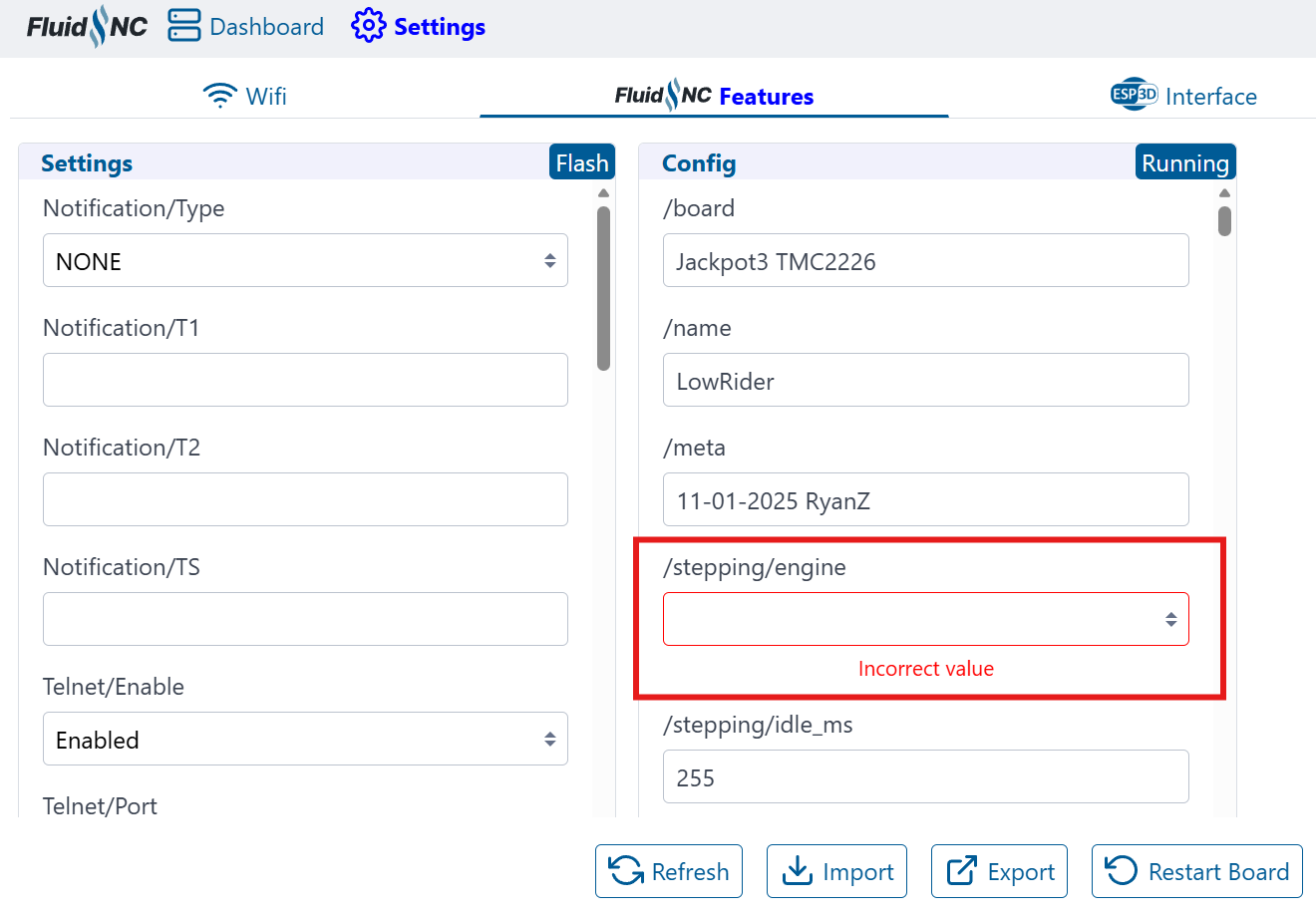

Are you guys referring to this value?
Mine is empty:
Regards
No, you don’t have to change anything with the new ESP-NOW implementation in FluidNC 4.0.4.
4.0.4 has issues, I had a job freeze up. There’s a 4.0.5-pre4 build that should fix it. 4.0.3 fixed the freeze for me but has no pendant esp-now support. (Not related to anything in my experimental version as discussed above in this thread)
Mitch has done a lot of fixes for both the webui, SD card reader and ESP-Now in the 4.0.5 branch.
I just updated to 4.10 and MillMage is working now!
